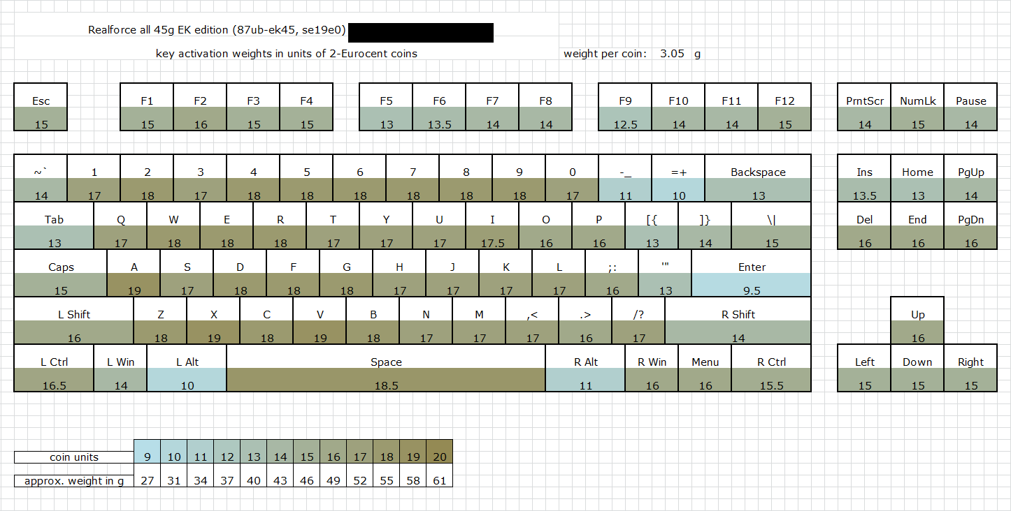

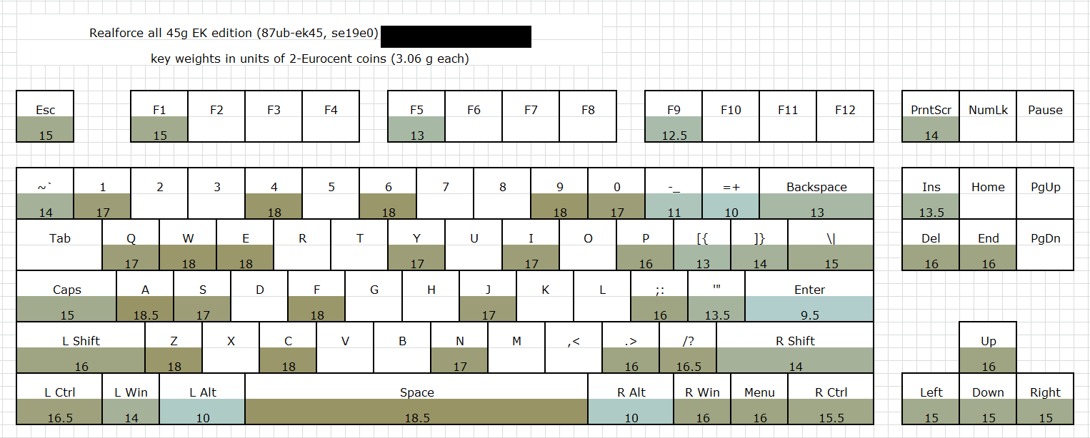

Ok, I did some coin stacking. I used 2-Eurocent coins which are rated at 3.06 g according to one source and 3.1 g according to wikipedia. I wrote down the numbers as approximate averages. A number of 15 coin units would be spot on. Allow +/-3 for tolerance (that's actually +/- 20%). That means that all figures should be between and including 12 and 18.
Behold the (incomplete) activation weight map of my Realforce. Quite some deviation in there. The enter key is indeed way off and so are =+ and both Alt keys.
Activation weight in 2-Eurocent units.
Realforce all 45g EK edition activation force map v01.png (34.05 KiB) Viewed 8408 times
17 Dec 2013, 00:17
That's a lot more variation than I'd expect. It'd bother me on both Alts as much as Return, because I use those continuously for keyboard shortcuts as Command keys.
Your map's looking practically like a standard variable weight Topre, with the tough stuff in the middle.
Kurk
18 Dec 2013, 23:43
Here's my updated force map. The alpha block is really homogeneous and clearly heavier than 45 g. To the sides, the required forces are much lower and in some cases way too low.
The more I use this keyboard the more I start to like Topre switches. But at the same time I'm getting increasingly annoyed by the too light enter and also the rather heavy A on the left.

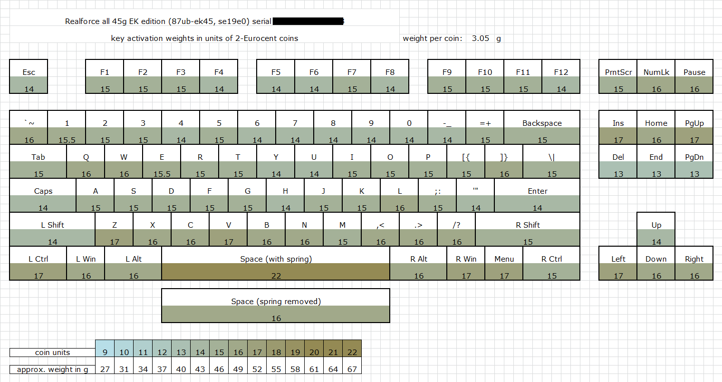

Brian from Elitekeyboards offered to service/replace my keyboard if I would take care of two-way shipping. Naturally I agreed. So I sent my Realforce to EK at the end of January. Approximately three weeks something later I received a parcel from EK with a brand new keyboard :) Even better, the return shipment was for free :D Again, thank you Brian for taking care of my complaints and extending the warranty across the US borders.
Anyway, the new Realforce immediately felt much more uniform. Of course, I've stacked some coins on the keycaps to show you. Indeed, look at the picture, it's such a difference.
Finally, I am experiencing oneness with cup rubber!
Activation forces of the replacement Realforce all-45g
activation force map of new Realforce all-45g.png (36.79 KiB) Viewed 7980 times
