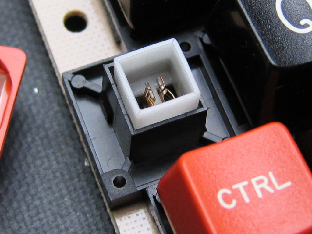

I've just noticed something else. Notice how the separator bar on Hi-Tek keyboards is completely flat on top, and level with with support triangles:
http://www.flickr.com/photos/triplehaat ... 5403683621
Compare with this CASI keyboard, with a stepped bar that's raised up above the support triangles:
https://plus.google.com/photos/11384566 ... 5823397356
That stepped design is specifically detailed in Stackpole's patent. There's a suggestion that this might be a better indicator of origin; for example, this HP 2382A terminal keyboard has the "waffle frame", but the sliders are flat bar:
http://deskthority.net/photos-videos-f8 ... t5471.html
At the moment, there are too few photos to go on. For example, the Oric Atmos keyboard is confirmed Stackpole, but no photos appear to exist of the sliders. There are a lot of photos of these types of switches and keyboards, but seldom photos of the switches AND the PCB/switch grid branding.

More pictures of the CASI keyboard.
http://www.flickr.com/photos/triplehaat ... 686728893/

Thanks. Those are far better than the photos on eBay of that same keyboard (which does have a blurry slider photo, but I just forgot :) Interesting that the slider is different again. Also, the keyboard is very flat. Compare with the HP 2383A terminal keyboard, which has tall mouldings:
http://deskthority.net/photos-videos-f8 ... ml#p138417

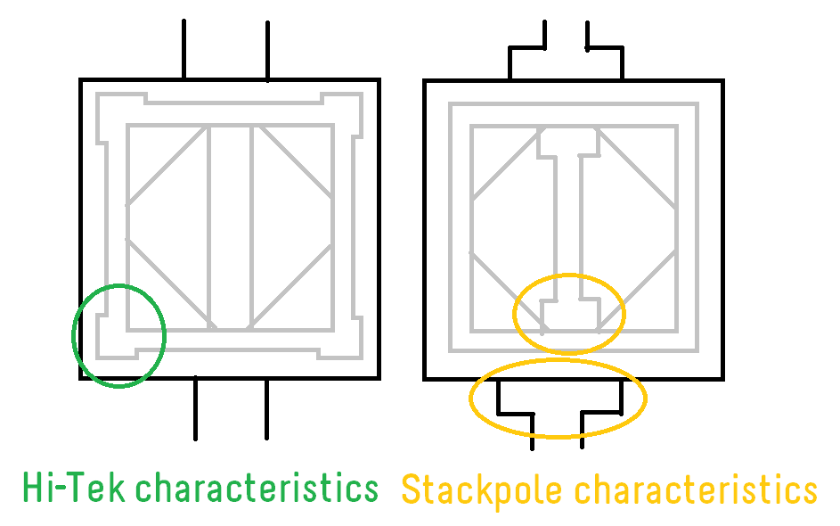

Current theory, up for refutation:
Hi-Tek vs Stackpole.png (40.41 KiB) Viewed 11388 times
Hi-Tek: one long finger on the left, four small fingers on the right; separator bar wide and parallel
Stackpole: one long finger and two small fingers on either side; stepped separator bar or replacement of triangles with rectangles
This appears to fit the evidence to date: Toptronics, Perkins-Elmer, HP 9816 (all confirmed Hi-Tek), and Oric Atmos (confirmed Stackpole, which happens to partially match the Stackpole patent). The CASI keyboard has no supporting signs of being Hi-Tek (white-infill serial number, branding), so that seems to be Stackpole, and it does exactly fit the design in the Stackpole patent (the Atmos does not).
OK, anyone got any exceptions to this where Hi-Tek or Stackpole branding is present on a keyboard that does not match the above?
The waffle frame appears to be a red herring: it appears that Hi-Tek used that themselves.
Diagram based on an excellent top-down photo from Kurk on the wiki.

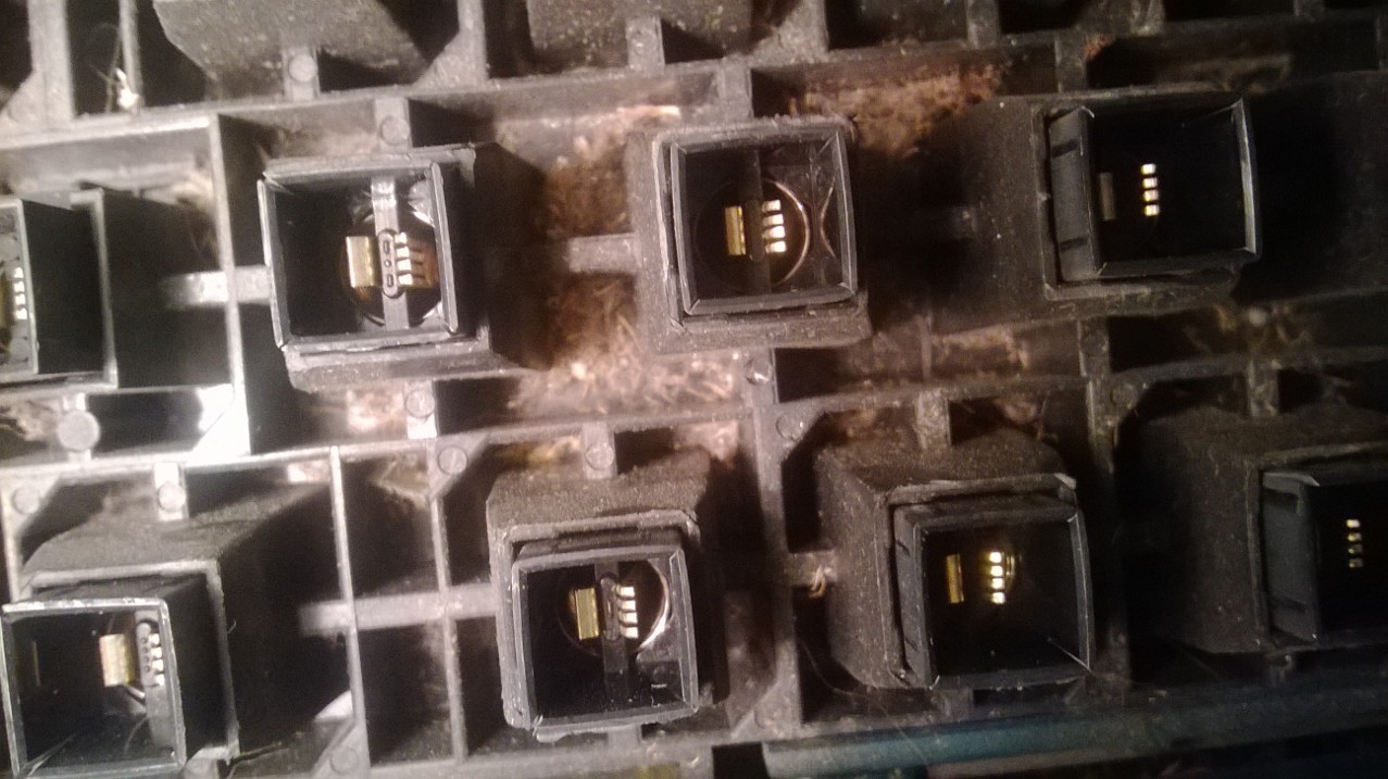

Here's my DEC VT52. Ignore the filth underneath, I need to clean it.
The clamp is solid on the left, 4 prong on the right. The cross beam is a straight bar with a raised portion in the middle.
Not sure if this is noteworthy or not, but on some of the raised bars there are little imprints, 1 dot or 3 dots, while some hav none. Not sure if this is caused by the clamp or there by design.
Also the caps have adapters for a cross mount.

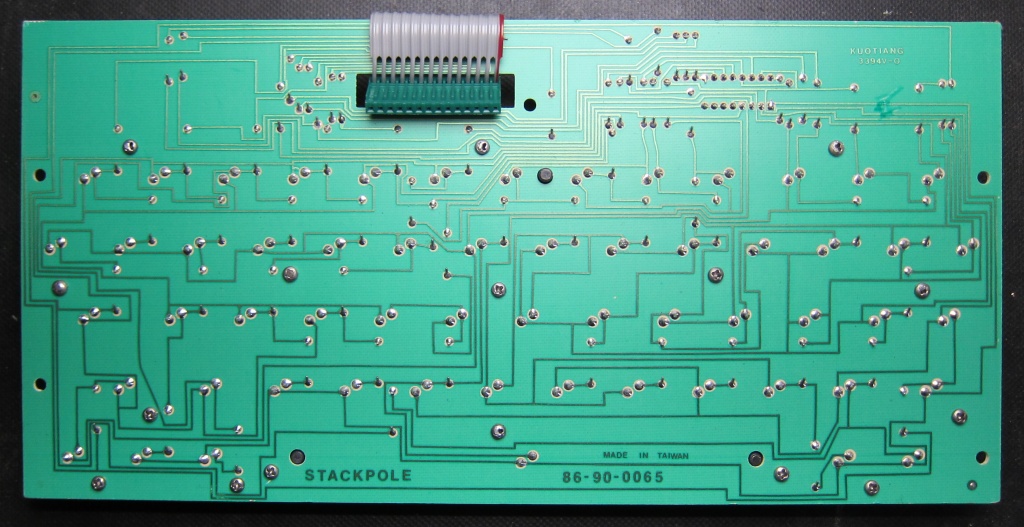

Sadly, the PCB was Made in USA by TI. the IC's date it to 1981.
full album: http://www.flickr.com/photos/110970257@ ... 094078524/
Any good ideas on cleaning these switches so I can take wiki-suitable photographs? I spent a few hours on it already; getting dust out of those switch holes is a significant pain.

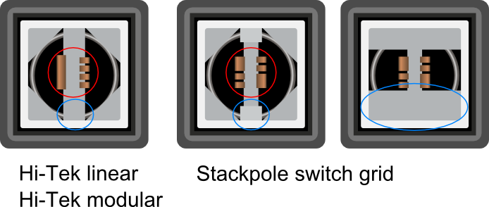

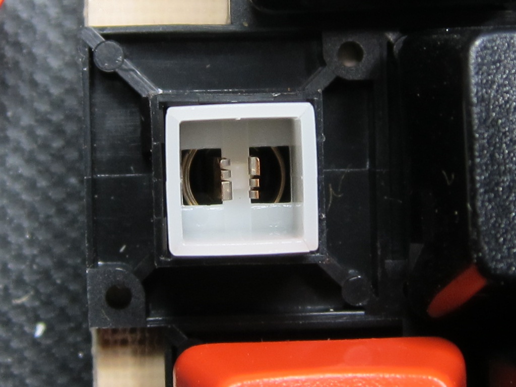

It gets more curious. Following the discovery of an HP 2623A keyboard with yellow sliders that seem to be Hi-Tek, I put this to D'Milo Hallerberg. Neither he nor Susan Kennedy (also ex-Hi-Tek) are aware of Hi-Tek using any slider colour except white (colourless).
So that suggests that my diagram is misleading or incorrect. The shapes circled in blue give Stackpole for the HP 2623A keyboard, but the colour would indicate Stackpole. The contacts (circled in red) would therefore also not be manufacturer-specific.
Then you have the centre-raised black type that theGagne and dorkvader have, which are Hi-Tek-shaped but still the wrong colour!
So far, every keyboard that we know for certain to be Hi-Tek does have white (colourless) sliders. All these strange, mystery ones are always totally unbranded.
Stackpole also used white (above) but also yellow and green (all confirmed).

OK, so the switch contacts are not an indicator!
Stackpole in US patent 4255635 wrote: One strip is solid, but the upper end of the other one preferably is provided with parallel longitudinal slits to form fingers that assure good contact with the other strip.
The contact design is therefore not an indicator!
What I did notice is confirmed Hi-Tek sliders seem to have reinforced corners. D'Milo independently observed the "boss" (as he calls it) where the webbing meets the plunger shaft, something that's been a consideration already. In that HP keyboard, despite having Hi-Tek–style contacts, the separator bar still has Stackpole's stepped design. These three characteristics are all highlighted in the image below:

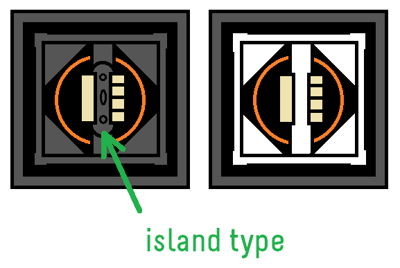

I rediscovered this earlier:
keyboards-f2/hi-tek-corp-history-t10435-30.html#p229162
At the time it seemed irrelevant, but now I see that it's a confirmation that Hi-Tek did make switches with black sliders, and that the island design is indeed genuine Hi-Tek:
Hi-Tek old island.png (8.25 KiB) Viewed 10206 times
However, I still don't know what the island is for, and and why it always has erratic blobs on its surface. In the example linked above, the blobs look very blobby, and one switch looks as though there's water between the contacts.

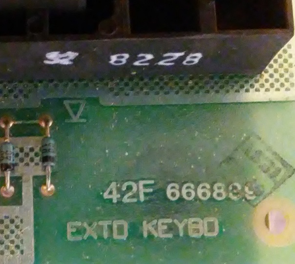

Very interesting analysis! I don't know if this will help any, but there are a few markings on the the switches from the HP 2623A - here is one pic I have of them on the yellow switches:

OK, new page with a new illustration and (over three and a half years on, albeit only three years since this topic was created) a recreation of my original diagram with far more detail:
[wiki]Hi-Tek and Stackpole recognition[/wiki]
The rebuilt diagram is based on photos from snuci, Soarer, Kurk and others.
The text has come out in serif as the wiki no longer has any idea what sans-serif is,and it also butchers the character weight and kerning sometimes.
