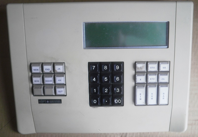

Bought this keyboard (actually three of them) because the photo obviously showed Cherry relegendable keycaps and I was just curious.
Now I received it and here is how it looks:

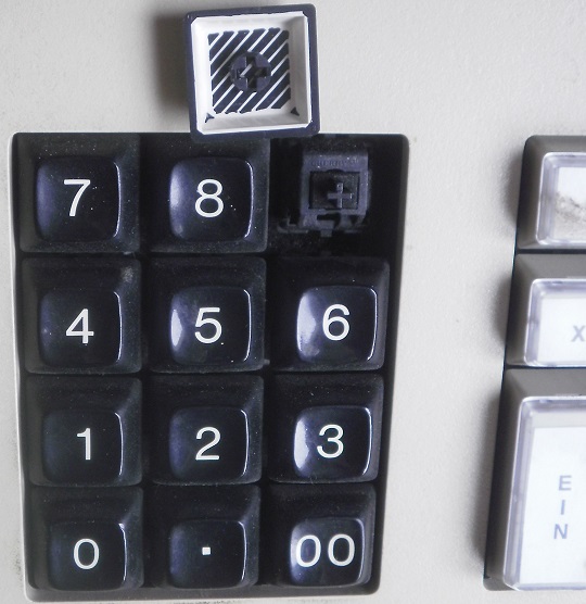

Flat spherical doubleshot number keycaps:

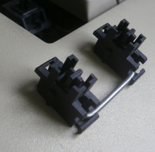

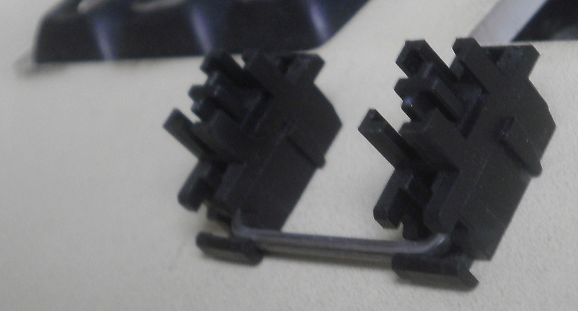

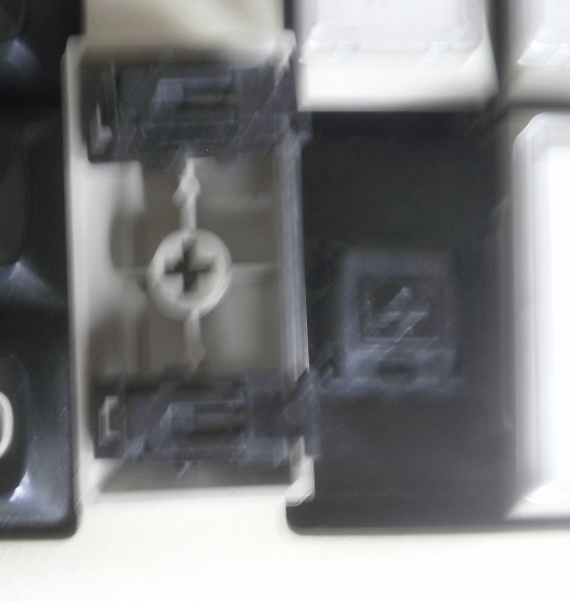

But the interesting thing are those double keys. When pulling one of them, the whole assembly comes out together with the stabilisers (sorry for the blurred pic):
Neither the PCB nor the bottom side of the stabilisers show any trace, hole, tape or whatever suggesting the stabiliser is attached to the PCB, and that is true for all the double keys. When in place, they are just a bit wobbly, but pressing them completely off-center is no problem at all.

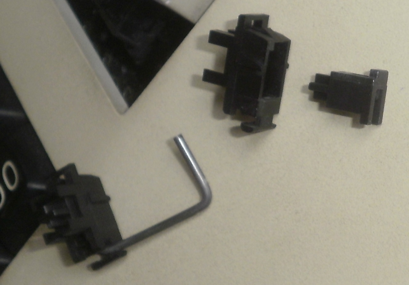

Here is how they look like:
I'm not very familiar with stabilisers, but do not remember having seen those before.

They look like the standard Cherry plate mount stabs to me, been a while since I've seen one though so could be wrong...

HzFaq wrote:They look like the standard Cherry plate mount stabs to me, been a while since I've seen one though so could be wrong...
But aren't those standard stabs normally attached to the board? And anyway, here the switches are PCB mounted. The whole assembly is held in place only by the cap on its switch and the stabs obviously just lie on the board.

The only Cherry stabs I've seen in person are the PCB mount variety. The ones you've found look quite similar to them, but different on the foot. Certainly credible that they're the (surprisingly elusive) Cherry plate mount. If they are, I could use a few of them for my PCB-less custom keyboards! Strange they're not actually mounted in anything, though. You say they seem to work anyway?

The plate mount stabs push through the bottom of the switch mounting plate and aren't connected to the PCB at all IIRC, I've only ever used one when I built my Phantom but I'm pretty sure thats right.
The fact that they're present here on a PCB mounted board is odd to say the least...
edit - Found this (I think its WFD's picture from over at GH), looks like those are plate mounted Cherry stabs.

Those are Cherry plate mount Stabilisers as said before. You can see how they work here:
http://imageshack.us/a/img18/3152/j0am.jpg
http://imageshack.us/a/img842/9720/y1is.jpg
If they are really just thrown in on a PCB mounted board the manufacturer did pfusch, :D
They are basically the only alternative to Costar stabs when going plate mount, which are considered being
Muirium wrote:Yeah, you're both right. Costar stabs sighted, the fiddly buggers!
As there are only so much vintage Cherry boards with plates made, they are quite rare, but as Ducky and others are using them they are also quite in demand.
Take a look at this thread (56k warning) for more pics.
In other words: If you market them seperatley be prepared to get your hands ripped off... ;) Also: nice board, congrats. :)

Thanks for the input, guys. Obviously one never stops learning.
As said before, pushing the cap completely off-center is no problem, even if it is just a bit wobbly then.
I'll try to find time to test how the space bar of a PCB mount board behaves with those stabs only connected to the bar itself and just resting on the board.

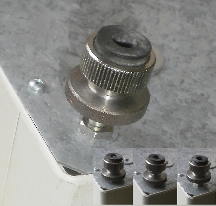

By the way, each keyboard has two gorgeous heavy-duty adjustable feet each consisting of a big bolt, a fat nut with a rubber insert and a large lock nut:
Perhaps some of you would be interested in those as well.
