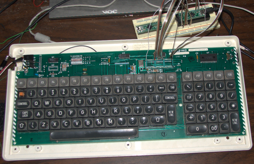

Process (after disassembly):
1)Remove 8741 chip at U6. Go slowly and carefully since you will not be able to use the left side to create leverage.
2A)Wire up solid core wire as indicated from socket U6 to a small breadboard, prepared perfboard, or circuitboard:
Wired up keyboard to breadboard Teensy++ for testing.
Pin 40 is upper left (+5v)
Pin 20 is lower right (GND)
Pins 21-24 are across from GND (Strobe lines). These must go to D3-D0.
Pins 27-34 are between strobe and +5v (3rd pin left of leftmost strobe, 6th pin right of +5v).
2B)Align Teensy on controller board so that the connector faces leftward - so that one can take advantage of the external connector.
3) Carefully assemble board so that wires remain in place.
4) Connect USB cable and route it under the board so that it goes to the keyboard port.
5) Reassemble strain relief.
6) Reassemble all remaining parts of board (screws to case))

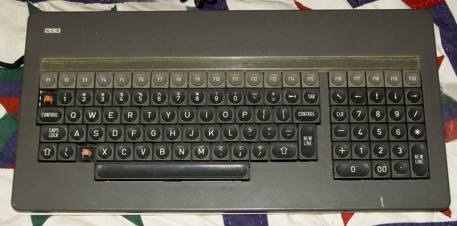

Misc. Pictures:
The keyboard in a more complete state, aside from missing keys.

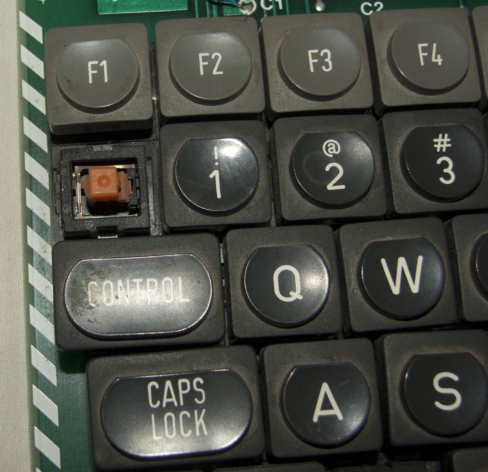

Closeup of the keys and switches.  The keycaps are doubleshots.

Those switches are one of the following:
[wiki]RAFI RS 76M[/wiki] — if the travel is 4 mm
[wiki]RAFI RS 74M[/wiki] — if the travel is 2.5 mm
They do appear to be 76M.
