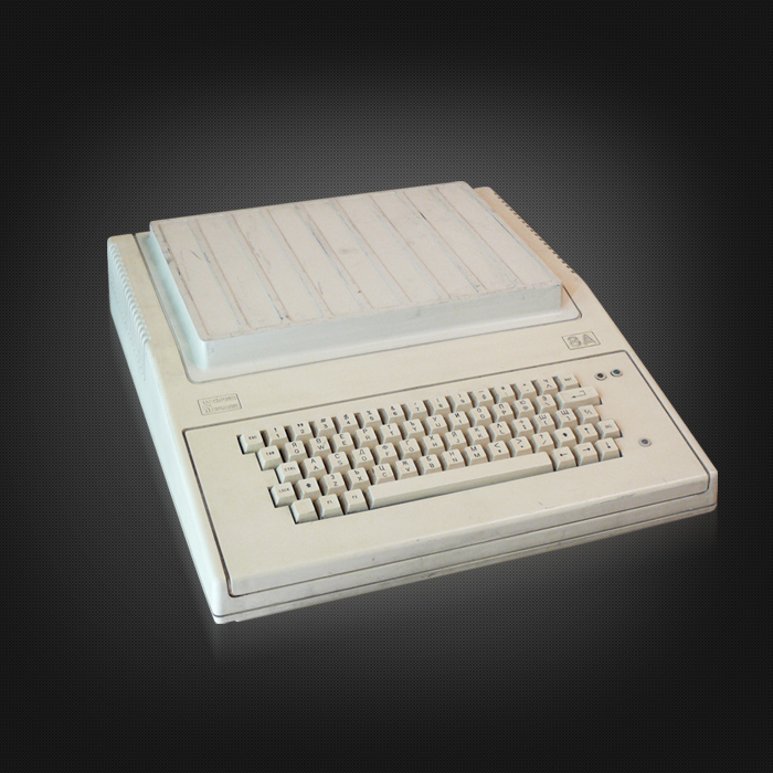

So I recently got this keyboard from Ebay after somebody posted it here. The keyboard stems from a Pravetz 8A computer, which is from what I understand the Bulgarian counterpart of the Apple IIe. The 8A was build between '86 and '88. If you want more information about it here's what I have found: http://www.pravetz.info/pravetz-8a.html

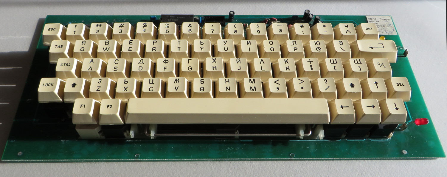

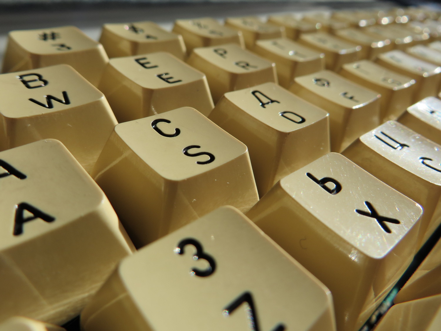

When it arrived it was extremly dirty and the keycaps were in a disgusting condition. For those who never bought an old keyboard, the first step is usually to put the keycaps in some warm water with dental tablets. They didn't really help this time and I had scrub each keycap - in hindisght that was a good decision since the legends are engraved. The keycaps are not doubleshot and probably ABS. They have a slightly spherical profile and feel very solid.

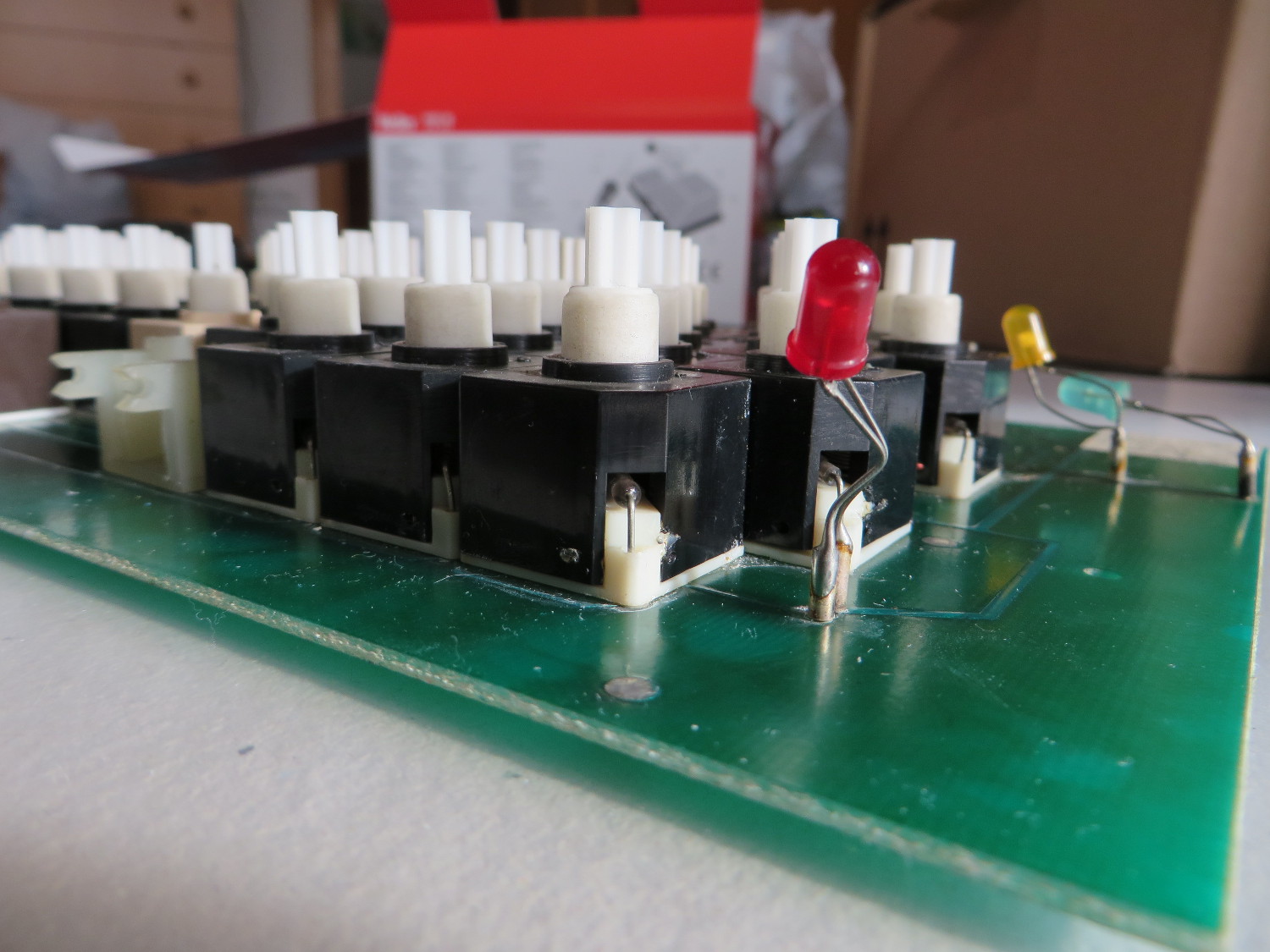

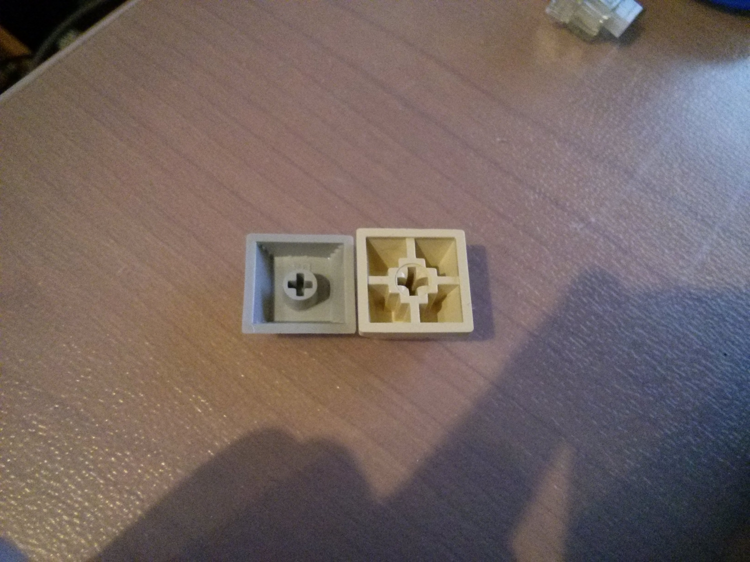

The keyboard features some cross-stem switches (not MX compatible), most of them with black housings, but with some brown and beige housings as well. The switch on the spacebar has a grey stem and feels heavier, but I couldn't feel a difference between the different housing colors, I don't think they make a difference. I don't know what exactly that is on top of the grey stem but it didn't come off. The enter key is the only key that uses two switches.

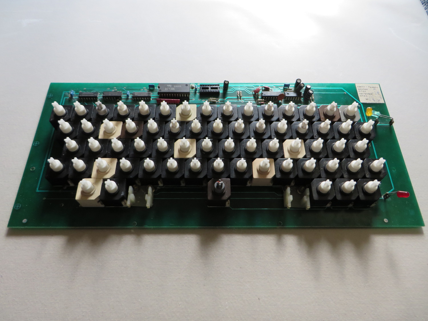

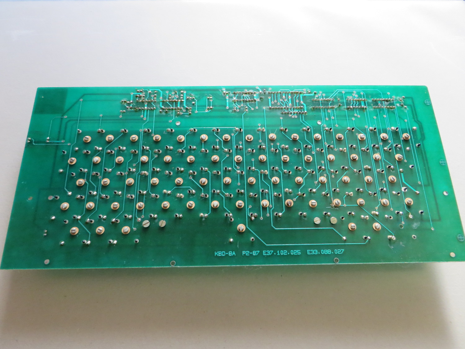

Now to the switches. As you can see the switches are secured with some screws on the PCB. I don't think there's an option to plate mount these switches.

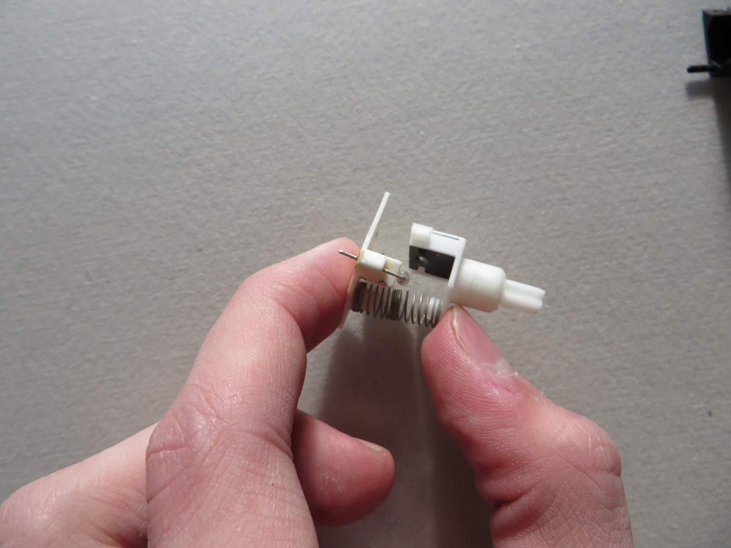

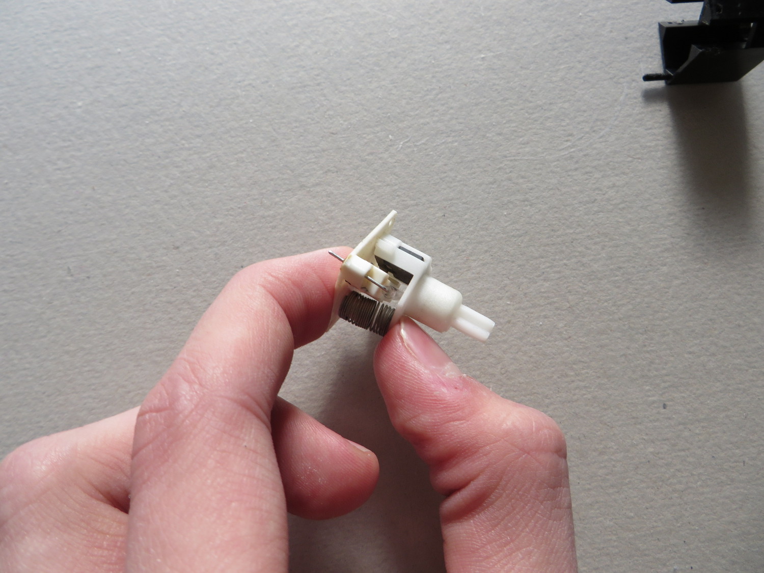

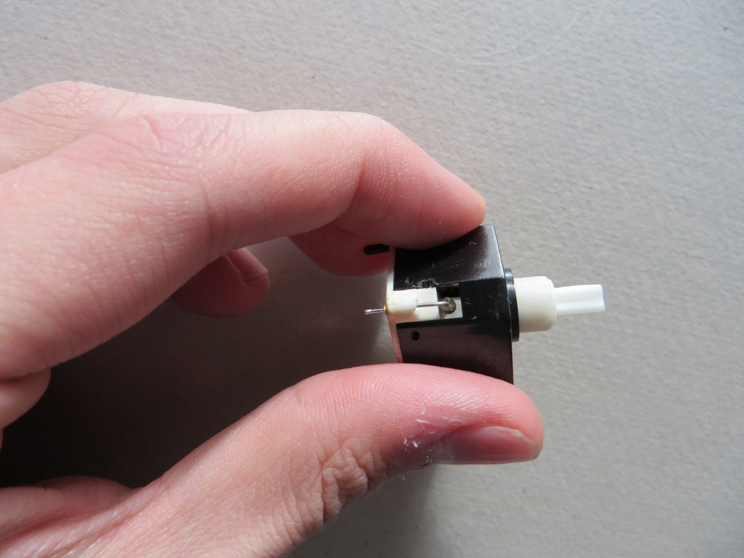

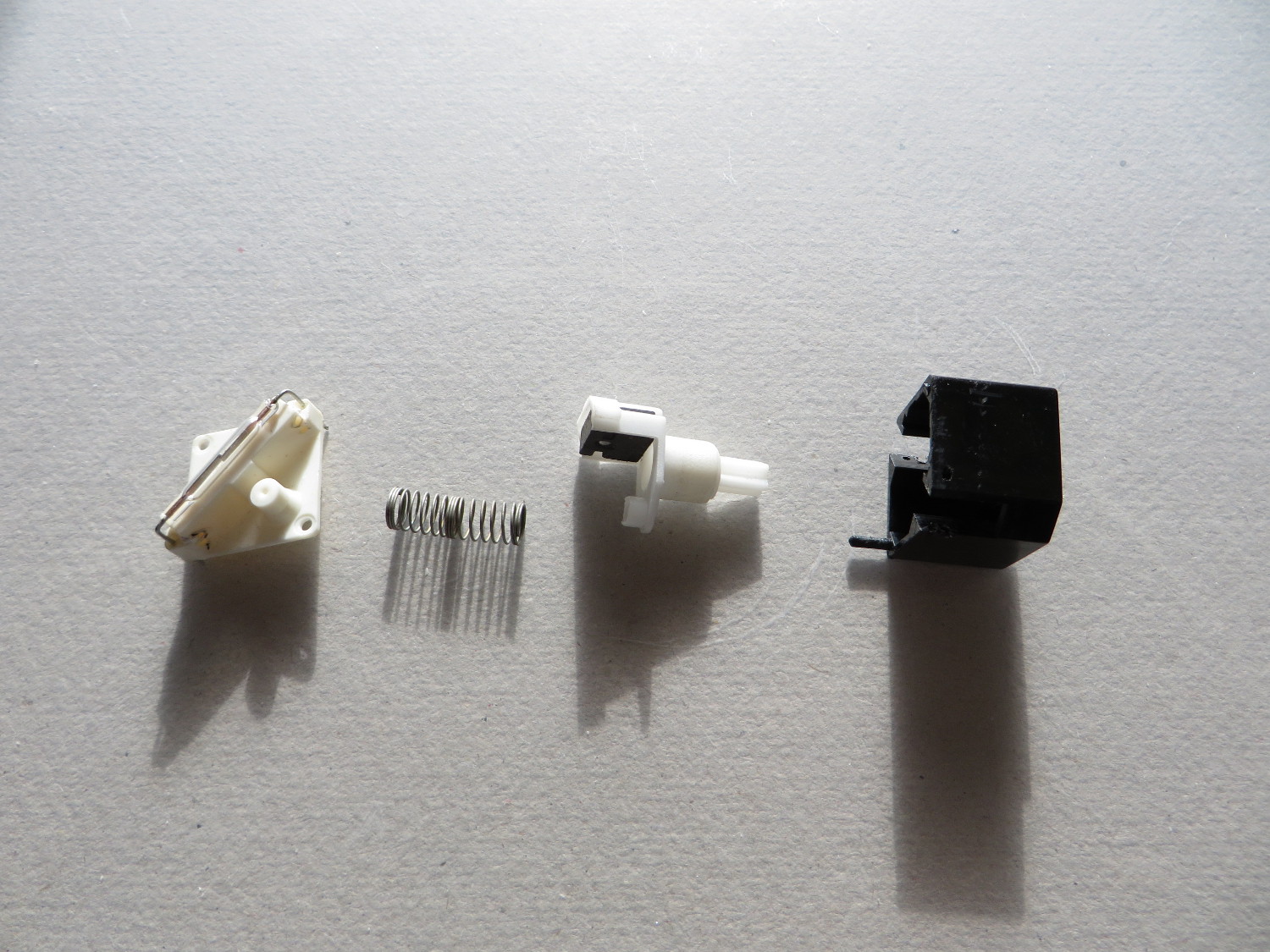

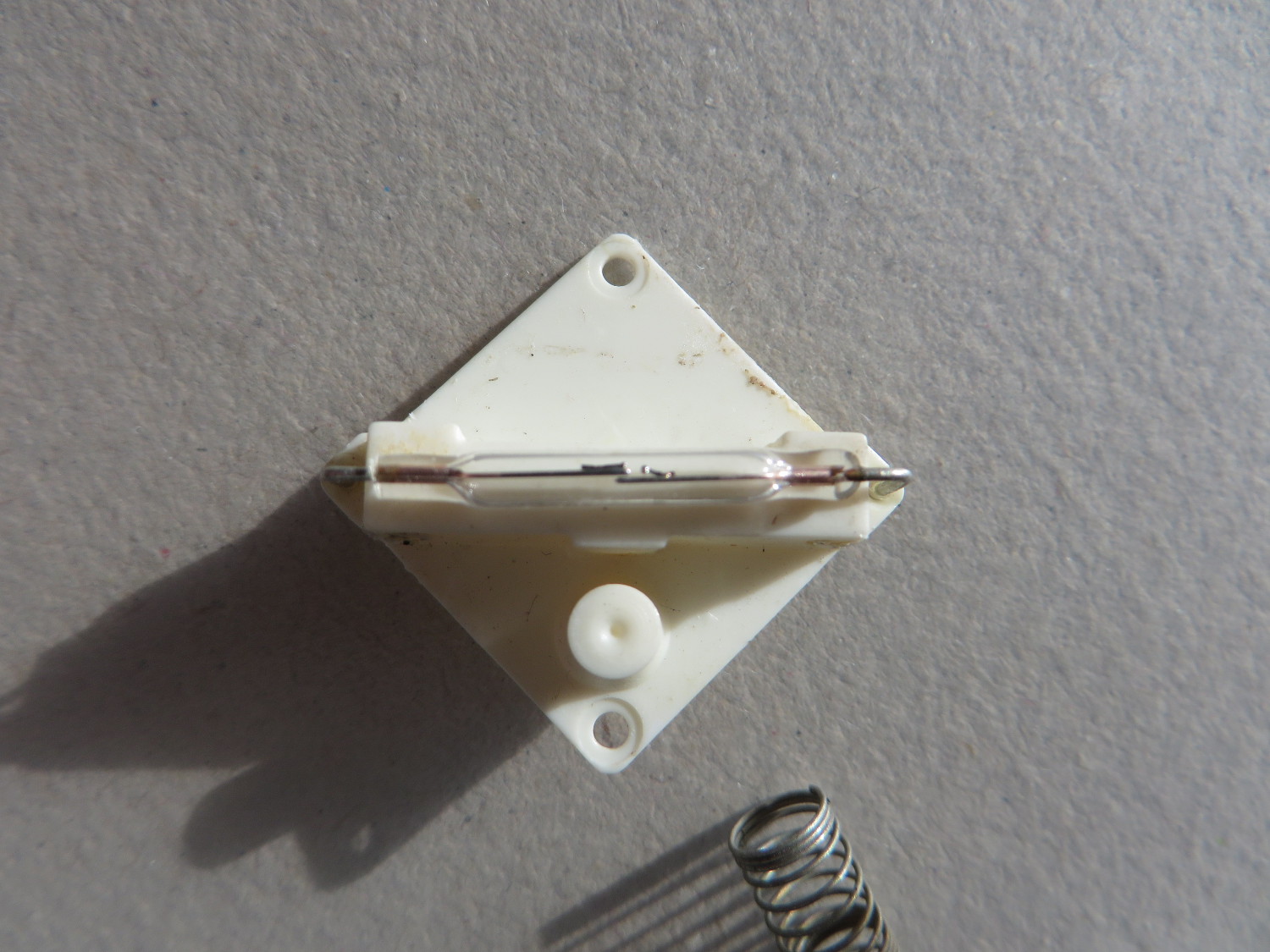

From the outside you can already see the most important part of the switch, the reed switch. Opening a switch is not as easy as you would think, there's a part of the housing molten so that it doesn't open without scraping a bit of the molten part away. Hard to explain, but worse than glue. There's also an additional tiny copper pin that goes through a tiny hole to prevent opening it as well. If you noticed, one of the legs to fix the switch on the PCB broke off :?
The switch inside is quite simple, a magnet is attached to the slider and goes next to the reed switch when the key is pressed. A reed switch works with two very small metal plates that connect when a magnet is brought nearby. The slider itself only hits the bottom of the housing, it's not really clear on the photos.

For engraved caps, they look pretty damn good. Better than those crazy bandy-legged LEDs! Sounds quite nice too in the video. The space bar stabiliser is refreshingly quiet compared to many 80s boards. Could still use a little lube, though.

Yes, I like the lighting in that video. I wonder if those keycaps were originally white and the plastic yellowed or if "butter yellow" was the intended colour (doesn't look as bad as most yellowing). I didn't think they still did engraved keycaps in the late 80's. Eastern European countries were obviously slower to modernize. (which is certainly good for keyboards)

The caps have a long long cleaning session behind them, they were disgustingly dirty (this picture is still harmless, especially in comparison to what amount of dirt was on the switches) when they arrived.

I think they were always a bit cream colored but not as much as they are now. I don't mind, the current color is quite pleasant and the yellowing is even.

Hmm, the keycaps look like they might have been doubleshot as blanks and the legends then engraved. It's not too uncommon to see, especially for boards with really funky legends. Care to check?

dorkvader wrote:Hmm, the keycaps look like they might have been doubleshot as blanks and the legends then engraved. It's not too uncommon to see, especially for boards with really funky legends. Care to check?
Nope, caps aren't doubleshot. Also quick thickness comparison with Triumph-Adler caps (should be the same as thick Cherry/GMK/BSP). Sorry just Nexus 4 quality but I think it will do :)

What a fantastic looking board - I love the engraved caps. Super neat switch mechanism. (Neat looking machine too - the texture on the case looks cool).
