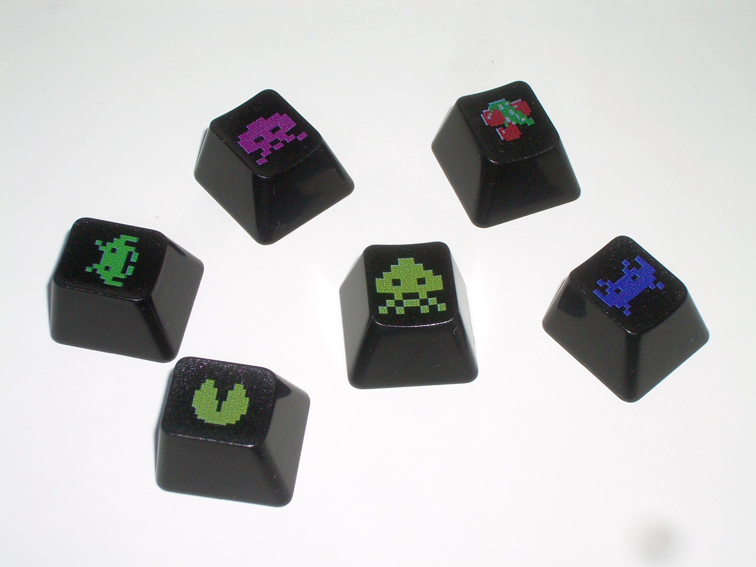

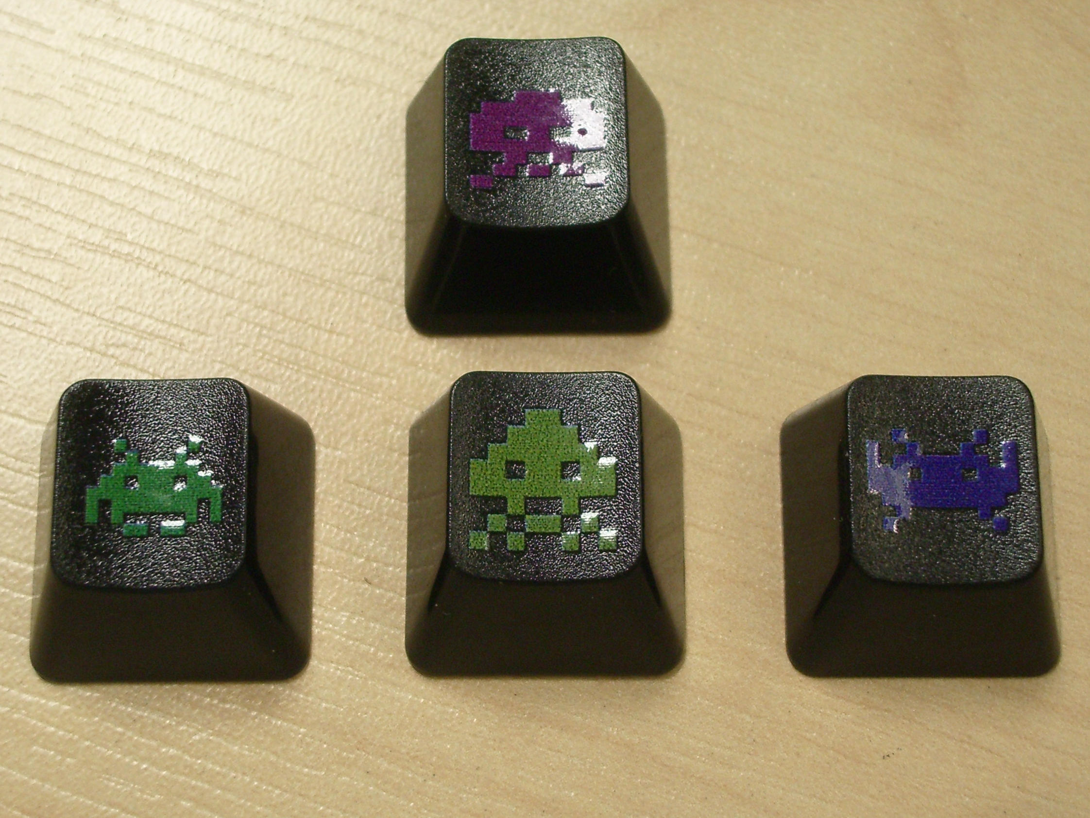

I just got my QWERkeys dye-sub group buy keycaps yesterday. This topic serves as both a photo gallery and a review.
My complete order of keycaps; I was actually wondering where these had got to:
Assorted keycaps.jpg (286.95 KiB) Viewed 3497 times

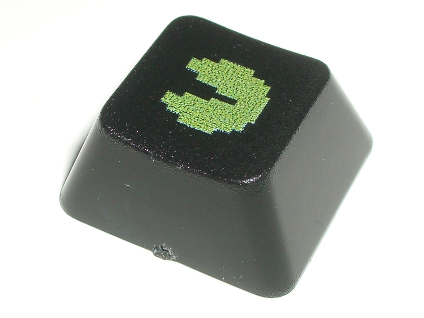

I am not entirely clear on how the legend is generated. One possibility is a white pad-printed base, dye sublimated image, and finally a carefully-cropped selective image UV lacquer. However, there appears to be signs of lacquer running down the sides, suggesting that the thickness of the highly raised printing is down to the pad-printed base, which is topped with all-over coating.
You can see how thick and shiny the legends are:
UV lacquer thickness and shine.jpg (516.96 KiB) Viewed 3497 times

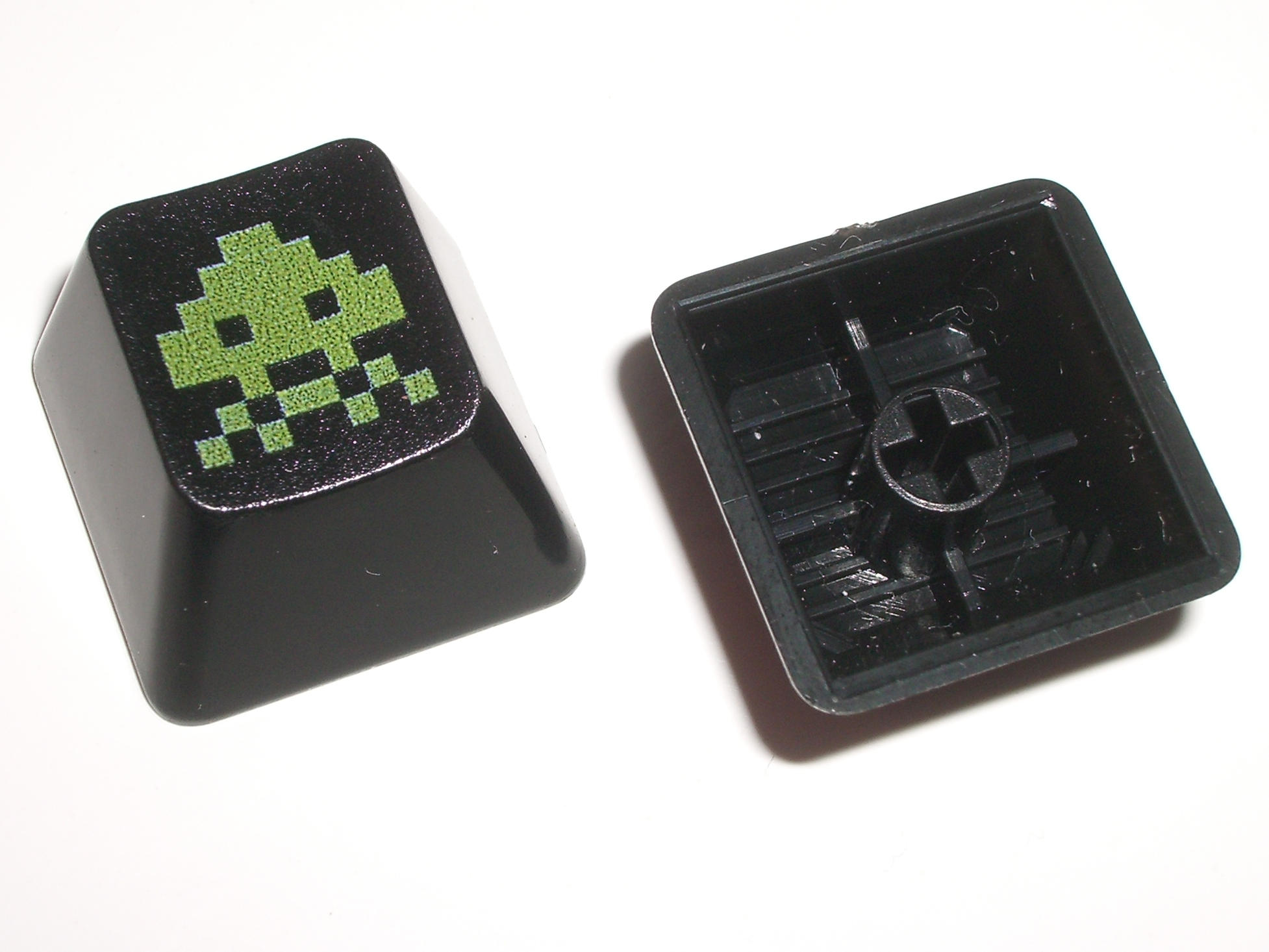

The walls are around 1.5 mm thick at the base, and appear to get thinner towards the top:
Exterior and interior.jpg (208.27 KiB) Viewed 3497 times
The sprue mark is at the rear, where it belongs:
Sprue mark at rear.jpg (103.93 KiB) Viewed 3497 times

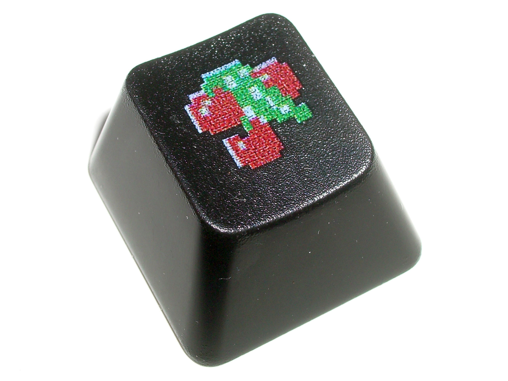

The dot pitch of the dithering from the colour printing is particularly coarse, being readily visible with the naked eye:
Surface printing detail.jpg (275.07 KiB) Viewed 3497 times

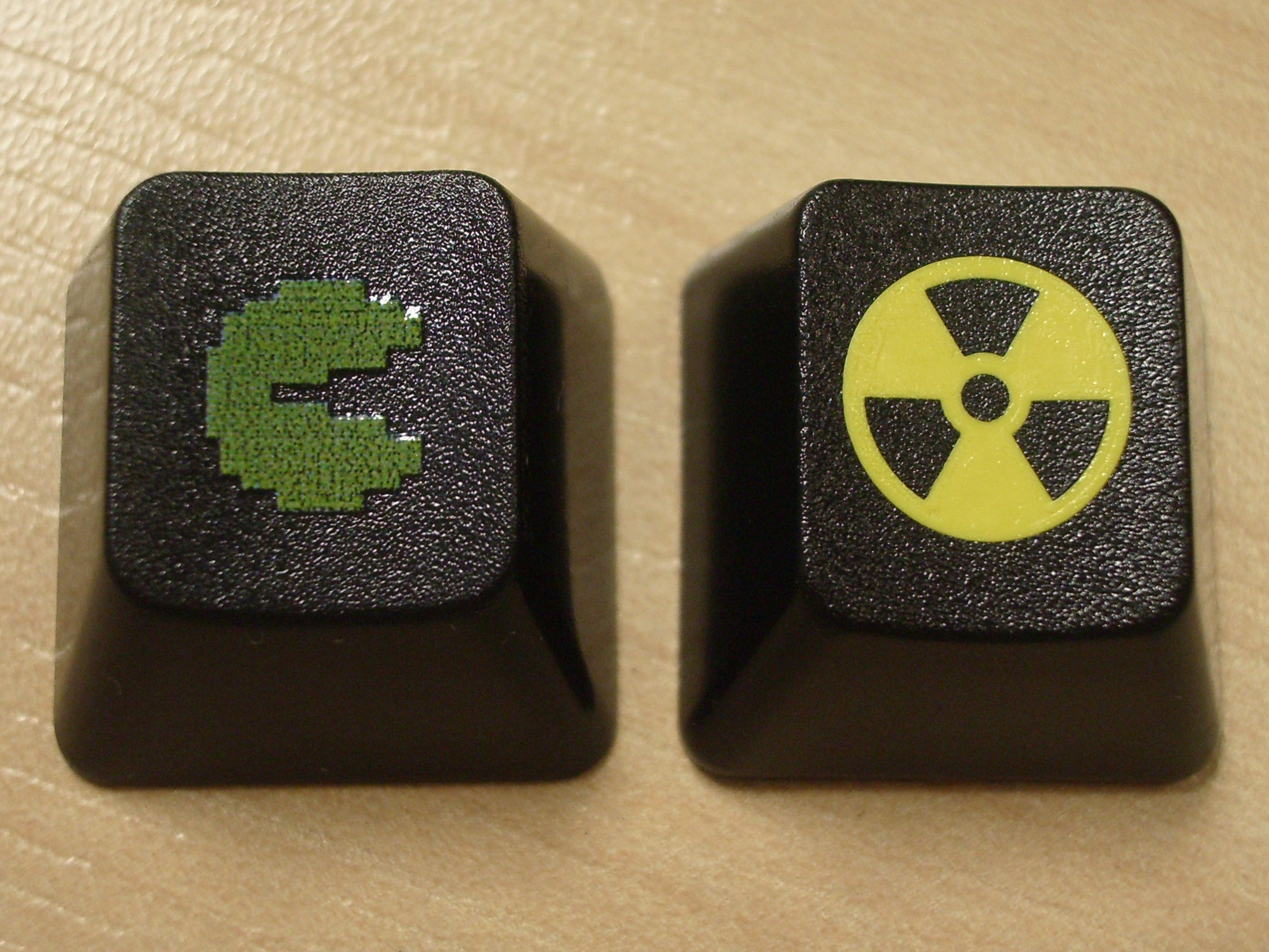

The most noticeable characteristic is that the printing is really dark. The following picture compares a QWERkeys dye-sub Pac-Man keycap side-by-side with a Signature Plastics double-shot "nuke" keycap; even if we ignore the fact that QWERkeys forgot what colour Pac-Man is (both of mine that should be yellow, are green) you can just how dark the colours are:
Comparison with doubleshot.jpg (529.09 KiB) Viewed 3497 times

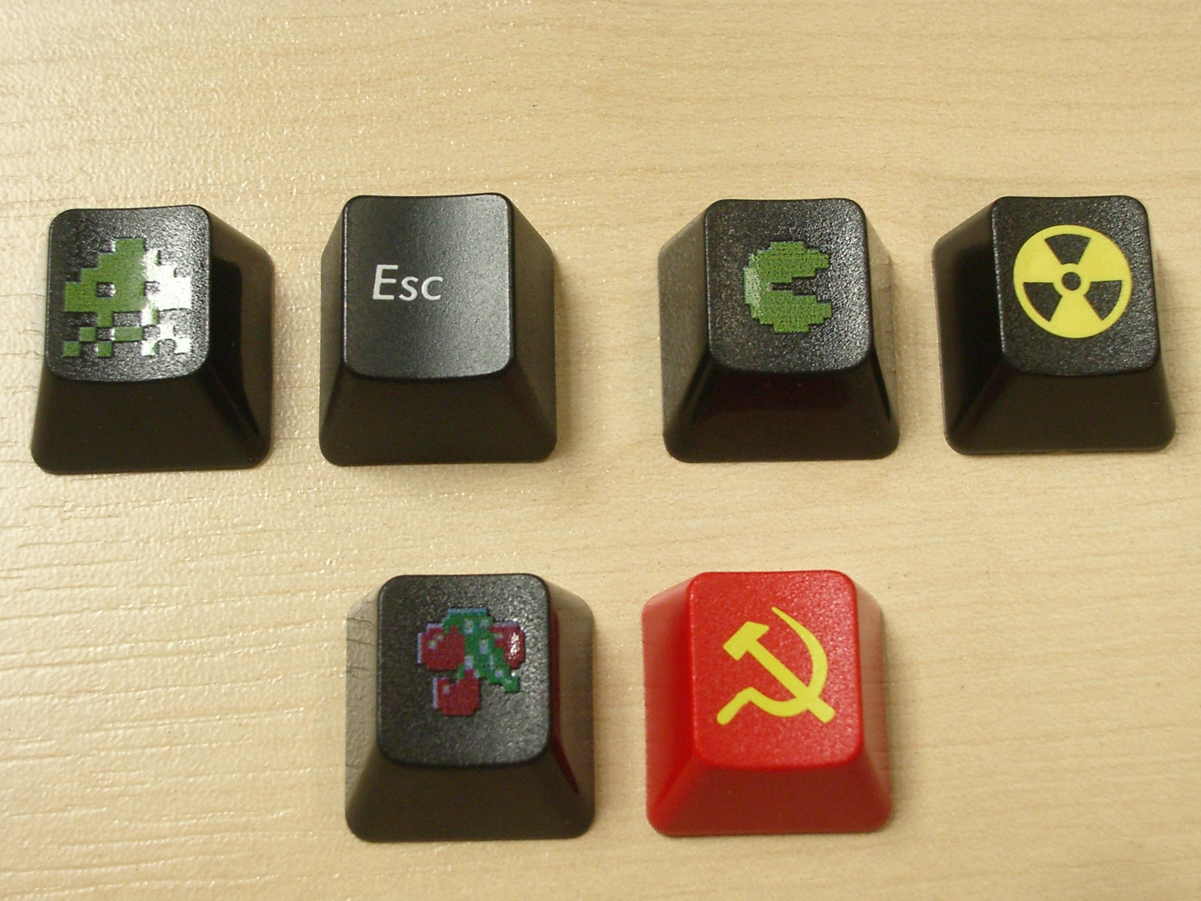

Here's an overall shot comparing Filco pad printing, QWERkeys dye-sub and Signature Plastics double-shot; these photos taken without the flash (on the fake wood background) are far more indicative of the dull colours than those taken with the flash (white background):
Comparison with doubleshot II.jpg (544.47 KiB) Viewed 3497 times
I knew from the outset that the final product would not be as bright and sharp as the mock-up photos. The yellow colour in the samples nubbinator received isn't too bad, except I got green instead.
The technology is new, and hopefully in the future we will see it improve to the point that it can start to approach the vibrant colours offered by double-shot moulding, and without the painful distraction of the ultra-gloss printing.
As they stand, I've written them off as a dud, and they won't be going on my Poker II when it arrives, as I was planning. The legends are just too hard to see under normal lighting, and far too blotchy.

Thanks for taking your time to review them!
These were initially organised through Sleabo, so I don't know a huge amount about them, but I have heard they don't come out that well on darker key caps, although I must say yours do look very odd! Maybe the white pad was missed off? Anyway, to make it up to you, let me know how much they set you back and I'll give you store credit to match it!
30 Jan 2014, 00:23
The white is there; you can see it in the "cherry" keycap. The white base is just way too dark.
I don't know why the yellow designs changed to green though — they were the correct shade of yellow in nubbinator's samples.
