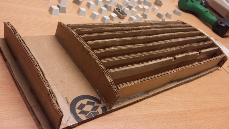

I'd like some pictures of that cardboard jig you're using when removing the plastic rivets.

Here ya go! I was thinking about making one out of plastic at some point, but this one is so sturdy and the cardboard doesn't scuff anything that I don't think I'll bother.Daemon Raccoon wrote:I'd like some pictures of that cardboard jig you're using when removing the plastic rivets.
I do need to make some rows for the number pad section eventually. It's not a big deal but it kind of bothers me since it's not "finished".

Thanks, now to try making one for myself.

No prob! Just trace the curve of the plate and mark where the rows need to sit in between the barrels, and make sure they follow the same angle. I used some good double walled cardboard, but my first revision was made out of some single-walled and worked pretty decent. Let us know how it turns out!Daemon Raccoon wrote:Thanks, now to try making one for myself.
