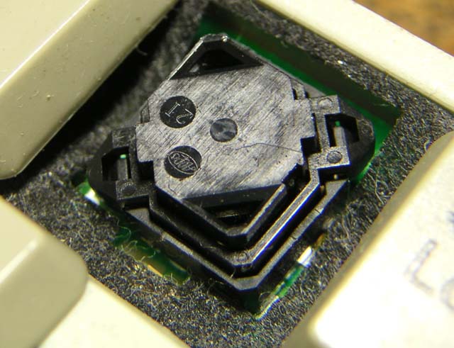

Not sure which Alps switches you're referring to. This is Alps's answer to Cherry ML:
[wiki]Alps ultra low profile[/wiki]
Clicky, too, but that is the only time that they have ever been seen. That's a 1992 keyboard, and the switches are not in the Alps 1994 catalogue. Too bad that I would have to fly out to some remote part of Japan to get to try them out!
Personally I consider the tactility in Cherry ML to be more than adequate; the problem is the scrapy sound and feel you get from them.
