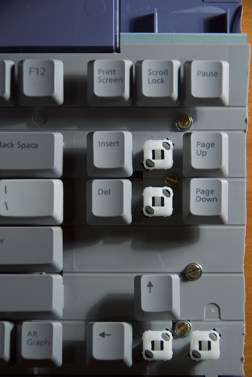

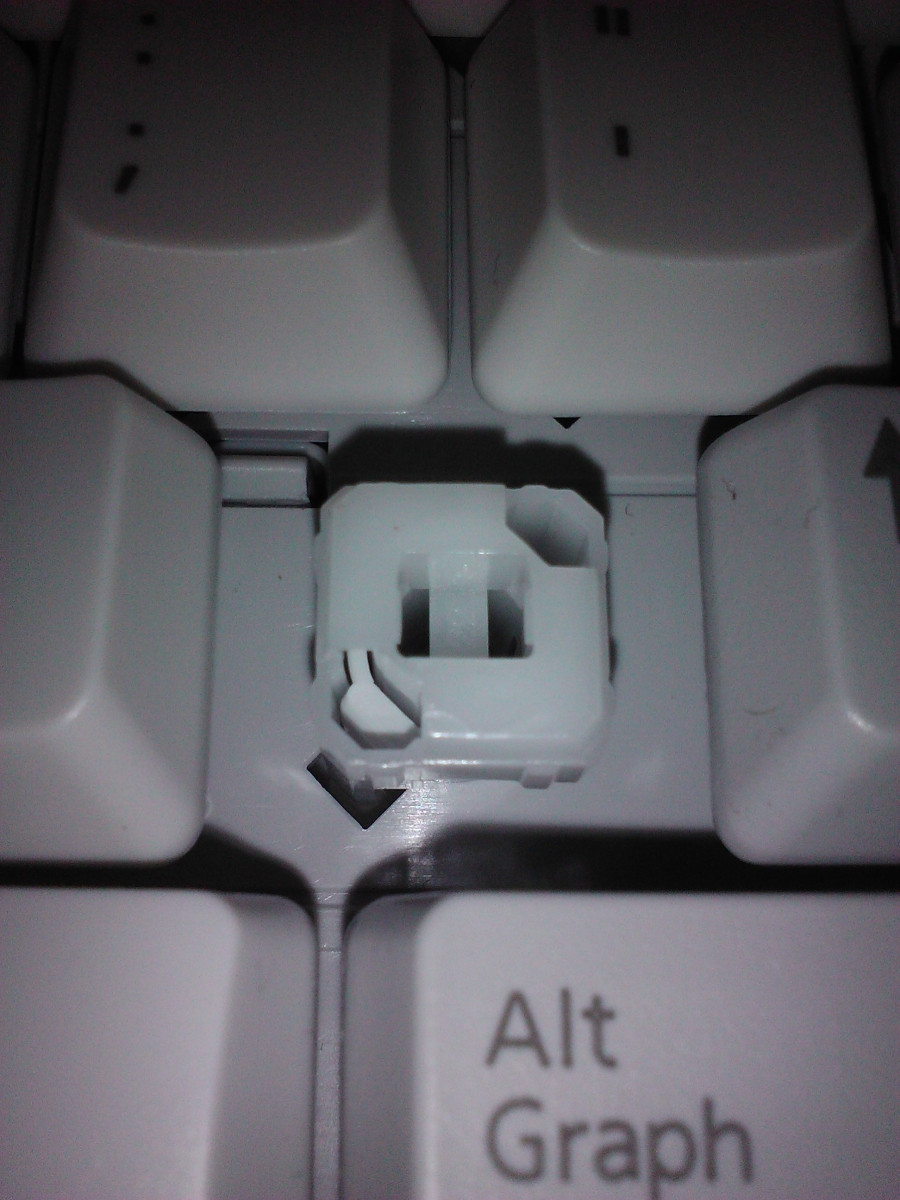

from what i can see it looks like they are all fujitsu, however you are correct that the led keys are different and am not sure abt the stabs
i found a shot from ripsters page, etc. of a sun with fujitsu switches
i don't know if the type 5 are pbt, ds or not but they sure look nice
thank you- you have been a great source of info
- sun type 6 switch.jpg (172.4 KiB) Viewed 6433 times
- sun type 5-6 keyboard swirch.jpg (215.83 KiB) Viewed 6433 times
