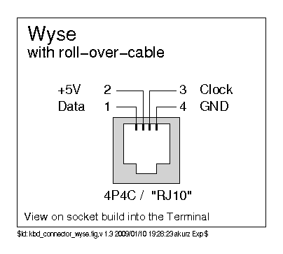

Note: this is looking at the front of the socket that you might fit to your converter. The socket on the keyboard (for those with a removable cable) is a mirror image of this diagram; the cable is wired as a 'cross-over' type.

wikipedia modular connector wrote:The 4P4C connector, is popularly, but incorrectly, called RJ22, RJ10, or RJ9. It is also commonly referred to as a handset connector because the most popular usage for the connector is to terminate both ends of a handset cord and it is the de facto standard for this application.
So, for the models with a removable cable, if you need a replacement cable, or want to hack a cable to make the converter, handset cables are easy to find and cheap.

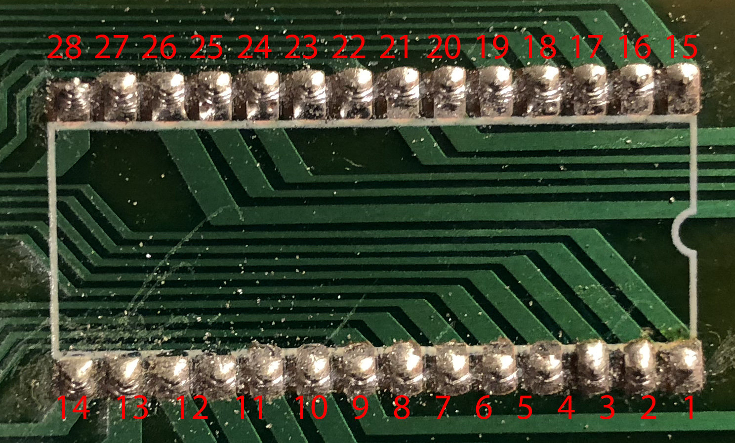

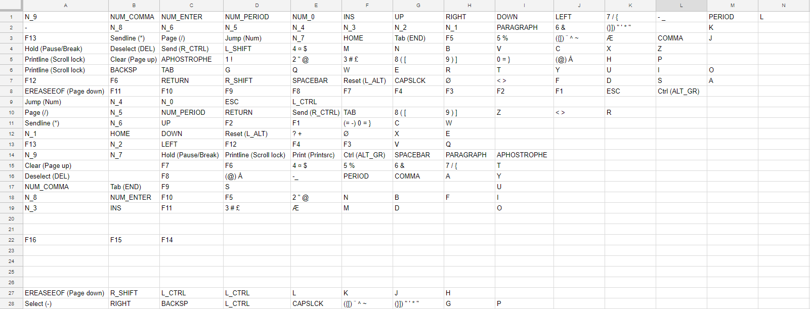

Alright, here I am again with yet another bunch of overly complex questions since I really don't know what I'm doing..
So I took my sweet time, pulled out the multimeter, and tried tracing each of the two contact points (solder points) of each switch to see what pin they were connected to.
I mapped everything out in a spreadsheet, where the rows correspond to the number on the pins:
Picture of the underside of the chip, for reference (please ignore the "lead dust"):
Questions:
1. Did I do this correctly?
2. Should I get contact twice on every switch? At least one (N_0) only registered once, but a lot of the other switches registered twice.
3. Now.. where do I go from here? How do I turn this into a working config file?
zrrion
10 Nov 2018, 23:58
What you should do probably is start a new thread, since it is looking like you won't be using Soarer's converter. (unless someone adds that board to the converter)
For your immediate question, you should notate which solder point on the switch goes to what pin. That way you can figure out what the rows and columns are. Once you know the rows/columns you can desolder that controller chip, wire a teensey up, and flash it with TMK or something.
