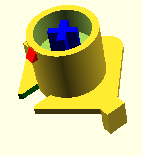

If you haven't tried OpenSCAD yet, this part would be a prime example for some experiments with it: I whipped up some crude code which should be fairly configurable, and find it a lot easier to prototypes that way than with blender, too, as much as I like it for more complicated and free-form designs.
OpenSCAD model
OpenSCAD model
Hopefully your new models work out better, but judging from the size of the MX stem which should be 4x1mm² the dent and rim looks awfully thin for 3D printing - maybe the geometry could be changed in a few places?
 *  OpenSCAD model of MX caps to topre slider based on image from matt3o :
 *      http://deskthority.net/workshop-f7/topre-sliders-mx-caps-t7437.html
 *  2014-02-11 suka @ deskthority
 *  All sizes are on estimates from above image, so most likely wrong :-)
 *  Other @todos are commented, most notably the join of the dent and the exact shape of the base cutouts tips.

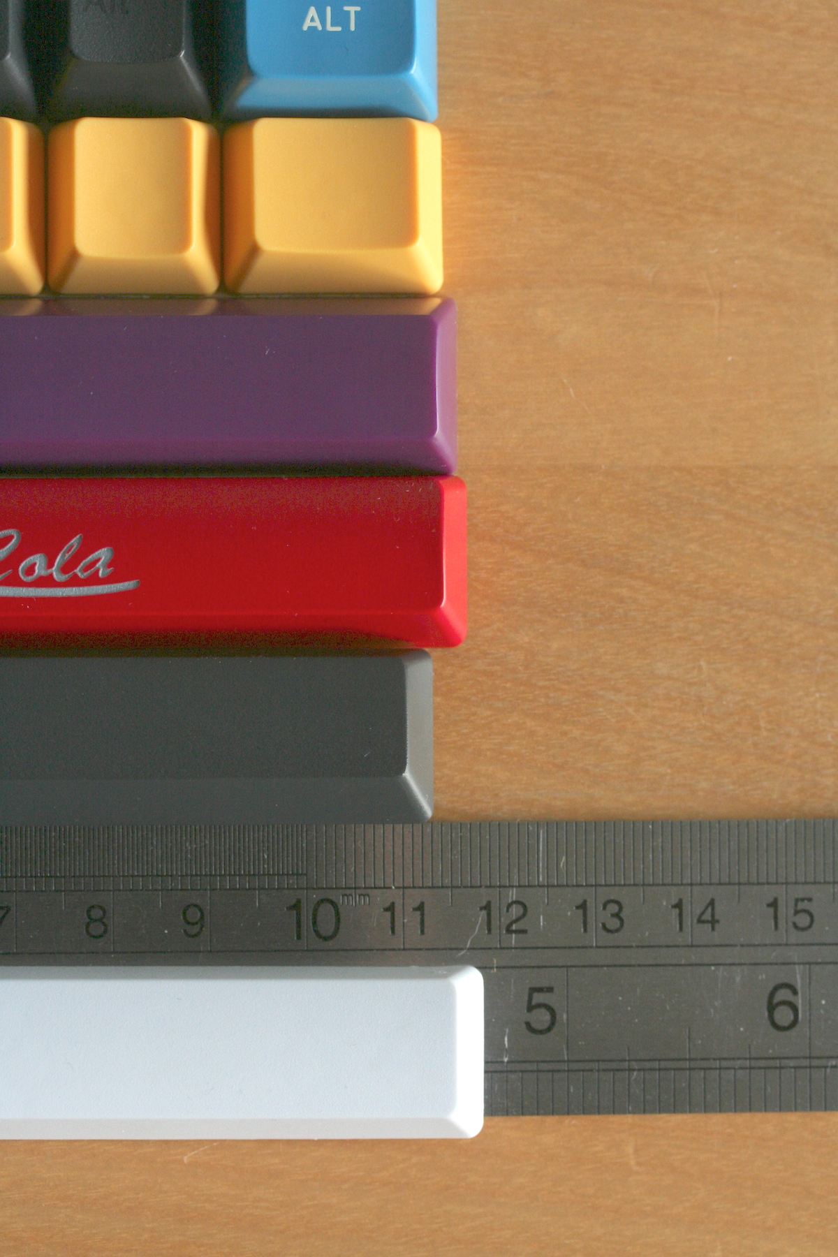

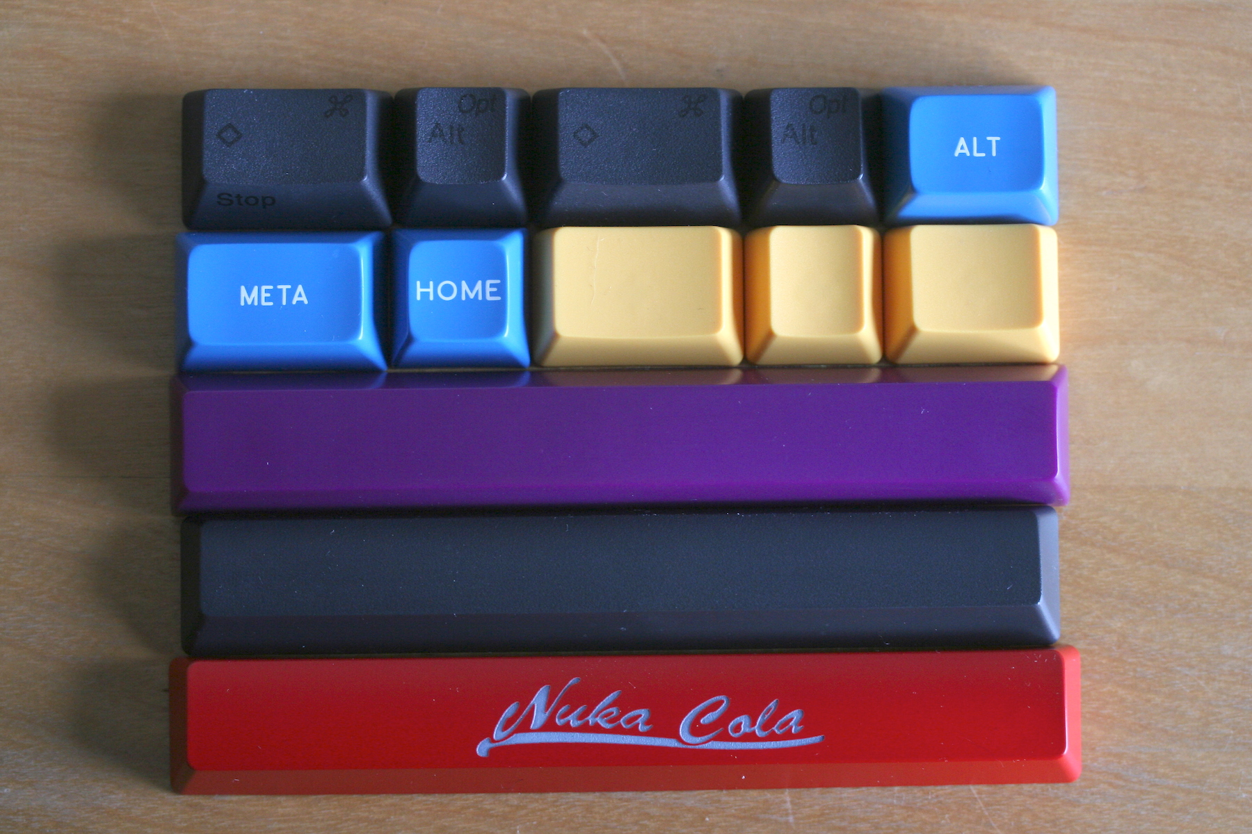

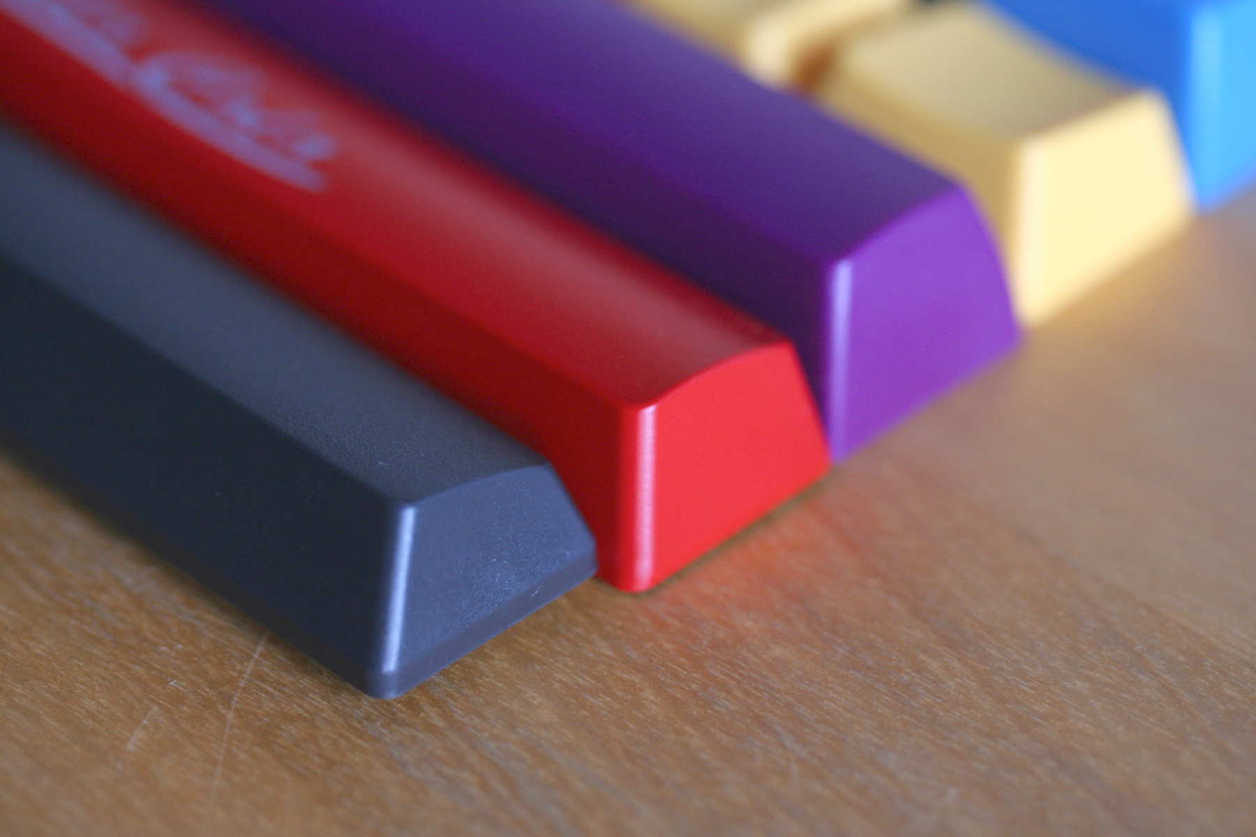

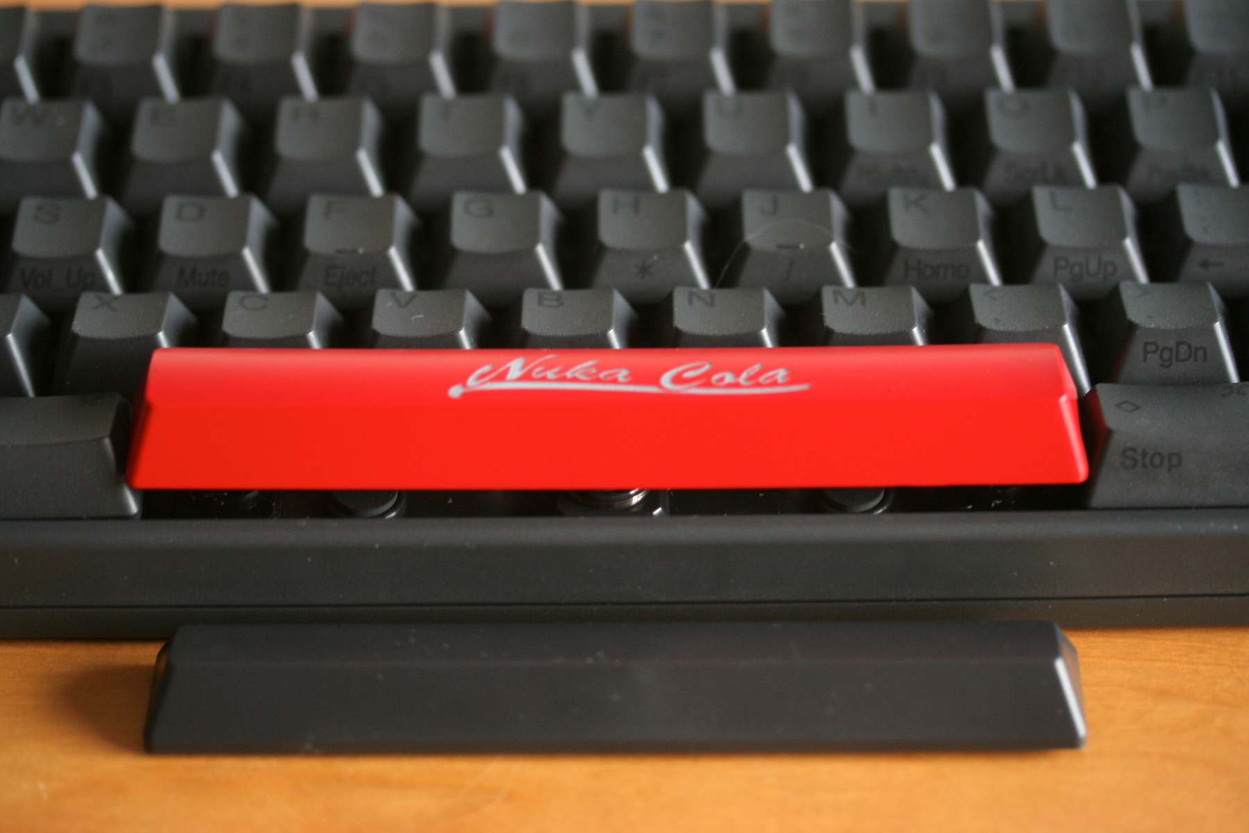

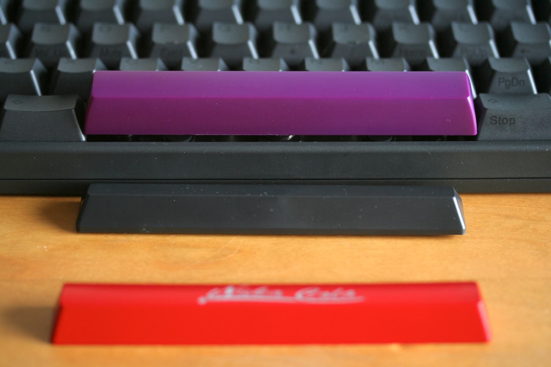

Have you still got an HHKB? Try a spacebar on it. I have some pictures to post of potential trouble for this.
Ichigo87
18 Feb 2014, 17:24
Awesome work, i would love to see my realforce with spherical keycaps. I see a lot of great group buy in 2014 !
18 Feb 2014, 17:41

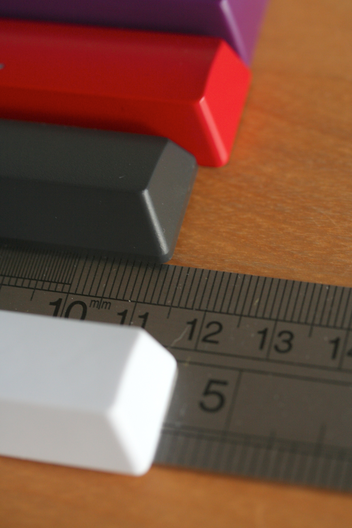

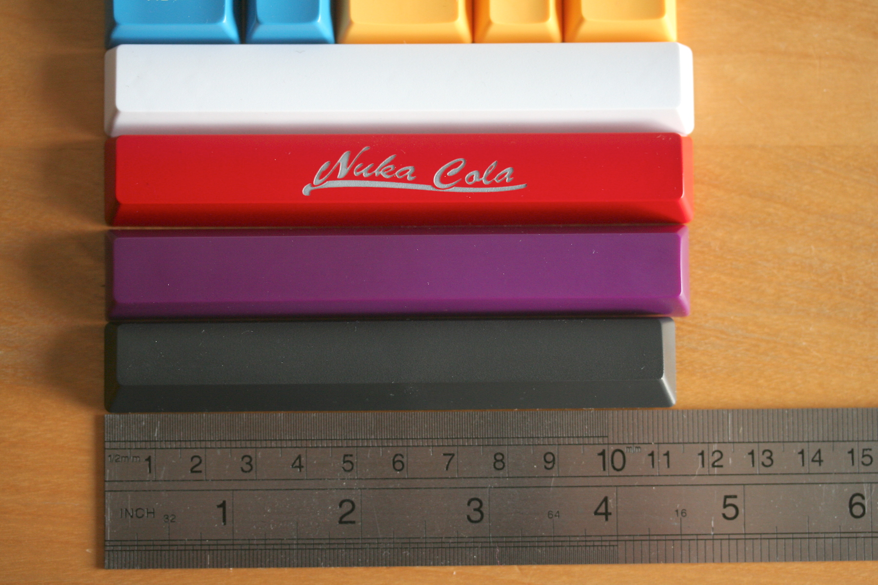

Well, watch out. Recently I proxied this HHKB Pro 2 for someone on the forum:
And I took the opportunity to compare caps. The blue caps are SA R4 SPH, the yellows are OEM profile Ducky PBT, and the black caps are the HHKB's.
The little ones are fine, they seem to be based on the same units. But look at the space bars. The purple one is Round 4 SPH and the red is a custom creation of Kayvee's, presumably OEM profile. All are 6.25 units.
The white one is another Ducky PBT space bar. It's visibly longer than all the rest of them, but not enough to be a problem in my Shine 3. But the HHKB's is a real outlier.
So what? Well, put a 6.25u MX space bar on the HHKB and…
Not. Gonna. Happen.
This seems to be a significant problem. 6.0u space bars and unsightly gaps might be the answer. But there are no 6.0s in Round 5. Anyone else with an HHKB and some space bars to try? Especially a 6.0u DSA.
-[°_°]-
18 Feb 2014, 17:52
I would state the obvious but... HHKB is 6u, you can't fit a 6.25 in a 6u :) That's why you need Skull Squadron set :) (or DSA retro)
SP calls all its spacebars 6.2u (not 6.25) I don't know if it's just for brevity or if the spacebars are really a pinch smaller, but from your pictures it seems they are actually smaller. Anyway the bottom line is, if you see a DSA set with a 6u spacebar you should take it. Just saying...
ماء
18 Feb 2014, 17:54
Really nice translucent stems 8-) matt30 are ahead CM now :lol:
i want see plugged on RF... :P may with DSA retro 8-)
18 Feb 2014, 17:56
matt3o wrote:I would state the obvious but... HHKB is 6u, you can't fit a 6.25 in a 6u :) That's why you need Skull Squadron set :) (or DSA retro)
Oh right! Whoops. Call off the alarm, folks. I just didn't realise. The variation in my own 6.25u space bars fooled me.
