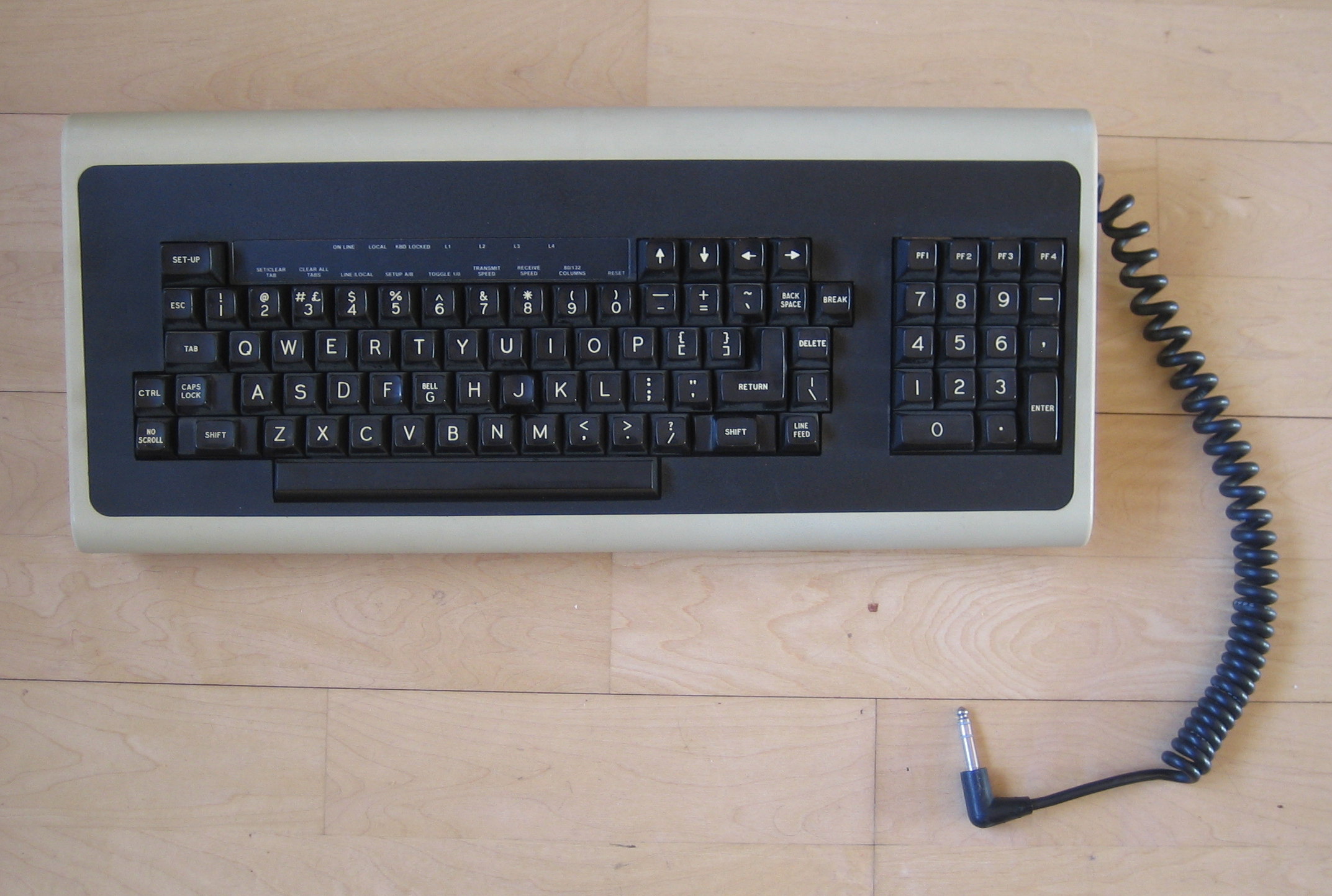

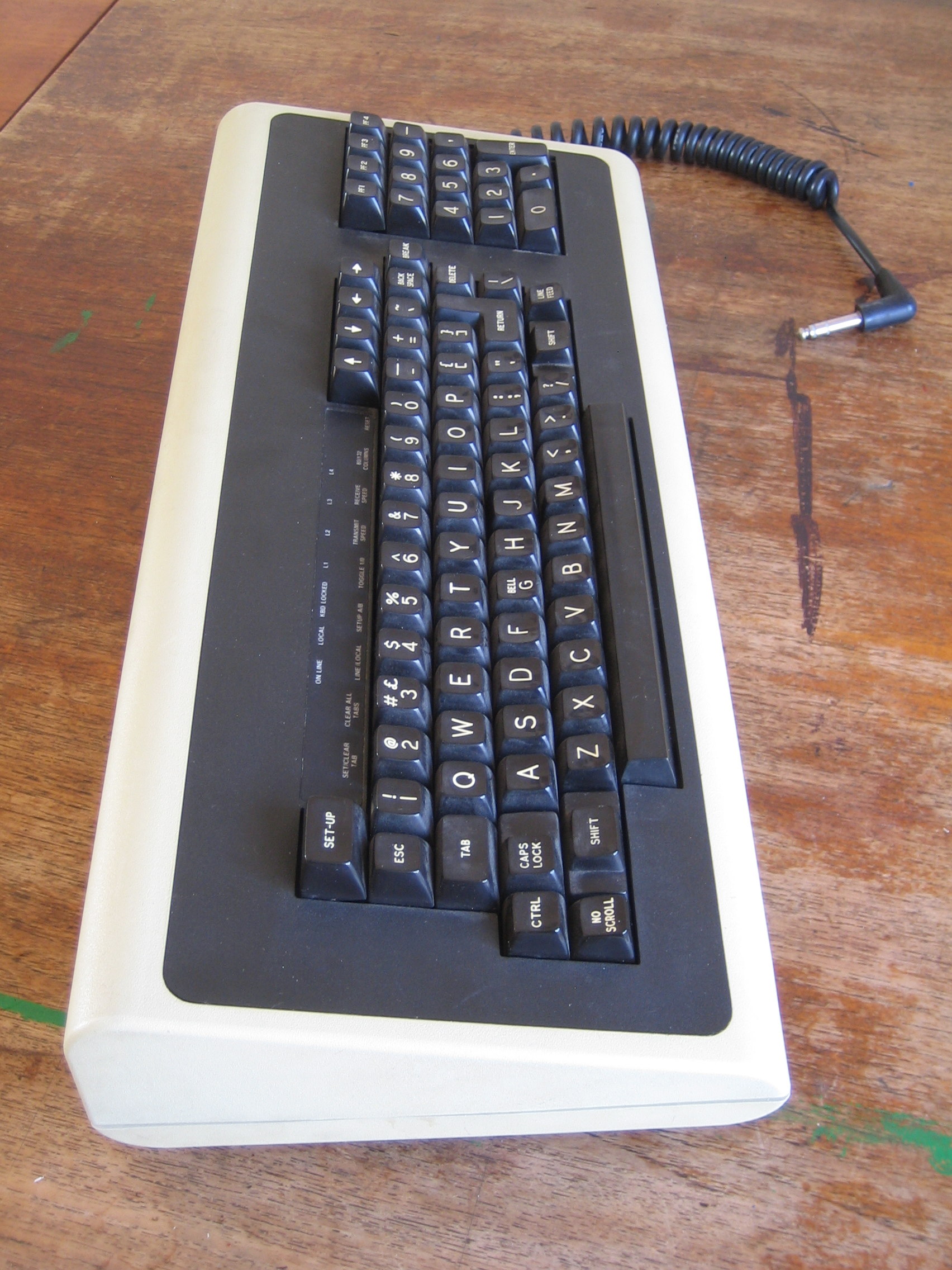

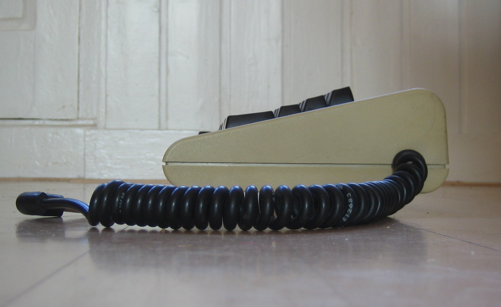

My most recent find is a DEC vt100 terminal keyboard, from I believe 1980. I keep trying to find keyboards that are a bit older than that, but that is not that easy (without spending loads of money on shipping, since such boards rarely show up on this side of the pond, for some reason). This keyboard is a classic, I really like the looks of it; great shape, nice colours, great caps. I also like the fact it has a jack-plug; there has been a project to build a converter for these boards, but I haven't gotten around to build one myself.
This particular keyboard came from a government research lab that has close relations with the military, so this binary 'cyber' code might in fact be be top secret. When connected to the terminal (or to the converter), the speaker can beep or produce extra keyclick sounds, but I have not heard those yet.

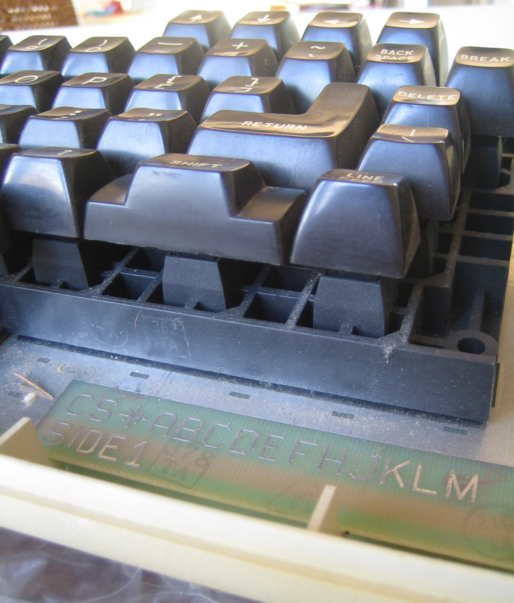

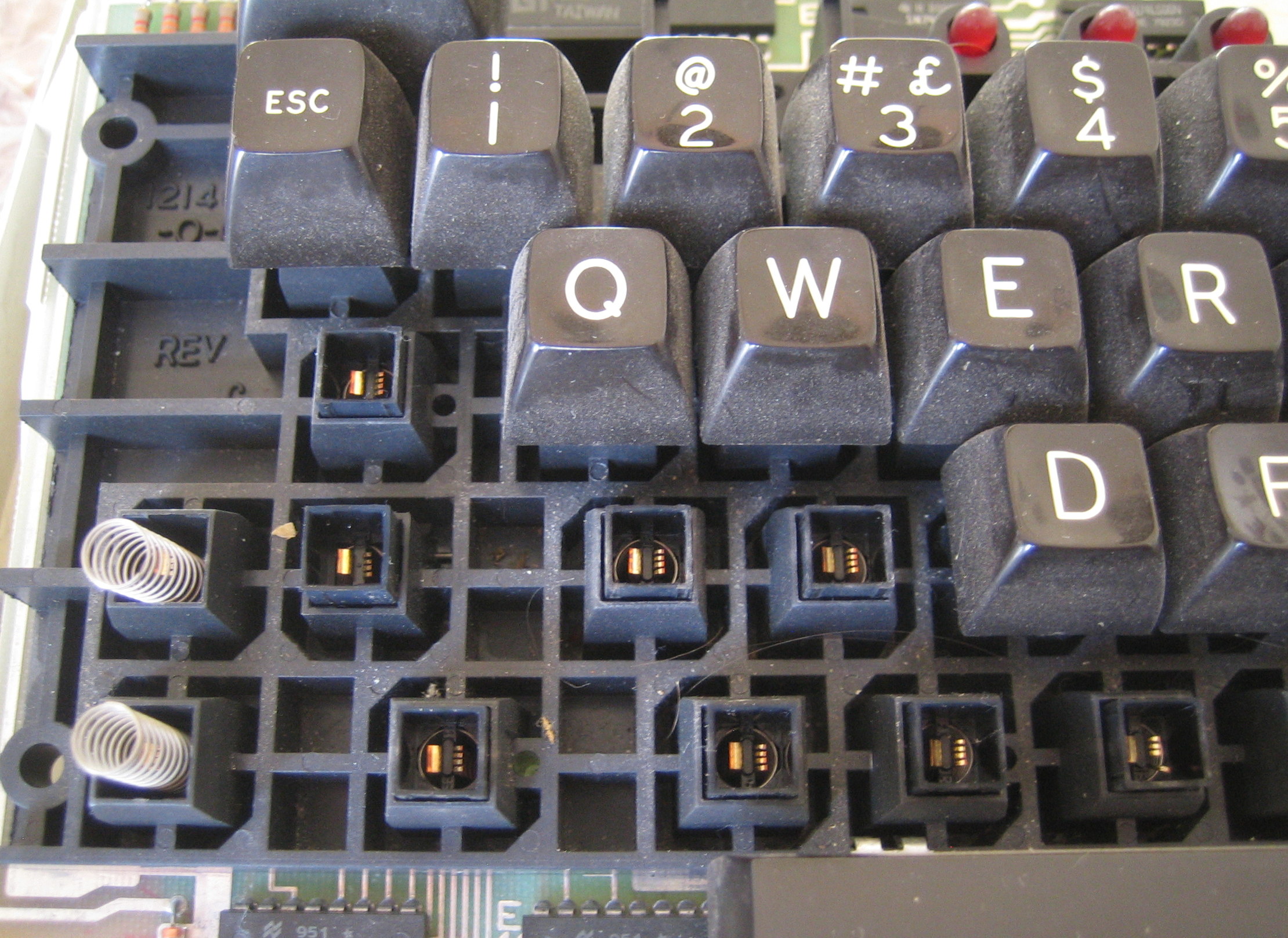

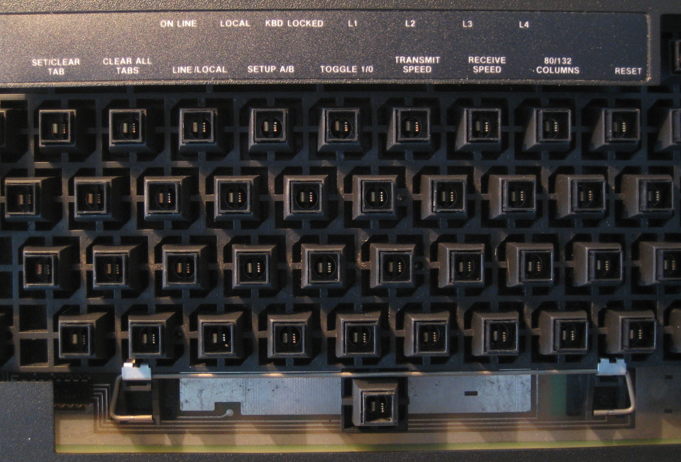

The switches are Hi-Tek Linear, in the familiar 'waffle frame' construction that seems to have been very popular indeed around 1980. So no individual switch housings, but one big plastic entity that fits all the switches. I know these switches can be very scratchy and rather unpleasant, but this keyboard seemed to have aged well: it is not my favourite switch, but it feels rather comfortable, pretty smooth, very light. Smoother and lighter than black Alps, much lighter than Cherry MX blacks, so I guess more close to Cherry MX Reds, but I don't really know those.

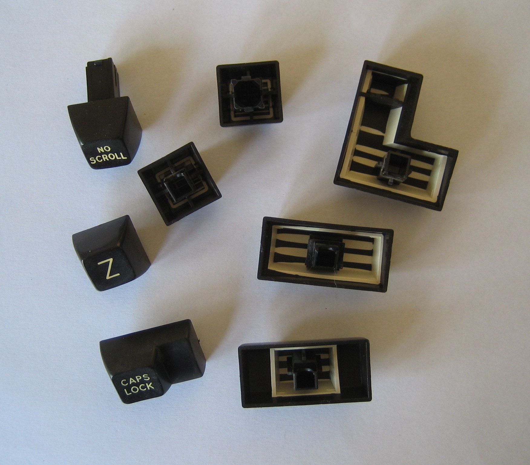

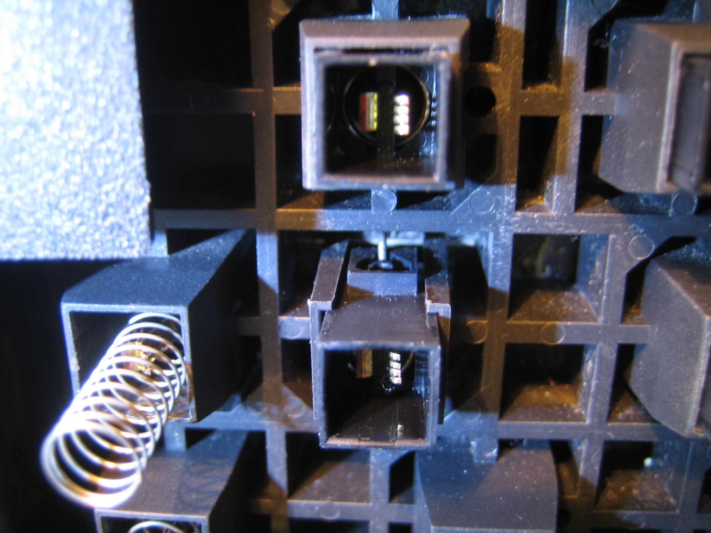

There are three types of switch on this board:
- the standard ones,
- some special switches (for ctrl, no scroll, setup etc.), with very long springs and very long stems on the keycaps, and that need a lot of force to actuate,
- a latching switch for the 'caps lock' key. See the pict below for the mechanism
The caps are beautifully tall, spherical, dark and shiny doubleshots..

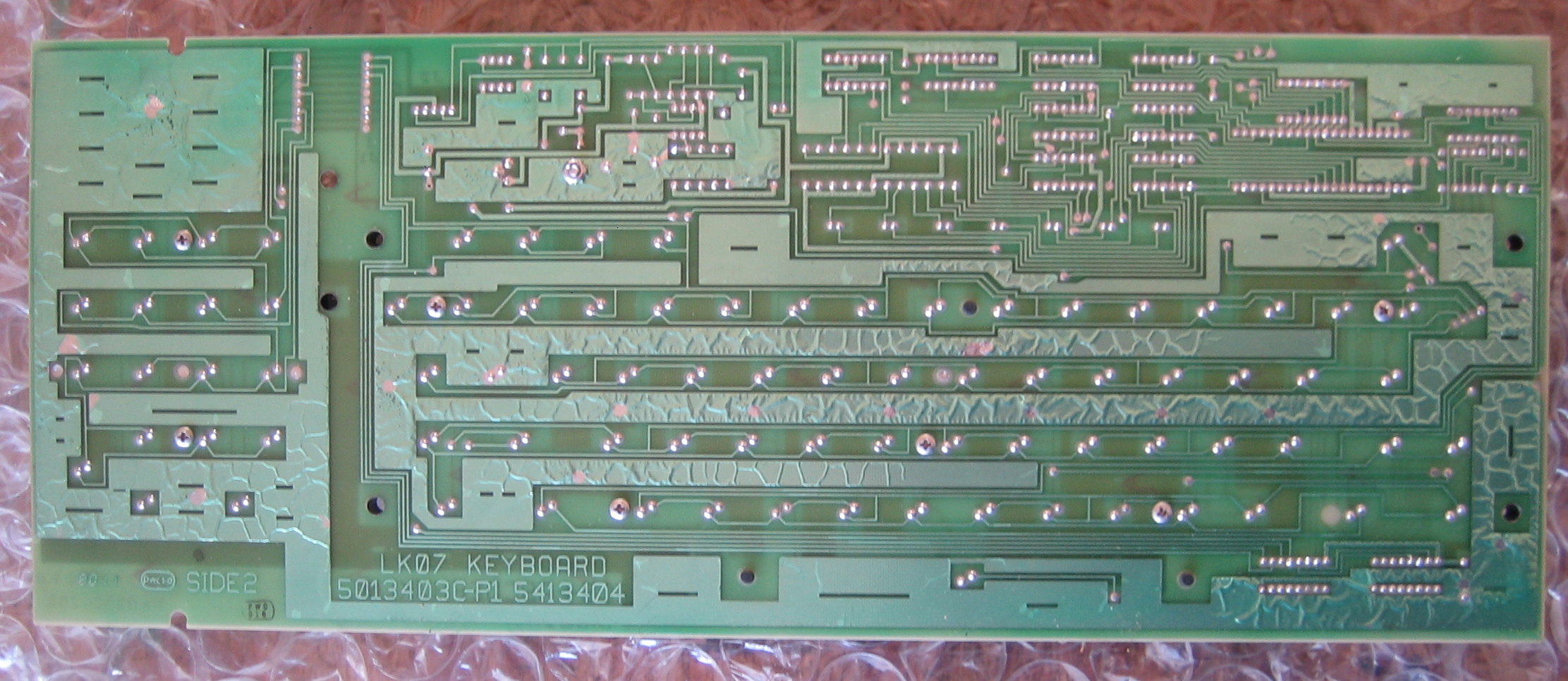

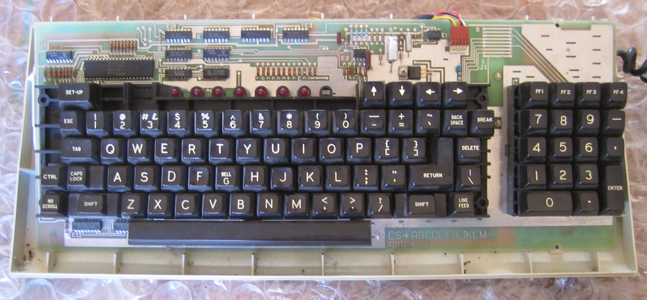

On the bottom left of the pcb it says '80' in nice futuristic lettering, so that is why I think this one is from 1980. I have the terminal too, but for now I put it in storage, since it is huge (and I am waiting for another one to arrive....).

I do indeed recognise the combo of waffle frame and the "praying hands" of Hi-Tek Linear. Seeing those two spells vintage layout and spectacular caps. Your DEC did not disappoint.

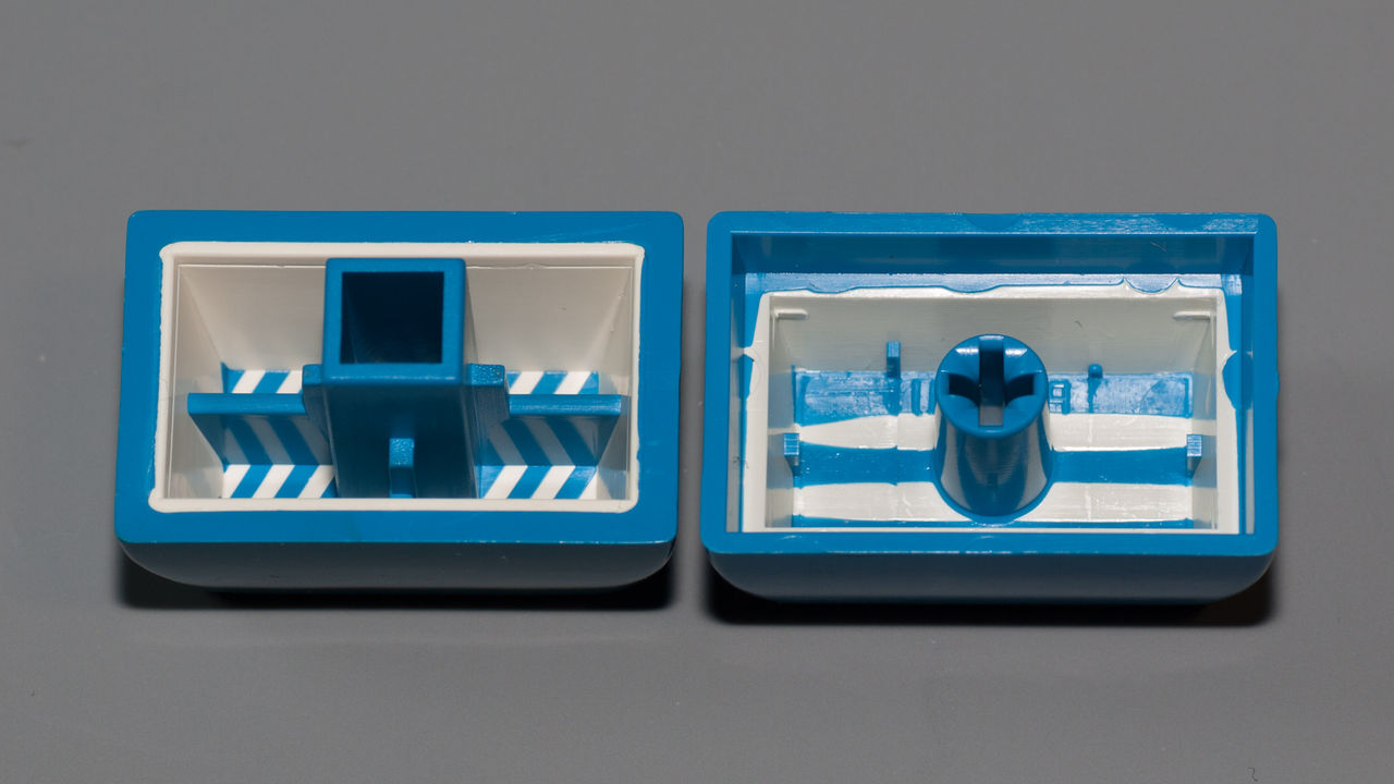

To me, these key caps look like from Signature Plastics.
07 Mar 2014, 23:55
I was hoping that a fully disassembled VT100 keyboard might yield some clues to confirm Hi-Tek and/or help recognition of Hi-Tek vs Stackpole, but not a lot there. The year done as 7-segment digits is certainly something you see on NMB Hi-Tek boards; I don't recall whether I've seen that on other brands. It's also got the little islands on the separator bars again, which are quite rare.
Interesting photo — [wiki]Perkin-Elmer 3700 keycap[/wiki] on the left, and Signature Plastics SA keycap on the right:
The VT100 keycaps above far more closely resemble the SP keycap in the photo (right). Obviously the mount stripes vary a lot, but the wall shapes are a match.
08 Mar 2014, 00:41
The black key caps look much more like SP. Dio you see those things (how are they called?) in the corners in the white section.
I also have a key cap with a similar, if not the same mount which had been erroneously produced (was in the grab bags).
08 Mar 2014, 01:04
The little ridges? Yes I see them.
I sent an e-mail to Melissa earlier, but I imagine I won't hear back until Monday now.

Here's proof that the Atari 800 Stackpole keyboard had the same low-profile structure ("waffle frame") as that of the Oric Atmos:

I got a reply from Melissa: yes, they are Comptec Incorporated keycaps; Signature Plastics was formed from a management buyout of part of Comptec.
http://www.keycapsdirect.com/aboutus.php
Comptec made keycaps for both Hi-Tek and Stackpole switches, specifically, mount type 0B.

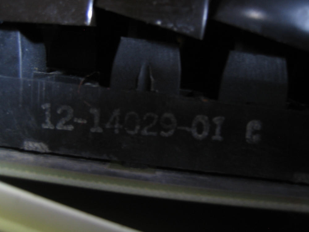

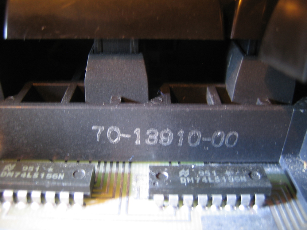

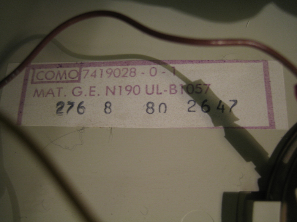

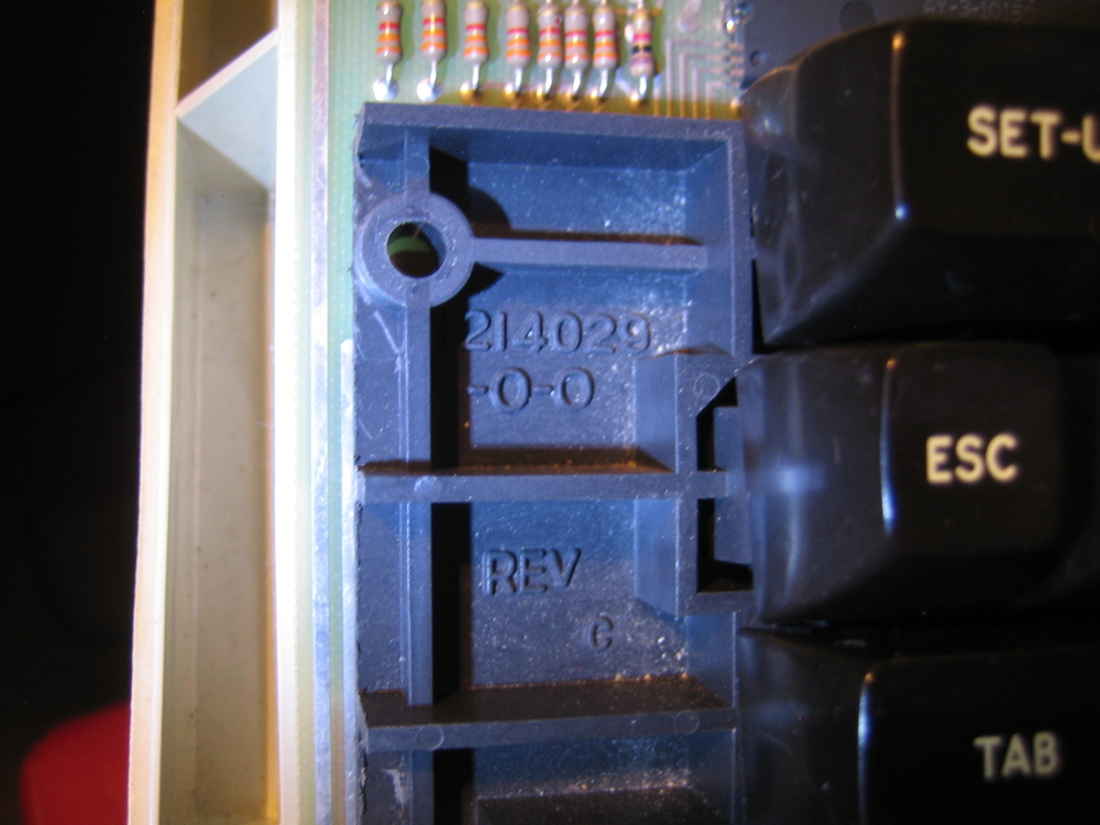

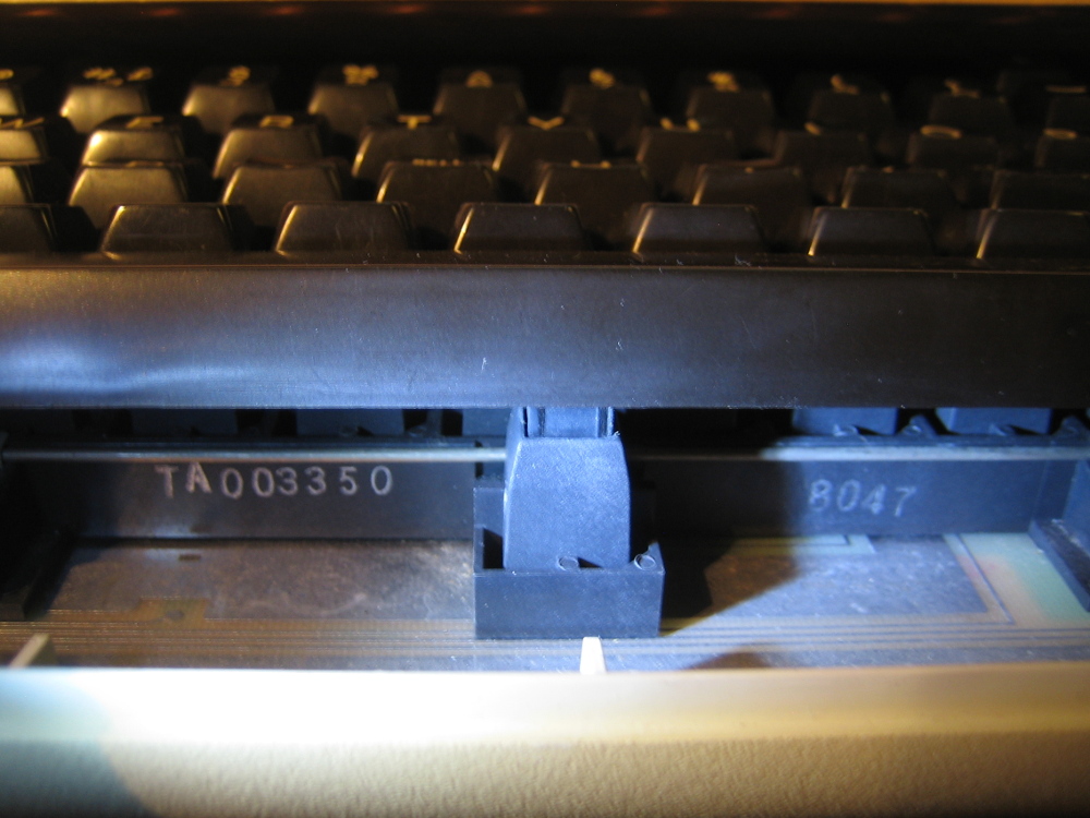

Daniel Beardsmore wrote: On this page I've posted a diagram (a page or two down) with my recognition theories:
http://deskthority.net/keyboards-f2/hi- ... t7092.html

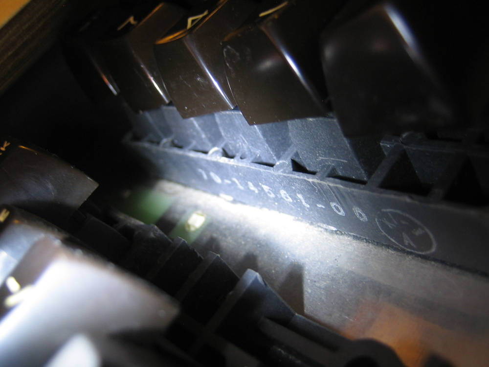

I did not find any more branding when I reopened the case of this keyboard, so I am not sure this will be of any help, but anyway some more picture with codes and serial numbers and such, covering all the alphanumeric info on that black plastic entity that holds the switches:

12 Mar 2014, 00:29
Indeed, those white numbers again. Different process this time, it appears — looks like they're printed on instead of engraved and infilled.
