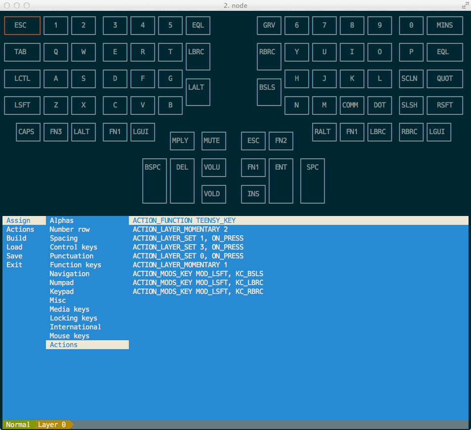

Screenshot of it's current state:
vikeys
vikeys

Right now you can't edit actions, that's what i'm working on at the moment.
It will be possible to construct any kind of action, such as macros and all types of layer functionality. If you look at the screenshot you can see the list of actions that were parsed from the .h file, the plan is to make them editable and have a way to add/delete.

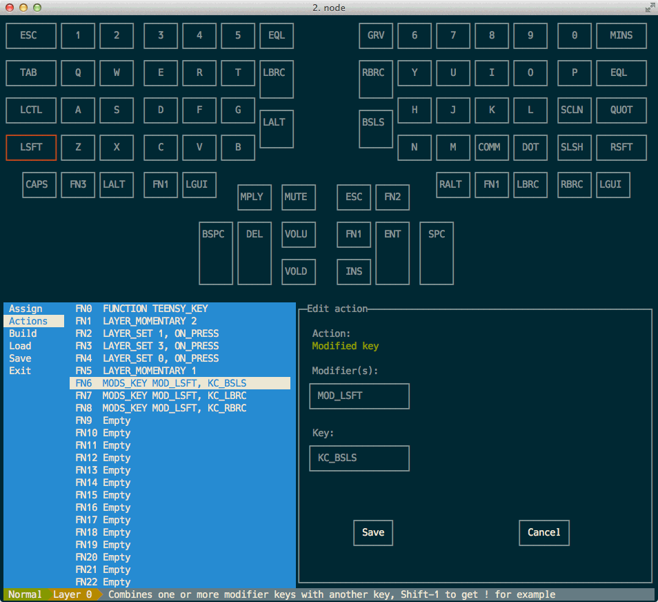

Here's the current state:
Vikeys 0.0.7
Vikeys 0.0.7
