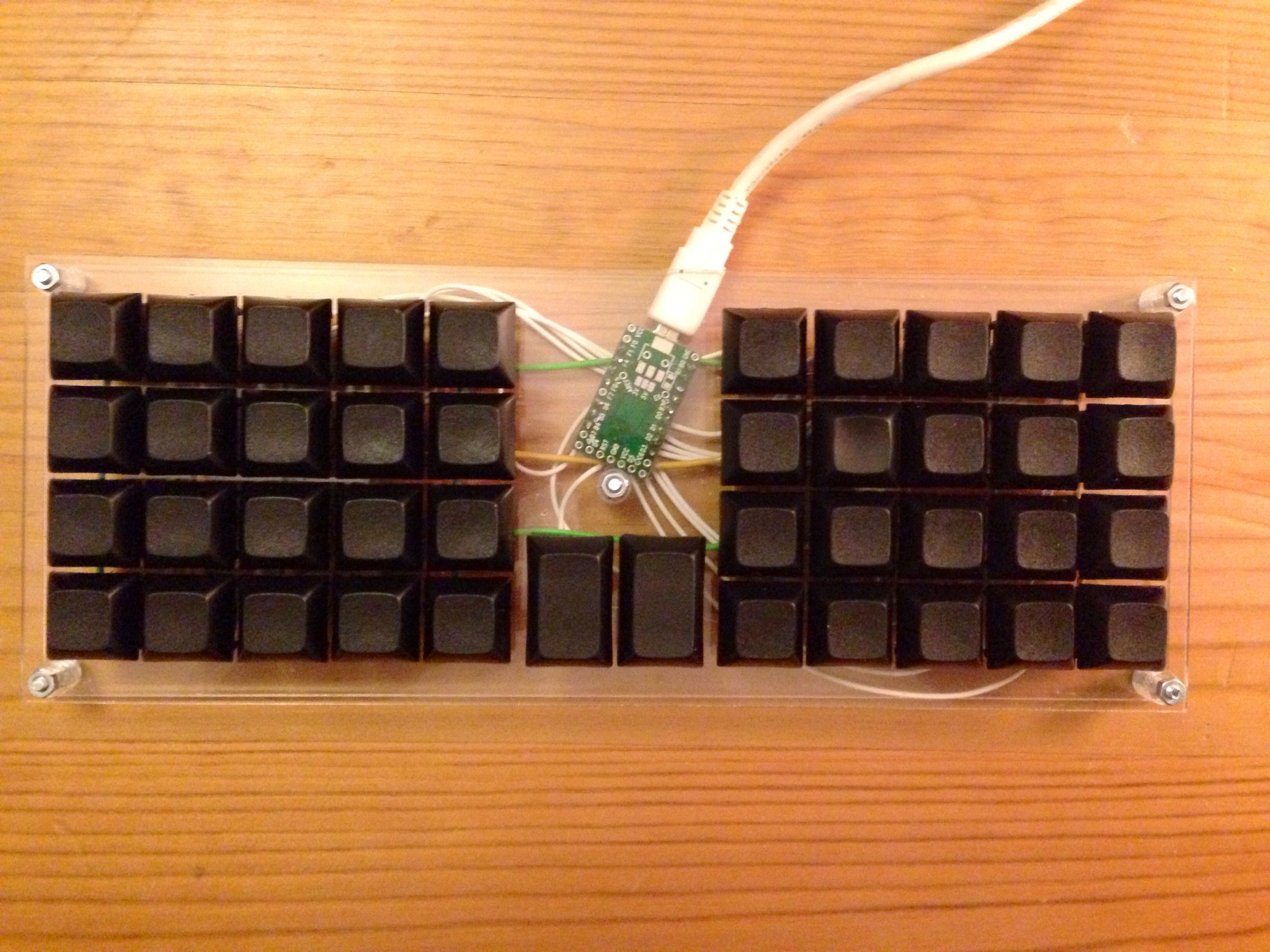

It's a "40%" keyboard heavly inspired by JDCarpe's creation over at geek hack and technomancy's Atreus, 40% column-staggered.
It's MX Black switches with DSA Blank caps. The case is lasercut 2mm XT acrylic. And it's controlled by a Teensy 2.0 with Hasu's keyboard firmware.
I finished it yesterday, and have only typed on it a bit, but so far so gooooood, I like the ultra compact feeling. The only downside is Im not a big fan of MX Blacks..
If you have any question, flame, critic or any thing else, just post or PM me.

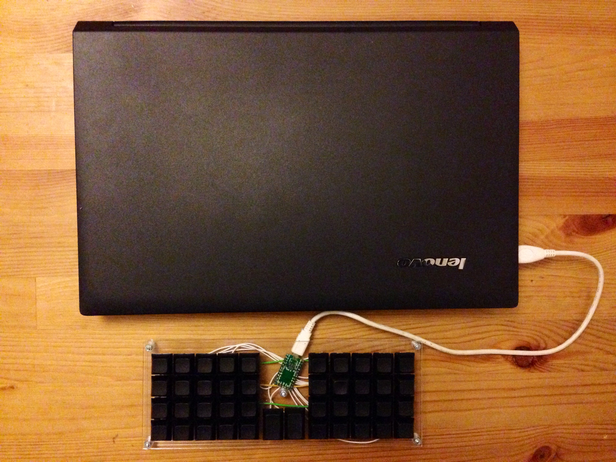

and compared to my 15" Lenovo laptop:

Welcome to the madhouse.
Your "Teensy Inside" look is quite novel. I'd mount the socket straight, because I'm like that (and often tug wires). How are you finding the feel? MX blacks could well be a bit heavy, especially in an acrylic plate.
I'd call your layout more like a mini ErgoDox. Thought of splitting the design in two pieces for greater separation?

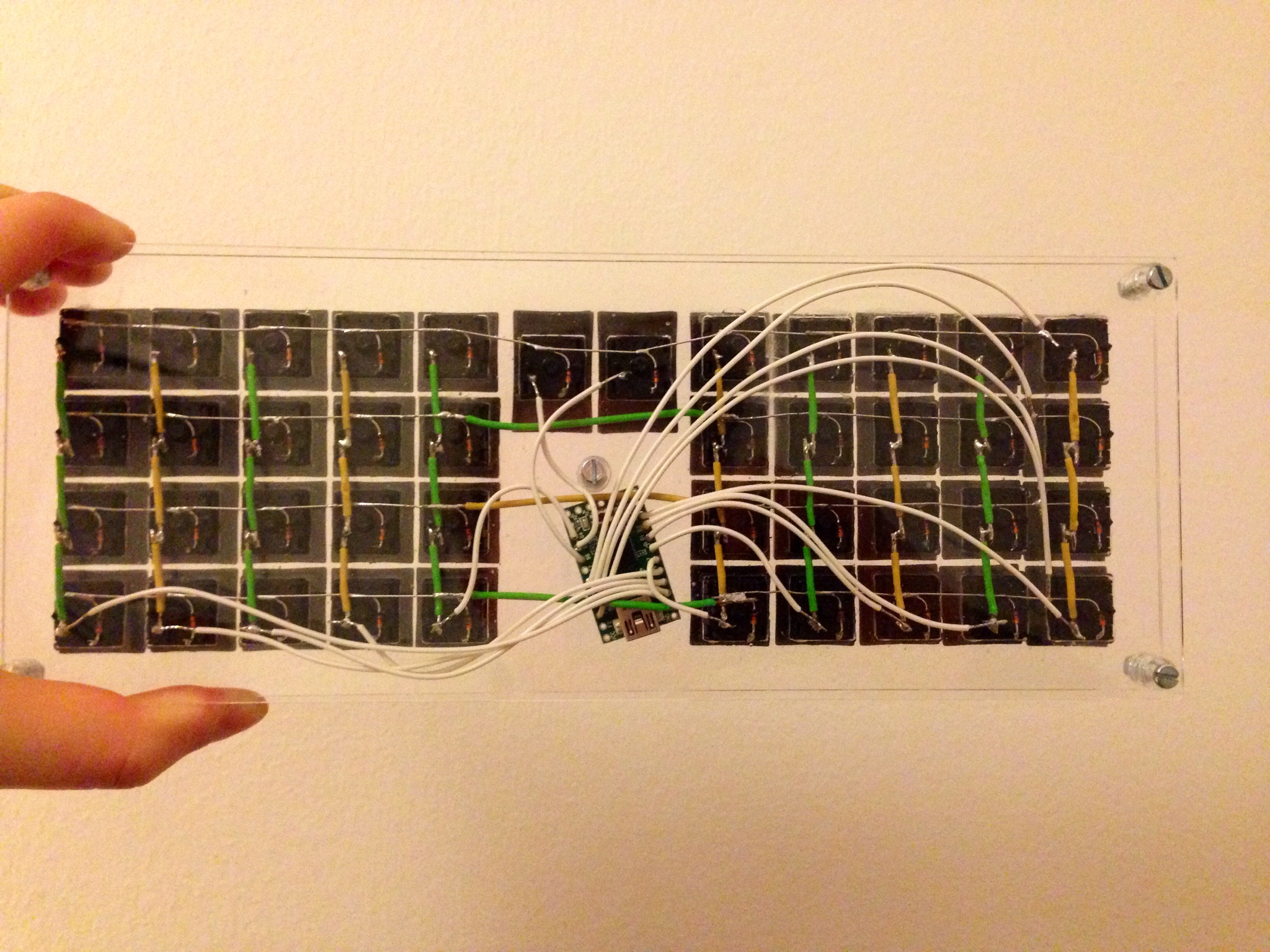

Congratulations, a very clean looking board, especially from the underside. Is the teensy floating by the wires only? And what's your next project :-) ?
cowfoot1
11 Mar 2014, 12:29
One should make a "Teensy Inside" sticker :)
I would like to have mounted the teensy better, and straight. But right now it only keept in place by the wires..
The MX blacks is a bit too heavy for me, might be in the combination with acrylic plate. Im also coming from MX browns, and love them.
I thought about doing a split design, but decided that if would be a bit to much for a first project. But I might do it in a further project.
But my next project is probaly going to be a steel or aluminium plate for the same keyboard and maybe some MX reds.

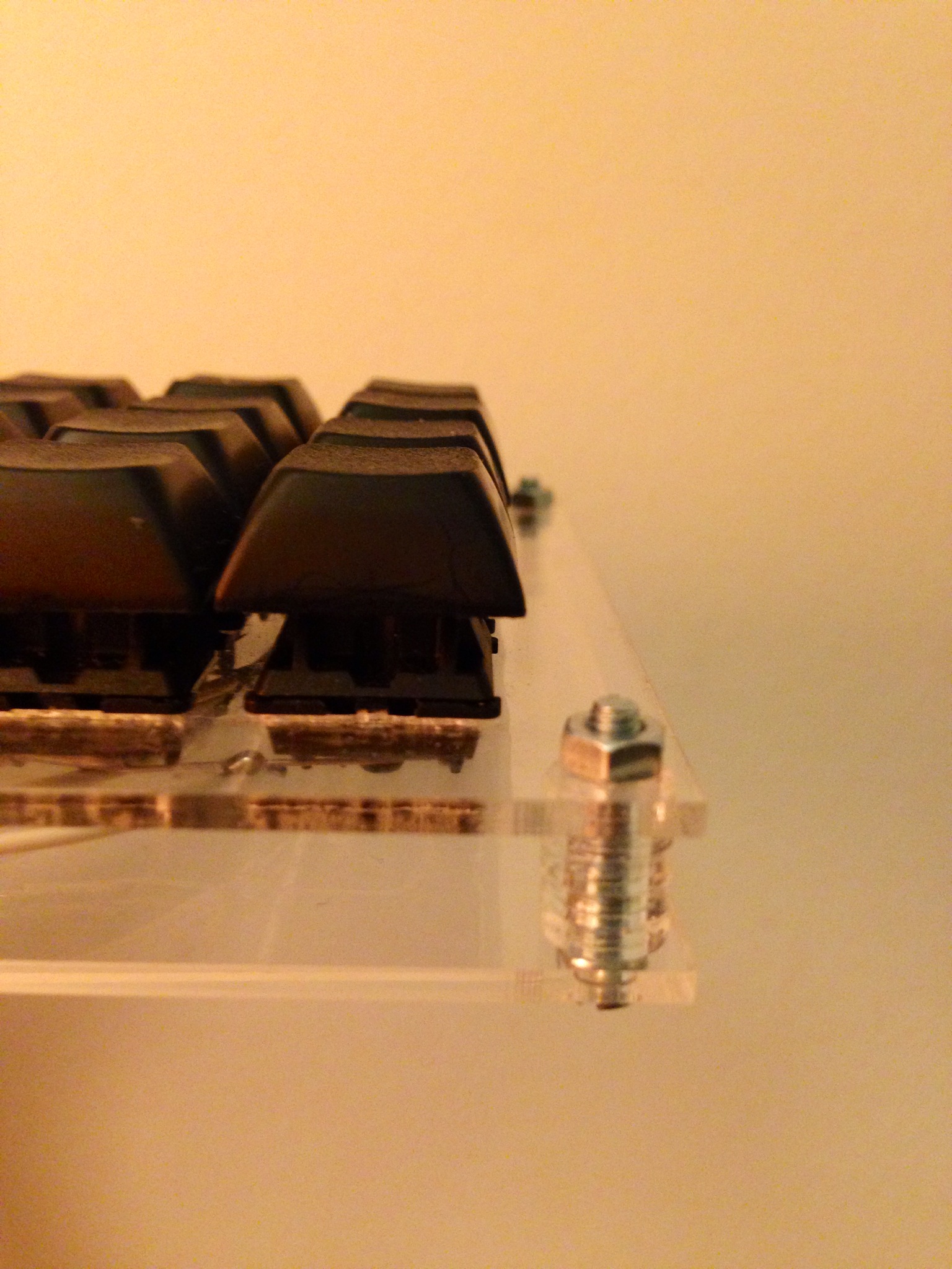

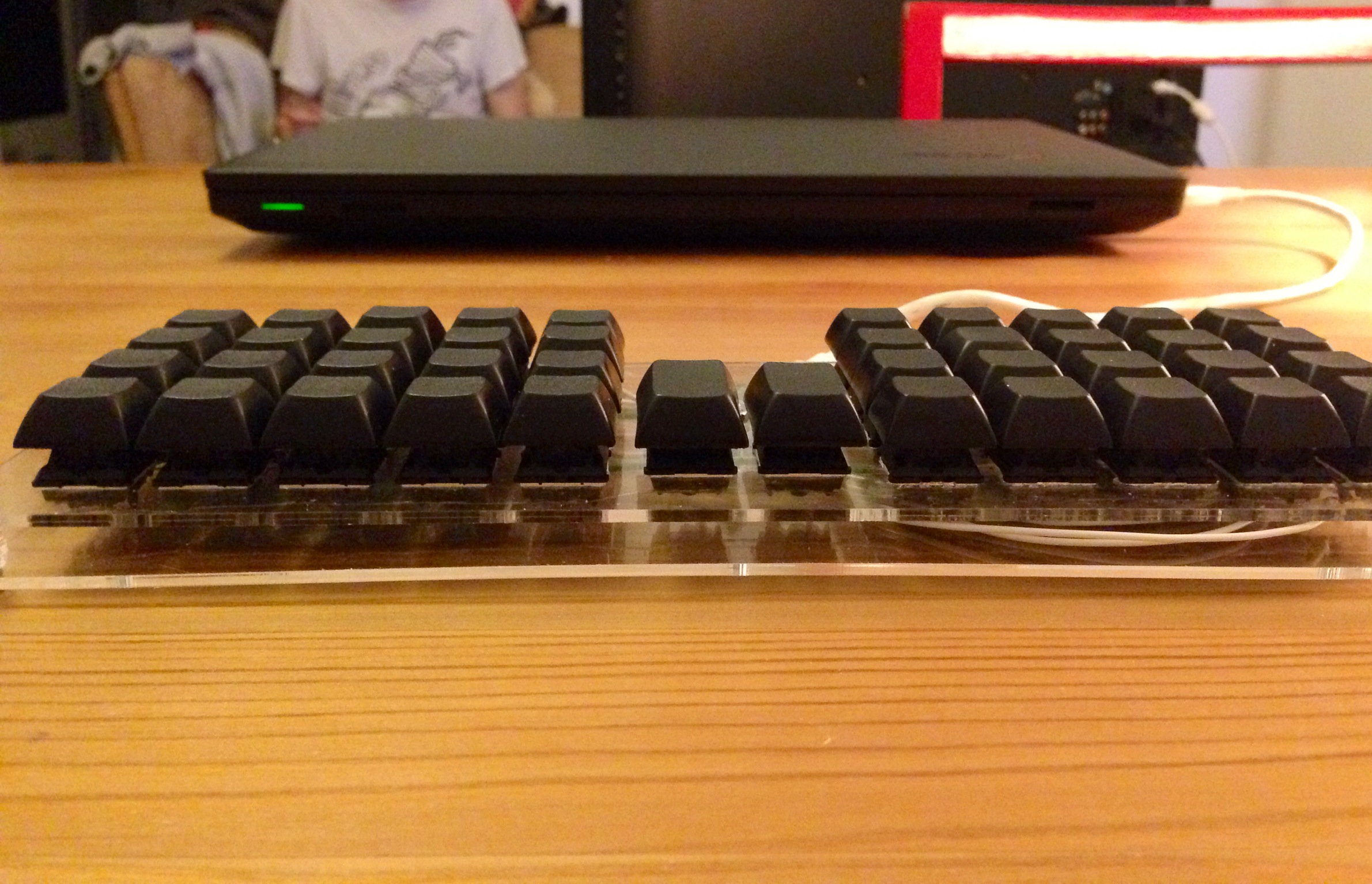

I like the simplicity of the case. Could you tell us how tall is it exactly, how much room there is for the teensy and cables inside? Doesn't it flex because of the lack of layers between the top and bottom plates?
I was also wondering if placing the switchs on the plate was any trouble? I usually see 1.5mm plates to mount switchs and not 2mm.
