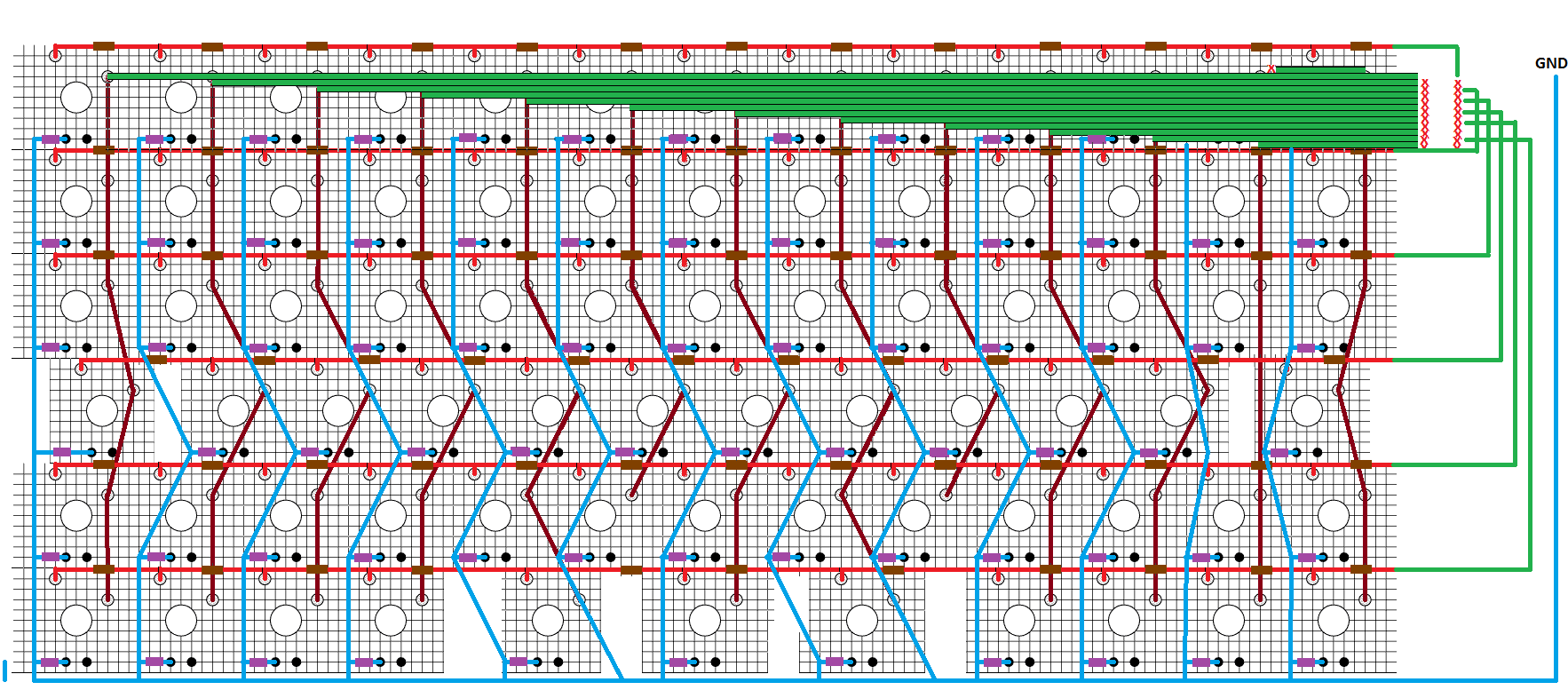

I am putting together the resources to construct a custom 60% board at the moment.
I have worked out a layout which I feel doesn't stray too far from my current keyboard usage: http://www.keyboard-layout-editor.com/# ... 39f70cf994
If you guys have any suggestions, I would love to here them.
I have a 3d model for the plate (which incorporates a cavity for the wiring and space for a teensy2.0): https://tinkercad.com/things/irhM1hX1m7v (still editing the .skp that I exported this from).
The local campus library has a Makerbot 2 with an 11x6x6 printing space, and I will most likely use it to print my model with either ABS or PLA. I have two sheets of 1/16" steel which I am going to layer and use as the bottom plate.
When I am done, I will post a full build log, however before I can really continue I need to figure out one or two more things.
I would like to add backlighting, but I am having some trouble finding the right LEDs and resistors.
Most of the white 3mm through-hole LEDs I have found are something like 2.8-3.6V 20mA. When I plug those numbers into http://led.linear1.org/led.wiz with the teensy2.0's 5v source voltage and 75 LEDs (one per switch), I get about 1500mA draw (with 82ohm 1/4watt resistors)... which would appear to be 1000mA more than the USB bus (or the teensy for that matter) could handle.
The LEDs that were recommended on /r/mechanicalkeyboards have about the same specs too: http://www.ebay.com/itm/50pcs-3mm-Pink- ... OU:US:3160
How should I go about wiring up LEDs to the teensy without destroying electronics?
Also... other suggestions, for reasons.

The normal way of adding that amount of LEDs, when you only have 500mA is by controlling them with PWM, that way you can cut almost 3/4 of the power consumption from the LEDs (IIRC).

That would work, but only if you group the LEDs into at least 3 groups and then successively turn one group on and all the others off. Make a sort of grouped running LEDs circuit. If you have PWM on all the LEDs at the same time you will drop the average current, but the peak will stay the same.Broadmonkey wrote:The normal way of adding that amount of LEDs, when you only have 500mA is by controlling them with PWM, that way you can cut almost 3/4 of the power consumption from the LEDs (IIRC).
I suggest getting a few samples of different brand LEDs and see how bright they are with less current. Chances are, some of the LEDs will be bright enough at 5mA especially if you have 75 of them to combine their light. At 20mA they will probably be too bright anyway.

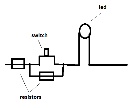

I read up on controlling PWM on the Teensy (https://www.pjrc.com/teensy/td_pulse.html) and it looks like the way to go.
I suppose the plan is now to wire up my matrix of 13x6 with 20mA/3.6v LEDs and 82ohm 1/4watt resistors to one of the PWM pins on the Teensy (I will most likely have a number of pins available, since I am only using 19 for my switch matrix) and run them at a pulse width of 25%.
That aught to bring the LED power consumption down under 400mA, which leaves 100mA for the Teensy (I think I read somewhere that it uses 50mA, correct me if I am wrong).
That wraps up pretty much all of the hardware problems I had, but opens the door to some new software problems I will have to work out :S

That will not work for at least two reasons. You can not directly drive 75 LEDs from one AVR pin. An AVR pin is capable of at most 40mA, but even going over 20mA is probably not safe for the pin in the long run. You can, however, use PWM to drive a MOSFET which will then turn the LEDs on and off. Which leads to the second problem: as I already mentioned in the previous post, PWM only lowers the average, not the peak current. While the PWM signal is high, the current draw will be 1500mA, and then it will drop to 0mA while the signal is low.
As I said, the best solution to this is to use lower current per LED. LEDs are not on/off devices - they will start emiting light at much lower currents. The 20mA probably means the current at which the LED will have peak brightness before any more current starts to damage it.
So, drive the LEDs at 5mA and see how bright they are. If they are bright enough - you have your solution.
The LEDs you linked should work, but they are not flangeless - meaning they have a small ring around their base that you will need to sand off if you want them to sit well in the CherryMX switch. Not a problem, but it could take a while for 75 switches.

This was what I was imagining originally (without any sort of light-show work)
Blue connections are the negative from the LEDs, purple rectangles are 330 ohm resistors
Red connections are for the switch matrix, brown rectangles are diodes
Green connections are from the switch to the teensy, the top connections are a ribbon cable (like this: http://deskthority.net/workshop-f7/the- ... t1067.html )
Sorry for the inexcusable ugliness... this was only meant to be a reference for myself
- Minimal Animal Wiring diagram Complete.png (68.52 KiB) Viewed 19368 times

Maybe something like this?
The LED would be connected to 2 resistors, so it would glow dimly, until the switch makes a connection that bypasses one of the resistors so it can run at its maximum spec.
I am such a good graphical artist XD
- I won't blame you for not understanding this.
- switch+led wiring.png (5.17 KiB) Viewed 19358 times

I understand it. The bit I question is whether the Teensy is going to see this as on or off when the switch is open and closed. The lower resistor makes the open state dubious, and the left resistor has the same effect on the closed state. Guess it's worth a test on a breadboard.

Trouble is, although that would change the current flowing through the LED, there isn't an easy way for the CPU to read the switch state any more! And even if that problem is solved, making it work correctly with multiple switches pressed probably wouldn't be viable.rklm wrote:Maybe something like this?

That is pretty much what I figured. Just a wild ideaSoarer wrote:Trouble is, although that would change the current flowing through the LED, there isn't an easy way for the CPU to read the switch state any more! And even if that problem is solved, making it work correctly with multiple switches pressed probably wouldn't be viable.rklm wrote:Maybe something like this?
I will probably just wire up an independent matrix with 330 ohm resistors to keep the draw under 400mA. Positive leads to the 5v on the teensy, negative to the ground. Clean and simple
