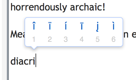

25 Mar 2014, 22:09
Well, I'm coming from an ISO-UK perspective. Our layout here has next to nothing on Alt Gr at all. (Indeed I really wonder why we don't just use ANSI-US with a £ sign.) So when I was learning German (poorly) at high school, I fooled around on Windows to see how to type in umlauts and such. Alt+ inscrutable numbers was the only way. An old classmate of mine from back then still likes to use Héävy Mêtål style diacriticals and has the codes memorised for gaming purposes. It seems horrendously archaic!
Meanwhile there's always been diacritical dead keys on the Mac, and Apple recently added this when you hold down a letter:
Screen Shot 2014-03-25 at 09.08.23 pm.png (21.2 KiB) Viewed 9306 times
(Retina screenshots are loud!)
jacobolus
28 May 2014, 01:10
Muirium wrote:Meanwhile there's always been diacritical dead keys on the Mac, and Apple recently added this when you hold down a letter:
The standard key layout on a Mac is great, but this 'hold the letter down and get a little popup' thing is IMO a shitty solution, which makes sense on iOS touchscreen keyboards but is quite terrible for a traditional computer OS / input devices:
  • It requires the use of number keys to disambiguate items, which take some finger reaching and are typically less accurate for people than letter keys;
  • It requires a substantial slowdown to type one of these characters, because as far as I can tell the delay is mandatory;
  • It changed the behavior of held down letter -> repeat the letter which has been standard for decades, so that now letter keys don’t do repeat, but random symbols do, a behavior I find annoyingly inconsistent (personally I’d rather have some better mechanism for key repeat than holding down a key, but the behavior should at least be consistent;
  • There’s no way to learn the proper shortcut for a symbol from the little popup, so it doesn’t encourage any kind of mastery of the system... it’s a tool designed only for shallow/beginner use cases;
  • It’s not an open mechanism that can be extended by end-users... there are a built-in set of little shortcuts predefined by the OS vendor, so if I have my own symbol I want to add, I’m out of luck.
28 May 2014, 03:18
All true. I learned the dead keys in my first ten years on OS X before these new shortcuts were introduced, so I seldom use those. They still have it all over Alt+XXXX codes, though…
I anticipated being annoyed by the absence of auto repeat, now that holding down keys means something else. But as the only keys I ever hold down in anger are the arrow keys and backspace, it's been a non issue; those still behave as they always did. Something about holding down a to type aardvark never did catch on with me. I think it's the doubt that I'd get two a's instead of three or more. It's easier to just type!
