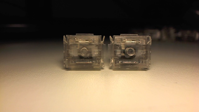

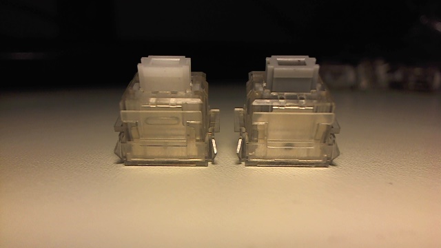

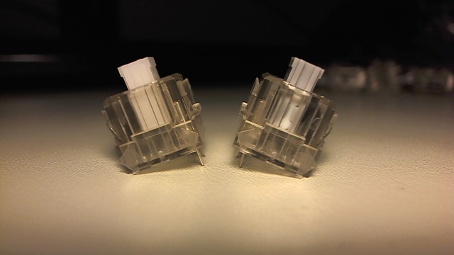

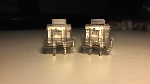

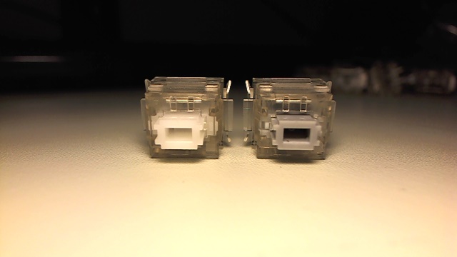

I've got my hands on a bunch of fake / unmarked MX and ALPS/Mathias(?) switches.
Let's show them off!
noesc
27 Mar 2014, 19:24
Starting with the ALPS:
White is clicky
Grey is tactile

Why do you say that the Matias switches are clones? Where did you get them? Matias switches are unbranded. Final assembly is carried out by [wiki]Gaote[/wiki] and are listed on the Gaote website, so you may just have direct-from-manufacturer switches. Edgar Matias declined to respond to my question about whether they're paid for sales that bypass Matias, but he's noted to someone privately (now publicised) that they own all the tooling for the switches.
Of course, this is why I am so amazed that Matias failed to brand their switches. That was a very peculiar omission considering how infamous the Alps world is for confusion over manufacturers.
Gaote also sell branded MX clones, and it's claimed that the very different-looking MX clones in the Noppoo Lolita are also Gaote (presumably assembled from parts made to a different design by someone else).
27 Mar 2014, 22:51
How can you tell that the Matias switches are fake? They look right to me. The tactile switches used to be made with white sliders, but it was changed to grey.
27 Mar 2014, 22:55
Guess not everyone's actually heard of them. As Daniel pointed out: the lack of branding on all Matias switches is a recipe for confusion.
My theory why Matias didn't spank a logo on them is because Gaote wanted more for the privilege. Everyone loves to sell a little on the side, quite regardless of who's tools actually churned them out…

28 Mar 2014, 22:00
The Matias Tactile Pro had Alps-branded SKBM White switches.
When Edgar Matias was inspecting the then-new Tactile Pro 2, Strong Man demonstrated the "Strong Man switches", which were similar, but with grey sliders.
However, if you look at Tactile Pro keyboards, most of those, too, had grey sliders, but Alps branded, and Matias never noticed (grey and white might be the same switch, for all we know; my datasheets only cover white and the thus far unseen yellow). Strong Man seem to have taken advantage of the removal of the Alps branding by Forward as an excuse to claim ownership of the switches. They also described the four-tab clones as being Strong Man switches to some companies, when they appear to be Himake/Hua-Jie. It looks like Forward only branded the bottom of the switch after they removed the Alps logos, so you'd not normally see the branding; I only discovered this recently. Sandy's loose simplified white and my loose simplified grey are both Alps-branded.
(The Strong Man website itself made no such claims back in 2005, not naming the Alps switches and clones by name.)
Those switches in your photographs just look far too accurate to be clones, as typically the clones aren't the same shape as the original. Yours appear to be 100% the same as the real switch, though I don't know the exact shade of grey for the tactile switch.
It's definitely a rabbit hole all right.
