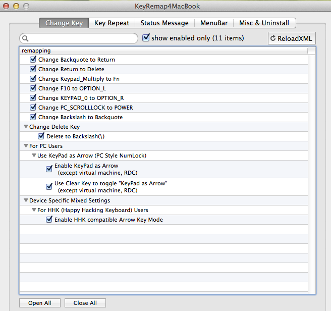

Here is my IBM XT keyboard that I have remapped using KeyReMap4MacBook. It is connected to my Mac using a Hagstrom Electronics converter, and the keyboard is shared with a Linux box and Windows machine using Synergy. Thanks to Muirium for many of the remapping ideas!
I put a small Return key in place of the Backquote (`) key, and put the Backspace (back Delete) in place of the former Return key. This placement gives it a "pseudo HHKB" layout for Return and Backspace. "F" = Fn, replacing the former */PrintScreen; Fn is set to emulate HHKB functions, such as the cursor diamond and F-keys. Command replaced CapsLock, and Option replaces the KeyPad zero key. Arrow keys are toggled with KeyPad numbers using NumLock. Scroll Lock has been remapped as Power; I can actually shut down my Mac from the XT keyboard!

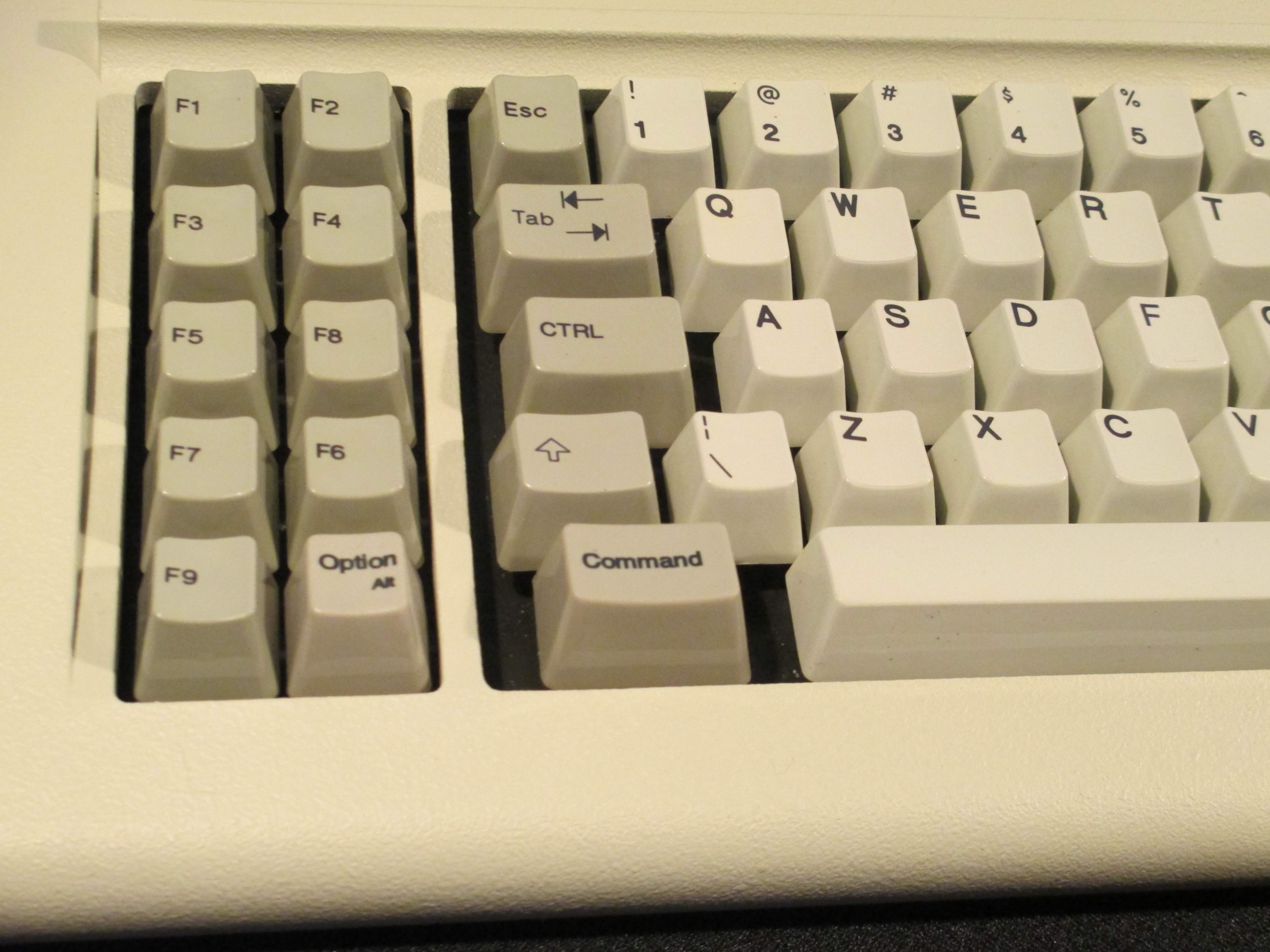

On the left side of the keyboard, F10 was remapped to left Option and left Alt to left Command. On the XT, Ctrl is already where it belongs, to the left of the "A" key.
Other touches included replacing the small shift keys with slightly larger ones and replacing the plain-surface F and J keys with ridged ones. IBM Replacement keys were from a 122-key IBM and a standard Model M; Option and Command keys were from Unicomp.

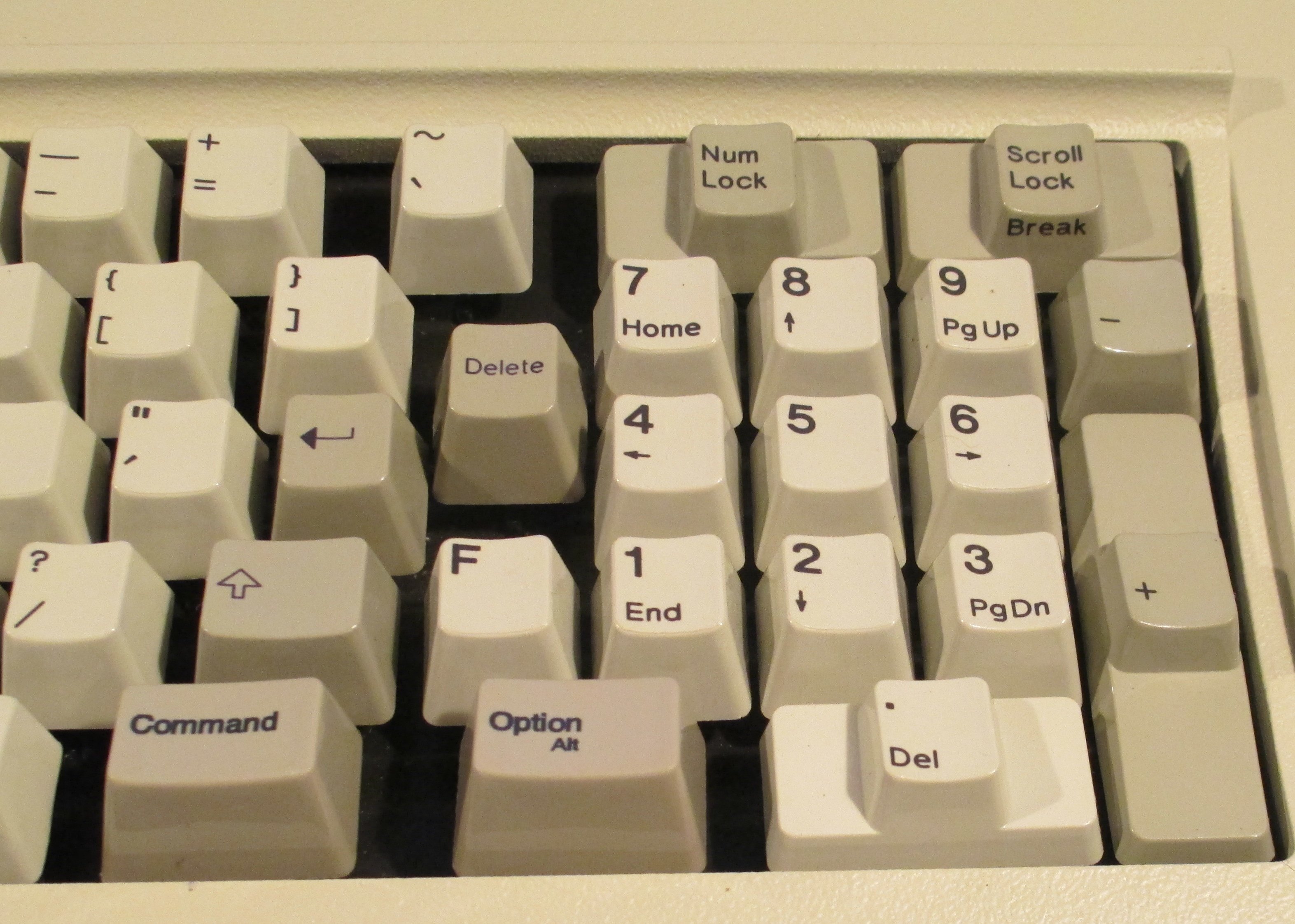

Update: I've made some revisions that I think improve the aesthetics and functionality somewhat. I remapped Backslash to Backquote and Delete to Backslash. Now the Backslash and Tilde (~) key is to the immediate right of Left Shift, and the Backslash (\) key is on the top row between = and Num Lock, where the original Delete was located. I substituted a 1.5x Backslash key from a Model M for the 1x Backslash key on the XT; this swap better fills in the empty space in this location. In addition, I put the original Return (Enter) key in place of the 1x Delete key; this also fills in a considerable amount of empty space. Now the only problem is having two adjacent keys with the Return (Enter) symbol. Users of this keyboard simply have to remember that the nearer 1x Enter key is the true Enter, whereas the farther and larger vertical Enter key is the back Delete (Backspace).
This seems fine. However, if anyone knows of a better vertical key for Delete (Backspace) that would fit in the original Return key space on the XT, please let me know. Note that the large keys on the XT have a centrally located mounting stem and no stabilizer stem. The only stabilized key is the super-long spacebar.

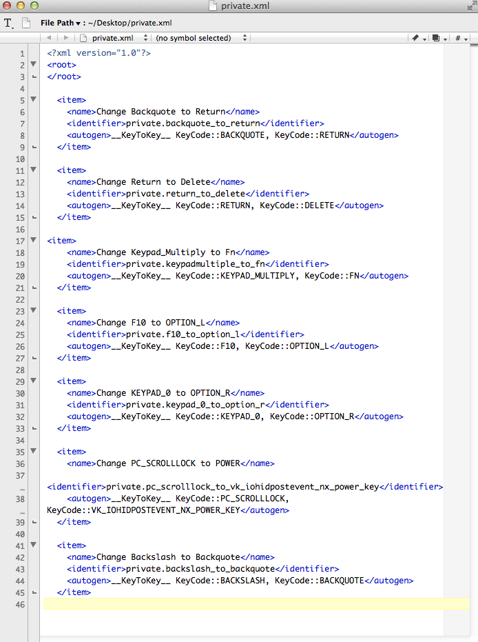

My KRM4MB settings and private.xml file are shown as images below for anyone who would like to reproduce these remappings.

Right side of keyboard, showing the black tan Backspace (back Delete) above the Green Return key. Light Blue = right Fn, Dark Blue = right Option (Alt); Red = right Control. Right Command is shown adjacent to the Spacebar. Among other things, Fn toggles back Delete to forward Delete and creates a cursor diamond from the [ / ; ' keys (as in the HHKB layout). NumLock toggles arrow and number keys in the NumPad, and Scroll Lock/Break = Power.
Left side of keyboard. Red = Control; Dark Blue = Left Option (Alt); Light Blue = left Fn. Left Command is shown next to the Spacebar. Among other things, Fn toggles Escape to Backquote (`) and Fn+shift = Tilde (~).
