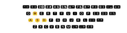

4.A. I have access to a Die Cut machine for papers, adhesives, etc for free. I'll make a custom stickers to put it the sides in order to avoid wear. My first option was decals but my keycaps are black, so I need to use a white decal paper ... too complicated. My question is basically I should put them a clear coat? I cannot live with only blanks, my wife will use it rarely but she will use it.
Here is an idea
keycaps
keycaps

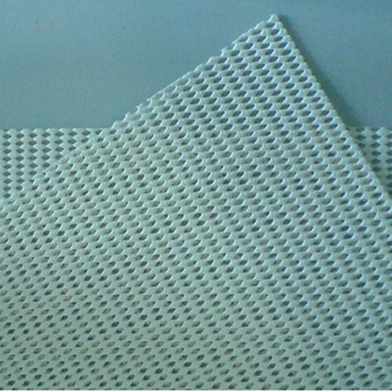

5.C. 2mm+2mm Anti-slip mat, why? Because I've used in the key caps as an alternative for the O-Rings, and also to fill the base of my Noppoo Choc Mini case. The noise was reduced a lot. My question is if I should be worried about the static. And I know if at the end I choose the mat, I should take care about water.
