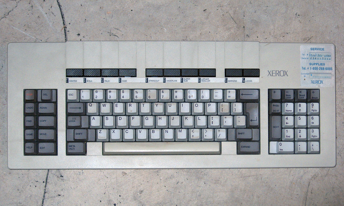

All of these had the same keyboards, though, which had keycaps oriented toward the Star office system.
There were four known keyboard variants — two earlier ones, which were thick and had black main keycaps, as shown here, and two later ones, which used Cherry MX switches and had grey keycaps. In each era, there were keyboards with and without an integrated round trackpad (pictured in this thread).
This keyboard is the late, no-trackpad version from an 1109 LISP workstation.
The top of the keyboard is somewhat discoloured. In these pictures it looks redder to me than in person, but that's a grey card in some of the pictures, so you gets what you gets.

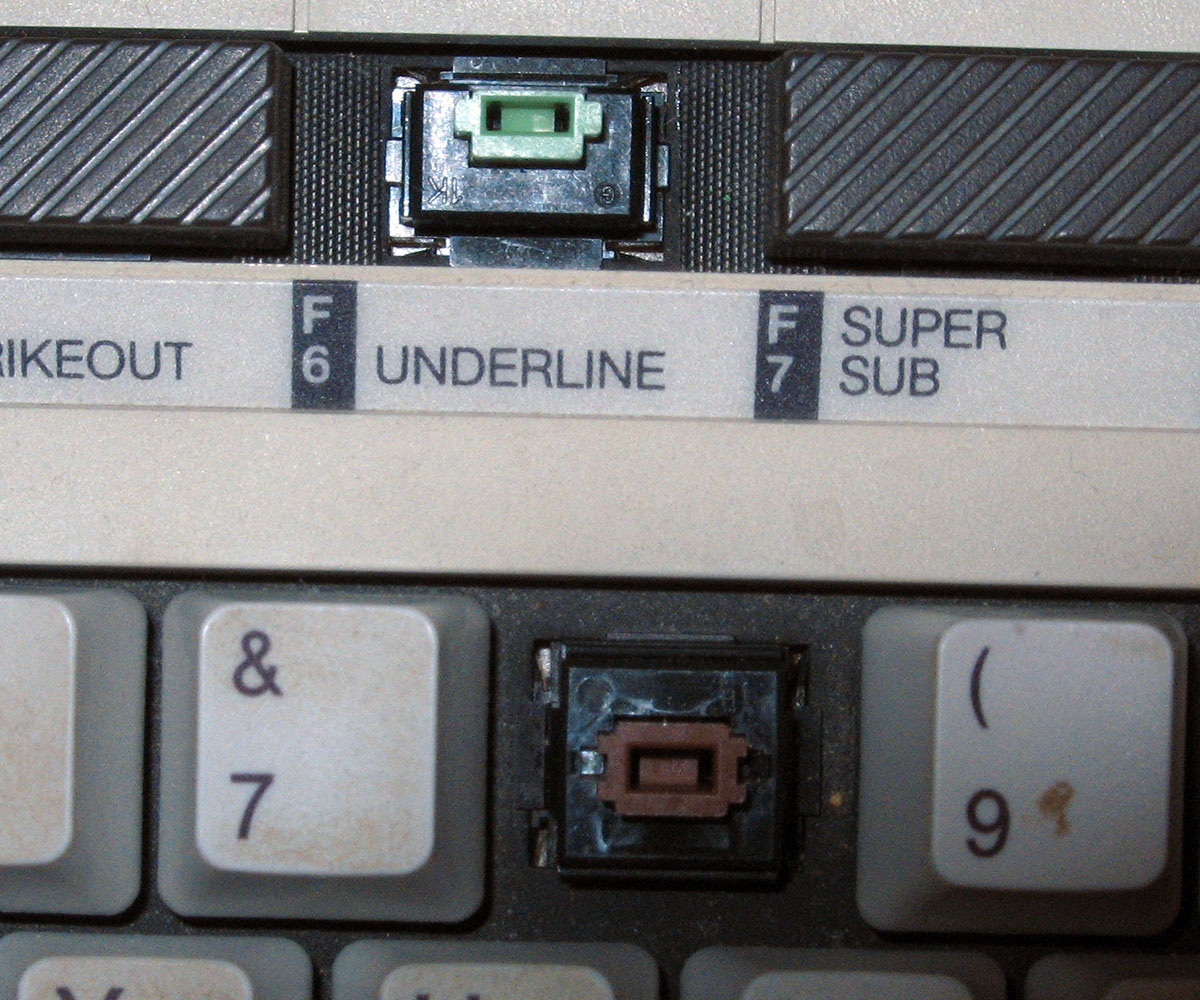

The switches are interesting. I've posted this picture before, asking about them:
All the switches are linear. Some of the yellow switches (used for function keys) and all of the white switches (alphnumeric keys) have ‘HCP’ mold marks instead of the Cherry mark.
Using the crude method of holding up the keyboard and pressing a loose modern switch against the keyboard switch to see which gives first, the white switches used for the alphanumeric section are stiffer than Cherry MX Red but lighter than Cherry MX Black.

The grey-green switches used for the Shift keys have approximately the same force as the current MX Grey.
There are no stabilizers under the shift keys.
The Shift Lock is an all-black locking switch. To me it looks the same as more recent ones.

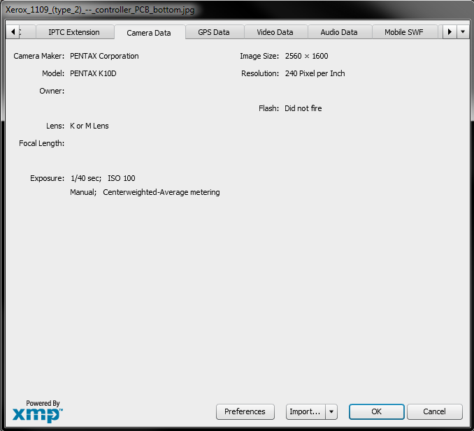

How very curious. Can you estimate if there is an actual Cherry text logo behind the sticker on the PCB? It all seems so odd. Daniel will be all over this I guess.
PS: Amazing photos. What is your setup for this?
Compgeke
23 Apr 2014, 08:36
Pentax K10D based on EXIF info.
Shot at 1/40s, ISO 100, f/??, ??mm lens, no flash. Manual lens then?
I would guess a couple of soft boxes or a light box was used for the even lighting.

sixty wrote:What is your setup for this?
Cloudy day outside. I don't have space or equipment to do this indoors currently. The backdrop is an old projector screen — helps a bit with fill, and nobody wants them any more, so they're dirt cheap in thrift shops. Lens is a Kiron 105mm f/2.8 1:1 macro (manual, yes). I lack patience and skill to get the lighting consistent.
