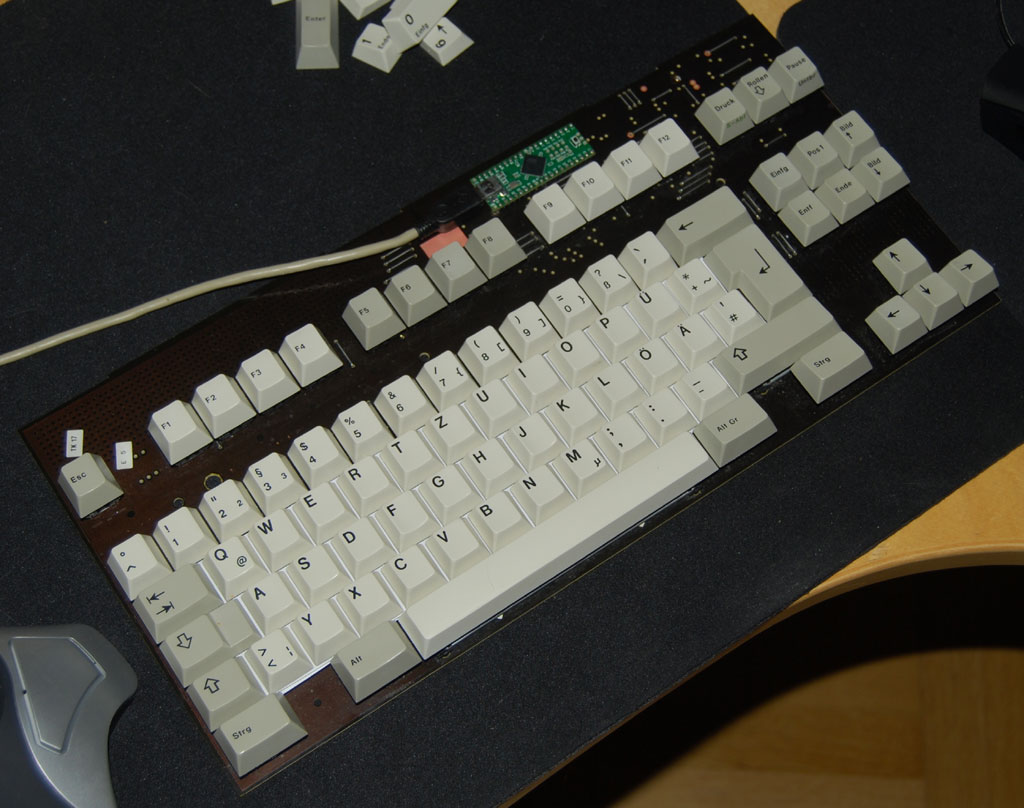

Replaced controller with Teensy++ 2 + dmw's HH firmware. Gonna cut the case later. This will do for now :)
Will post the matrix later!

Pin 1 is located at the top left corner if you turn the board around. The model number is G80-1000 LFADE/02, S/N G013502 L33.

Thanks! The matrix was well laid out, only three jumps were needed to restore it!

This particular one has actually been my daily driver since the first batch :) Probably gonna use it for a long time to come. One of my fav boards actually, the keys are retrobrighted doubleshots from another board, the switches have been moved around, and now a custom controller + tenkeyless mod. It just keeps getting better :)
The reason I cut this one was that it was the one with the wonky case, the PCB has been bent a bit, and I can't get it to straighten out perfectly (even with the new cases you sent me!). I don't know yet if I'm gonna bother cutting the case... I actually like the PCB flush against the desk. Helps keep the wrists straight.
