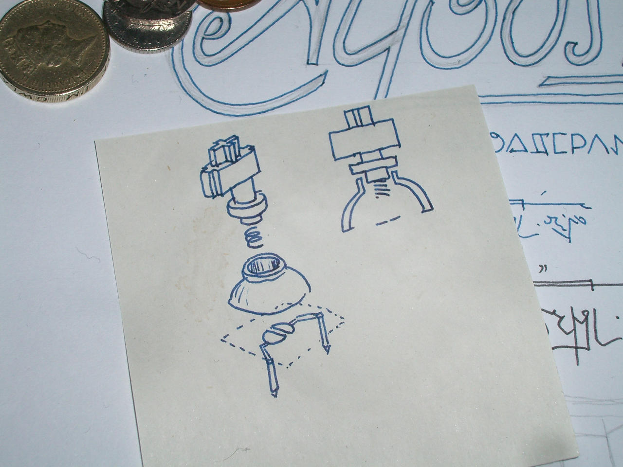

I guess you could engineer one to have an integrated [wiki]buckling rubber sleeve[/wiki] with a small metal spring at the base of the slider:
Integrated buckling rubber sleeve.jpg (161.74 KiB) Viewed 10902 times

Thanks for info - and nice drawing/idea :) But how about doing it inside/around the Cherry MX switches?
Is there no place for a rubber sleeve, "spiral" like springs and so on? No solution to circumvent the small space / stem contact?

I posted full disassembly shots of [wiki]Cherry MX Green[/wiki] — I am not sure how you'd get a dome in there anywhere.
When you say '"spiral" like springs', I presume you mean something other than a normal spring, which is spiral-shaped … I'm guessing you mean a bird's nest type spring like in an [wiki]Oki Gourd Spring[/wiki]?
Space inside an MX switch is indeed a bit cramped.

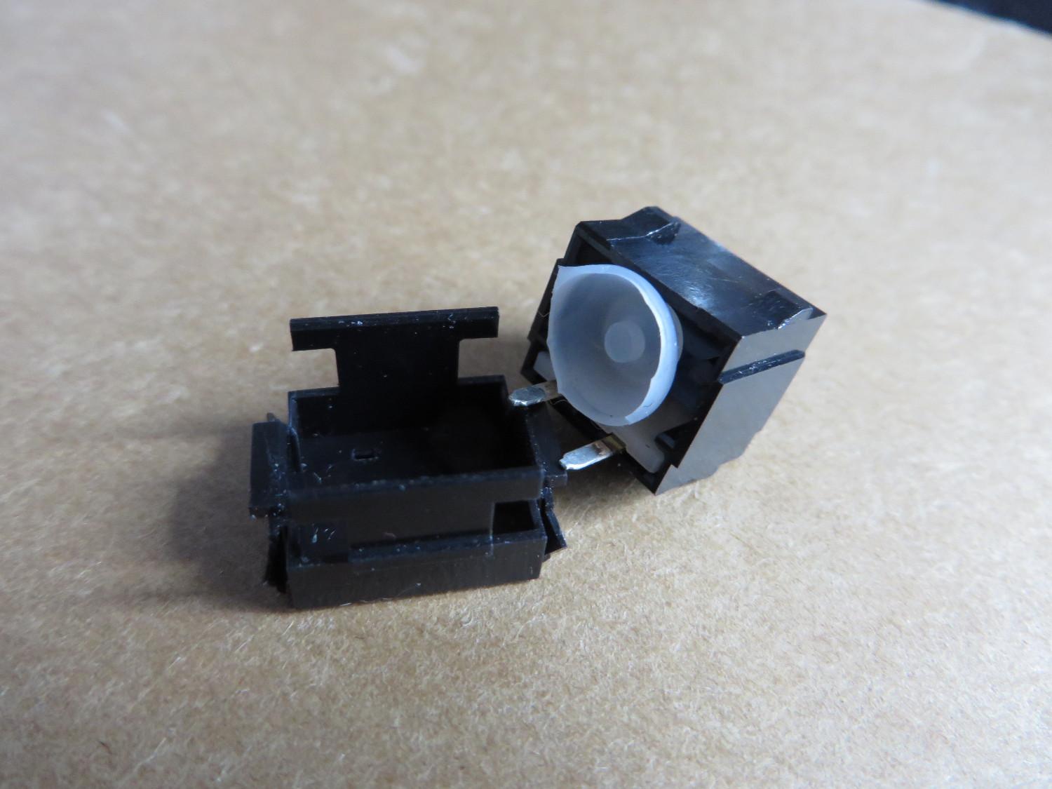

29 May 2014, 15:47
I just saw this, i find it quite relevant (and i do have a blue alps keyboard!) :shock:
http://geekhack.org/index.php?topic=588 ... msg1347946
I hope it's allright to also quote / post image here:
BlueBär wrote:I recently modded some blue Alps with some rubberdomes instead of the spring to enhance tactility. I also removed the click leaf while I was at it since it only produces unecessary noise. Feels a lot better now, almost like Topre!
