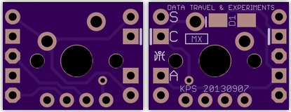

I am doing a group biy for single switch PCBs with the purpose of custom layouts without the need of having a single PCB made. Here is the link to the thread.

Anyway, I made some switch breakouts a while ago, for MX and ALPS switches, with a few goals in mind:
- easy to wire together in grids
- with pins, allow 750 mil key spacing on standard 100 mil breadboards
- allow various combinations of internal/external diodes or LEDs
- mx.png (61.08 KiB) Viewed 4213 times

Very nice. The biggest thing I wanted with this version was make them small enough to be soldered to the switch before installing into the plate.

You don't have to solder to the side of a pin
You can open switches with no desoldering and no plate with the goofy switch holes
Cheaper than a one off full PCB
Support for backlighting
Support for PCB mount stabs

I thought that in the absence of a full PCB there must be a plate to hold the switches.Rotti wrote:[…] You can open switches with no desoldering and no plate with the goofy switch holes […]

kbdfr wrote:I thought that in the absence of a full PCB there must be a plate to hold the switches.Rotti wrote:[…] You can open switches with no desoldering and no plate with the goofy switch holes […]
Correct but you can still do a stem swap with the square switch holes on a stock style plate and still not have to desolder. Because the PCB is taller than the hole you can just pop out the switch, open, change stem/spring, and put back in the plate.

At last, a real reason for this kind of board's existence. It would work on perf/stripboards too, also then I suppose - something that lots of us have wished that switches were attachable to. That would make a thick keyboard, but still.kps wrote:[*]with pins, allow 750 mil key spacing on standard 100 mil breadboards
So, instead of desoldering the single switch, you would have to desolder all the interconnects to the whole single-switch PCB (which are twice as many) and also thus making the entire row and the entire column inoperable ...kps wrote:You can open switches with no desoldering and no plate with the goofy switch holes
Would a full keyboard populated with single-switch PCBs really be cheaper than a one-off single-sided PCB that holds all switches?kps wrote:Cheaper than a one off full PCB
But not PCB-mount switches ... You would still need a plate to make a one-switch keyboard.Rotti wrote:Support for PCB mount stabs
The kinds of plates I have seen that support PCB-mount 2u stabs need to leave a lot of room for the stabs, thus making the parts of the plate holding the switch more narrow than usual - and pretty weak unless the plate is steel. Those thin slivers of plate have to support everything: the switch, the PCB and the stabilisers.

No need to desolder anything to swap internals. Interconnects are hook up wire soldered to a through hole. Pull the wires through an inch and stuff them back in.Findecanor wrote:At last, a real reason for this kind of board's existence. It would work on perf/stripboards too, also then I suppose - something that lots of us have wished that switches were attachable to. That would make a thick keyboard, but still.kps wrote:[*]with pins, allow 750 mil key spacing on standard 100 mil breadboards
Yes it is cheaper. For one you are not paying for any space between the switches. At 1000 square inch order through OshPark I was quoted about 23 cents each.
I chose not to support PCB mount switches because of finding room for everything and having through holes for interconnects.
