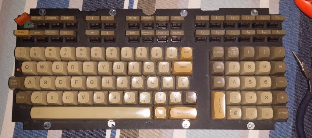

I’m trying to restore an "antique" HP keyboard.
The keyboard belongs to a desktop calculator from the 70s (HP 9825A). It is a little "tired" : sometimes two keystrokes are necessary to input one character, sometimes a single keystroke yields multiple characters, and the overall typing experience is not too good...
My intention is to de-solder the key switches from the keyboard PCB and replace them with new switches.
I have taken the calculator apart to have a better look at the keyboard PCB.
The key switches seem to be from cherry corp. Unfortunately, they are not identical to the switches that can be ordered from (say) WASD.
They are taller, and the two pins are located differently.
For clarity, I have uploaded a few of pictures on my flickr account.
https://www.flickr.com/photos/78824170@ ... 101724017/
Pictures 1 and 2 are of the HP 9825 key switch.
Pictures 3 and 4 are of a cherry switch (Cherry MX Brown Keyswitch - MX1A-G1NN).

HP 9825A keyboard
HP 9825A keyboard

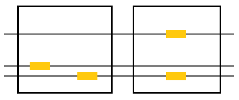

Well, with a cruciform slider, you frequently have 90° rotational symmetry. However, what's interesting here is that, when you look at the plane of the legs, they're positioned front to back, as shown on the right here:
Leg positions.png (5.9 KiB) Viewed 4255 times
Most switches are arranged as shown on the left.
That's what gave me a clue where to begin.
