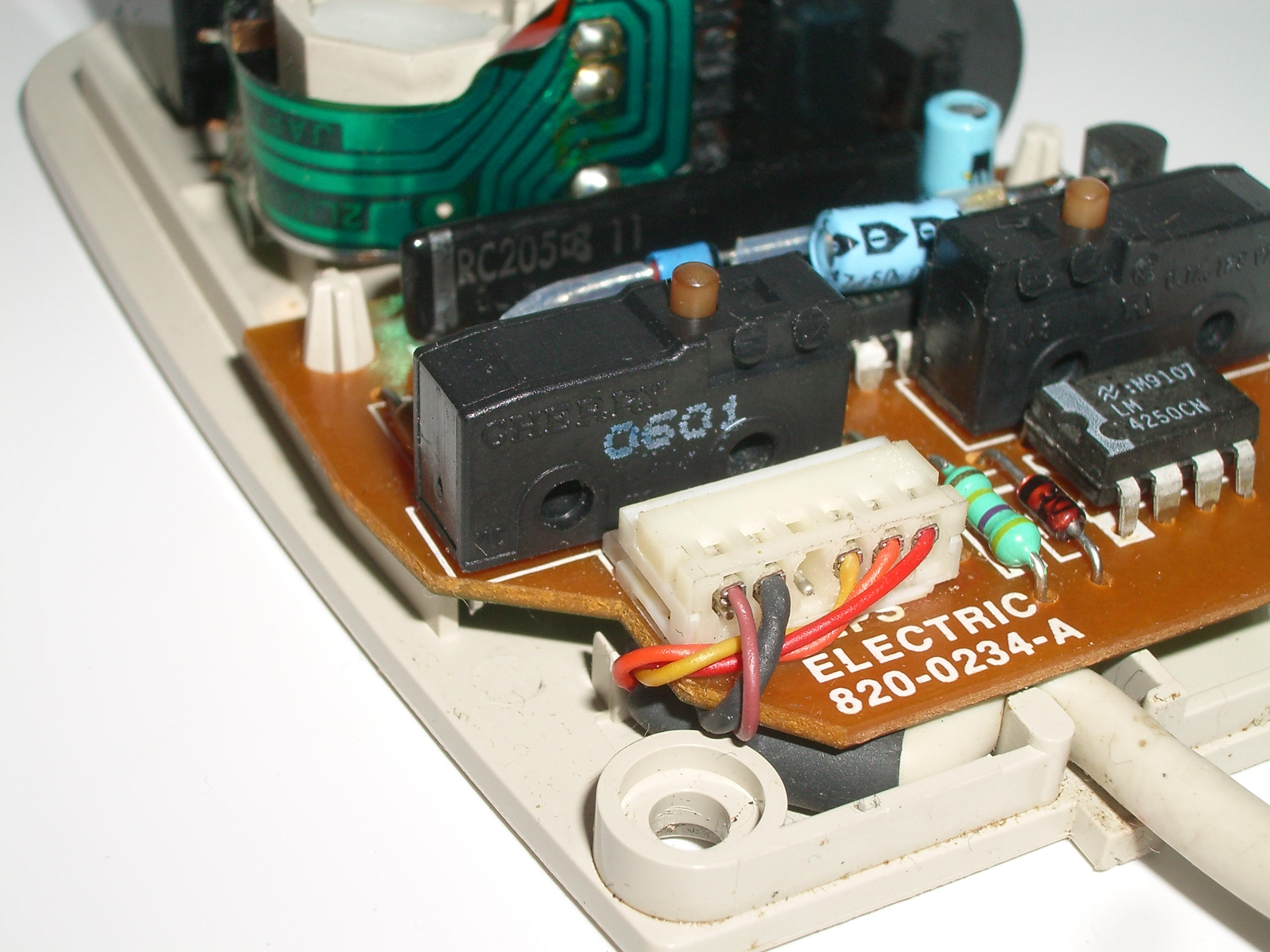

The OEM is Alps Electric, who became queer bedfellows with Cherry:
key tronic Professional Series Mouse -- Union of Alps and Cherry.jpg (481.6 KiB) Viewed 2910 times
Yep! Cherry microswitches in an Alps mouse. How could that be? I have no idea …

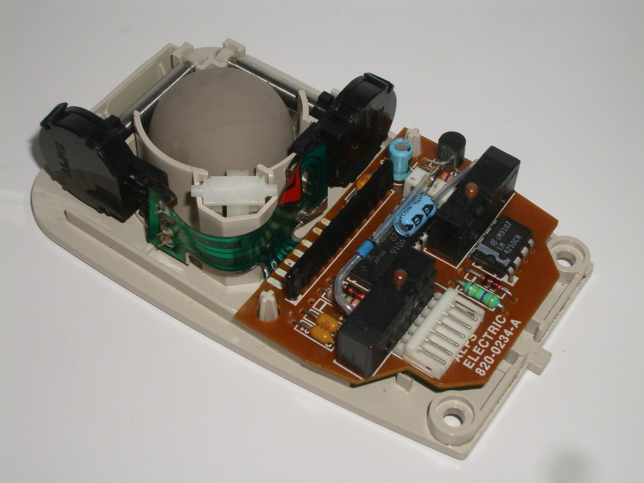

Full internals:
key tronic Professional Series Mouse -- internals.jpg (415.43 KiB) Viewed 2910 times

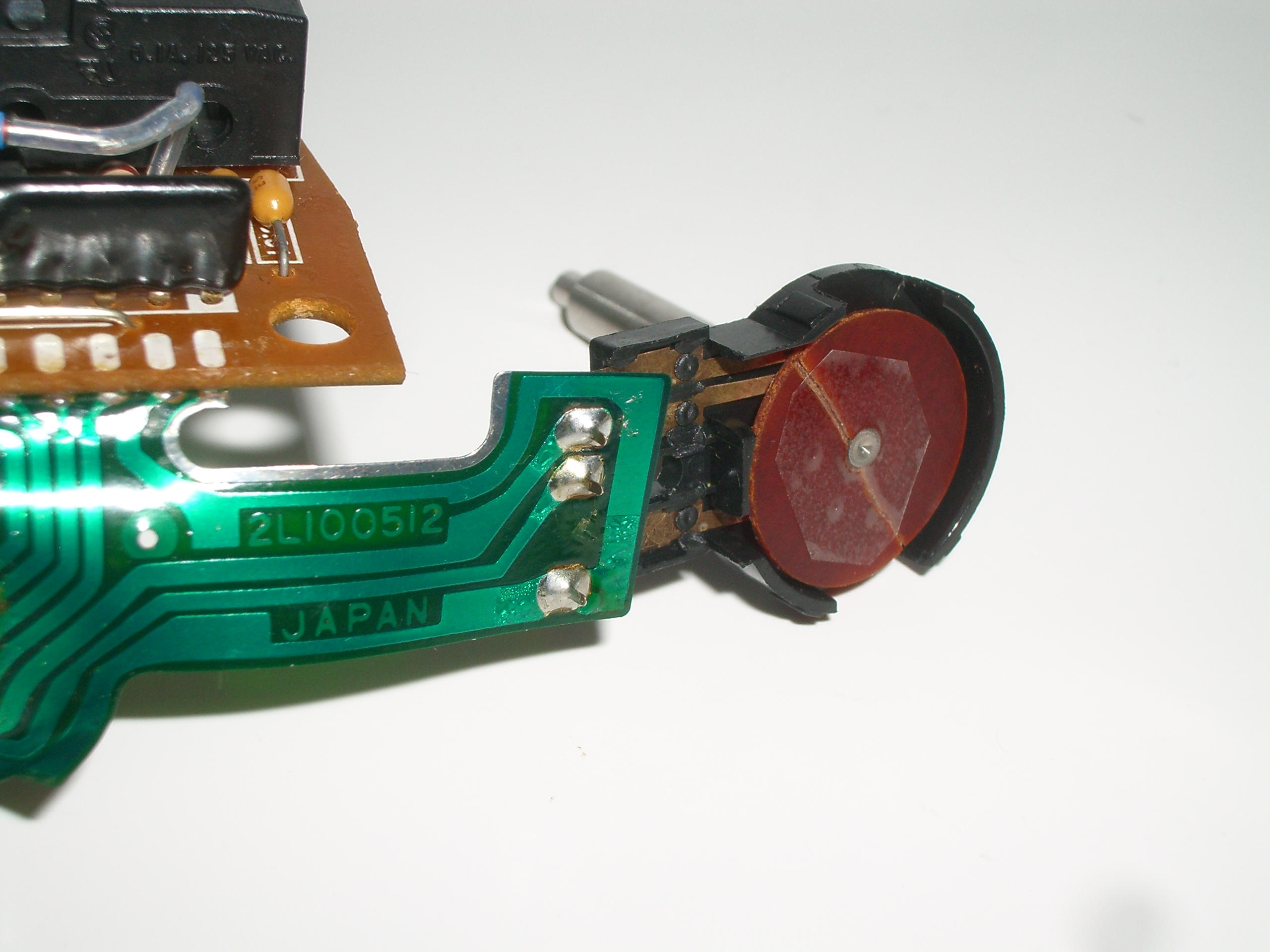

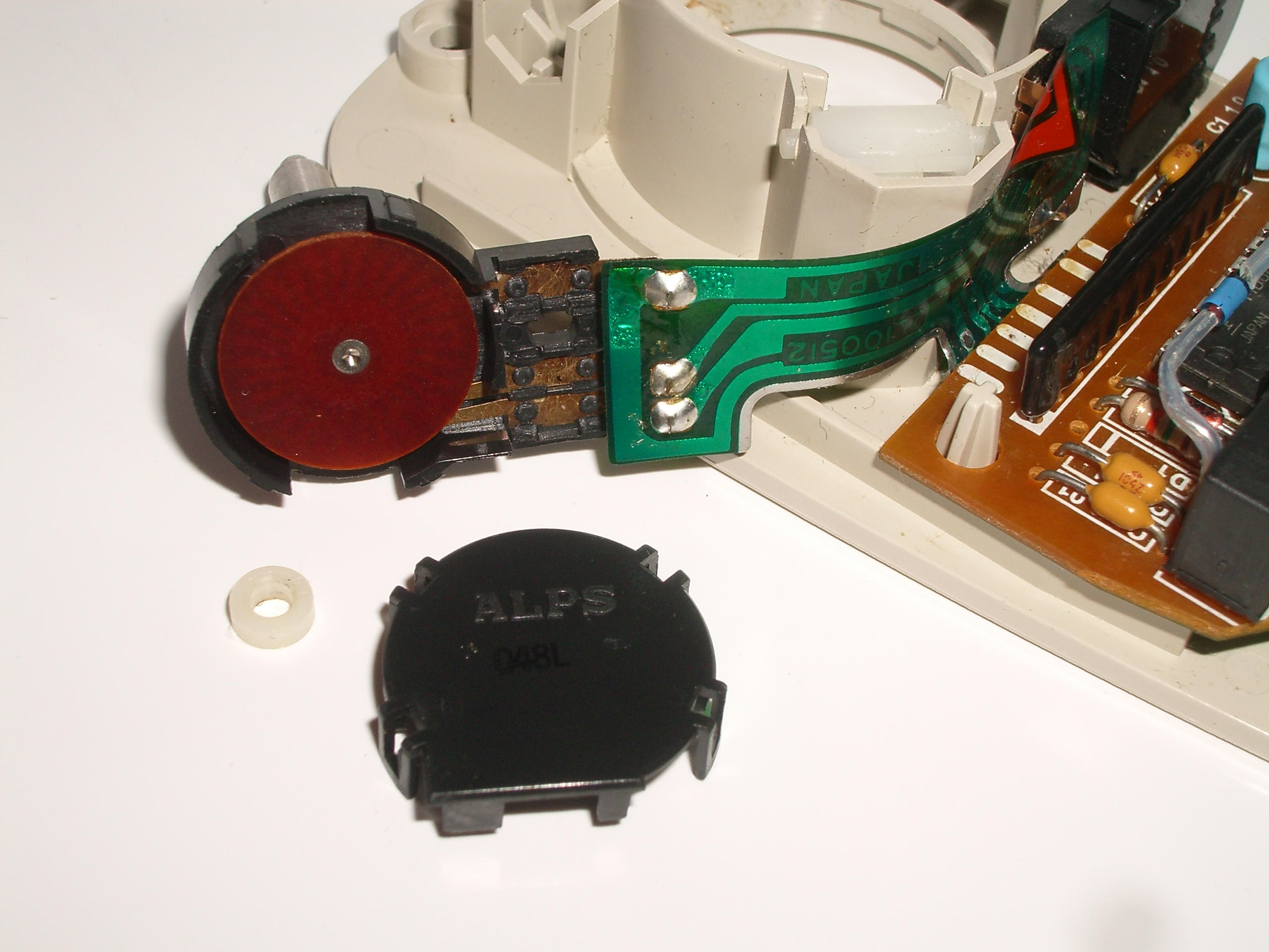

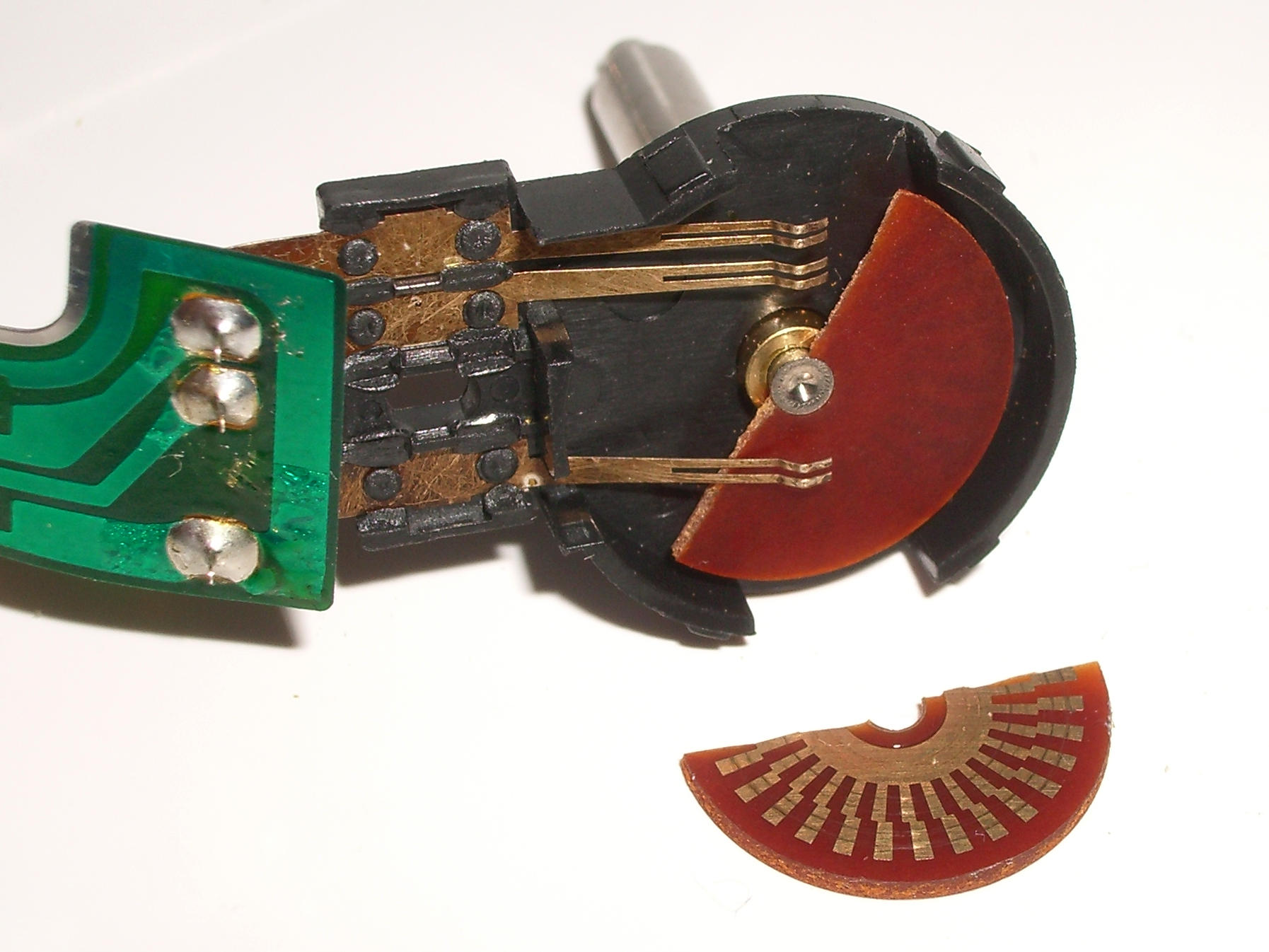

What's really fascinating is that, as you can see, it is not opto-mechanical! It uses a pair of purely electric Alps rotary encoders:
key tronic Professional Series Mouse -- rotary encoder.jpg (410.43 KiB) Viewed 2910 times

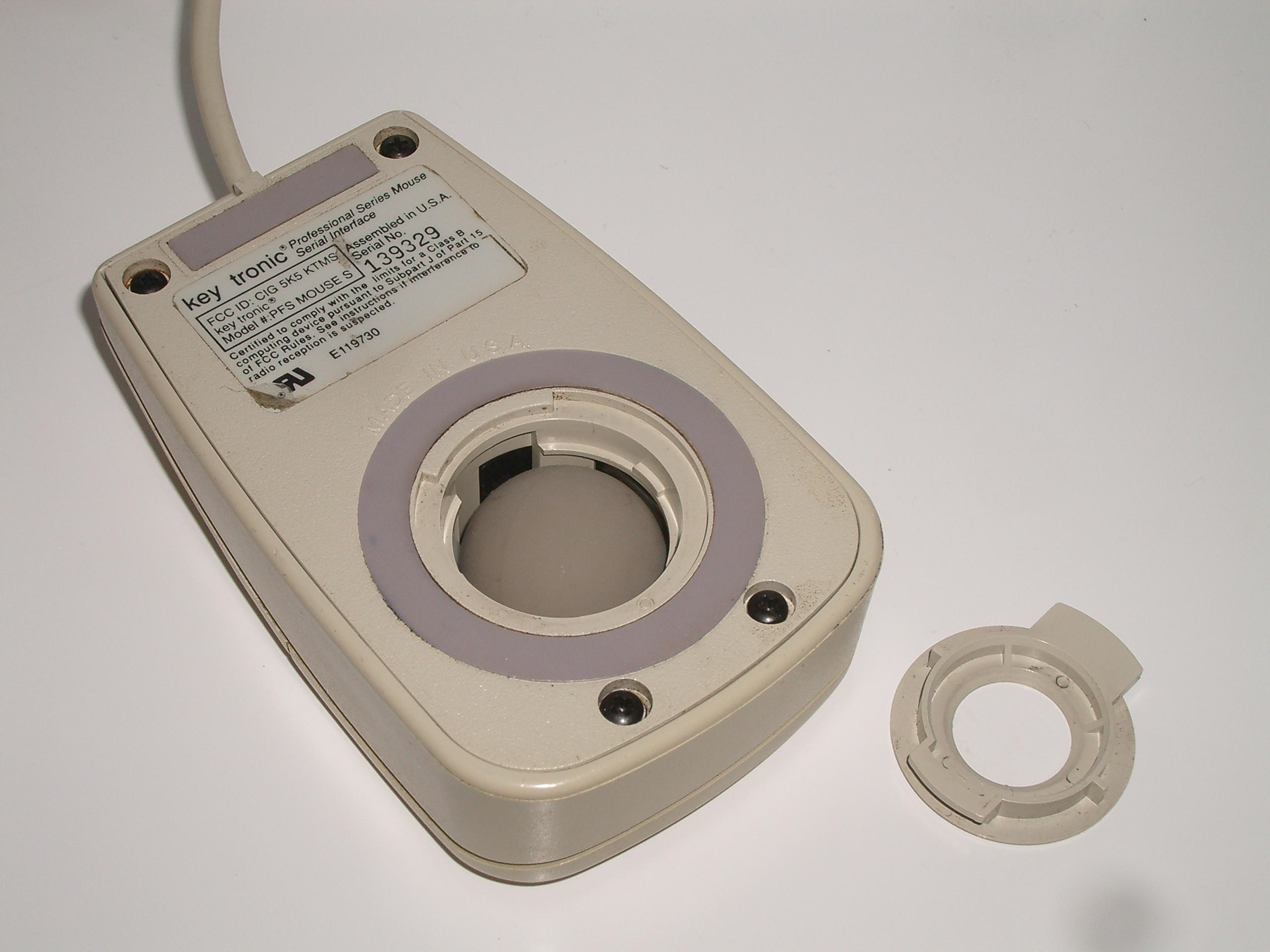

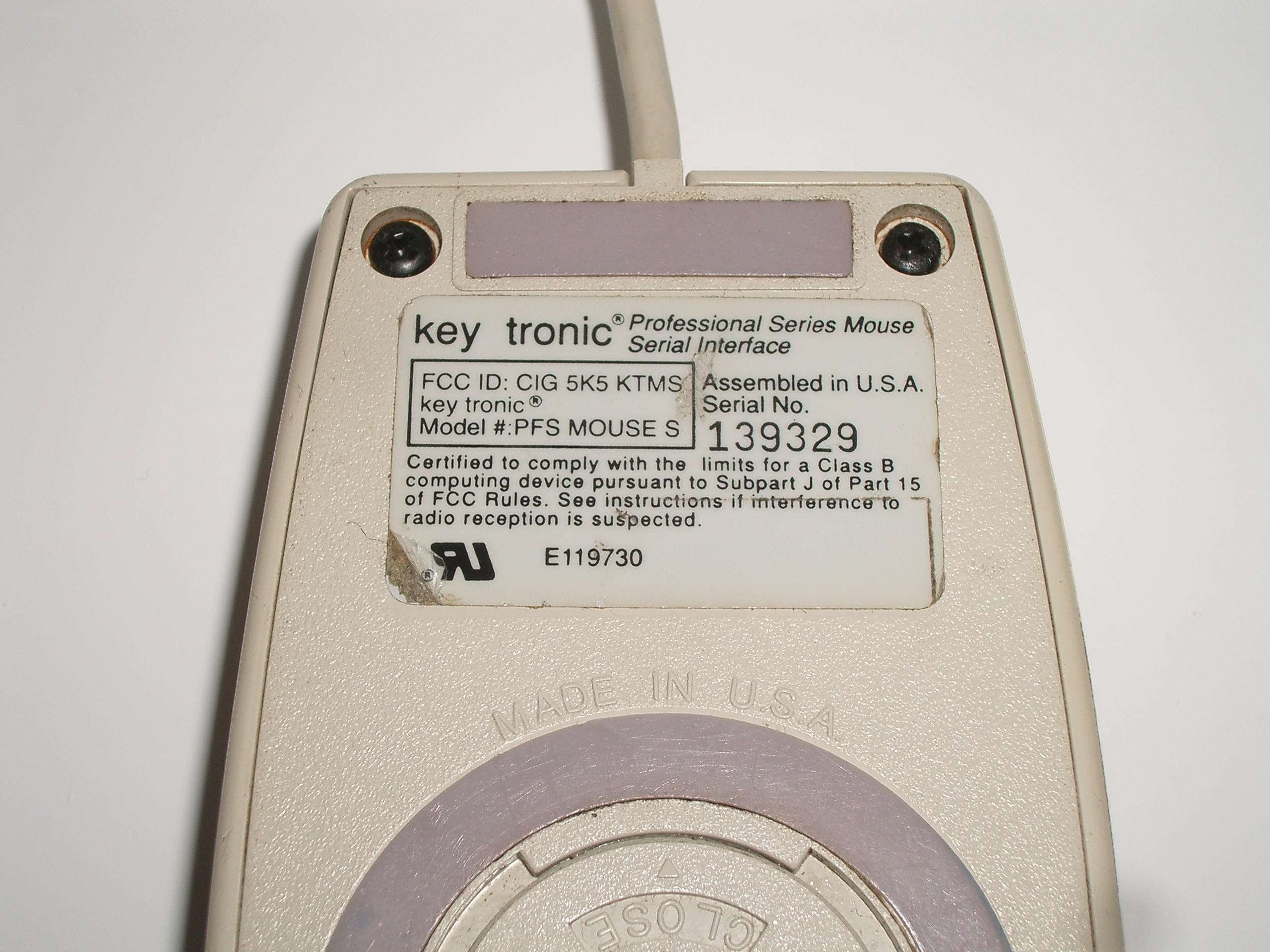

As you can see in the first photo, a pair of contacts feeds current into a central ring, and the current is returned through staggered traces that alternate which input contacts receive current. FCC registration was 1988. Interestingly this is the same year of registration as the [wiki]Apple Desktop Bus Mouse[/wiki], which was opto-mechanical. (I got some better exterior shots of that, too.)
key tronic Professional Series Mouse -- product label.jpg (514.92 KiB) Viewed 2910 times
I tried to get the encoder apart, which appears to be impossible, hence snapping the rotary PCB. I've stuck it back together, but it will never work again:
key tronic Professional Series Mouse -- looks good but won't work.jpg (338.52 KiB) Viewed 2910 times

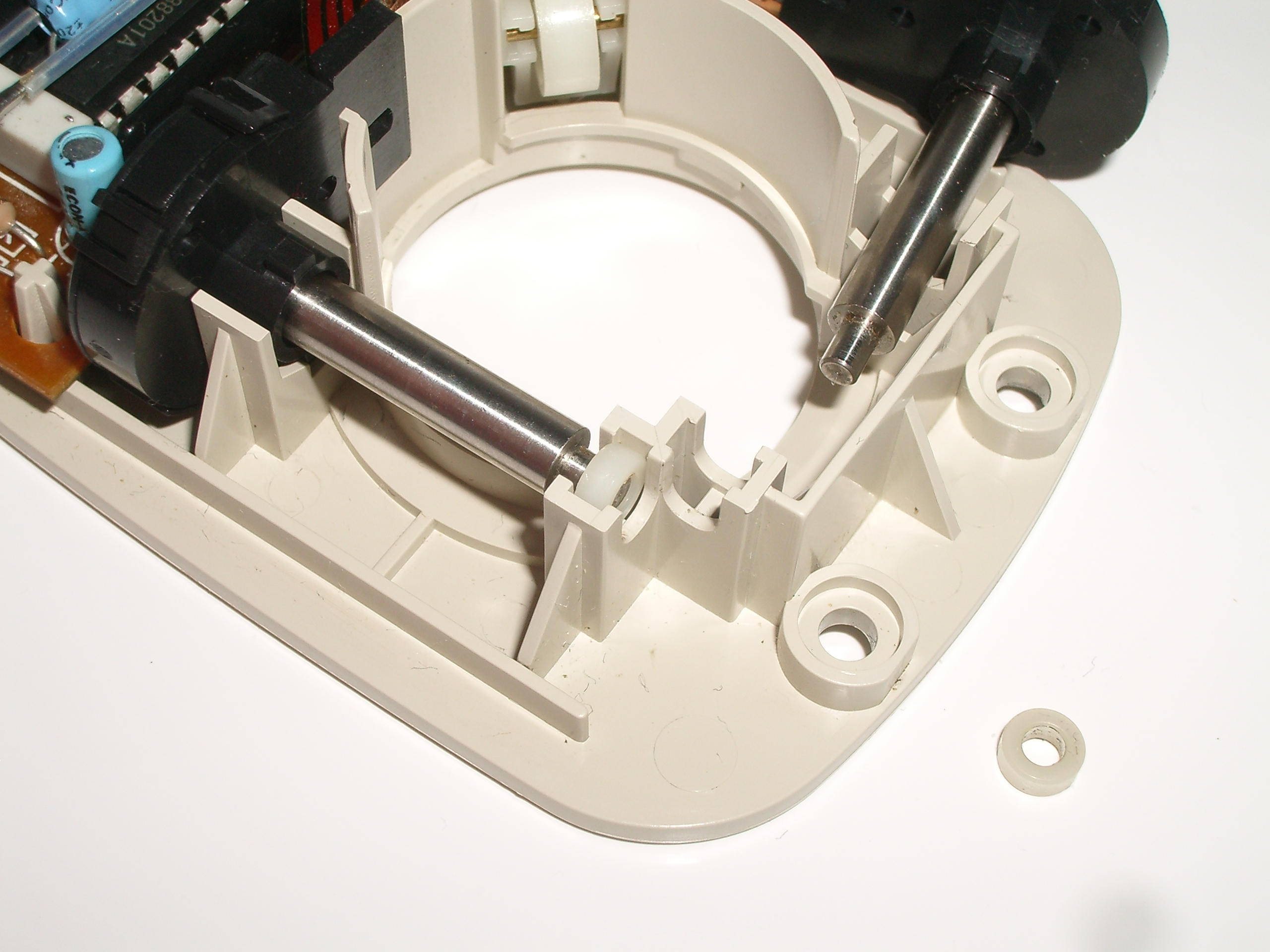

The shafts that drive the encoders are machined metal instead of the usual plastic, and they run in little plastic bearings:
key tronic Professional Series Mouse -- encoder shaft bearings.jpg (340.79 KiB) Viewed 2910 times

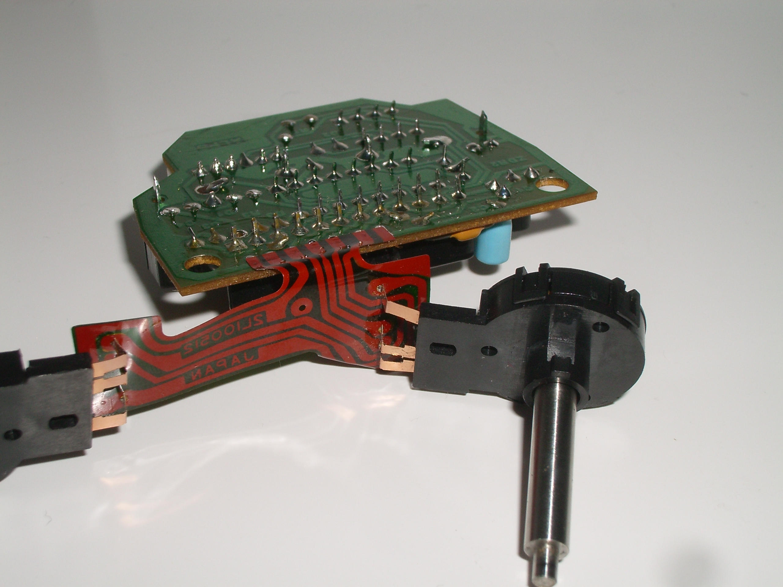

They're soldered into a flexi PCB that wraps around the ball enclosure:
key tronic Professional Series Mouse -- flexi PCB for the encoders.jpg (357.61 KiB) Viewed 2910 times

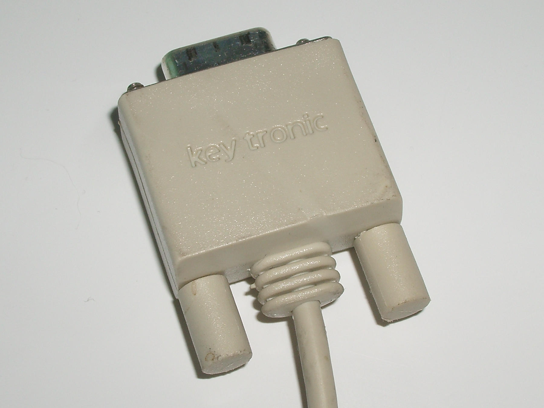

The DE9 plug is Key Tronic–branded:
key tronic Professional Series Mouse -- branded DE9 plug.jpg (146.63 KiB) Viewed 2910 times

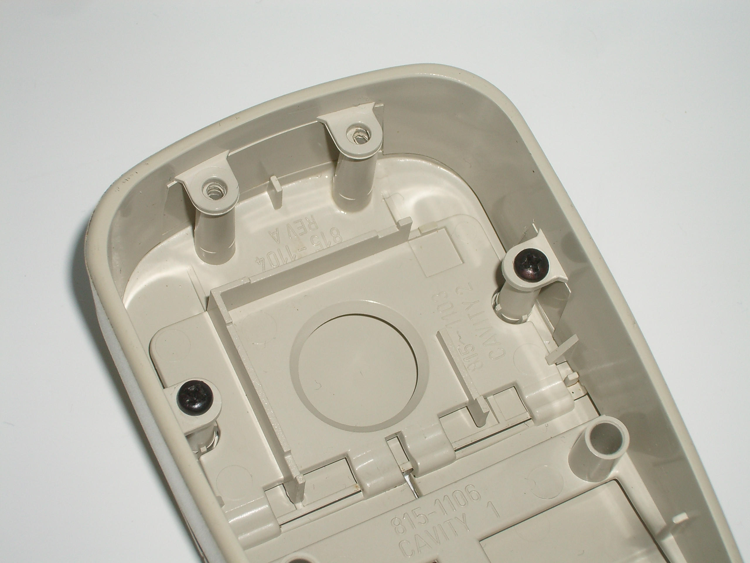

Even the buttons are high quality: the palm rest and buttons are separate parts; the palm rest is held in with screws, and this in turn supports the buttons:
key tronic Professional Series Mouse -- button and palm rest assembly.jpg (303.58 KiB) Viewed 2910 times

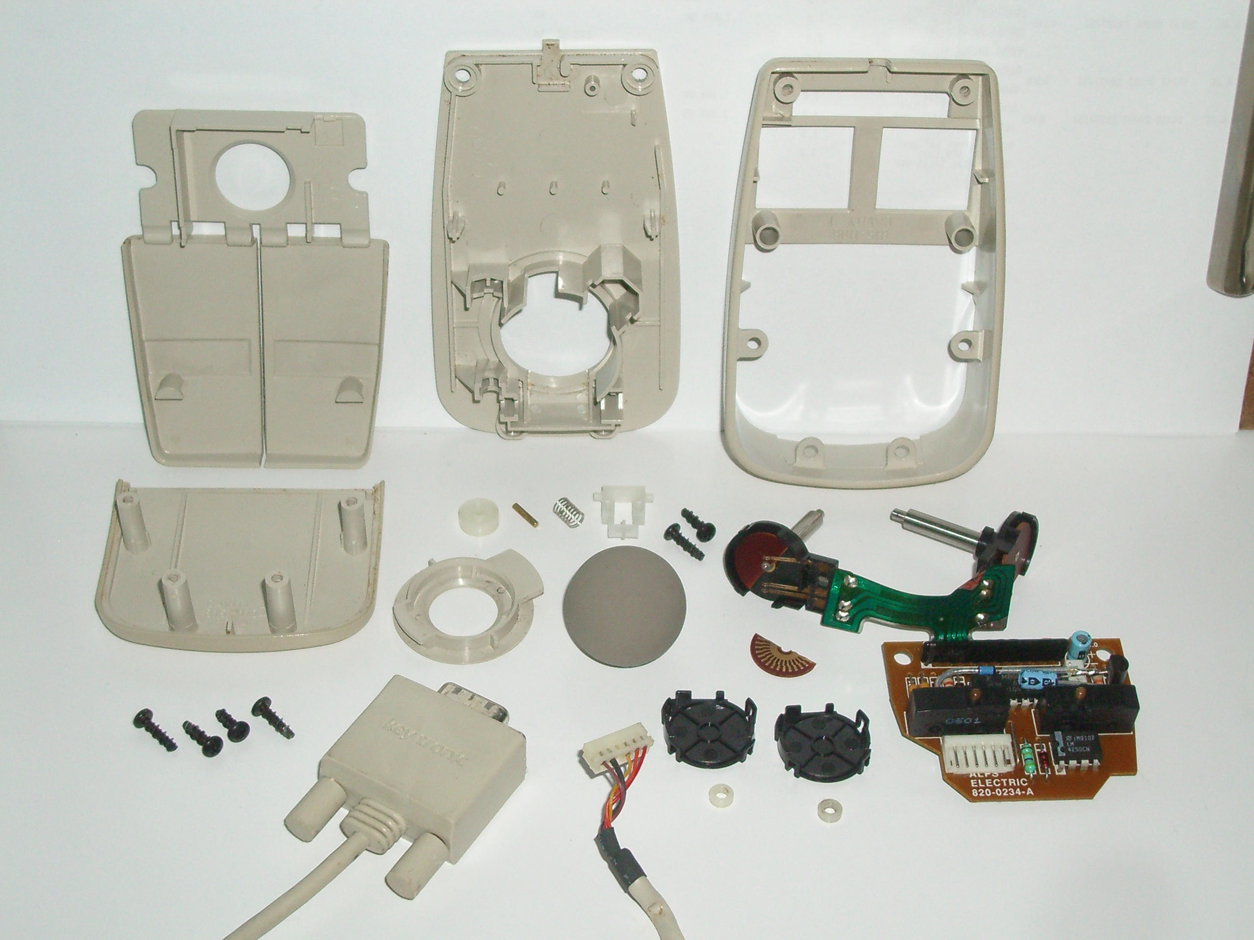

Back in 1988, mice were mice! This is a complete strip down of the mouse — it's a lot of parts:
key tronic Professional Series Mouse -- when mice were mice.jpg (402.47 KiB) Viewed 2910 times

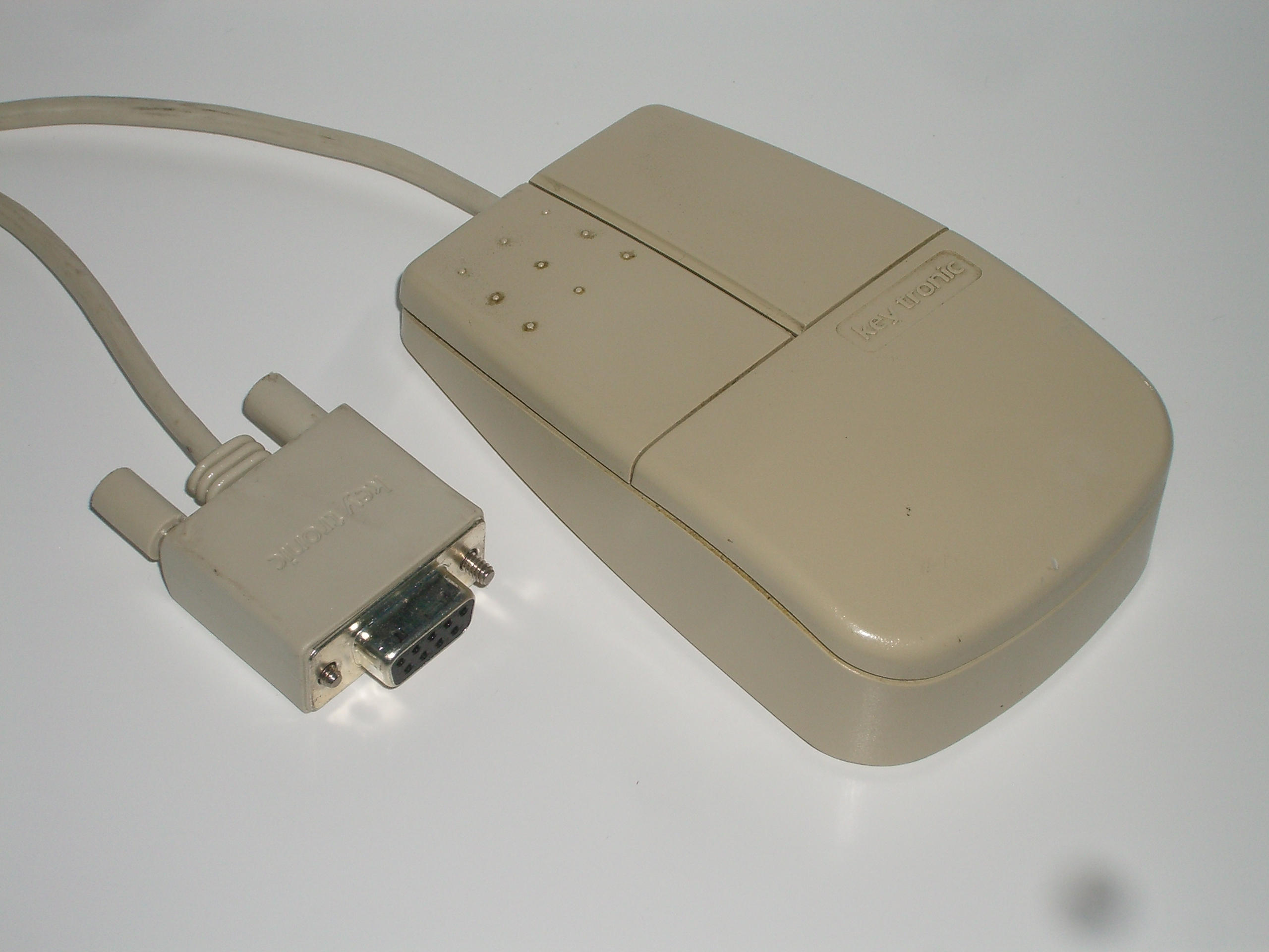

The mouse itself:
key tronic Professional Series Mouse Serial Interface.jpg (255.81 KiB) Viewed 2910 times
It leaves only one question: what do we call such a mouse?

That is quite interesting, I've never seen an electro-mechanical rotary encoder like that before, just hall-effect, optical, and the ones used in multi-meters as a rotary switch.

Internally it seems to be good build quality. Those steel shafts are about the same as the ones in Penny & giles (now US micro products) trackballs.

Flexi PCBs instead of cabling, delrin bearing sleeves and mechanical encoders that scrape their traces off after a while don't exactly scream quality to me ;)
