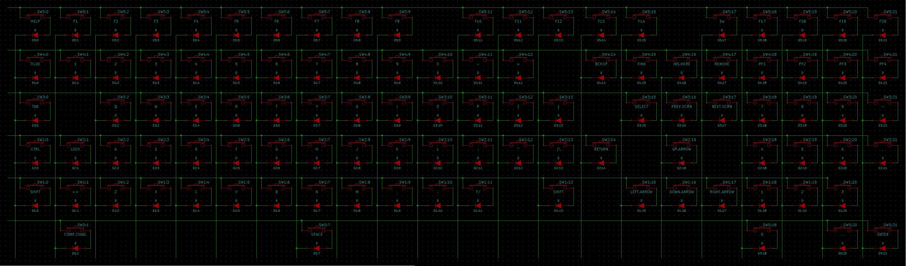

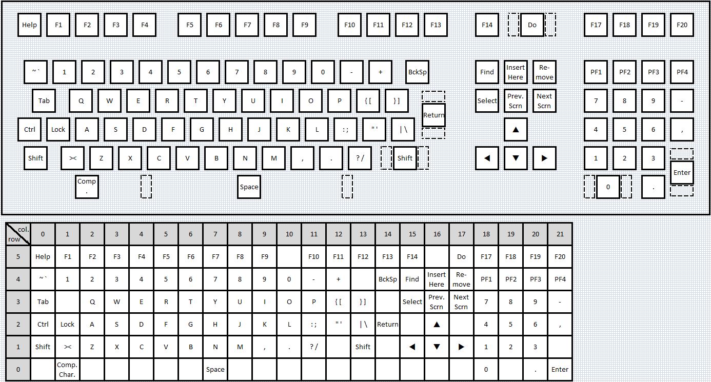

So far I've finished the switch/diode matrix in the eeschema — I've got 6 rows and 22 columns = 28 lines. But the Teensy2 controller has only 25 legs to connect the rows/columns, if I get it right (PB0..7, PC6..7, PD0..7, PE6, PF0..7 = 25 legs plus RST, AREF, 2*VCC, 2*GND). Happily, I don't need in LEDs at all.
Should I choose another controller, or is there some trick to solve this problem?
(I have empty cells in the matrix, so I could make things more tight and squeeze the matrix to 6 rows, 21 columns = 27 lines, but it would lead to further circuitry tangling, I'm afraid, and won't be the answer to this question anyway)
Thanks in advance for the answers!

You have 105 switches. As a general rule, the matrix with the least number of (rows+columns) would be as square as possible. The smallest square that would fit 105 switches is 10×11 (110 positions, 21 lines).
You could stretch that matrix out vertically and merge adjacent columns. You would have to move some switches between columns because there are only 5 empty positions compared to 27 in your original matrix.
27 Jun 2014, 16:07
When hand wiring my 63 key custom keyboard, I lazily made a 15x5 matrix, which is only 84% utilised. Of course, 20 pins was within the Teensy 2's reach anyway, so I had no reason to complicate matters. When designing your own PCB, though, you can be the judge. Teensy++ isn't cheap!

Findecanor wrote: As a general rule, the matrix with the least number of (rows+columns) would be as square as possible. The smallest square that would fit 105 switches is 10×11 (110 positions, 21 lines).
Thank you for the tips, guys!
First, I'll try to connect the Teensy 2.0++ and continue with the KiCad modelling. After finishing that, I'll try to rework the matrix as Findcanor suggested and manage with Teensy2.0. So I could understand which way is the best.

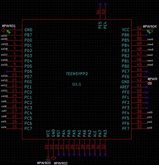

I'm trying to create the new PCB for the old WYSE terminal keyboard, it's switches are plate mounted and the plate is connected with the PCB ground; I want to do exactly the same.
So far - so good. Please, help me to clear one more thing I'm stuck with. Teensy 2++ has 2 VCC legs and 3 GND legs. I connected each VCC leg with VCC component from library and each GND leg with power port. I've called them: "Component Ground - #PWR01", "Component Ground - #PWR02", "Component Ground - #PWR05", "Component VCC - #PWR03", "Component VCC - #PWR04".
But Electric Rules Check said:
ErrType(3): Pin connected to some others pins but no pin to drive it
    @ (97,79 mm,69,85 mm): Pin 1 (power_in) of component #PWR04 is not driven (Net 42).
and highlighted one of GNDs (pin1) and one of VCCs (pin52) with the green arrows.
What am I doing wrong?
Thank you in advance for the tips!
