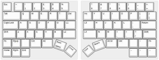

OK then... Poll over, and the only thing that stood out from the poll was to have thumb keys. :)
The most important thing we got out of it is that it is much easier to reason about a real proposal ... so here it is:
The idea is to create a split symmetric stagger keyboard, like a western answer to the µTron but with Cherry MX switches and regular key spacing.
The µTron has non-standard diagonally slanted thumb keys. To make up for that, I instead rotated the keys, and I picture that they would be mounted upside down so that they would slant towards the thumb instead of away.
The only unusually-sized keys in this layout would be the 2u Tab and the 1.25u home-row keys.

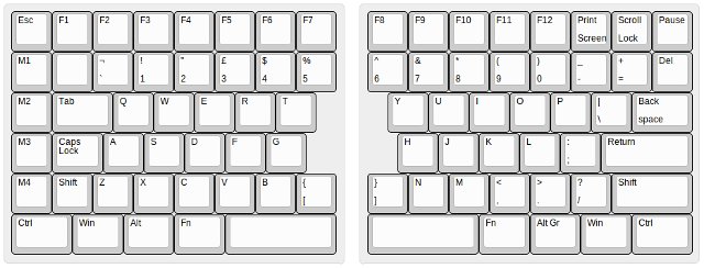

However... if you instead value function keys higher than thumb keys, you could rotate the keyboard 180° and mount a more traditional layout:
I picture the internals as being much like the ErgoDox. A double-sided 8×6 key PCB for both left and right with support for both PCB-mounted and plate-mounted switches, through-hole or SMD diodes. You practically get support for Alps automatically with a double-sided PCB - only the rotated keys and a possible ISO Return key option would be tricky.
A Teensy in one side, mounted under the next-to innermost column, but with the port sticking out. An I/O expander in the other side, but not at the opposite position of the Teensy but at the opposite position of an EEPROM chip for storing macros.
That is the idea anyway. I anticipate that there will be a few tweaks here and there to make it work.
02 Jun 2014, 18:01
Smart. I like the look of this better than the ErgoDox, which is too big for my taste. In fact, I'd lose the number row and put that on a function layer instead, but I am one of the more aggressive minimalists around.
A separate EEPROM chip to increase the Teensy's storage, eh? Interesting idea, but seems a challenge. I'm no engineer, but it sounds like a big increase in complexity.
Have you tried Soarer's controller? There's a fair bit of space left over on the Teensy's stock EEPROM for macros, which I have not come close to using up on my 60%. The numbers sound crazy small, but the community firmwares are quite efficient at using it with care.

22 Jun 2014, 16:56
Muirium wrote: A separate EEPROM chip to increase the Teensy's storage, eh? Interesting idea, but seems a challenge. I'm no engineer, but it sounds like a big increase in complexity.
There is firmware for the ErgoDox that already supports it. You put the EEPROM on the same I²C bus as the I/O expander and the µC accesses it with a different address.
Muirium wrote: There's a fair bit of space left over on the Teensy's stock EEPROM for macros, which I have not come close to using up on my 60%.
There is only one kilobyte of internal EEPROM. There is more in the program Flash, but you want to keep that for program code that is separate from user-defined macros.
22 Jun 2014, 16:58
True. Soarer's using it very efficiently though, so I've not had any problems. Different story when I try to make my Teensy powered keyboard converter box store several whole classes of layouts at once.
