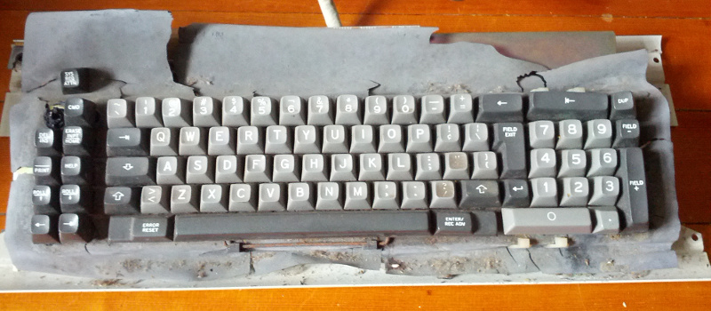

I bought a beam spring board on Ebay a while ago. It was probably overpriced but I was greedy and stupid. With xwhatsit making controllers for them now I decided to check out the condition and see if I can't get it to work.
Here are some pictures:
The foil is probably supposed to protect it from dirt but over the year it seems to have to turned into the very thing it is supposed to fend off.

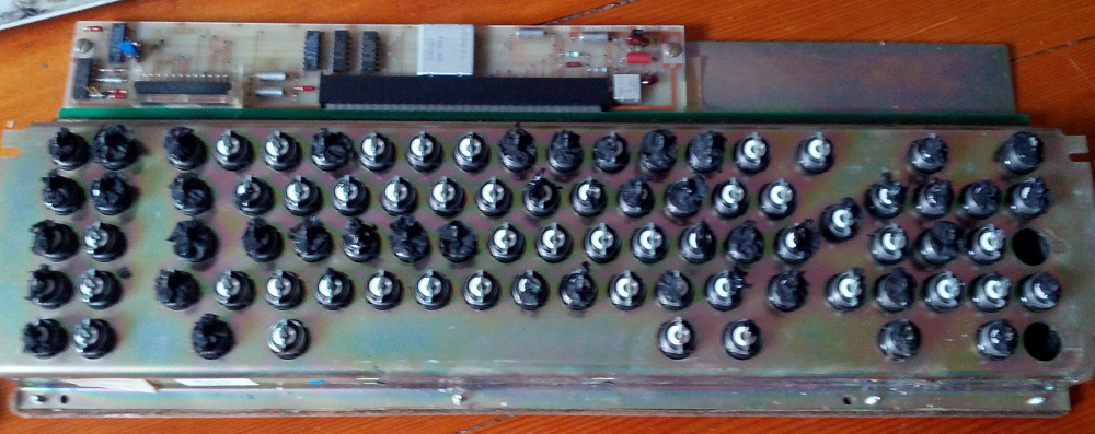

Stabs are a bit rusty, too.
Under it, it does however look better.

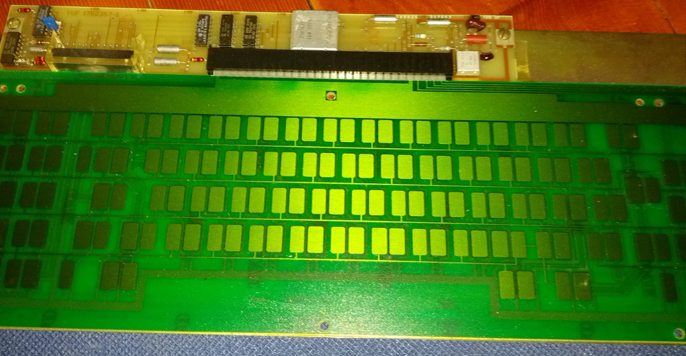

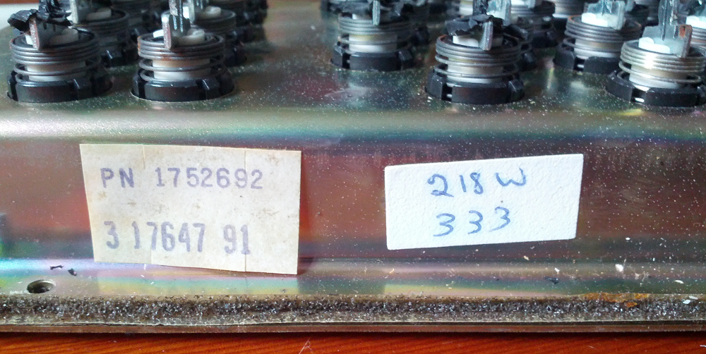

Oh hey, I found some ID.

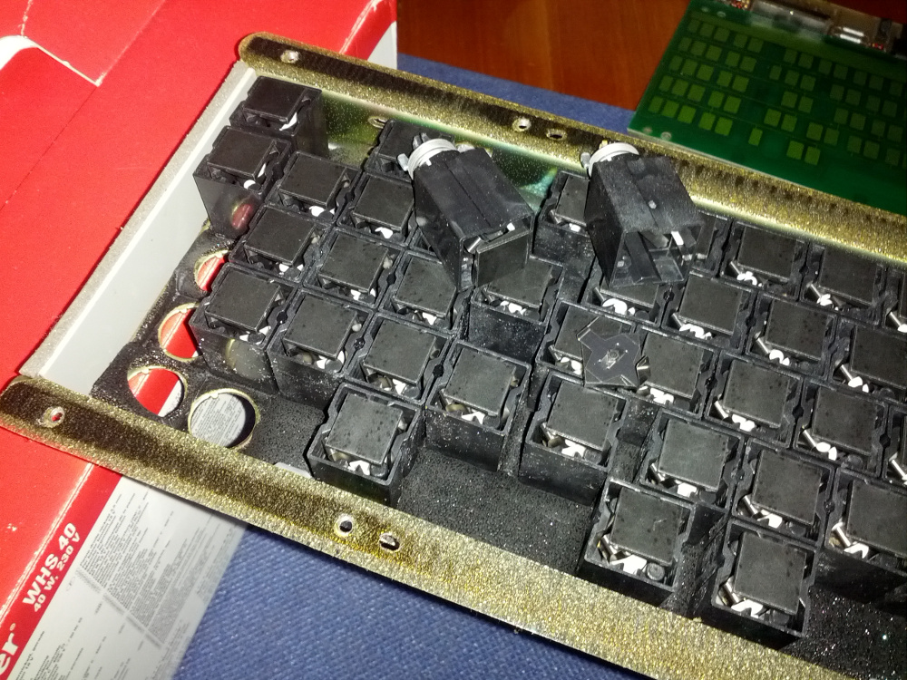

A few more screws and we're finally getting to the good parts.

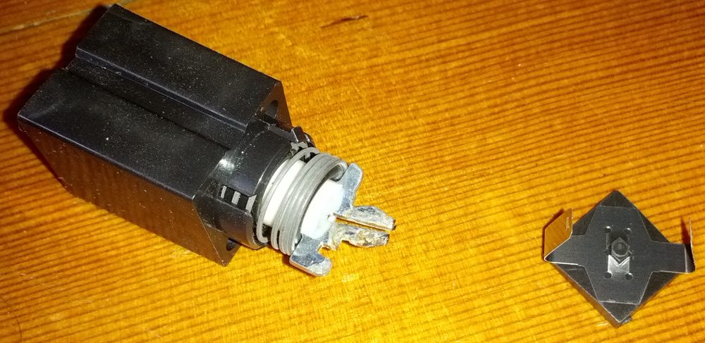

Now I need your help, the metal part which holds the caps is bent on some of the switches and I would like to remove the to straighten them out. Does anybody know how?

I just took webwit's advice and hit it with a hammer. (I knew I could always sue webwit if anything went wrong :D)
Those contamination shields are always in a pitiful state, but at least they usually protect the rest of the keyboard from getting ruined, no matter how badly it was stored.

I was pretty surprised that the just used some sort of rubber and then pressed the keys on over it.

How does beam spring's underside compare to Model F's flip plates? Do those squares pop up when the switch is activated? It looks a lot like its descendant, especially on the PCB, but I read in Xwhatsit's documentation that beam spring is the reverse polarity, capacitance wise, compared to buckling spring.
Yes. As you push down when you reach the activation point the fly plate pulls up and the key activation force just drops. Has a great feel to it.

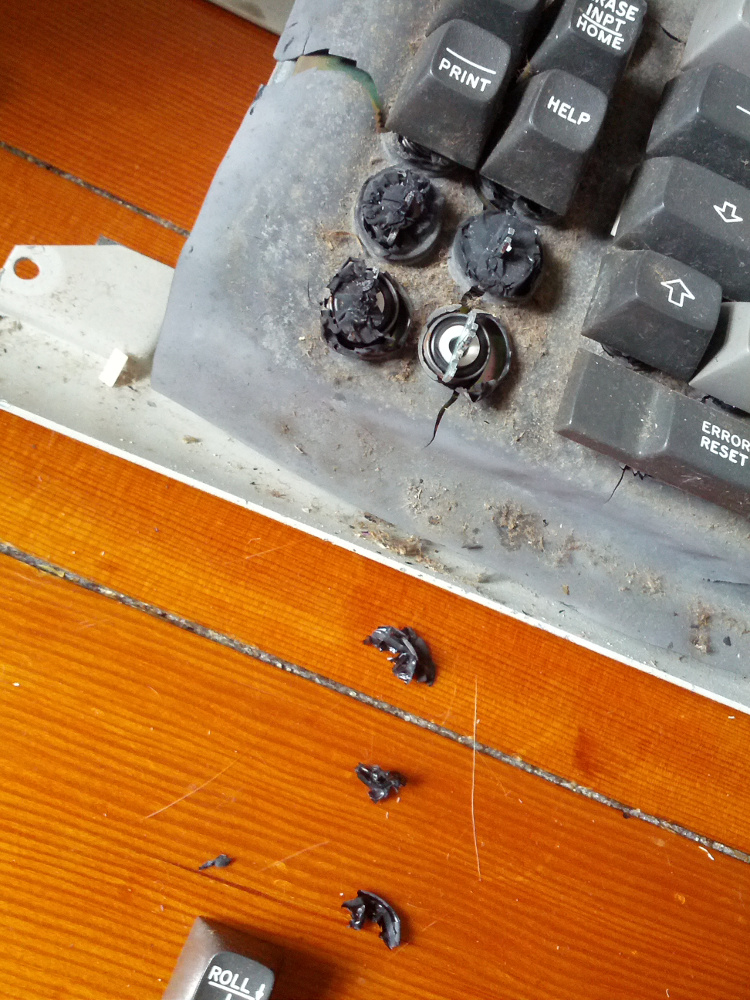

I experimented with different kinds of foils to replace the contamination shields, but I haven't found a good solution yet.
You have to put a lot of extra foil between the switches to keep them from interacting with one another (neighbour keycaps moving when you press down a key)
But the more extra foil you put there, the more foil rustling you hear when typing, which for some reason annoys me a lot.
I had the best results with really thin Saran wrap (clingwrap) so far, but it's still not ideal, both silent high-pitched rustling and some crosstalk between key caps.
I wonder how the original shields were made and if there is a way to imitate that. What I would need is something like a thermoplastic rubber material, but not shrinking but kind of adopting to the surface. I thought about using something like those silicons that become rubber-like when hardening (think bathroom gaps), but I don't really know how to apply that without risking it to contaminate every gap in the keyboard.

My guess would be the original shield were put into a heated press that had the shape of the keyboard assembly. So it was molded before it made it to the keyboard, then it was placed and those little "doilies" on each key were added.
I don't think it was a one step process where a flat piece of material was added to the keyboard.

Has anyone taken apart a beam spring switch? I don't mean just removing the fly plate, but removing the metal stem, white plunger, circular spring from the black shell and each other.
And if so, have you managed to reassemble it? I've done the fly plate, which is just loads of fun...

Well, I pulled really hard on one of the metal stems but couldn't get it out. That's what I was asking earlier...
Oh and I just looked through http://deskthority.net/wiki/IBM_Beam_Spring_Keyboards but couldn't find this exact board. Does anybody know what it is?
5251

Halvar wrote:I experimented with different kinds of foils to replace the contamination shields, but I haven't found a good solution yet.
Here's how I did it: linky
YMMV :D

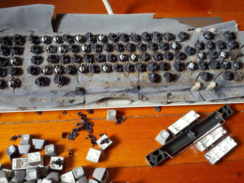

Are you guys really that concerned about contamination? I have mine with the shield removed and no plans on replacing it.

I haven't replace my contamination shield and have no problems at all so far. I do cover the keyboard when I'm not at the PC though.

Muirium wrote:How does beam spring's underside compare to Model F's flip plates? Do those squares pop up when the switch is activated? It looks a lot like its descendant, especially on the PCB, but I read in Xwhatsit's documentation that beam spring is the reverse polarity, capacitance wise, compared to buckling spring.
Yes, the "fly plate" (to use IBM's terminology) retracts back into the switch housing when the switch actuates, so it moves away from the contact pad instead of moving towards it as in the Model F. You can place a Beam Spring on top of a Model F contact pad, but the Model F's controller will think that the switch at rest has been pressed, and that its at rest when you press it.
Regarding talk of dismantling the switch - I tried it once, and my conclusion was that this was not possible without breaking the switch, but if someone more adventurous (and with more spare beam springs) wants to try, I'd love to see the photos ;)
Regarding the bent keycap mounts, IBM mentioned this in their maintenance manuals, I think you can twist them without dismantling the switch.

My daily-driver 3727 gets a lot of use at work, and I removed the shield from it about 6 months ago. It was originally in good condition, but with the keyboard getting heavy use it fell to bits.
Since doing that, I have had to take the back off it again twice to clean it. The first time might have just been residual shield bits filtering through the switches (I didn't strip down each switch, as it appears the flyplate it somewhat fragile). However the second time definitely had a few beard hairs in the mix... :?

Absolutely—I started getting glitchy keys that would repeat or just go off spamming by their own. Initially I had a fright that there was something wrong with my controller, but after viewing traces on the oscilloscope I could see that those keys were actually higher capacitance for whatever reason—and it seems a bit of flaky rubber shield or hair is enough to cause that. Removing the foreign matter resolved the problem immediately.
M's of course would need a small brick or pebble to cause a misfire, being ohmic switched rather than capacitive. The Fs are much more sealed up generally, and with the higher levels of capacitance they produce even if there was dirt in the right place there would need to be much more of it to reach such a threshold. The fact that they're `normally open' w.r.t. capacitance may help here too; foreign matter is likely to inhibit capacitance (by holding the flyplate or foot up from the PCB, or interfering by being a poor dielectric etc.), and with the beamsprings, they are higher capacitance when unpressed, unlike the Model Fs. If you have a 1-in-a-1000-scan glitch because of some fluff in your key, this is enough to cause a key to do a fake press on a beamspring, but will only cause a momentary delay or unintended double-press on a Model F when you *are* actually pressing the key.
