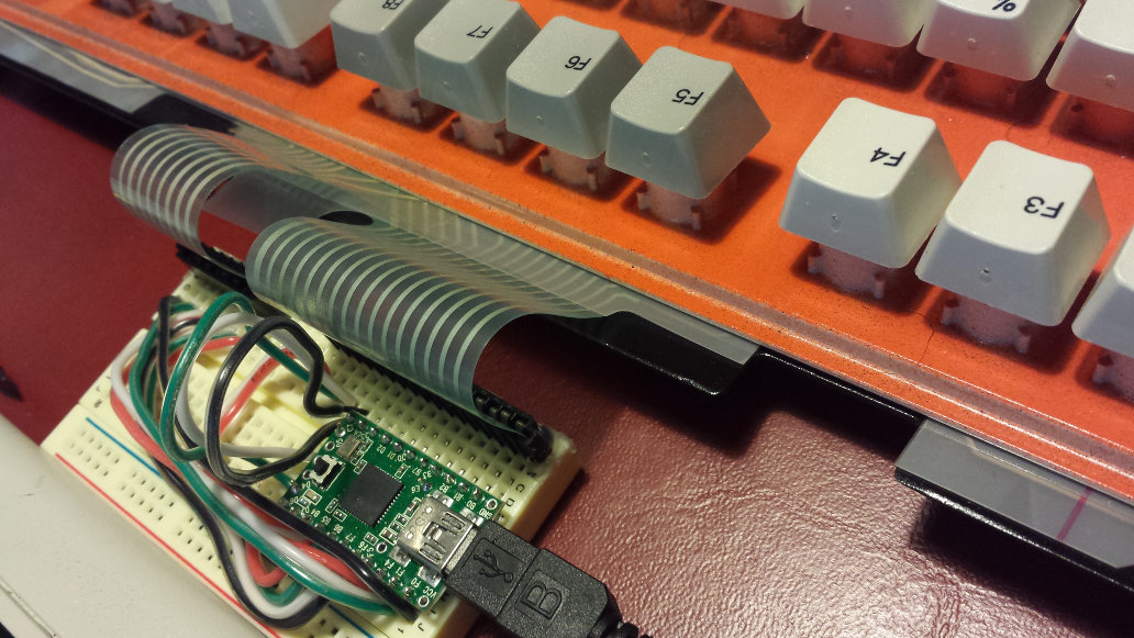

Hiyo!
I'm sure someone has already done this, but I haven't found it, so hopefully this helps.
I'm a hardware guy. I've always meant to get into coding, and this little project really gave me a nice 101 crash course. Still not entirely sure what I'm doing, but I have a fuzzy idea... :P
THANK YOU HASU FOR YOUR AWESOME WORK! ^_^
And thank you matt3o for your very awesome intro guide to his firmware!
2014-06-01 19.14.12.jpg (176.82 KiB) Viewed 13044 times

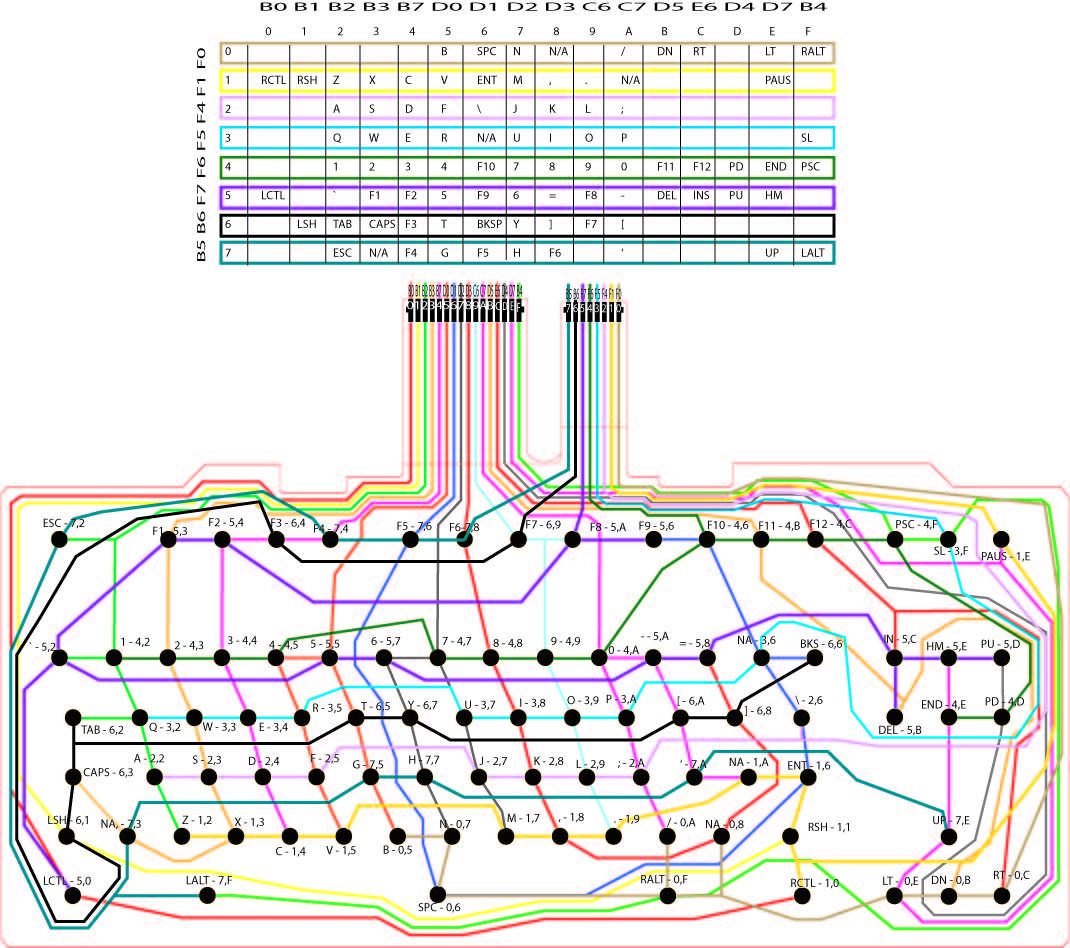

Layer 2 - COLOR MATRIX COMBINED.jpg (747.68 KiB) Viewed 13044 times
#define KEYMAP_ANSI( \
    K72, K53, K54, K64, K74, K76, K78, K69, K59, K56, K46, K4B, K4C, K4F, K3F, K1E, \
    K52, K42, K43, K44, K45, K55, K57, K47, K48, K49, K4A, K5A, K58,      K66, K5C, K5E, K5D, \
    K62, K32, K33, K34, K35, K65, K67, K37, K38, K39, K3A, K6A, K68, K26, K5B, K4E, K4D, \
    K63, K22, K23, K24, K25, K75, K77, K27, K28, K29, K2A, K7A,      K16, \
    K61,      K12, K13, K14, K15, K05, K07, K17, K18, K19, K0A,      K11, K7E, \
    K50, K7F,                K06,                K0F, K10, K0E, K0B, K0C \
    { KC_NO,	KC_NO,	  KC_NO,    KC_NO,    KC_NO,    KC_##K05, KC_##K06, KC_##K07, KC_NO,    KC_NO,    KC_##K0A,  KC_##K0B, KC_##K0C, KC_NO,   KC_##K0E, KC_##K0F }, \
    { KC_##K10, KC_##K11, KC_##K12, KC_##K13, KC_##K14, KC_##K15, KC_##K16, KC_##K17, KC_##K18, KC_##K19, KC_NO,    KC_NO,    KC_NO,    KC_NO,    KC_##K1E, KC_NO }, \
    { KC_NO,    KC_NO,    KC_##K22, KC_##K23, KC_##K24, KC_##K25, KC_##K26, KC_##K27, KC_##K28, KC_##K29, KC_##K2A, KC_NO,    KC_NO,    KC_NO,    KC_NO,    KC_NO }, \
    { KC_NO,    KC_NO,    KC_##K32, KC_##K33, KC_##K34, KC_##K35, KC_NO,    KC_##K37, KC_##K38, KC_##K39, KC_##K3A, KC_NO,    KC_NO,    KC_NO,    KC_NO,    KC_##K3F }, \
    { KC_NO,    KC_NO,    KC_##K42, KC_##K43, KC_##K44, KC_##K45, KC_##K46, KC_##K47, KC_##K48, KC_##K49, KC_##K4A, KC_##K4B, KC_##K4C, KC_##K4D, KC_##K4E, KC_##K4F }, \
    { KC_##K50, KC_NO,    KC_##K52, KC_##K53, KC_##K54, KC_##K55, KC_##K56, KC_##K57, KC_##K58, KC_##K59, KC_##K5A, KC_##K5B, KC_##K5C, KC_##K5D, KC_##K5E, KC_NO },  \
    { KC_NO,    KC_##K61, KC_##K62, KC_##K63, KC_##K64, KC_##K65, KC_##K66, KC_##K67, KC_##K68, KC_##K69, KC_##K6A, KC_NO,    KC_NO,    KC_NO,    KC_NO,    KC_NO },  \
    { KC_NO,    KC_NO,    KC_##K72,    KC_NO,    KC_##K74, KC_##K75, KC_##K76, KC_##K77, KC_##K78, KC_NO,    KC_##K7A, KC_NO,    KC_NO,    KC_NO,    KC_##K7E, KC_##K7F }  \
const uint8_t PROGMEM keymaps[][MATRIX_ROWS][MATRIX_COLS] = {
    /* 0: qwerty */
    KEYMAP_ANSI(
        ESC, F1,   F2,  F3,   F4,   F5,   F6,   F7,   F8,   F9,   F10,   F11,   F12,   PSCR,   SLCK,   PAUS, \
        GRV, 1,   2,   3,   4,   5,   6,   7,   8,   9,   0,   MINS,   EQL,   BSPC,   INS,   HOME,   PGUP, \
        TAB, Q,   W,   E,   R,   T,   Y,   U,   I,   O,   P,   LBRC,   RBRC,  BSLS, DEL, END, PGDN, \
        CAPS, A,   S,   D,   F,   G,   H,   J,   K,   L,   SCLN, QUOT, ENT, \
        LSFT, Z,   X,   C,   V,   B,   N,   M,   COMM, DOT, SLSH, RSFT, UP,\
        LCTL,   LALT,   SPC,   RALT,   RCTL,   LEFT, DOWN, RIGHT),
/* Column pin configuration
 * col: 0   1   2   3   4   5   6   7   8   9   10   11  12  13  14  15
 * pin: B0  B1  B2  B3  B7  D0  D1  D2  D3  C6  C7  D5  E6  D4  D7  B4
static void  init_cols(void)
    // Input with pull-up(DDR:0, PORT:1)
    DDRE  &= ~(1<<6);
    PORTE |=  (1<<6);
    DDRD  &= ~(1<<7 | 1<<5 | 1<<4 | 1<<3 | 1<<2 | 1<<1 | 1<<0);
    PORTD |=  (1<<7 | 1<<5 | 1<<4 | 1<<3 | 1<<2 | 1<<1 | 1<<0);
    DDRC  &= ~(1<<7 | 1<<6);
    PORTC |=  (1<<7 | 1<<6);
    DDRB  &= ~(1<< 7 | 1<<4 |1<<3 | 1<<2 | 1<<1 | 1<<0);
    PORTB |=  (1<< 7 | 1<<4 |1<<3 | 1<<2 | 1<<1 | 1<<0);
static matrix_row_t read_cols(void)
    return (PINB&(1<<0) ? 0 : (1<<0)) |
           (PINB&(1<<1) ? 0 : (1<<1)) |
           (PINB&(1<<2) ? 0 : (1<<2)) |
           (PINB&(1<<3) ? 0 : (1<<3)) |
           (PINB&(1<<7) ? 0 : (1<<4)) |
           (PIND&(1<<0) ? 0 : (1<<5)) |
           (PIND&(1<<1) ? 0 : (1<<6)) |
           (PIND&(1<<2) ? 0 : (1<<7)) |
           (PIND&(1<<3) ? 0 : (1<<8)) |
           (PINC&(1<<6) ? 0 : (1<<9)) |
           (PINC&(1<<7) ? 0 : (1<<10)) |
           (PIND&(1<<5) ? 0 : (1<<11)) |
           (PINE&(1<<6) ? 0 : (1<<12)) |
           (PIND&(1<<4) ? 0 : (1<<13)) |
           (PIND&(1<<7) ? 0 : (1<<14)) |
           (PINB&(1<<4) ? 0 : (1<<15));
/* Row pin configuration
 * row: 0   1   2   3   4   5   6   7
 * pin: F0  F1  F4  F5  F6  F7  B6  B5
static void unselect_rows(void)
    // Hi-Z(DDR:0, PORT:0) to unselect
    DDRF  &= ~0b11110011;
    PORTF &= ~0b11110011;
    DDRB  &= ~0b01100000;
    PORTB &= ~0b01100000;
static void select_row(uint8_t row)
    // Output low(DDR:1, PORT:0) to select
    switch (row) {
        case 0:
            DDRF  |= (1<<0);
            PORTF &= ~(1<<0);
            break;
        case 1:
            DDRF  |= (1<<1);
            PORTF &= ~(1<<1);
            break;
        case 2:
            DDRF  |= (1<<4);
            PORTF &= ~(1<<4);
            break;
        case 3:
            DDRF  |= (1<<5);
            PORTF &= ~(1<<5);
            break;
        case 4:
            DDRF  |= (1<<6);
            PORTF &= ~(1<<6);
            break;
        case 5:
            DDRF  |= (1<<7);
            PORTF &= ~(1<<7);
            break;
        case 6:
            DDRB  |= (1<<6);
            PORTB &= ~(1<<6);
            break;
        case 7:
            DDRB  |= (1<<5);
            PORTB &= ~(1<<5);
            break;
I'm happily typing on my SSK at the moment. Yay!
Next up is to etch some PCB's.

Can't really help you, just a quick Thank You for that matrix graph for the Model M and the matrix code. I might use that in the future, as my SSK came with a terminal controller.

Halvar wrote:Can't really help you, just a quick Thank You for that matrix graph for the Model M and the matrix code. I might use that in the future, as my SSK came with a terminal controller.
Hey no problem! It'd be a shame to keep it and all of its color coded prettiness to myself - I'm glad it helps!

Thanks for posting this. It never dawned on me that the membrane leads are on 100 mil centers, but they obviously are if you have it plugged into a breadboard. Here I was thinking I'd need to lay out a custom PCB just to utilize the connectors. :roll: I have a nice Wheelwriter keyboard I'd like to make a controller for.

quantalume wrote:Thanks for posting this. It never dawned on me that the membrane leads are on 100 mil centers, but they obviously are if you have it plugged into a breadboard. Here I was thinking I'd need to lay out a custom PCB just to utilize the connectors. :roll: I have a nice Wheelwriter keyboard I'd like to make a controller for.
Yeah it's rather convenient! Either desolder them from a dead board, or as far as I can tell, Mouser sells them.

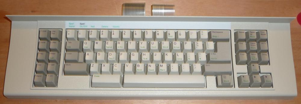

I'm thinking of making a "universal" Model M to Teensy 2.0 PCB. The idea is that, regardless of which Model M you have, you can solder in the appropriately-sized membrane connectors and solder in a Teensy, and you're good to go. Any other configuration would take place in software.
What I've been able to discern based on my Model M inventory is that the spacing between the row and column connectors is 0.685 inches (closest conductors, center-to-center), regardless of the specific configuration (84/85, 101/102, Wheelwriter, etc). There are 15 or 16 columns and 8 or 15 rows (the Wheelwriter board I have has 15 row positions, of which only 8 are used). The 122-key board has 20 columns, so it's impossible to use a Teensy on it unless you place an external latch and make the appropriate modifications to the firmware.
