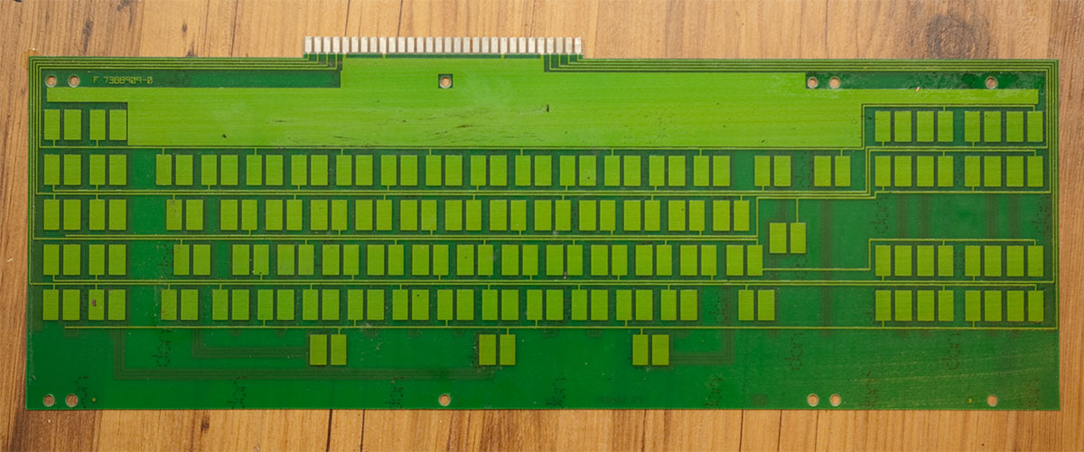

Hypersphere wrote:Is it possible to move any switches around on this keyboard to achieve something like an ANSI mod or beyond? For example, on my other keyboards, I have been rearranging things so that I end up with a standard ANSI Return key and a Backspace key directly above the Return. This might depend, in part, on finding suitable substitute keys from sources such as Selectric typwriters.
On the 3278, there is only one "dummy" switch, and it serves as a stabilizer for the space bar. I suspect that the DW has two or three: one for the space bar, one for the Return key and possibly one for the right shift. Those would be your only options for gaining positions. Maybe someone who has actually had one apart can enlighten us as to whether or not there are spare pad positions.

kps
10 Jun 2014, 04:15
quantalume wrote:Maybe someone who has actually had one apart can enlighten us as to whether or not there are spare pad positions.
There's only one extra position, at the right of the space bar.

I'm confused about the extra pad to the right of the space bar. On my DW, there is already a modifier key on each side of the space bar. On the left is "Code" (missing from my DW) and on the right is "Enter". This "Enter" key is separate from the backwards-L-shaped "Return" key.
Looks like I won't be able to put a Backspace immediately above the Return key.
