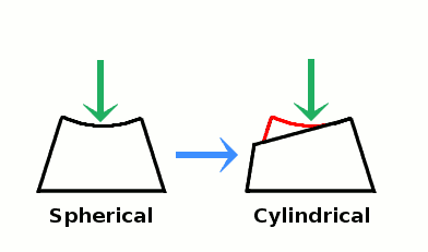

Spherical keycaps is the old norm. Cylindrical keycaps were developed from spherical keycaps to make it easier and cheaper to print on them. They are supposed to be typed the same way.
To compensate for the lack of a vertically curved front rim, the cylindrical keycaps are often angled more.
The flattening of the top/back edge has the effect that it is easier to avoid hitting the keycap on a lower row when pressing down a key, thus promoting a "flatter" way of typing, with your wrists resting on the desk. That is really the most significant difference.
By the way, there are vintage keyboards where the key top is more U-shaped with the print on the cylindrical part, but with still a spherically shaped front rim.

Nice drawing Findecanor :) I had not realized that. Question then is: what is more relaxed,

Muirium wrote:SA has similar row profiles to cylindrical caps: the top surface is tilted.
Findecanor's diagram better describes DSA.
It's supposed to be an illustration, not a blueprint. But no, for home row or for curved backplane. DSA is like home-row SA that have been lowered and given more texture.
SA is contoured with ~6.6° difference between rows. DCS is contoured with ~4.4° angle between rows, so they can't be compared directly one to another.

My experience is with Cylindrical OEM and DCS caps and DSA . I prefer DSA, the surface is spherical , a general flat feeling, low, little gaps between the caps, is just perfect for my style of typing, which is a non conventional one (my fingers fly around the board left to right with no standard rule, that's why I find it impossible to type on an ErgoDOX) .
The Cylindrical caps are ok'sh , on my HHKB I like them, maybe also the Topre switches help along, but on the Poker I don't like them as much, too tall, too much space between the caps.
Recently I received a bunch of SA caps, just enough to make some tests, all Row 3, but nevertheless I got some picture of how they feel. I didn't like the feeling at all, too high and wobbly, I'll wait for my Round 5 caps to test a full keyboard with all the profiles, maybe I will change my mind, but I have my doubts.

- Sphericals! The deep-dish F and J keys on a beamspring are so satisfying. Little F and J nubs get in the way forever after.
- Float, don't let your wrists lie down. Don't you remember your piano lessons?
- Vim escape-key-syndrome—why are you still using escape? Home row baby! Ctrl-[ is way easier once you get used to it (as long as you have Ctrl in the One True Position (what is Caps Lock?))
