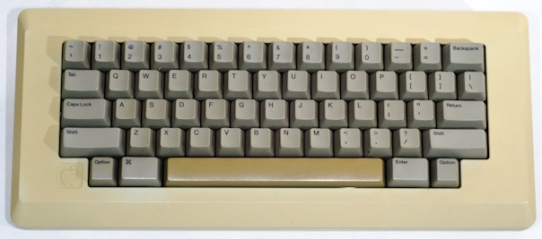

There have been some excellent posts on DT and elsewhere about modding the Apple Mac M0010 keyboard.
http://www.avernus.com/~gadams/hardware ... ayout.html
The mods were beautiful, but they involved completely desoldering the switches and then rewiring them.
http://deskthority.net/workshop-f7/the- ... t1067.html
http://deskthority.net/workshop-f7/my-c ... t5772.html
I am interested in the possibility of doing a minimal mod of this keyboard consisting of Hasu's converter and making the locking CapsLock key into a normal key that I could then remap as a Control key. At this stage, I don't think I want to remove the PCB and rewire all the switches.
To do the CapsLock to Control key transformation, would I need to desolder the switch and replace it with a spare normal switch from another M0110 keyboard, or could I simply remove the locking mechanism and Dremel off the peg from under the keycap?
Thanks for your advice and suggestions!

20 Jun 2014, 01:40
Have you got the M0110s yet? I guess it depends on condition.
Mine is in pretty good shape, and I haven't the heart to fiddle with it. I'm just going to install Hasu's M0110 specific converter, once I've cleaned the faint whiff of smoking out. I cleaned the caps when I first got it, but this is coming from under the plate I think.
Lowpoly's the man to ask, as his mod is legend. He swapped the latching key for an instantaneous one (from his backup keyboard), judging by the bit in his guide we shows how to mod the cap's mount, which is a different height on that single switch. Seems a lot of work if you ask me. And not in the vein of keyboard Buddhism! Latches are awesome, and every keyboard wants one really.

Thanks for the always insightful insights. Just found a couple of M0110s at a reasonable price. I've always been drawn to the M0110 owing to its symmetry and resemblance to the HHKB. Although I appreciate preservation and the novelty of a latching key on a computer keyboard, I also like to have my Ctrl key and to have it where it belongs -- where the Caps Lock often sits.

@Hypersphere: Removing the pcb will make the M0110 much more quiet. You can also replace the springs so the switches are lighter. If you really want to use it I would recommend this.
Otherwise, I'd just replace the switch. The latches break easily when you try to remove it with the pcb in place and I think in can't be modded into a regular switch but my memory may fail me here. If you can't find a replacement switch in the US let me know and I'll send you one.

Hypersphere wrote: To do the CapsLock to Control key transformation, would I need to desolder the switch and replace it with a spare normal switch from another M0110 keyboard, or could I simply remove the locking mechanism and Dremel off the peg from under the keycap?
Right. You need to file down the CapsLock like top right of my photo. Top left shows intact CapsLock of M0110.
Or you can harvest CapsLock from old darker color *Mitsumi* M0110A(bottom left), it is perfectly fits without filing. Bottom right is platinum color Mitsumi cap. As you can see Mitsumi caps are thiner than Alps unfortunately.
