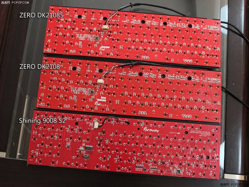

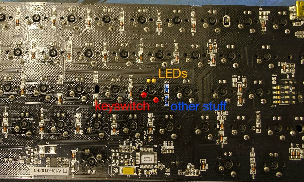

I saw LED mode guide of Fnzzy on Poker II. After seeing the Poker II board, I realized that they are the same with Ducky Zero 2108.
Ducky pcb
Poker II pcb
Since 2108S is an upgraded 2108 and the board are the same including chip, does it mean LED mod will work on 2108? My friend has Ducky 2108 and currently looking for LED for testing. Hopefully we can simply plug it til the tip of LED reaches the pcb to test before we proceed to dismantle the KB and void the warranty :D Will it light even just 1 bulb connected? Of course we know the Fn control to chance light mode.

Myk! wrote:Hopefully we can simply plug it til the tip of LED reaches the pcb to test before we proceed to dismantle the KB and void the warranty :D Will it light even just 1 bulb connected? Of course we know the Fn control to chance light mode.
You can, I if it doesn't work turn the led around. I did it with my keyboard, before committing to a full led job.

My friend tried inserting the led but didnt light up.
Dismantled the keyboard, stick the led to pcb (not soldered), didnt work too.
If the LEDS are not complete or missing 1 bulb, will other bulbs still light up? Hope someone can confirm this.

I did it on a Razer blackwidow 2013.
I put the led in and wiggled it until it made contact. It didn't work, so I turned it around (changed the pins from left to right).
Then it worked, with only one led.
