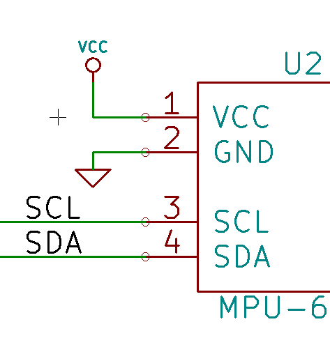

It seems to be OK. The common way to connect VCC and GND to the schematic, or at least the way I do it is this:
But it should be OK the way you did it, too.
I suggest that you post the project files again when you have imported the netlist into the PCB and placed the components. I will look at it again.
