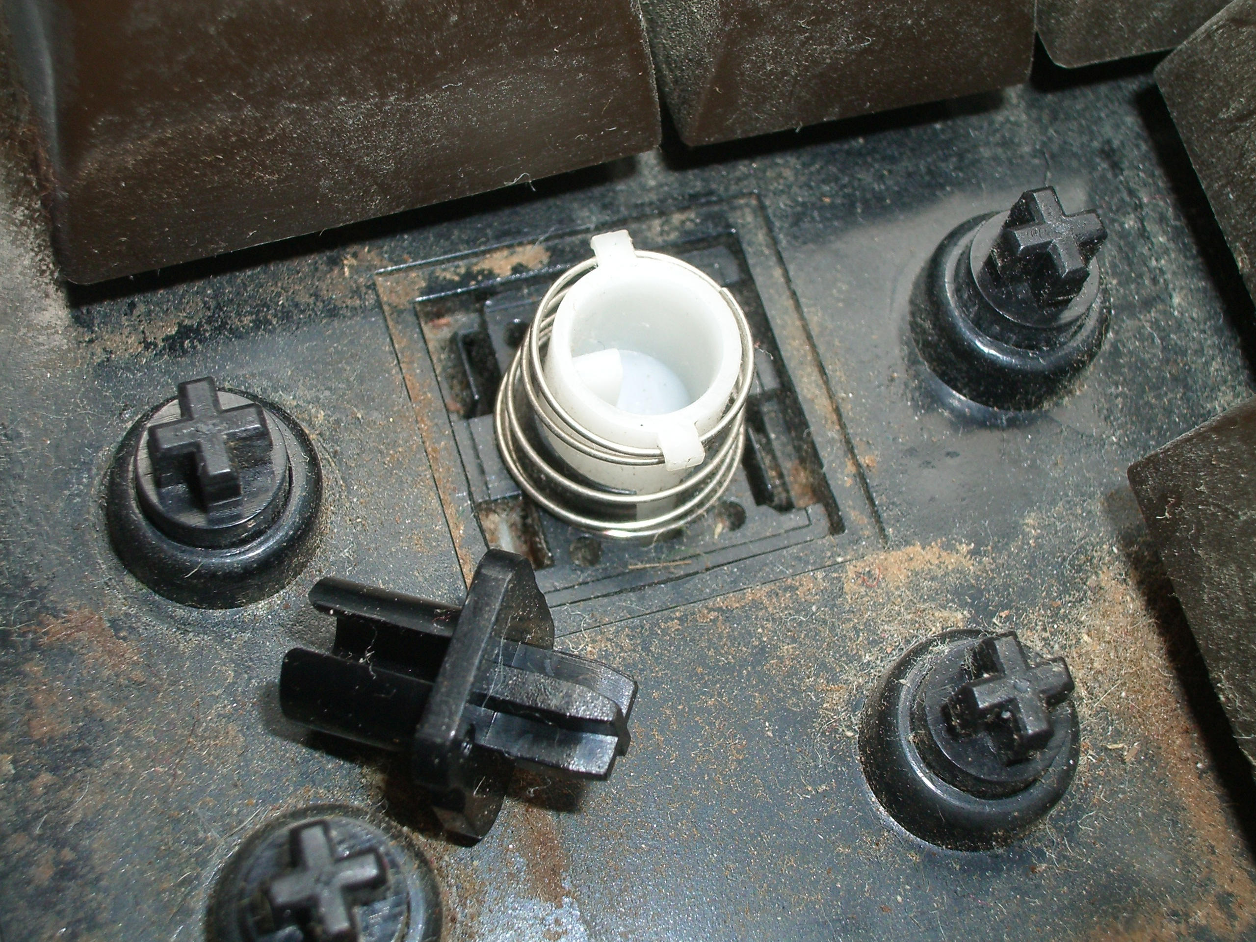

The shift lock switch on a Commodore 64 keyboard is a latching switch, but it's not the normal [wiki]Mitsumi standard mechanical lock[/wiki], nor is it [wiki]Mitsumi membrane lock[/wiki].

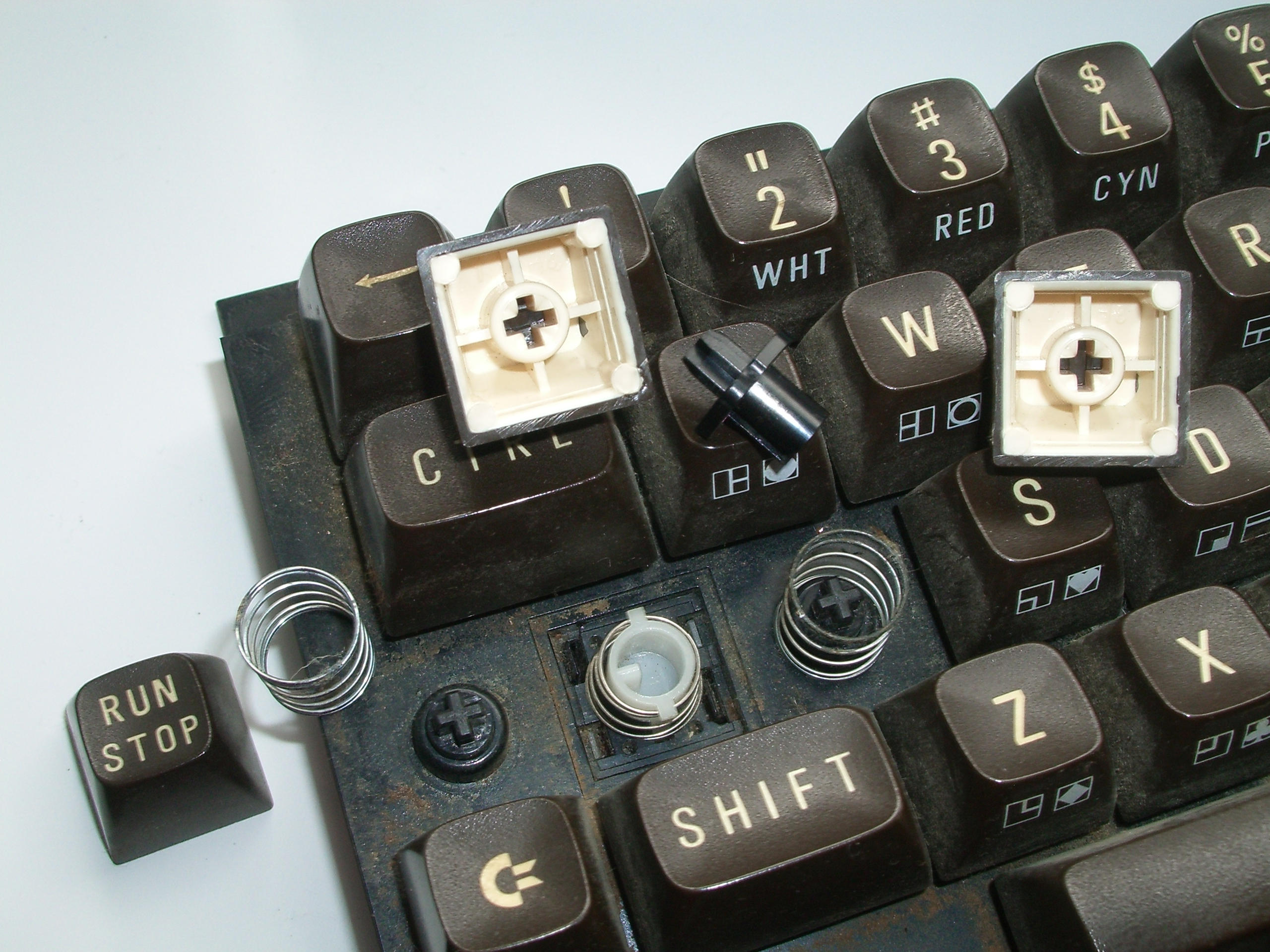

It's a whole new switch I've never seen before. The following pictures are preliminary, as the keyboard is absolutely filthy. The keycaps are double-shot.
C64 01 switches.jpg (604.52 KiB) Viewed 5166 times
I assume the regular switches are a form of [wiki]Mitsumi hybrid switch[/wiki], but I've yet to check.
Shift lock has a non-keyboard mount, suggesting it's not meant for keyboards at all. An adapter provides the cruciform mount used by the rest of the keyboard:
C64 02 shift lock switch and slider adapter.jpg (923.66 KiB) Viewed 5166 times

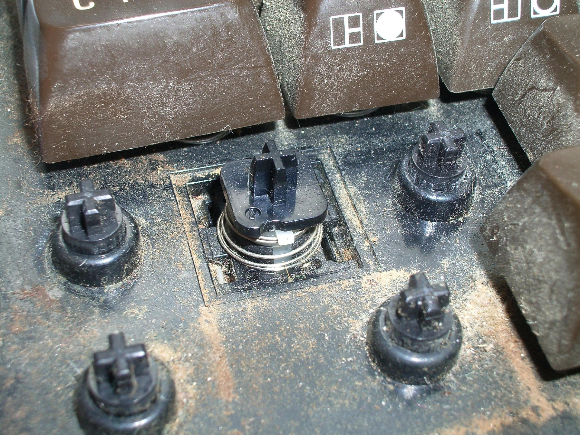

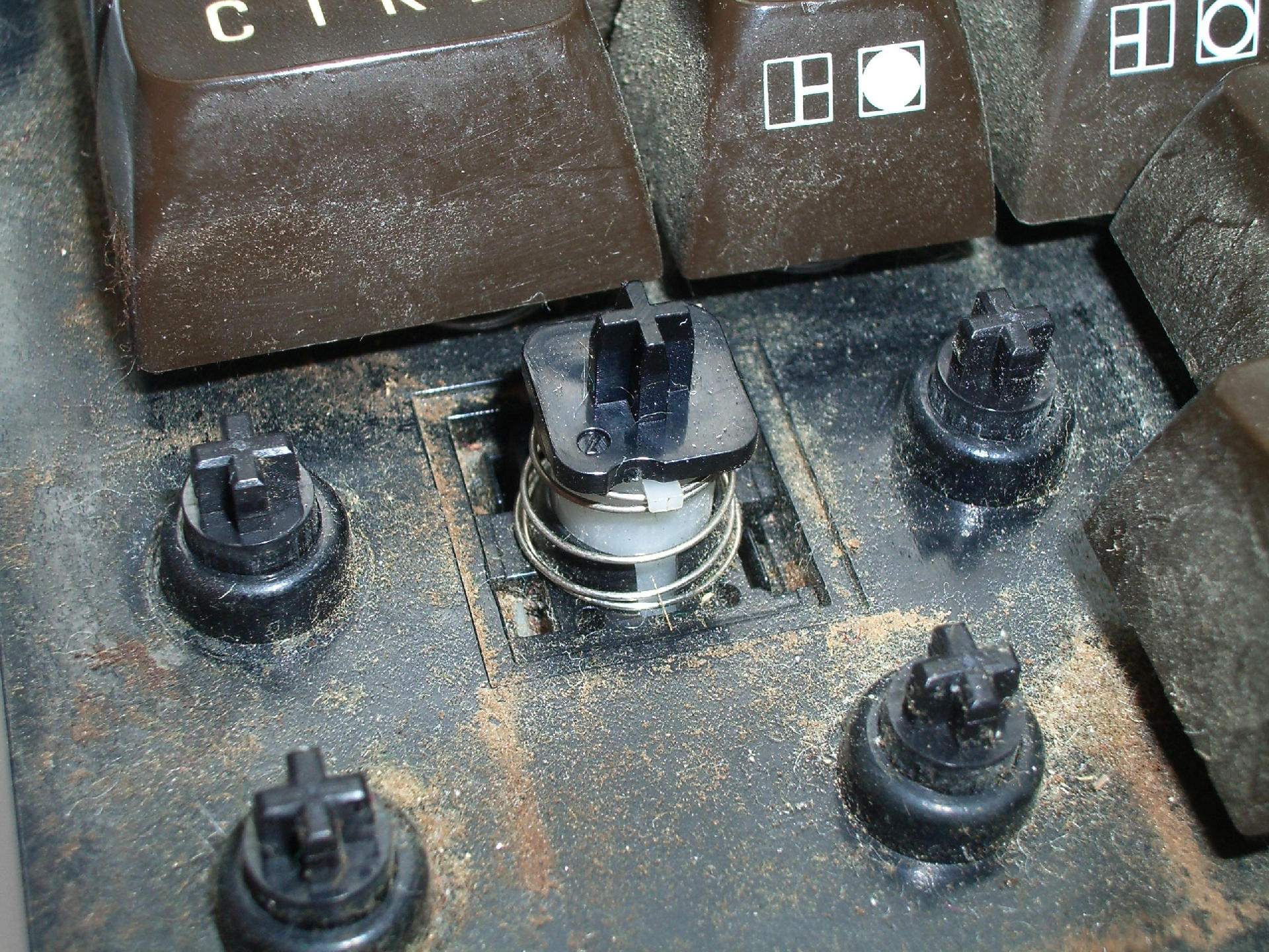

Released and latched states:
C64 03 shift lock released.jpg (678.86 KiB) Viewed 5166 times
C64 04 shift lock latched.jpg (714.48 KiB) Viewed 5166 times

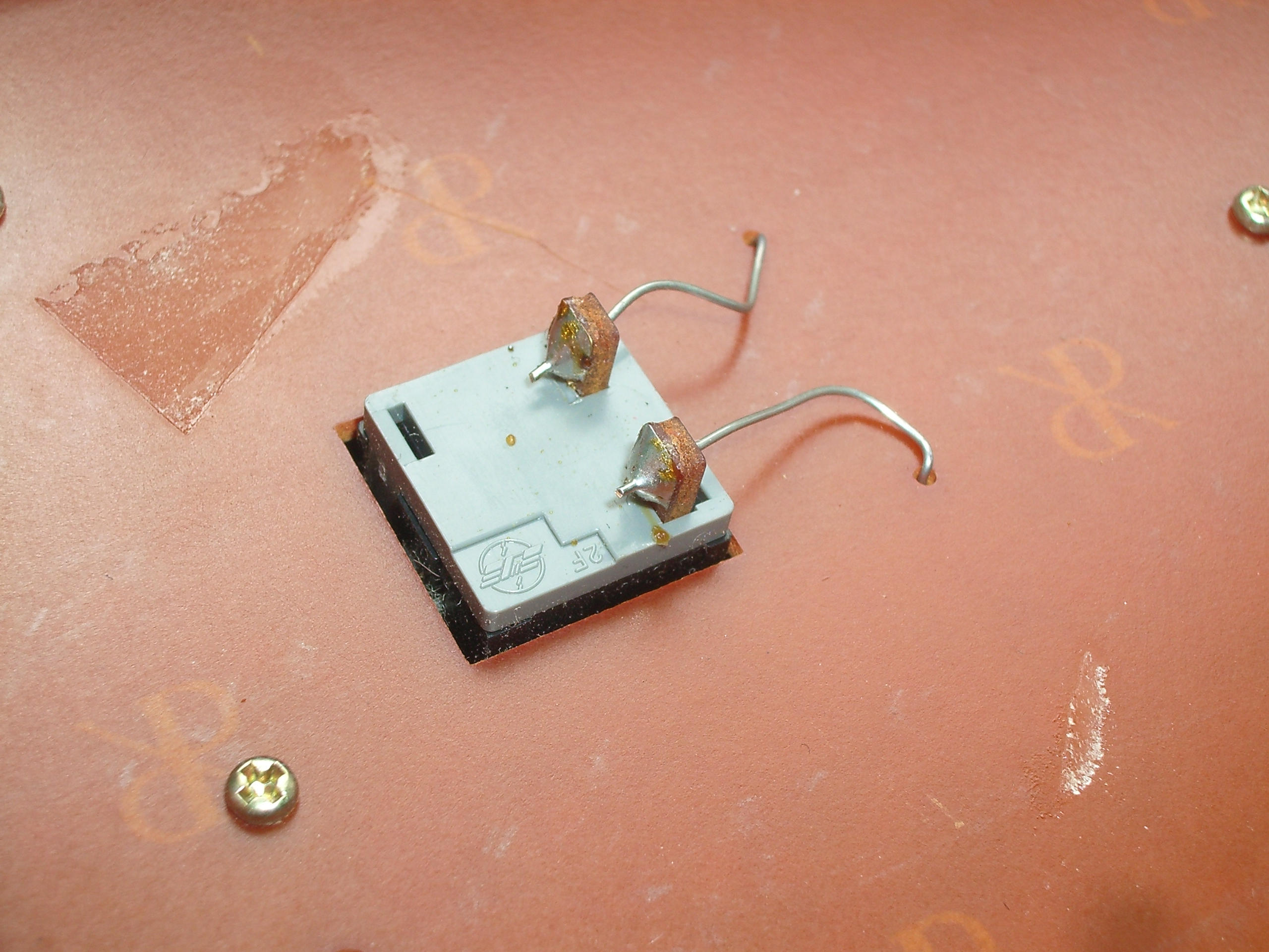

It's a plate mount switch that is plate-mounted into the PCB; you can see the Mitsumi branding in the corner:
C64 05 switch rear.jpg (493.45 KiB) Viewed 5166 times
(I should have cleaned it for that shot, as I cannot re-take it, having snipped the leads!! I'll have to remove all the filth in Photoshop later.)

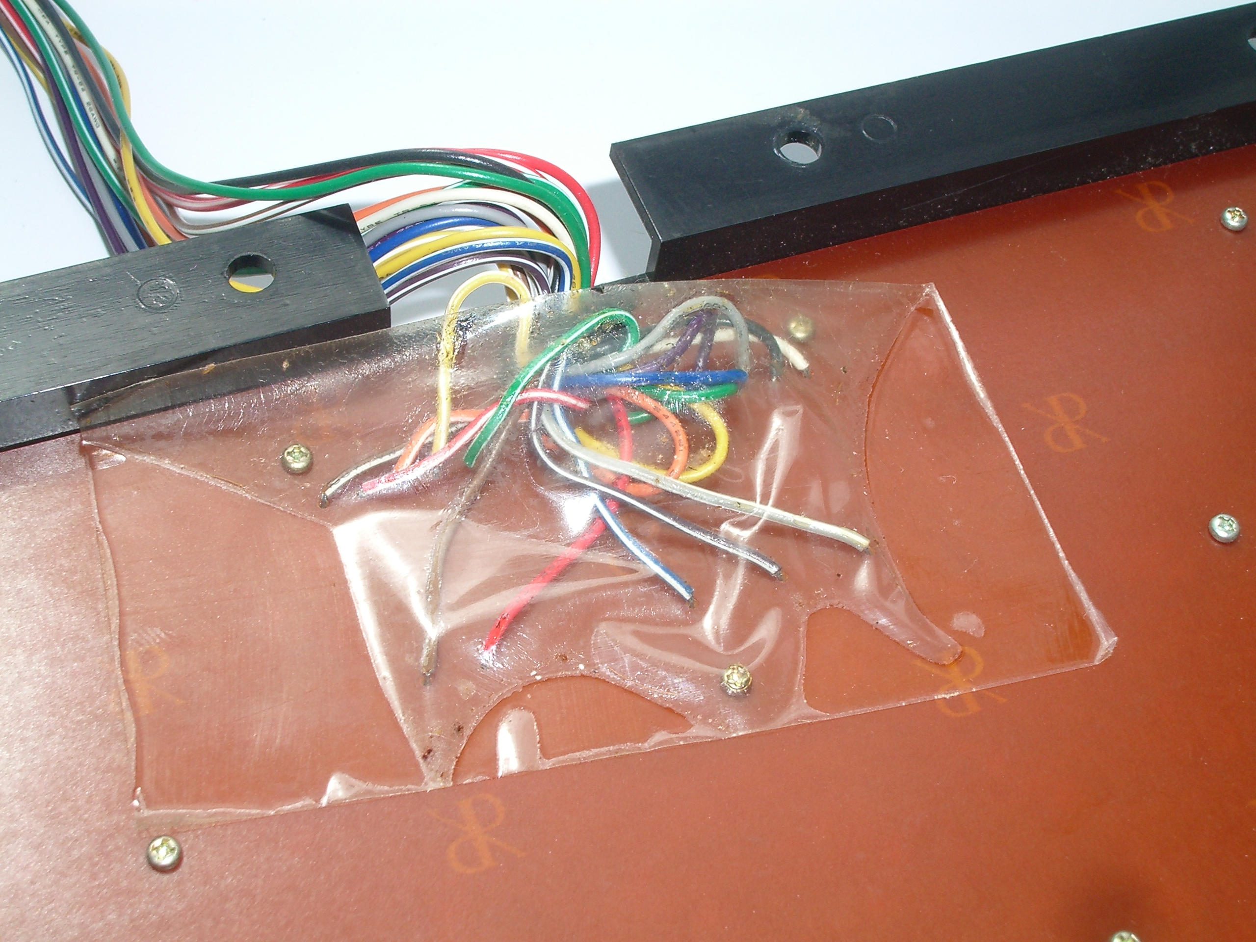

An aside into the awesome wiring by Mitsumi on the keyboard PCB:
C64 06 awesome wiring.jpg (597.35 KiB) Viewed 5166 times

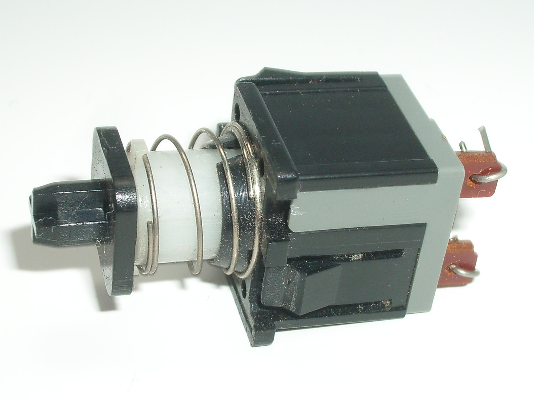

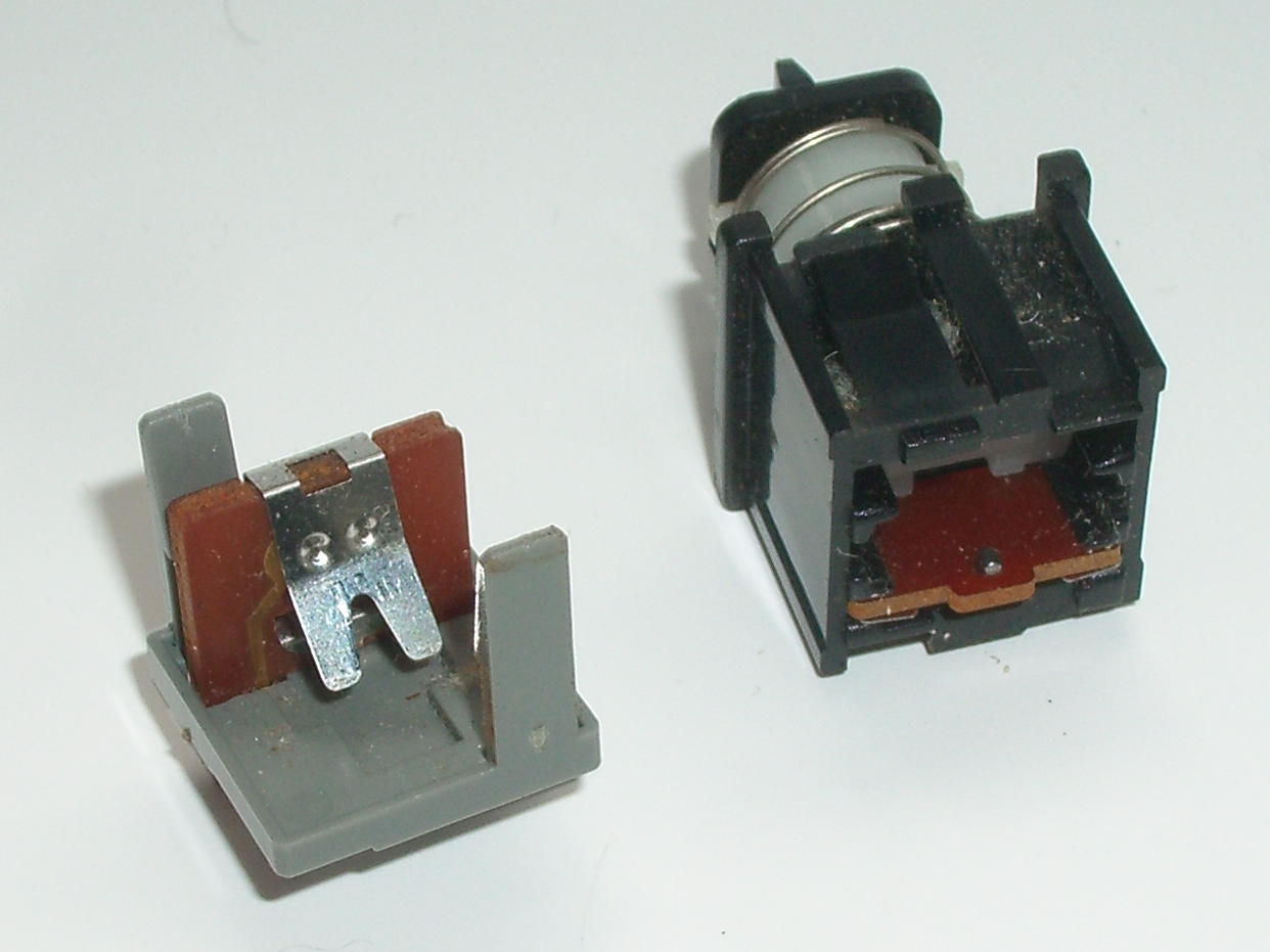

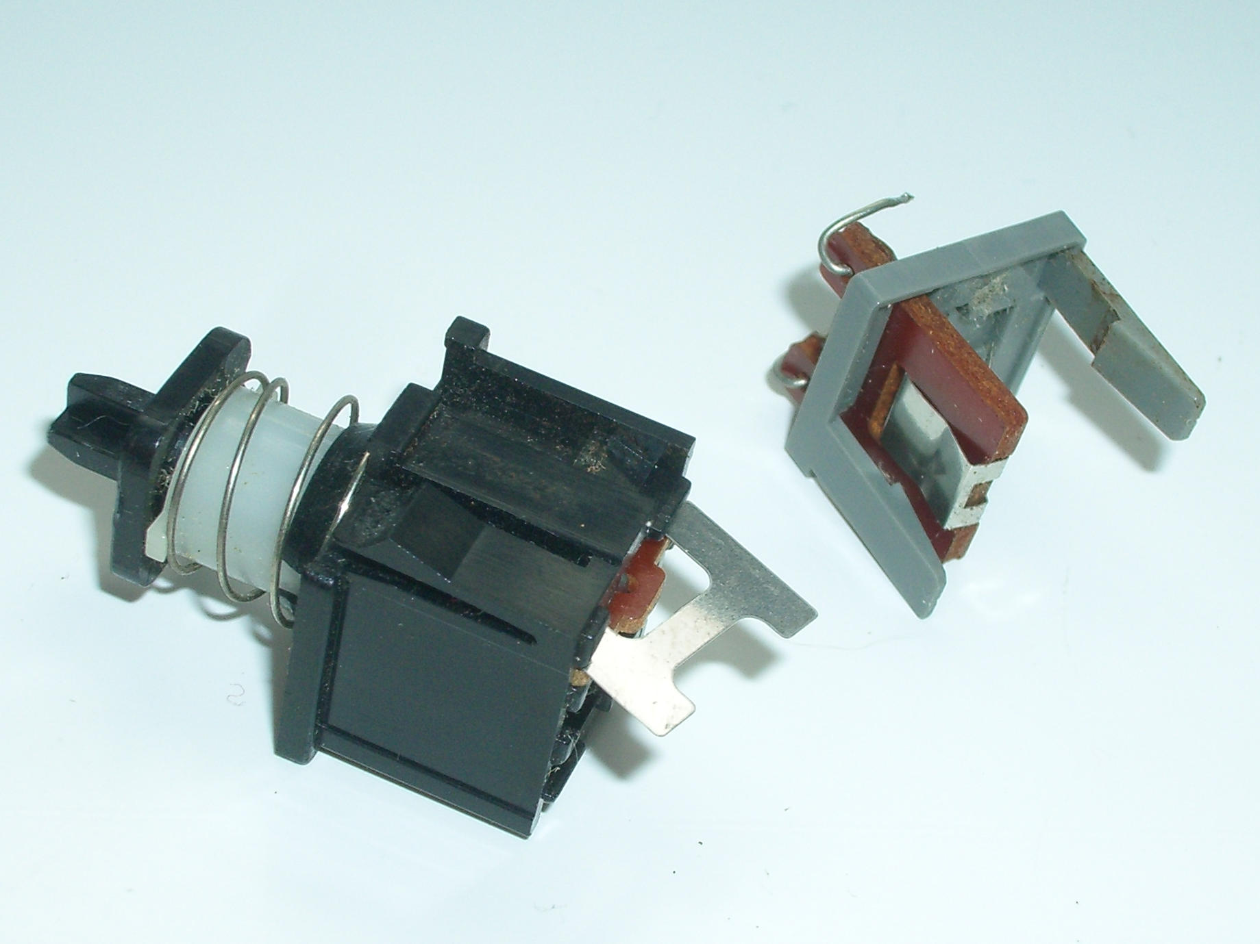

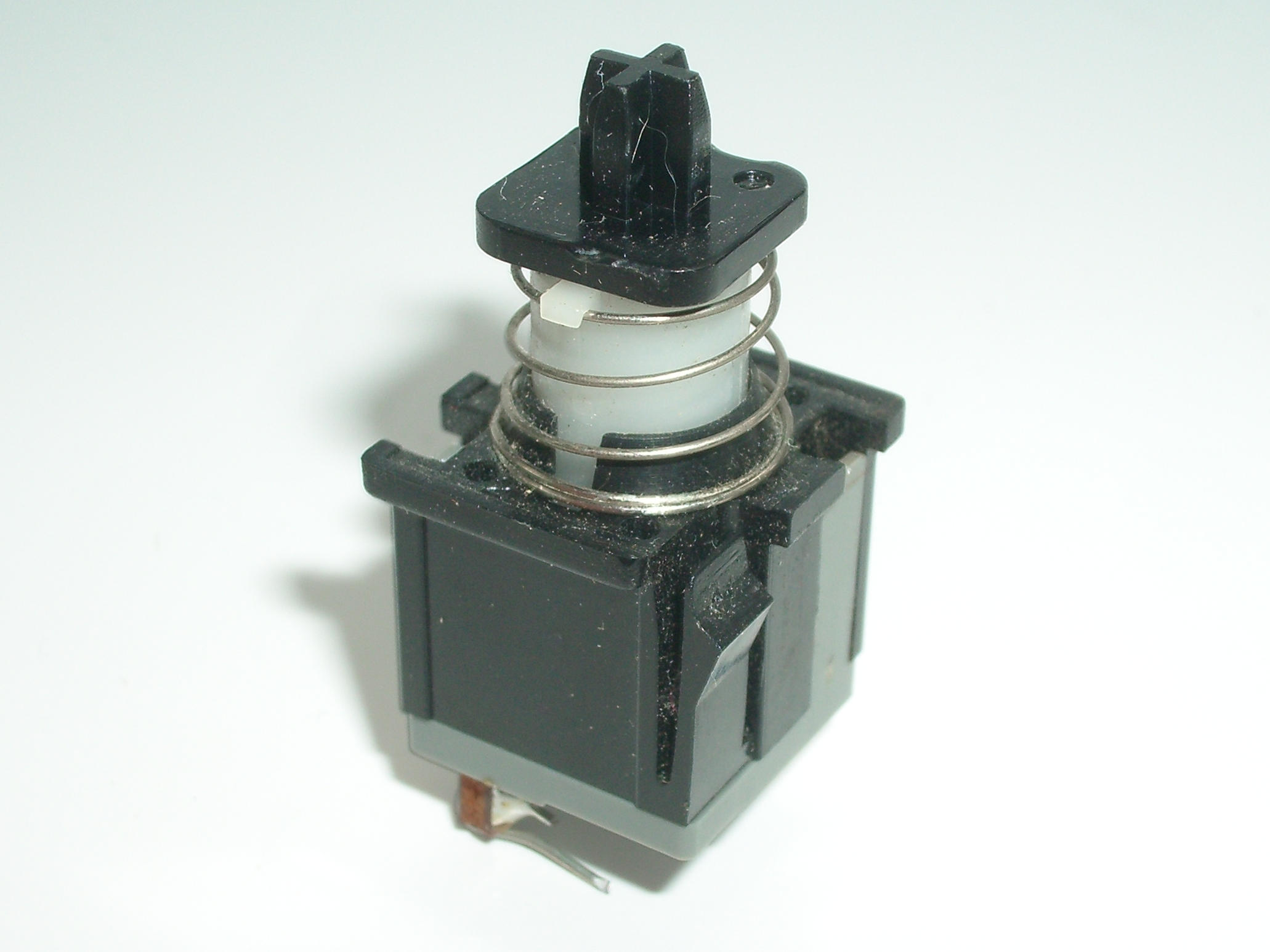

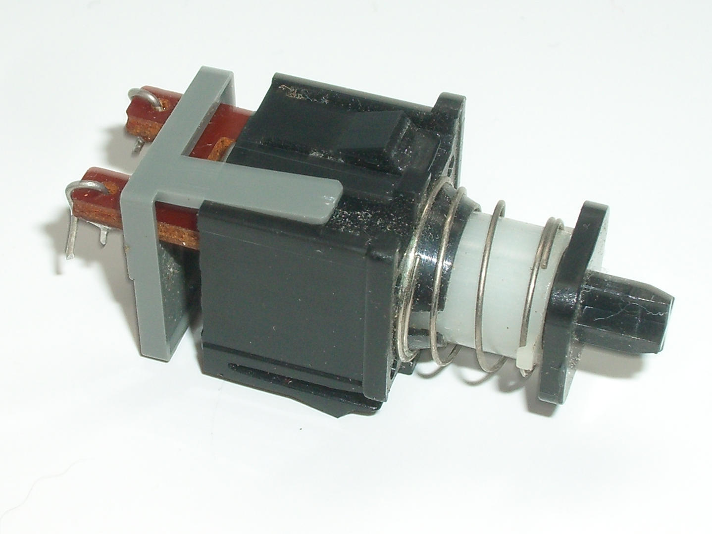

The switch:
C64 07 switch.jpg (169.45 KiB) Viewed 5166 times
C64 08 switch side.jpg (171.56 KiB) Viewed 5166 times
C64 09 partially open.jpg (115.5 KiB) Viewed 5166 times
C64 10 open.jpg (94.94 KiB) Viewed 5166 times
C64 11 opened some more.jpg (164.87 KiB) Viewed 5166 times

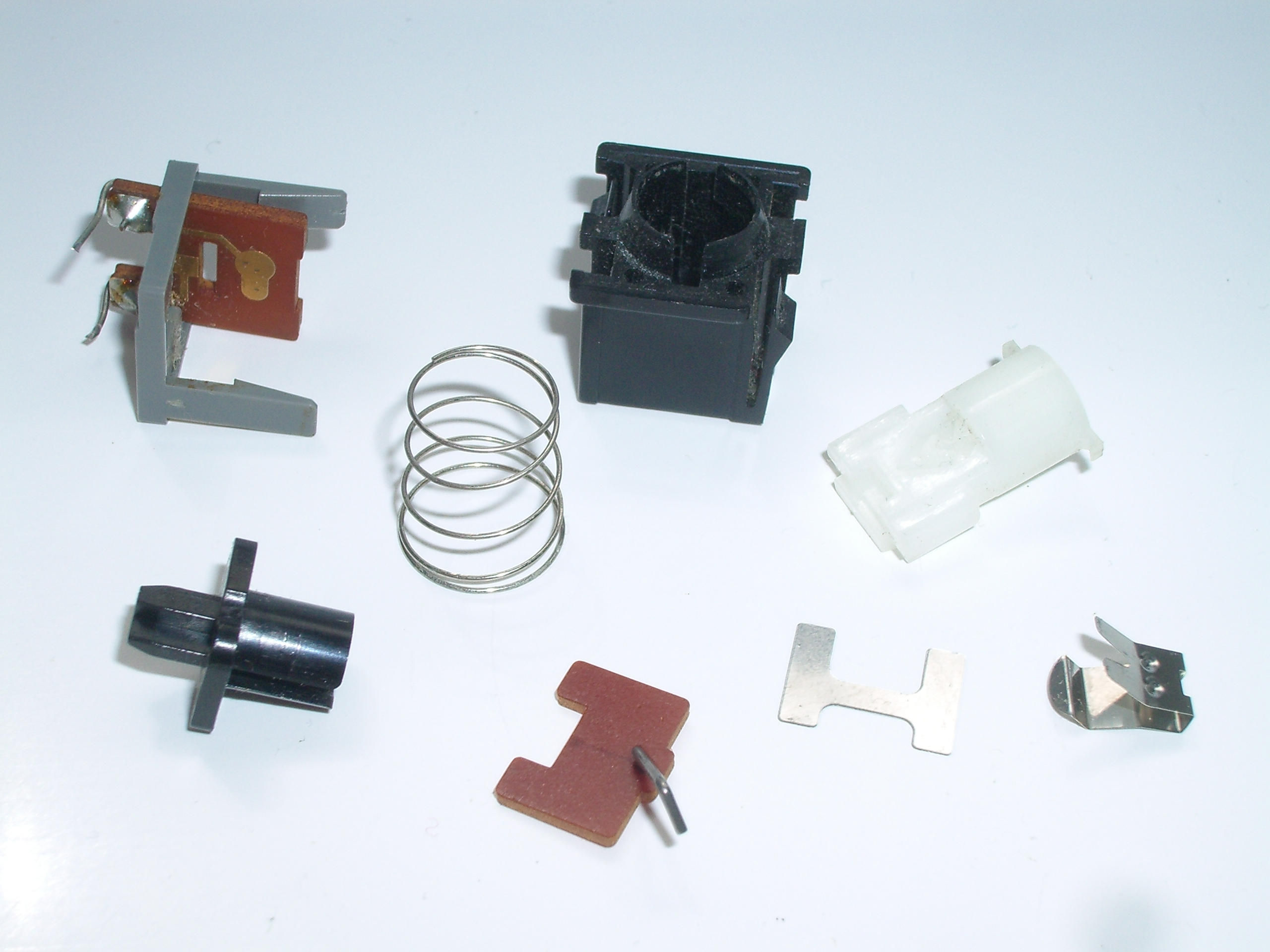

I can't achieve 100% dismantled state without a soldering iron, as the mini PCB inside won't slide out without removing all the solder and the lame-o wiring:
C64 12 almost fully disassembled.jpg (263.49 KiB) Viewed 5166 times
