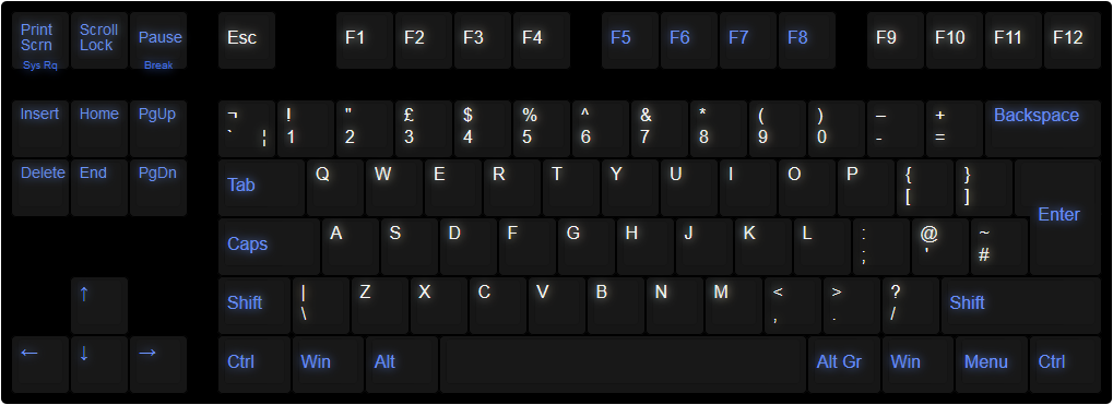

This is my current theory for an optimum design for me:
http://www.keyboard-layout-editor.com/# ... 7f1f43d466
  • Backlit, because it's funky (useless, but I like it for some reason), and using Cherry RGB switches because I'm too lazy to simulate rubbish backlighting in Photoshop
  • TKL as a compromise size, but with the navigation cluster on the left, to bring the mouse closer
  • Vintage two-tone applied to the LEDs

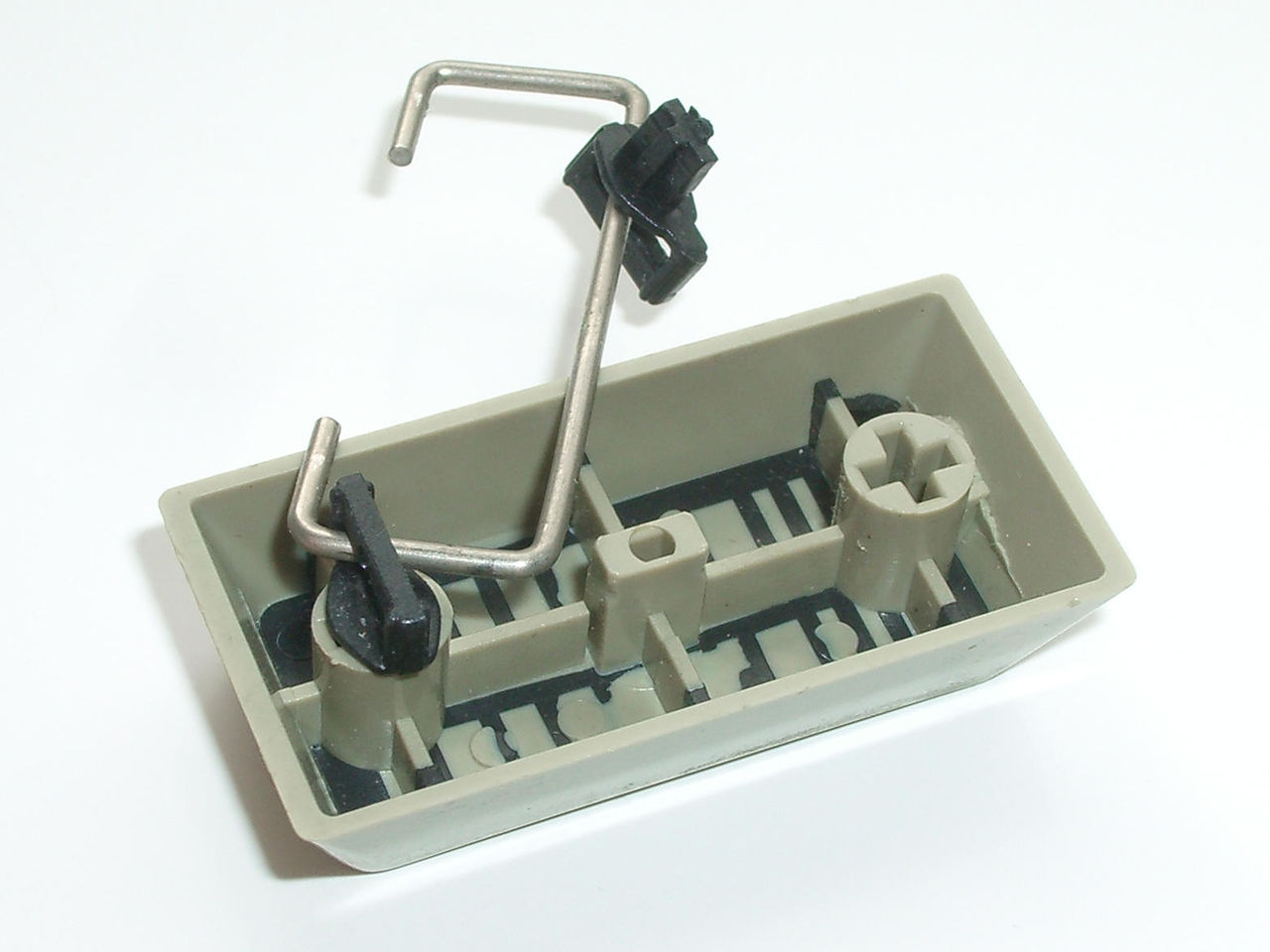

  • Obviously, Cherry stabilisers inside!
No idea on switches — Alps green sounds the best bet, and that would even make the LEDs possible, albeit without even backlighting. And yes, there are keyboards with keycaps that take Alps switches and Cherry stabilisers:
Mixed mount.jpg (88.57 KiB) Viewed 10886 times
This will never exist, so I'm just going to stick out suffering with a Poker II forever as I love the space savings even if it's a complete headache to use.
PS 1: Note that the blue legends should be actual blue LED colour, but since it's impossible on a computer screen to show any colour with an intensity more than white, the blue shade used is only an approximation. In reality, white does not exist (hold up a sheet of white paper against a computer screen) and black is hard to perceive due to your eye's noise floor. Black is likewise just a term of convenience for a range of dark greys, since it's possible to cast a shadow on a black object.
PS 2: I forgot to centre a load of the legends :(

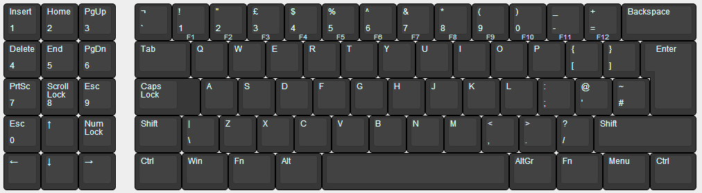

Edit: If I were to do this, I'd probably go with this layout just for the sake of it:
http://www.keyboard-layout-editor.com/# ... ec24c98437
(I didn't copy your two-tone LED layout due to laziness)
You could then turn the navigation area into a pseudo-numpad if desired.
It would actually not be too difficult to create a plate for this keyboard - it's probably doable by just moving the Phantom design around a bit. The PCB would be more difficult, but also quite doable.
Edit 2: It might be easier to use keyboard-layout-editor rather than Photoshop for the mockups. It is for me, but then again I'm not too familiar with Photoshop.

Most backlit Cherry MX keyboards have the legends top/centred because the switches are facing upwards. The keys with two symbols on them, such as the numeric row then often then get very ugly and non-standard.
However, it is perfectly possible to mount a Cherry MX switch facing left. I'd like to see a backlit keyboard that does that and keeps the layout of the legends on each key relatively standard.
Daniel Beardsmore wrote: And yes, there are keyboards with keycaps that take Alps switches and Cherry stabilisers:
I think there are more that take Alps switches and Costar stabilisers with Alps-like inserts. Just use the universal mounting hole shape that supports both Cherry and Costar.

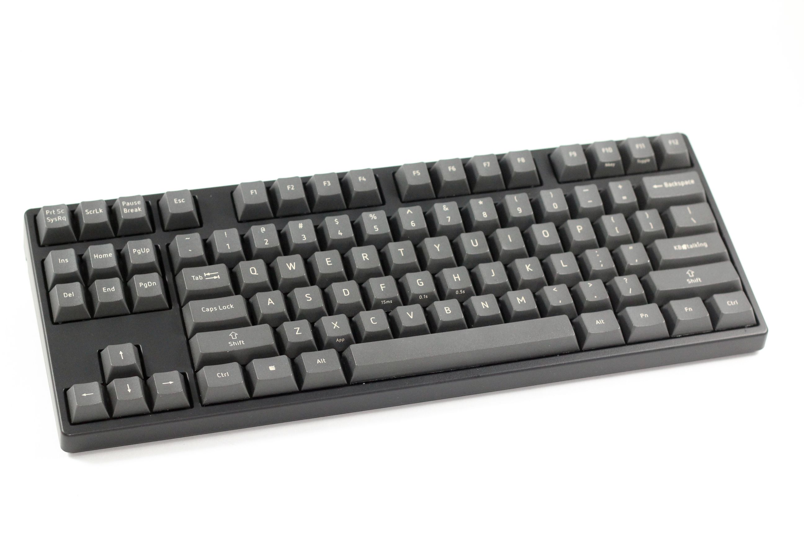

scottc wrote: I actually think I have seen something like this before.
I stumbled over pictures yesterday of a left-handed ANSI tenkeyless: KBT K87E.
03 Aug 2014, 19:05
That page goes back over a year, too. I guess it's not an idea that's going to catch on, let alone be anything close to what I had in mind. I was also expecting a nice edgy angular case like a Minila/KUL/WASD V2.

08 Aug 2014, 22:22
This what I would do:
http://www.keyboard-layout-editor.com/# ... d778d940c2
