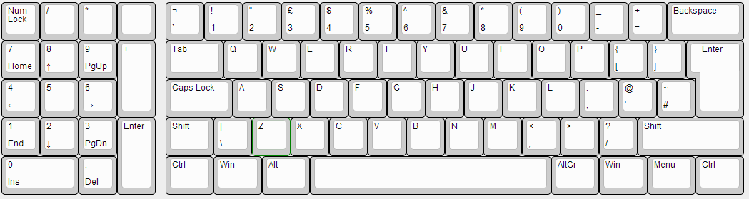

This is kind of the ideal layout for what I'd want.
http://www.keyboard-layout-editor.com/# ... 0029ab6138

A left handed keyboard, eh? Take a look at this thread:
http://deskthority.net/keyboards-f2/lef ... t8528.html
I wonder what you're doing for arrow keys, though. Usually they're the last thing people like to chop off their custom layouts. And I don't see an Fn key for putting them on a layer, like the HHKB.

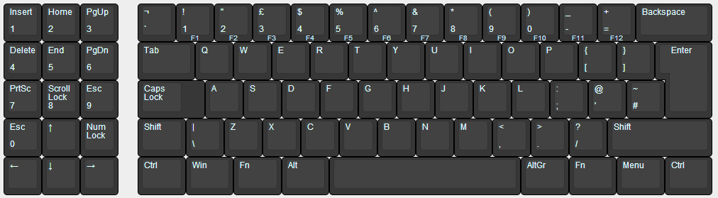

Thanks for the tip, I checked out that thread earlier the layouts there aren't exactly what I'd like. I did post on that thread showing a layout that would work for me, which I made from modifying scottc's post.
Here it is:
Also I'd like to point out that there are arrows on the standard numpad, if you don't have numlock activated you can use the arrow keys, home, page up/down, end, and delete then if you press it you have the numbers & period.
There have been some keyboards in the past that have allowed a layout similar to what I'd like but they have always had the arrow keys etc on the right side.
Ultimately what I think I'll end up doing is; getting a 75% keyboard and modifying the case to house a number pad, and then sleeve both cables together. They would still be separate cables, I'd have two USB males at the end, but they wouldn't move around.
So I'm thinking a keyboard like KBT race II, and a Keycool numpad. I can get Cherry Mx reds on both and the KBT race II is supposed to have a 1000hz polling rate. Although it looks like both are discontinued/out of stock at the moment, so I'm not entirely sure what to do. Do you know of some numpads with Mx reds and/or some 75% keyboards with Mx reds and a 1ms/1000Hz polling rate?
