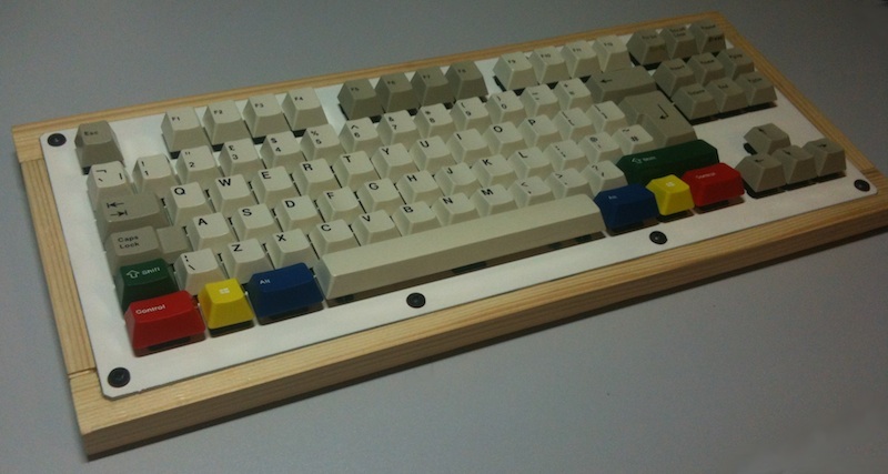

Yet another Phantom derivative
sgf
09 Aug 2014, 01:29
Some of you may remember me asking questions about Phantom plates etc. a number of months ago. I have finally finished my first DIY keyboard, having taken much longer than can really be justified. Most of the time was spent on the case, because I decided on a wooden case, and I am useless at woodwork and just kept putting it off.
The result is, compared to what I've seen elsewhere on this site, extremely unimpressive. Did I mention how useless I am at woodwork? However, I want to post this, partly because I think it's worth encouraging others to share, even if they're not on the cutting edge, and partly because I'm still proud of this very basic board.
The photo's rubbish, thanks to my rather old phone and limited light, but trust me, you don't want to see the corners I've cut in high-res. ;)
Final small.jpg (93.29 KiB) Viewed 2937 times
09 Aug 2014, 01:37
Doesn't immediately look too bad. Teensy powered, I presume? What have you done with the socket / cable? And what about feet?
mtl
09 Aug 2014, 06:35
Not sure if I can say why but I like it. Nice work. :-)
Madhias
BS TORPE
09 Aug 2014, 08:31
It's nice, i like it! Always good to see true selfmade projects. European customs instead of korean customs :)
sgf
09 Aug 2014, 12:30
Bog-standard Teensy (with bog-standard firmware). It's a detachable cable - I bought a USB type B socket, plus a short cable, cut the cable up, soldered it onto the socket and put it in a recess on the wood. I took the cable off for the photo as I didn't want to ruin the aesthetic. :D
The base is a sheet of 0.7mm aluminium, covered in dark grey baize, and nailed on. It seemed like a nice alternative to ickle plastic feet or whatever.
I wrote some notes up of how I made it/what I learnt as a newbie keyboard-builder, and took plenty of build photos, so I'll put them up when I have a chance later.
09 Aug 2014, 12:38
Ah, you're doing some things right then. Sockets are much better than fixed cables. That solid metal base ought to make for a good hefty feel, so long as you've got it on good and flat.
I'm sure Hasu will be amused at becoming the purveyor of "bog standard" keyboard firmware! It's a pretty good standard.
sgf
09 Aug 2014, 22:01
It's only 0.7mm thick alu, so it doesn't actually add a huge amount of heft. It's nice and flat, unlike the wooden frame - I had to bodge it with a shim to get the base on.
The firmware's great, "bog standard" was meant in the nicest possible way - perhaps "vanilla" instead? I just feel a little guilty that I just installed a binary image; I didn't even compile from source, let alone dig in properly. :) My plan for my next keyboard is to wire it directly into a DIY micro I'm planning, so there won't be any fancy microcontrollers getting in the way. Fortunately, 7bit's group buy hasn't arrived yet, so I have an excuse not to think about that one yet...
sgf
09 Aug 2014, 22:10

the rustic look - I'm quite happy to have a keyboard that makes it
clear I built it myself, and it still does the job for typing upon.
Thoughts on the Phantom design
The Phantom design tries to be a jack of all trades. It covers ISO and
ANSI, plus a few other custom funky things, with 1u and 1.5 Windows
keys. This does lead to a few ugly things - the wide switch hole for
caps lock, the space bar with multiple stabiliser cut-outs, various
bits on the PCB where the holes are a bit ick, etc.
Overall, it does a pretty good job, but if I were to do this again I'd
probably tidy up the plate a little bit more. I'd not try to redo the
PCB though!
On of the more painful bits is quite how thick the keyboard has to be
because of the Teensy and the way it's mounted. As I'm reasonably
confident with my soldering, /if/ I were to produce my own PCB, I
think I'd directly solder a microcontroller to the board, saving the
depth. If I could find an appropriate easy-to-solder SMT
microcontroller, I guess.
