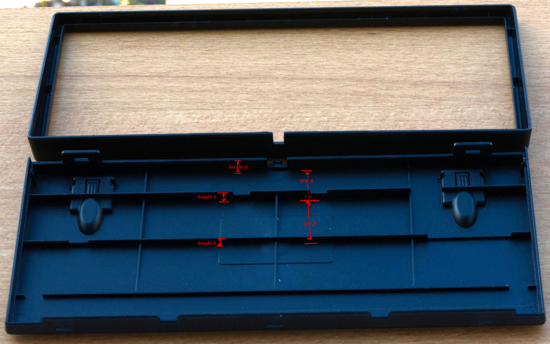

Does anybody know what measures this has?
I need to know positions of supports that go through the PCB or plate and the outer-dimensions of them.

23 Sep 2014, 11:47
echo "a,b,c,d,e,f,g,h=4,3,3.5,10,7.5,5,24,34" | sed 's/=/\n/' | gtab -t',' --transpose | sed 's/,/=/'
a=4
b=3
c=3.5
d=10
e=7.5
f=5
g=24
h=34

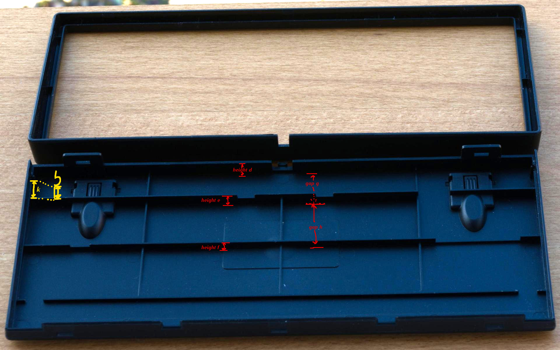

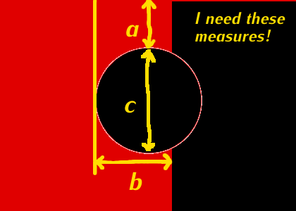

I need one more measure:

23 Sep 2014, 12:46
a=4
b=3
c=3.5
d=10
e=7.5
f=5
g=24
h=34
k=12
a+c+k
19.5
Teensy requires about 19mm width.
keyboard is 118mm deep, ie
(118-19.05*6)/2 = 1.85mm on each end extra space.
19.5-1.85 == 17.65

I finally got around to do the measurements (all in mm)
a = 3.5
b = 3
c = 3.5
d = 10
e = 8.5
f = 5.5
g = 23
h = 33.5
k = 12.5
topmost support is about 1mm thick and 2.5mm high. I'd say the topmost support runs a little bit higher than your yellow line, but not by much.

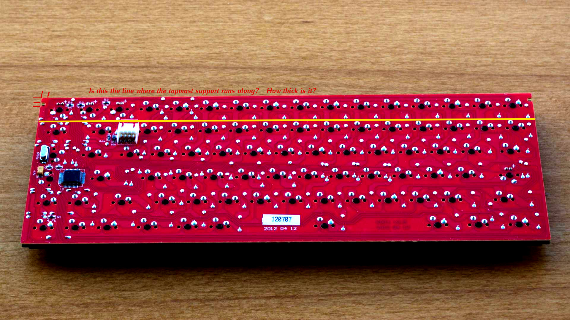

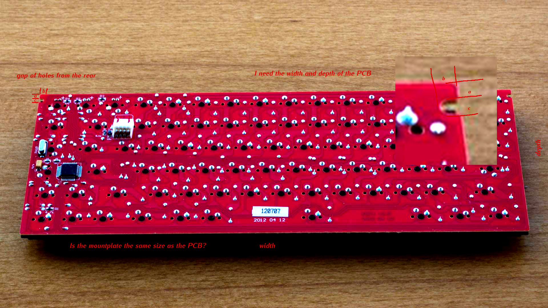

a|  4| 3.5|gap to top of hole from upper PCB boundary
b|  3|   3|gap to left of hole from right PCB boundary
c|3.5| 3.5|diameter of hole
d| 10|  10|height of topmost support
e|7.5| 8.5|height of support below
f|  5| 5.5|height of support below
g| 24|  23|gap from case-edge to topmost support
h| 34|33.5|gap from topmost support to support below
k| 12|12.5|gap from topmost support to lower boundary of hole
W|310| 311|width of PCB (12.25"-0.75"*16u=.25";  12.25"*25.4=311.15mm) ??
H|118| 117|height of PCB
BTW: Further up would mean it touches the solderpads! Are you really sure? I placed the line such that it is between all solderpads, so does not run over one. It seems the only possiblitiy.If this is where the support touches the PCB, it is within the boundaries of the 2nd row from top, so would not get into the way of the Teensy!

teuf
23 Sep 2014, 19:49
Nope, not sure at all, I checked again, and where you placed it is correct.
teuf wrote: topmost support is about 1mm thick and 2.5mm high.
Height was for the bottommost support, but thickness is the same for all.

Could you please measure the overall dimensions of the PCB?
davkol gave me 310x118mm, but I don't trust him.
:o :shock:
teuf
23 Sep 2014, 20:00
Ah right, I measured it but forgot to give the numbers ;) I got 311x117 but I don't trust the 311 all that much (my good ruler is only 30 cm so I had to use a different one).

teuf
23 Sep 2014, 20:05
Also, the corners of the plate are a bit 'cut off' as the plate sides are folded beneath it as davcol explained
