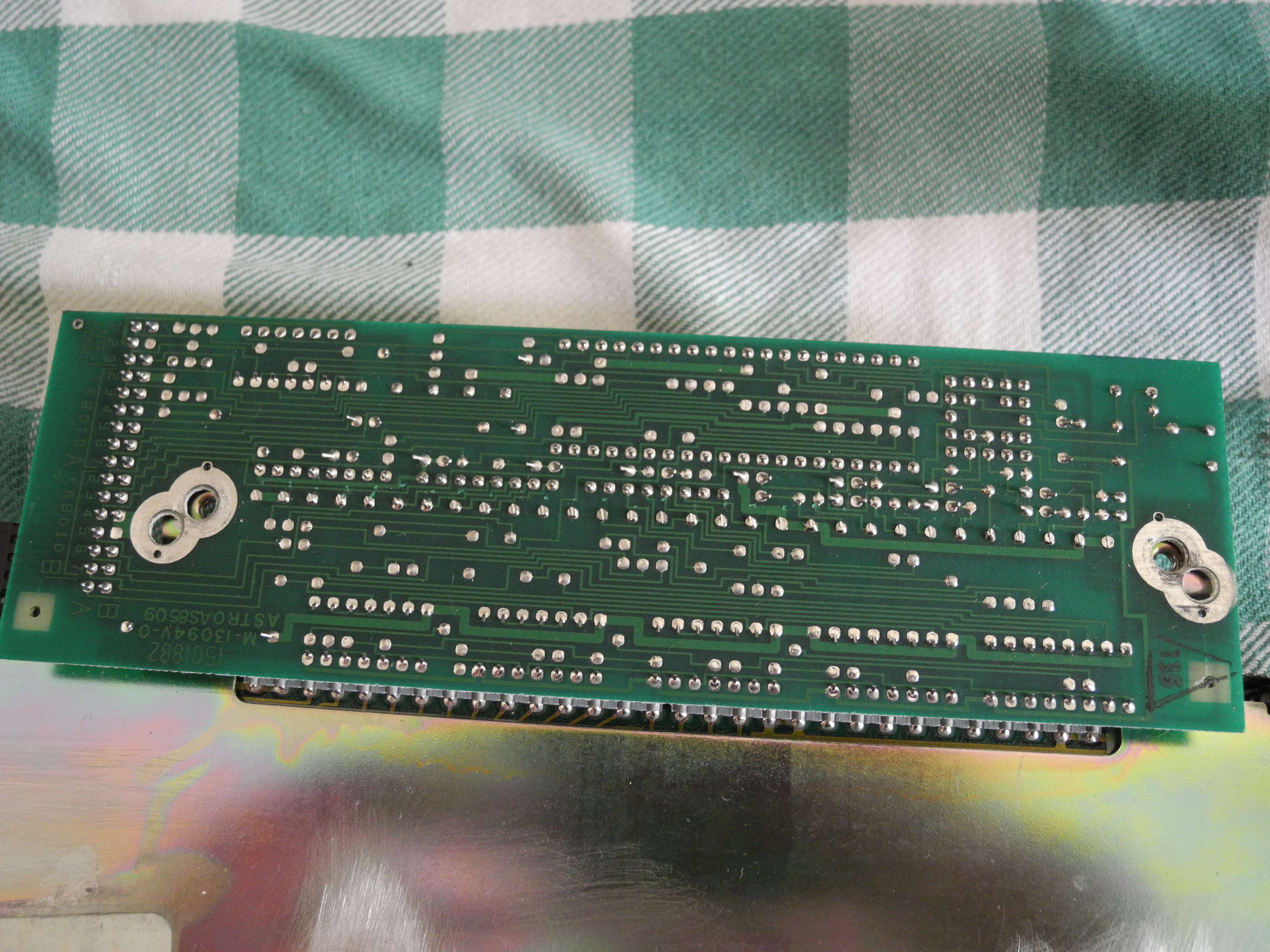

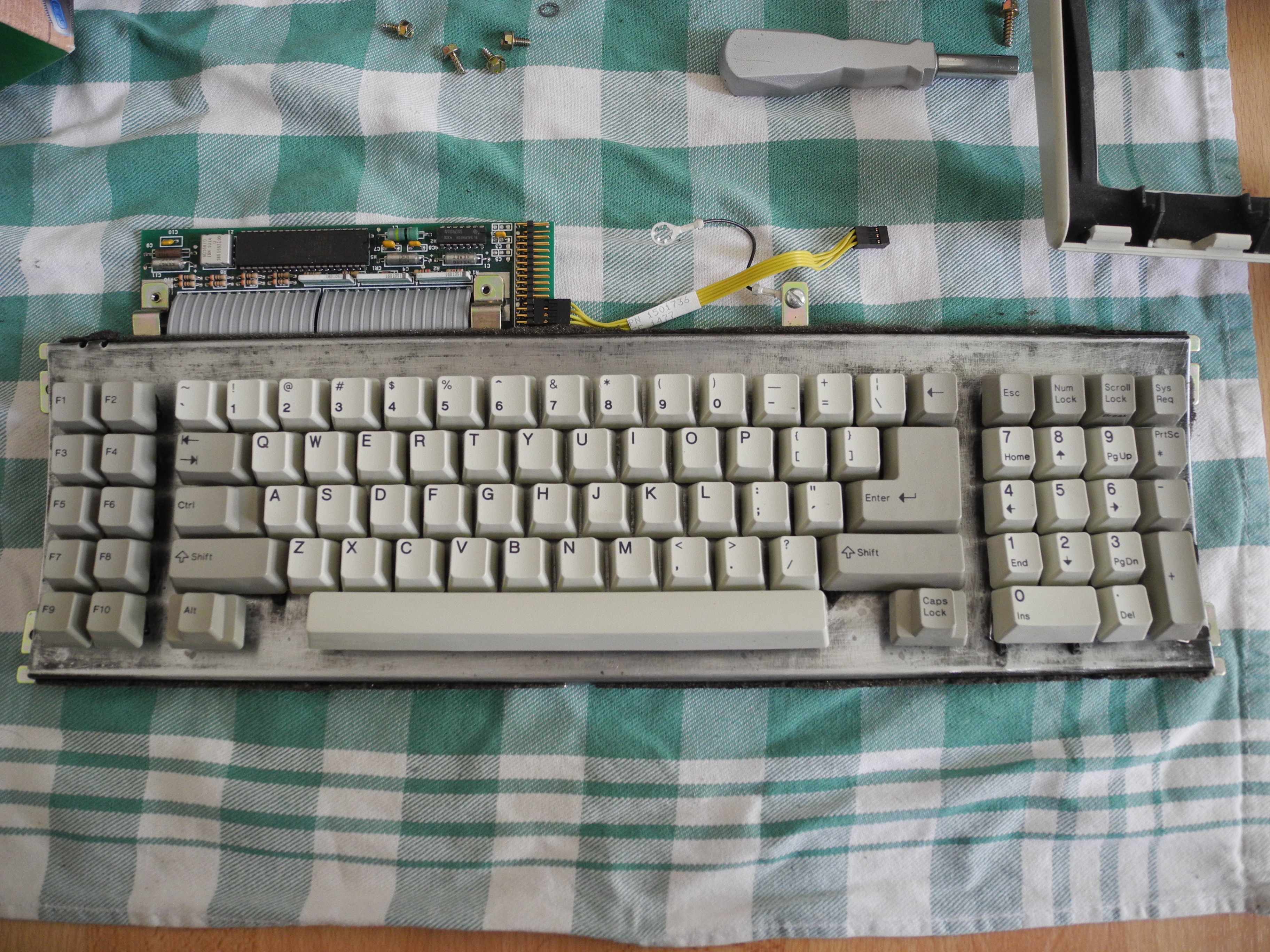

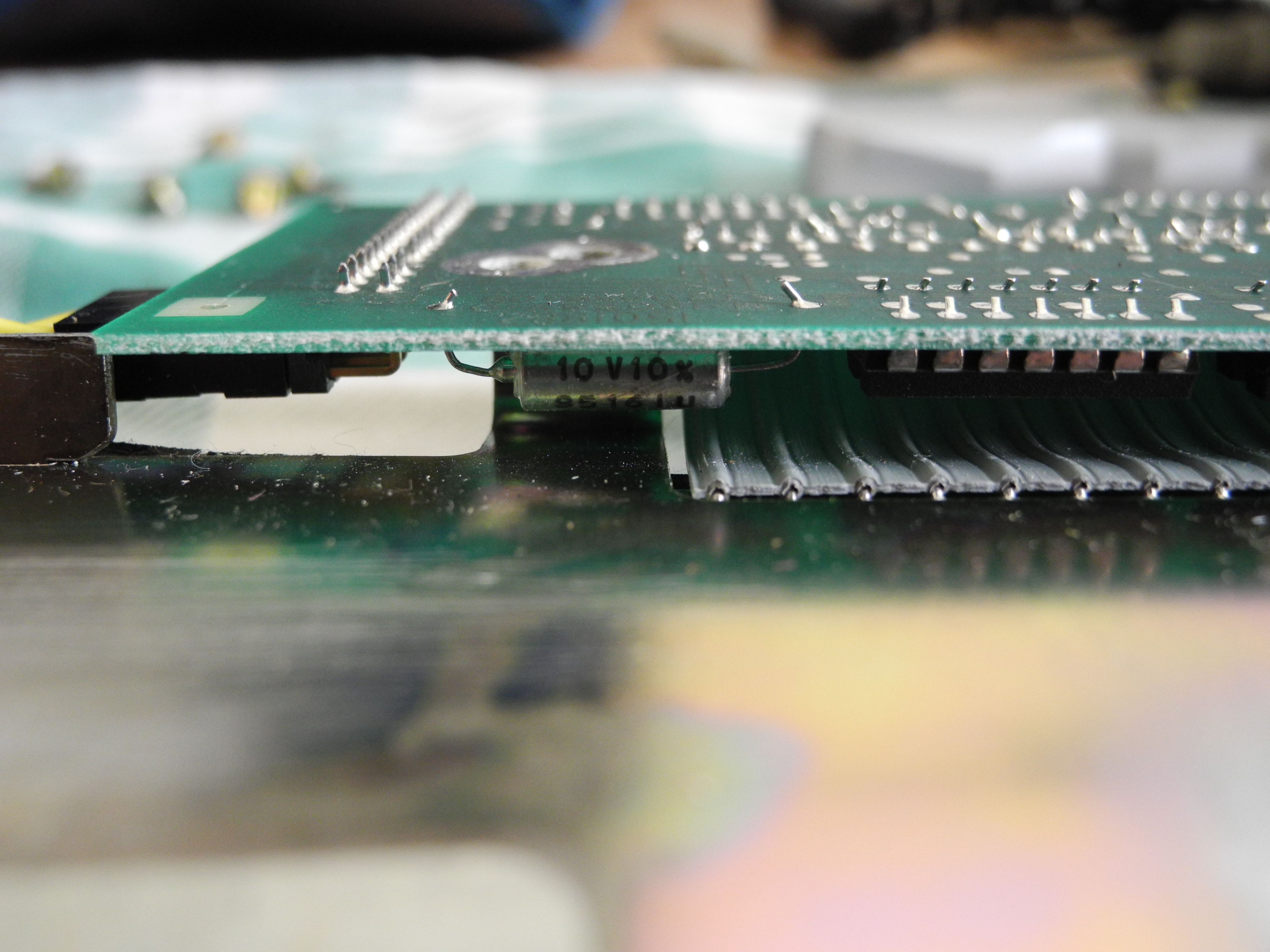

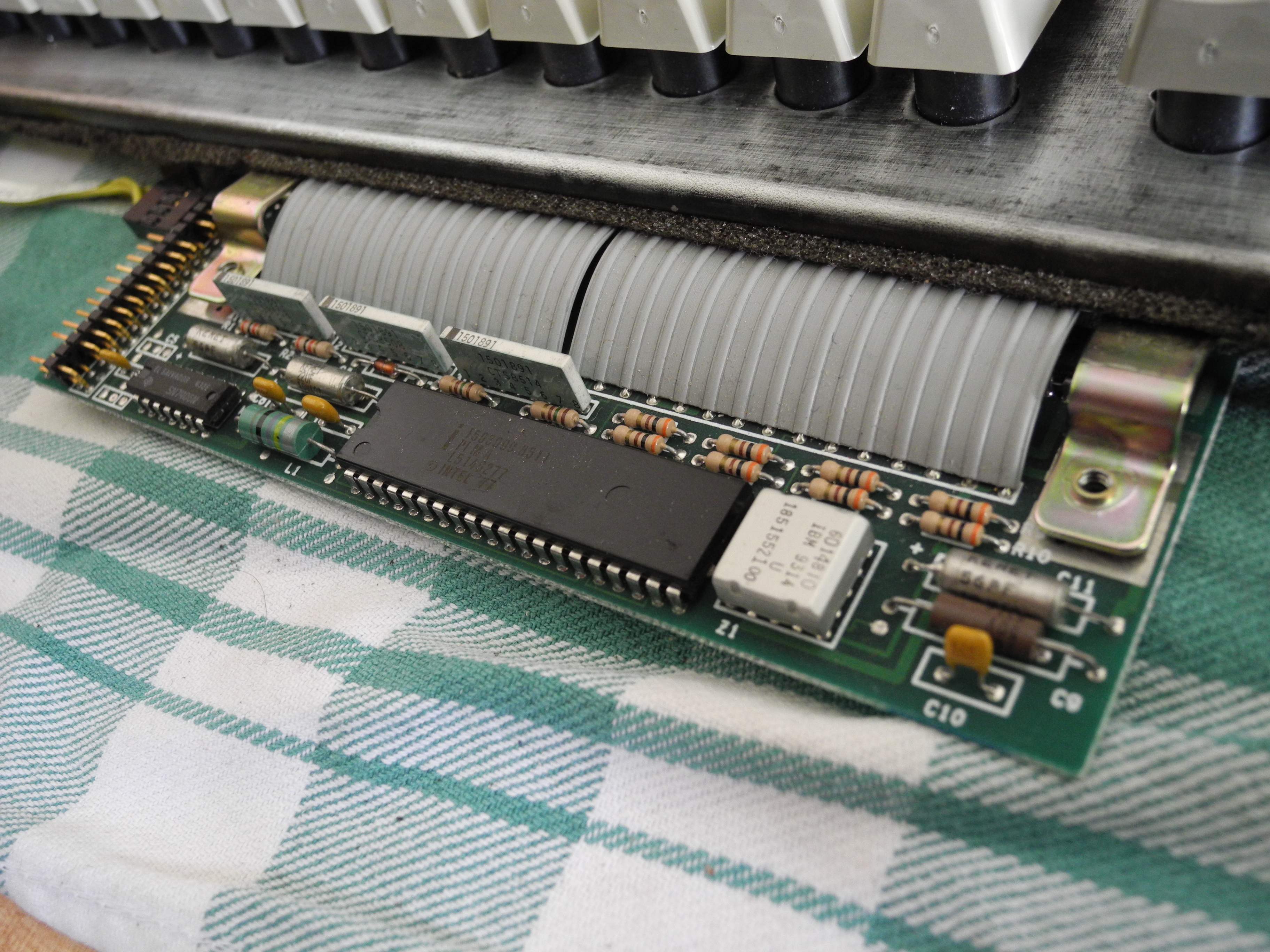

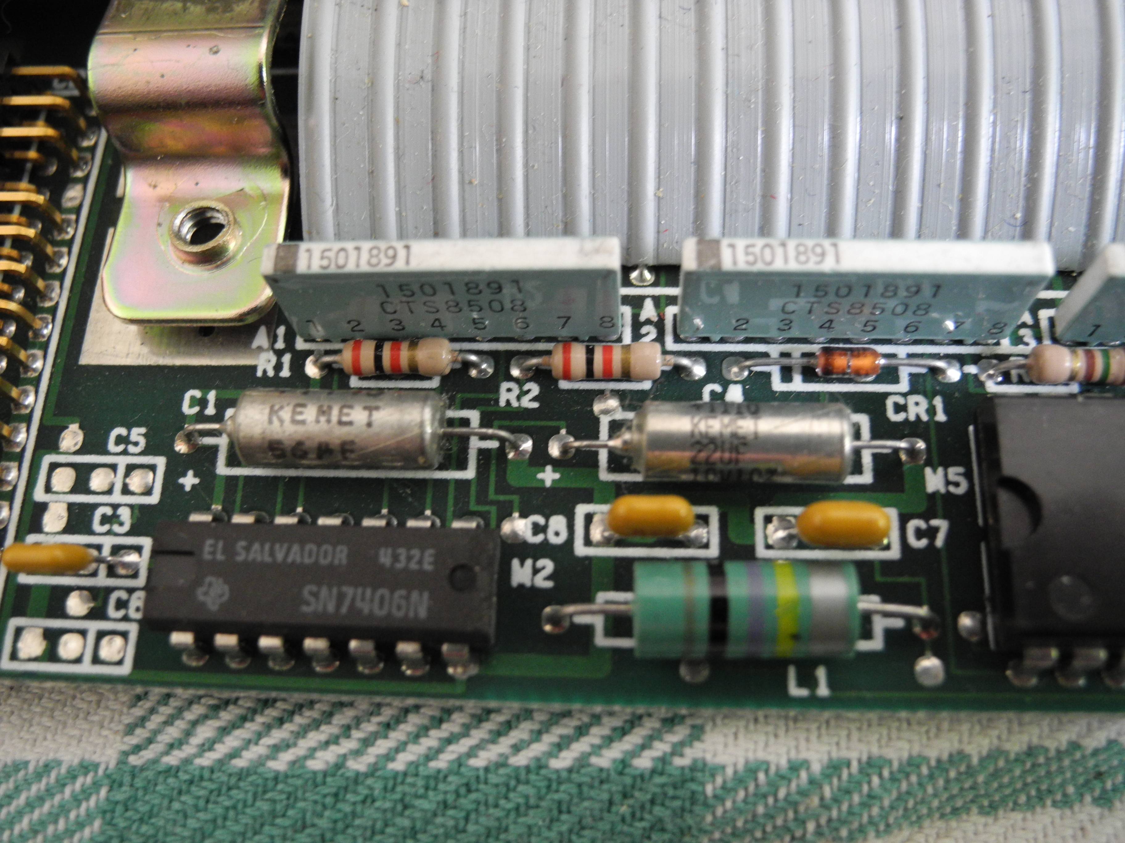

Meanwhile here are some photos of the internals, I don't see anything defective there:
Note: The plate is not quite finished yet, I still have to sand it a little more and laquer it.
22 Aug 2014, 17:28
check the ribbon cable , i know from experience they can be a bit dodgy It looks fine but check the solder joints on both ends of the cable

Hmm looks like something strange is going on with the controller.
Only thing i can think of is make sure it is correctly grounded. i had a look to see if i could find anything on that Intel IC but i could not find anything.
You could replace the controller i guess i think the replacement controller for the model Fs should work on the AT

Yes grounding can do strange things with the model Fs if you let it float all manner of strange things can happen,
If we could find out what the ICs are i may be able to help you as i have a controller off of a model F terminal most of the logic should be the same so you could use that to repair it if something is faulty.
I am assuming there is a eprom that tells the keyboard what it is an has the calibration data that Jbert spoke of, if the eprom exists and is ok we could salvage components from the terminal controller many of them look the same.
Then again the problem could be the eprom has lost its data, this can happen as many of them are UV eraseable, i would dump the eprom from my AT but i don't have the means.

I'm going to take some pictures of the ICs tomorrow, it's too dark here now. But I think I'm not able to solder something that tiny.

So, I checked the the grey ribbon connector to the PCB with the multimeter and it's intact. I also measured the resistance of the capacitors:
  • C1 & C11 and the hidden one under the backplate: 830 Ohm
  • C3: 800 Ohm
  • C4: 28.9k Ohm
  • C7 & C8: 1680 Ohm
  • C9: doesn't give me anything, don't know if this a capacitor
  • C10: 14.2k Ohm
Resistors:
  • R1 & R2: 2000 Ohm
  • The two right of R1 & R2: 150 Ohm
  • All the others: 300 Ohm
And then the thing called CR1: 26.7k Ohm

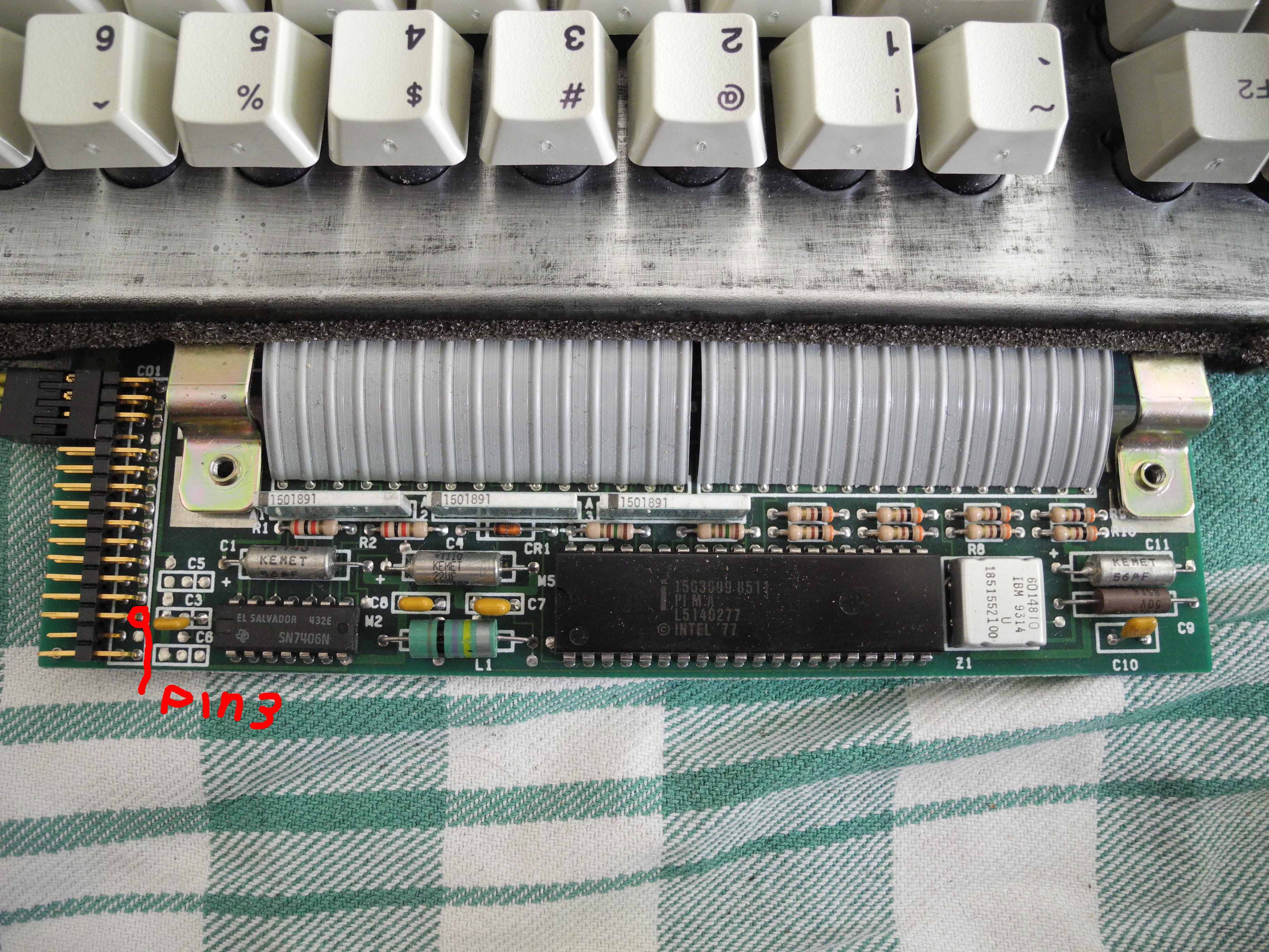

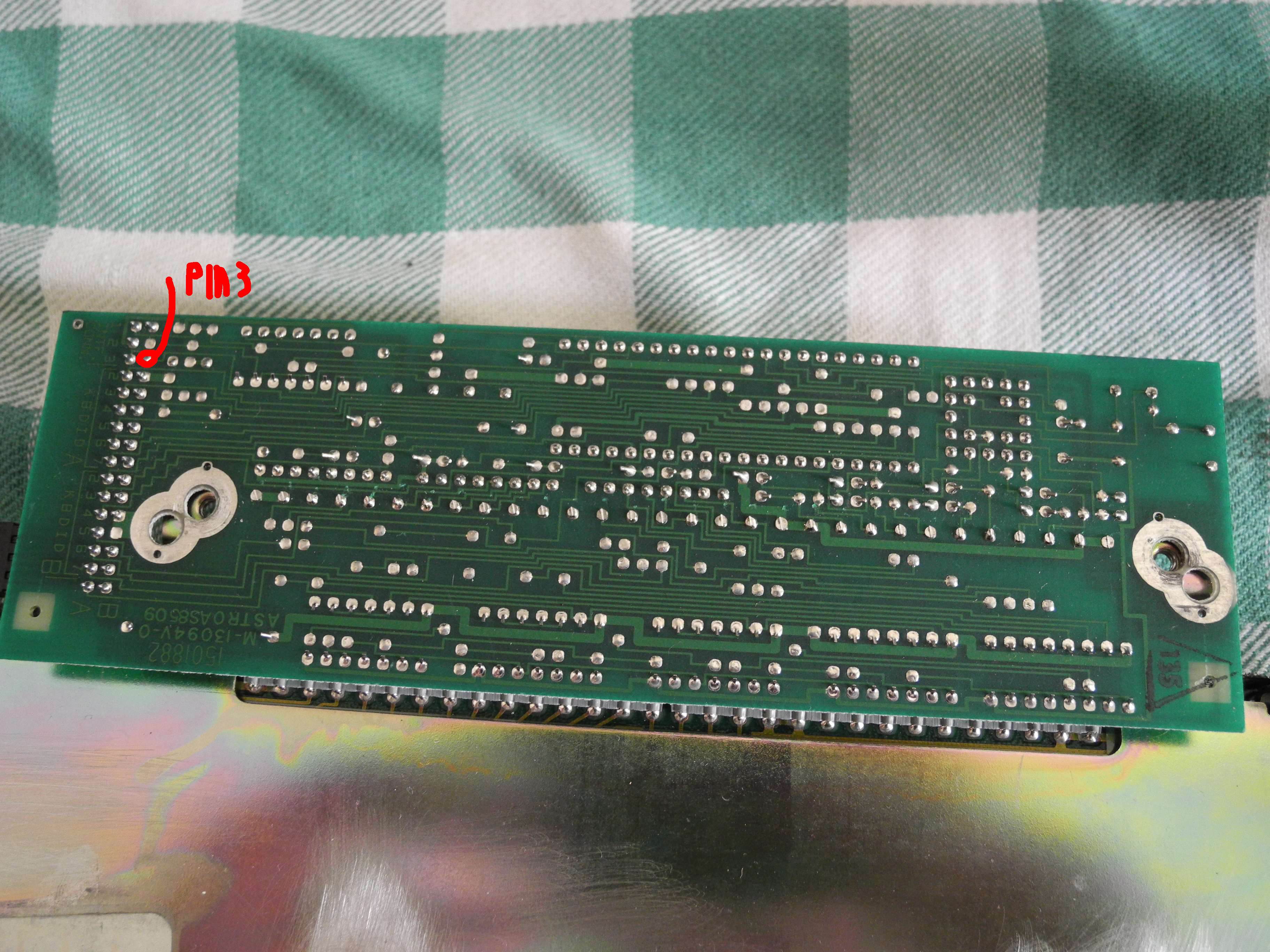

Ground, Voltage, Clock and Data are all fine. These should be the PS/2-relevant lines. Also the shielding is fine. But the green cable comes out on the pin 3 of the DIN 5 connector (See diagramm below) but doesn't lead to anywhere on the DIN 5 to PS/2 adapter. Maybe that is the problem?
Here is, where Pin 3 connects to the controller:
DSCN3412 Pin 3.jpg (898.56 KiB) Viewed 7338 times
DSCN3417 Pin 3.JPG (885.03 KiB) Viewed 7335 times

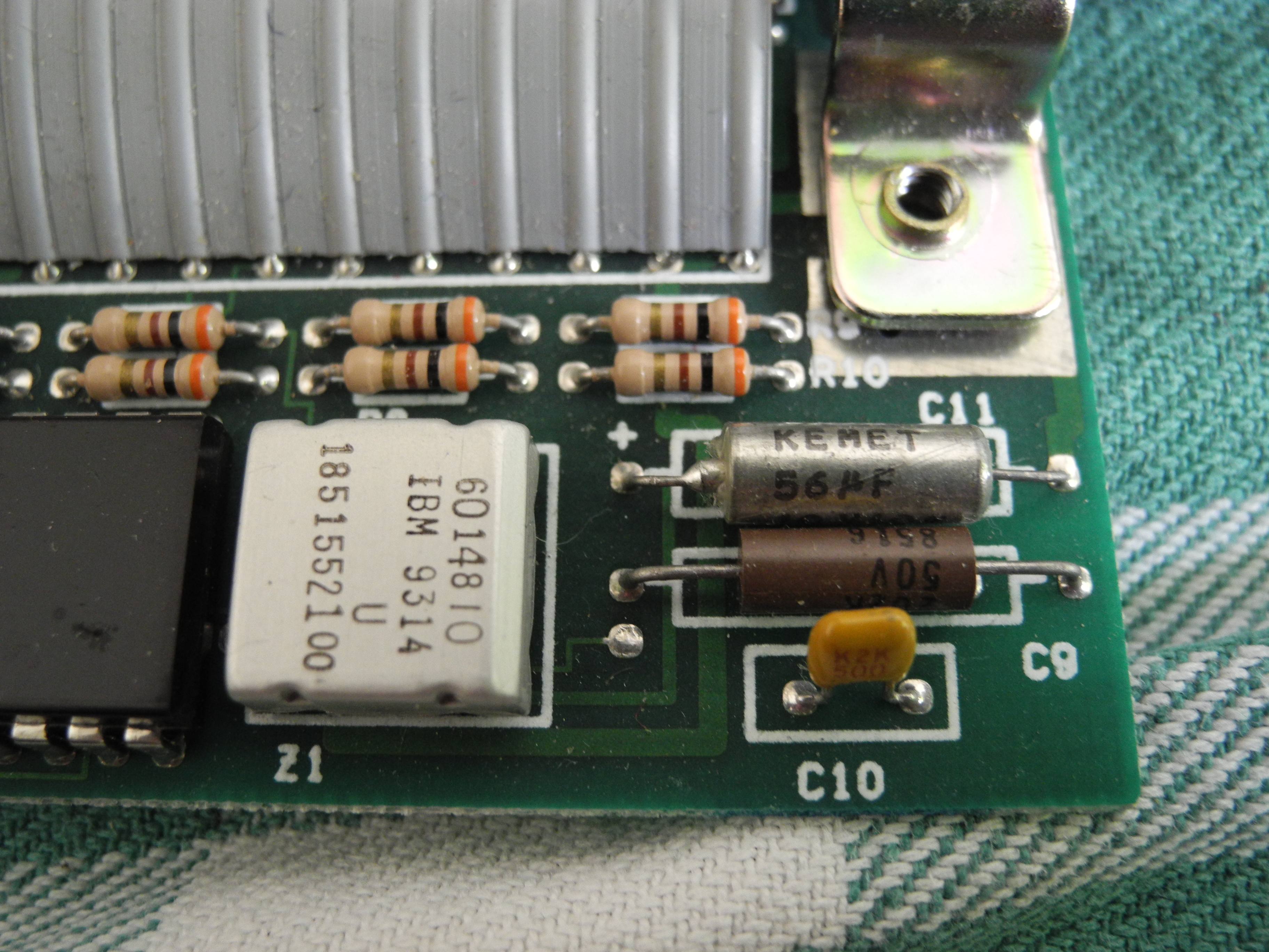

Does anyone know what the marked Pin on the controller or Pin 3 on the DIN 5 connector does?

The diagram of the connector that you posted shows it: it is unconnected and has no purpose. The AT and PS/2 protocol only needs 4 cables: data, clock, +5V and gnd.
Nuum
23 Aug 2014, 16:28
That's right, would have thought that, too. But I tracked the line and it connects to the capacitor C4 and then connects to one pin of C7, C8 and C4 and then goes into the bottom right pin on the "El Salvador" chip, where it splits and ends up at the black cable, which is ground.
23 Aug 2014, 16:33
There was a fifth earthing pin on IBM terminal keyboards, which would separate at the controller and lead to an earthing wire which led to the backplate and often the space bar, too. The keyboards work fine without it connected. Although I actually use the earth provided by the USB socket. You can earth by connecting to the outer shielding foil in USB cable. In fact, standard practice is that the exterior of USB, DIN and mini-DIN sockets are all earthed, so you just ride that chain.
Nuum
23 Aug 2014, 16:41
Ok, then that's probably not the problem, thanks you two.
Maybe it's C9 then, of which I don't know, what kind of part it is and which gives me infinite resistance?

I think the theory that the PS/2 port doesn't provide enough power seems to concur with the symptoms you have, as xwhatsit pointed out: the keyboard starts, then the power is interrupted by some limiter on the motherboard, then it comes up again etc.
C9 should be a capacitor, C generally means capacitance, and the other Cs on the board are all capacitors. Also, a capacitor should have infinite resistance to direct current (in spite of what you measured with the other ones).
Nuum
23 Aug 2014, 16:54
I'm kind of an electronics noob, so please excuse me if I say something wrong. All the other capacitors give me a real resistance as well, which was kinda odd to me, too, but I wasn't too bothered, because as I said I don't know much of electronics. Someone told me via PM to measure these.
Halvar
23 Aug 2014, 16:59
I think that's because everything you measured sits on a PCB with lots of other components that can interfere. But I'm not exactly a pro either.
23 Aug 2014, 16:59
Remember that these components aren't in isolation. There could be other routes around the PCB between your probes. I'd hold off until you get a good active PS/2 adapter.
Halvar
23 Aug 2014, 17:05
I agree. Don't start to solder out the capacitors! ;)
