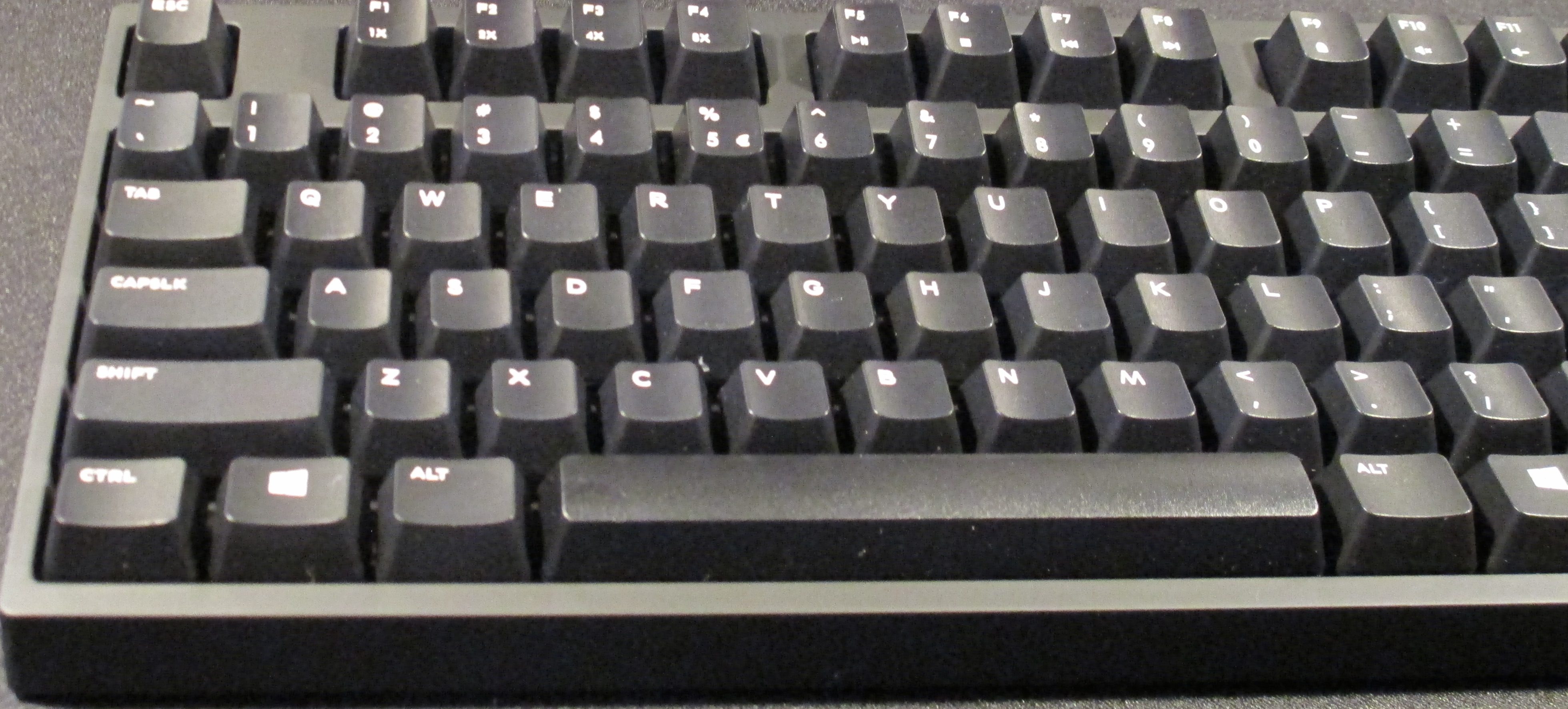

Inside the box is the keyboard with its stock keycaps (black ABS with lasered white-inlay legends), a USB cable with a right-angle micro US connector and thick braided insulation, a brief manual, and a bag of black O-rings.

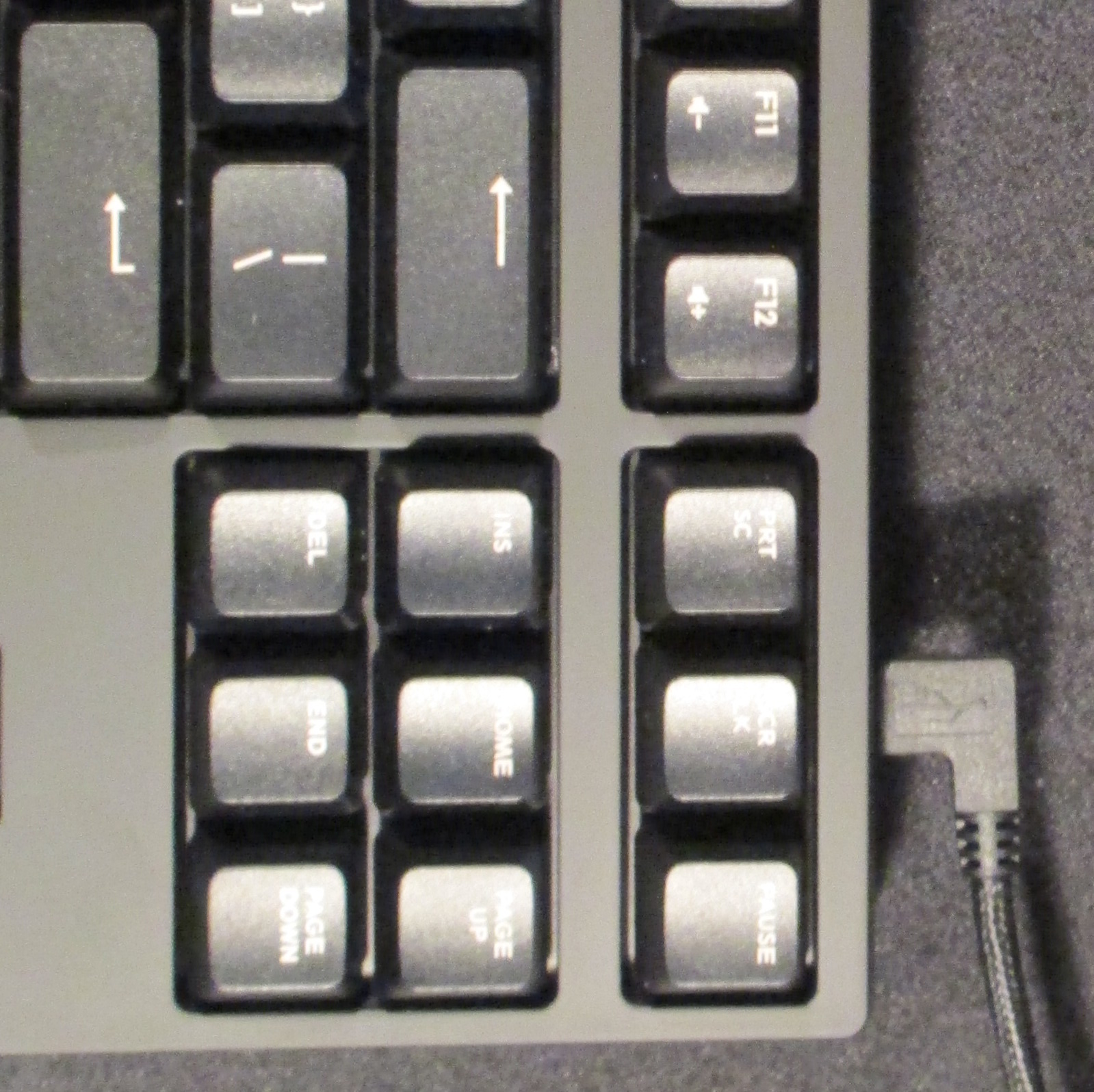

The CM Novatouch keyboard measures 35.9 x 13. 8 x 3.9 cm, weighs 895 g, and has no LEDs or DIP switches. For comparison, the RF 87u measures 36.6 x 16.9 x 3.8 cm, weighs 1200 g, has LEDS under the CapsLock and NumLock keys, and includes DIP switches on the bottom of the keyboard.
The stock caps and right-angle connector of the Novatouch are shown below in a series of out-of-focus potato pics. My own preference is to have the connector on the left rear of the keyboard rather than the right rear as in the Novatouch. I am also not fond of the thick braided cable. Fortunately, the cable is detachable and could be replaced with a thinner one with a right, left, or straight angle.

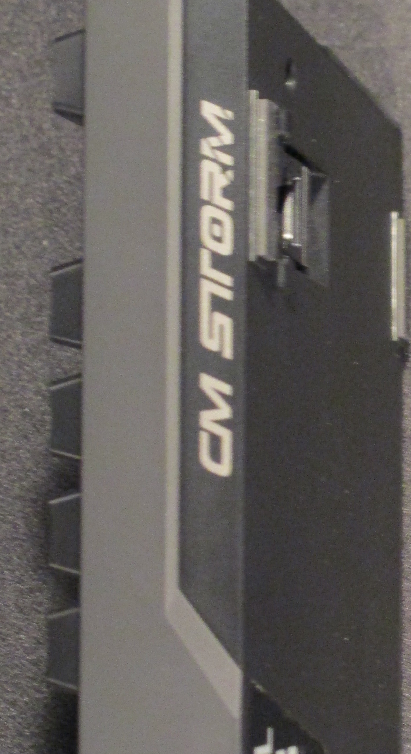

The Novatouch case is matte black with a smooth finish -- it does not feel rubberized like some of the other CM models. The case feels solid with no flex or creaking, except when pressing down near the top center, between the F8 an dF9 keys. Branding is confined to a logo on the rear of the case:

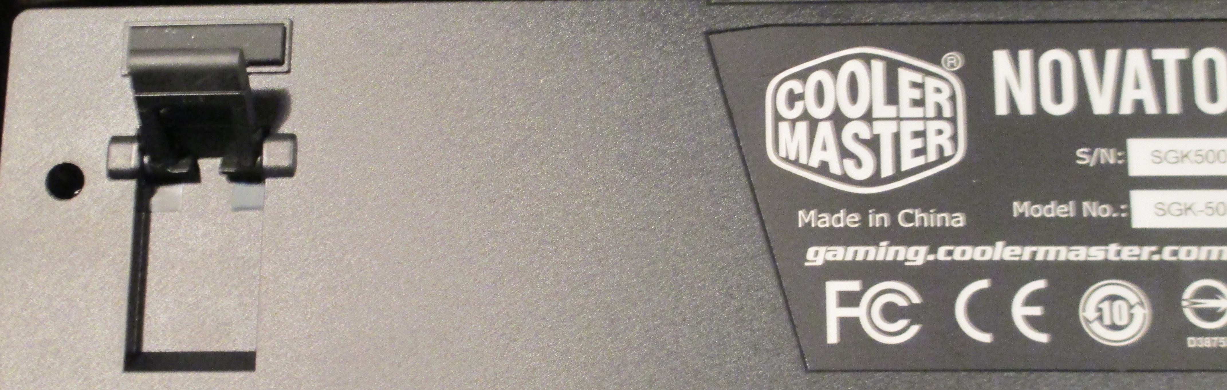

The label on the bottom shows that the keyboard is made in China. This view also shows one of the flip-out feet, which has a rubberized surface to grip the desk:

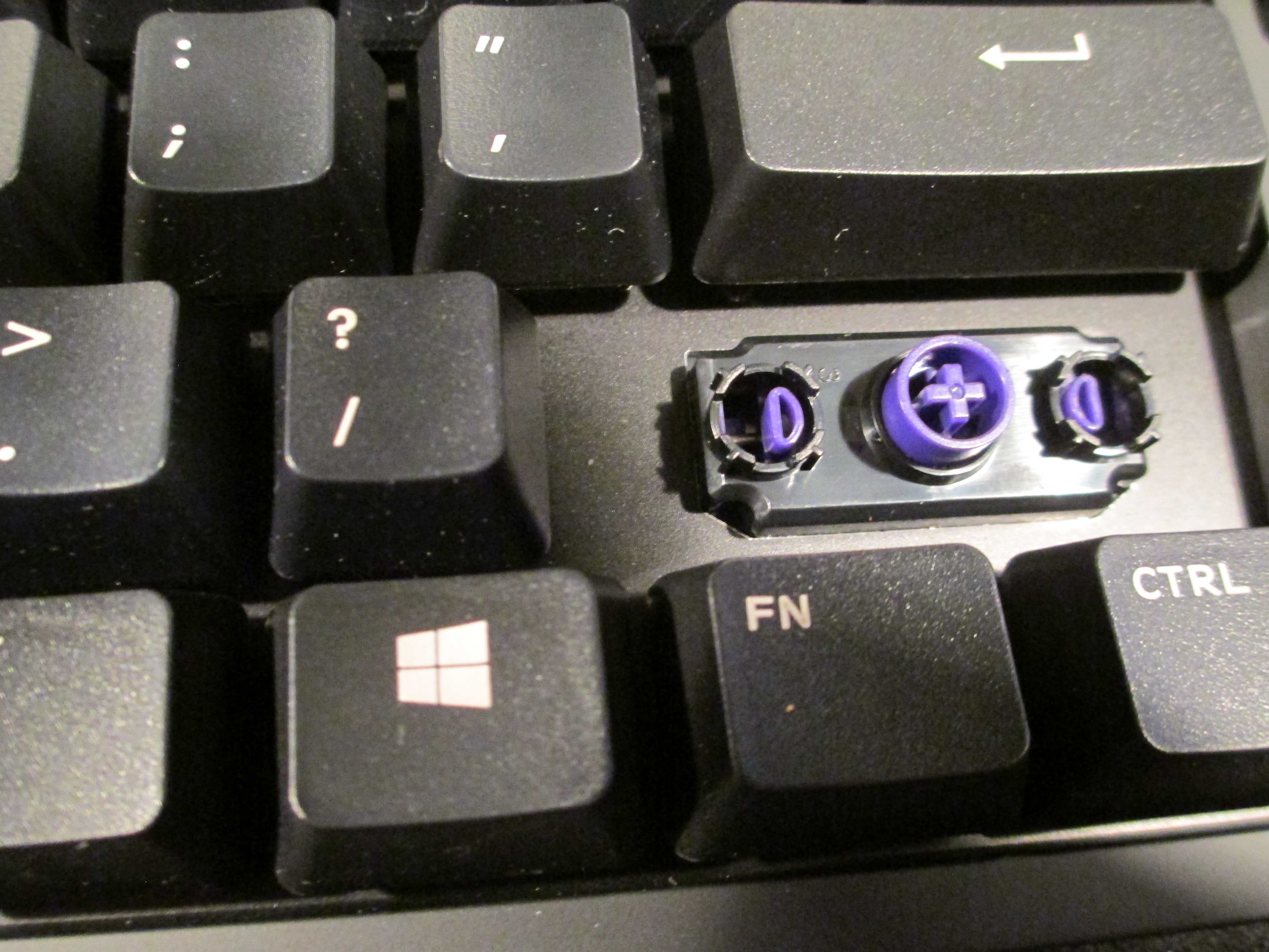

The widest keys on the board are equipped with stabilizers:
Unfortunately, IMO, the stabilizers have a somewhat negative effect on the feel of these keys, and they generate some stabilizer noise, which I find mildly irritating.
Indeed, I found typing with the stock keycaps to be unpleasant, both with respect to feel (the ABS caps are clammy to the touch) and sound (the caps are thin and the bottoming out "thock" that one gets with other Topre-switch boards is somewhat overwhelmed by a higher-pitched plastic-on-plastic sound).

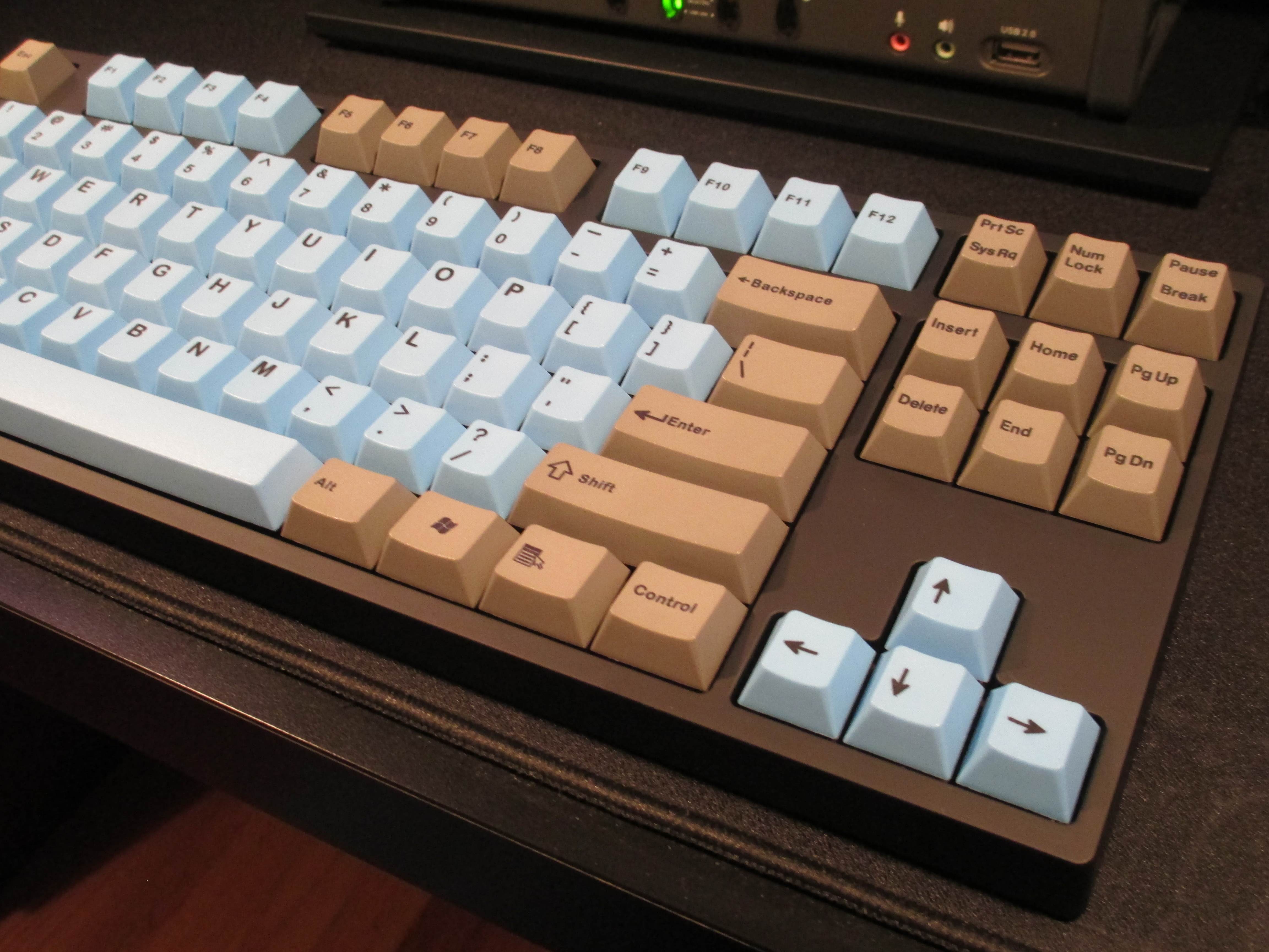

The appearance, sound, and feel of the Novatouch board were markedly enhanced after installing $200 worth of dye-sub thick PBT keycaps from geek_feng:

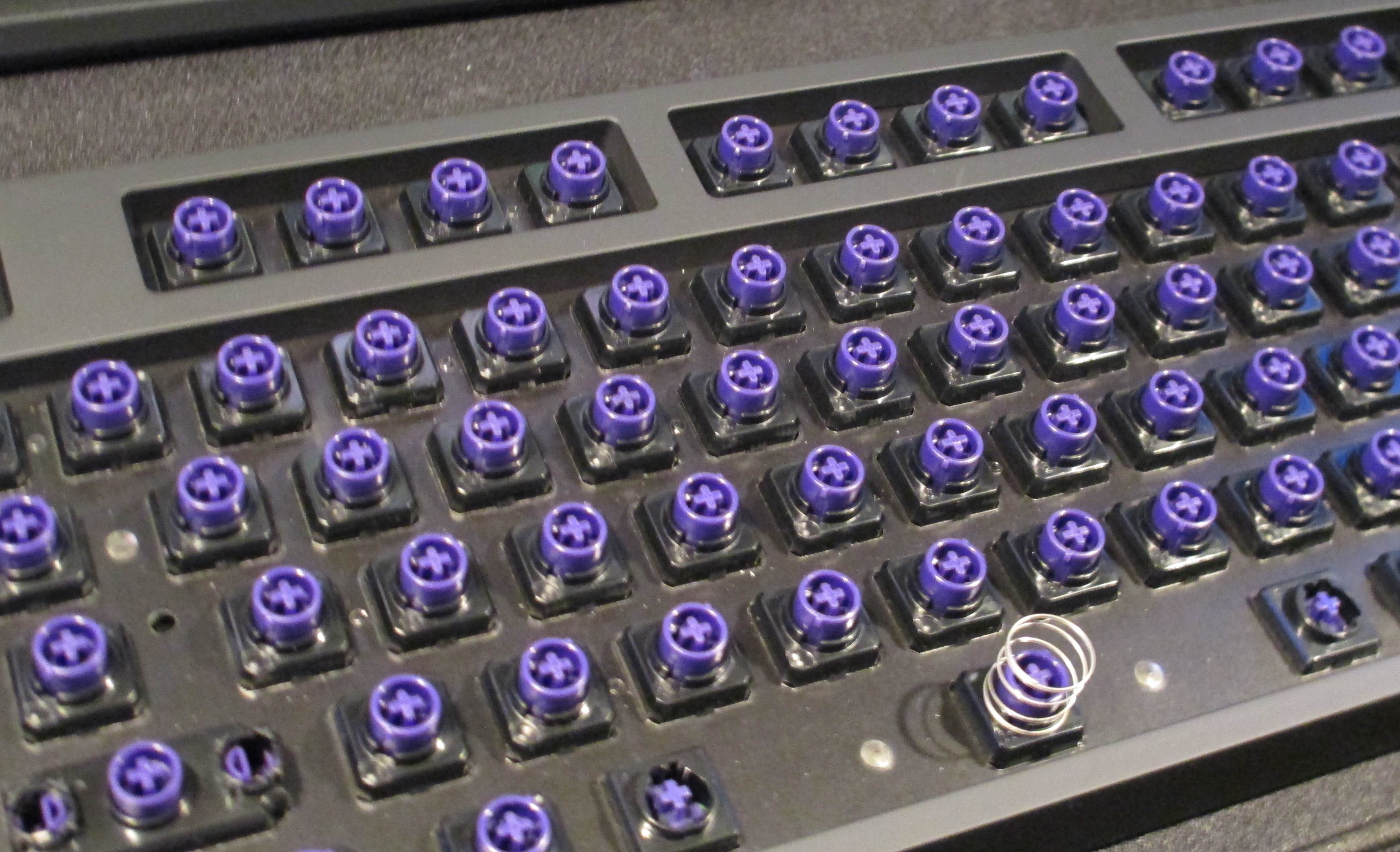

It was very easy to remove the stock caps from the Novatouch and to install new Cherry mx-compatible caps. It is important to note, however, that although the switch mechanism is Topre, the stems are NOT compatible with Topre keycaps.
I also found that the dye-sub PBT keycaps I used had a very loose fit on the Novatouch, so much so that with O-rings installed, the keycap on the "O" key would pop off while typing and fall off when the keyboard was inverted. Although Imsto keycaps are known to have a looser fit than some other brands of Cherry mx keycaps, the problem with the "O" key was intrinsic to the key rather than the keycap, because when I swapped the "I" and "O" keycaps, it was the "I" keycap that popped off during typing or when inverting the keyboard. I was able to make the keycap fit more securely by pushing a small square of cling wrap into the keycap mounting socket.

I still don't get how those stabilisers work. How do they attach to a Cherry keycap? Inserts?
Hypersphere
03 Sep 2014, 01:21
Daniel Beardsmore wrote: I still don't get how those stabilisers work. How do they attach to a Cherry keycap? Inserts?
They appear to work like Cherry stabilizers on a Cherry mx board. You install the Cherry mx keycap by simply pressing down over the stem.
The spacebar looks like all three stems are inserted in the cap posts, but on the others (smaller stab keys) only the center is inserted and the outer stems just sit on the top of the stabilizer posts.

mj45 wrote: The spacebar looks like all three stems are inserted in the cap posts, but on the others (smaller stab keys) only the center is inserted and the outer stems just sit on the top of the stabilizer posts.
That's what I was wondering. I guess it makes sense really, since pressing on either side will pull the centre down, and that should be enough to keep it level and stop the force on the switch being too diagonal.

Isn't it a miracle how a set of different caps can change the appearance of the case? It's a NovaChameleon! :D

Halvar wrote: Isn't it a miracle how a set of different caps can change the appearance of the case? It's a NovaChameleon! :D
Unfortunately, much of this illusion arises from my poor photography, lousy camera, and bad lighting.

You did that pretty well - the cold/blueish light with the grey original caps and the warm/yellow light that makes the case look brownish with the beige caps. I admit I thought it was done in software afterwards.

Halvar wrote: You did that pretty well - the cold/blueish light with the grey original caps and the warm/yellow light that makes the case look brownish with the beige caps. I admit I thought it was done in software afterwards.
Nope. Same lighting. No photoshoping. Probably different reflectivity of light from the all black keys vs lighter keys. Some day I hope to learn how to take pictures!
03 Sep 2014, 19:27
Hypersphere wrote: Probably different reflectivity of light from the all black keys vs lighter keys.
Probably automatic white balance. I get white balance errors even on manual — there's always a certain degree of automatic adjustment, it seems.
03 Sep 2014, 19:31
Depends on the camera. Generally speaking, the more high end (like a DSLR) the less handholding and vengeful error making it will insist for you. Smartphones are particularly egregious at this. You're basically running a wizard instead of a piece of hardware.
