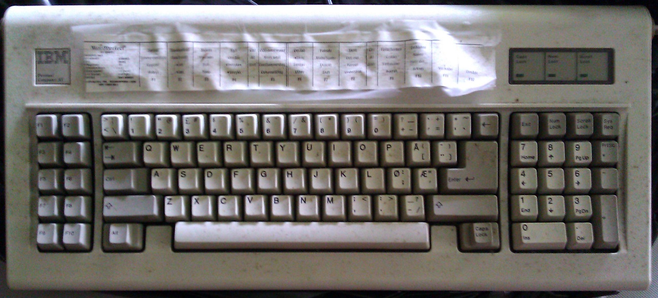

Found an IBM Model F in the attic!
Minskleip
25 Jun 2011, 16:23

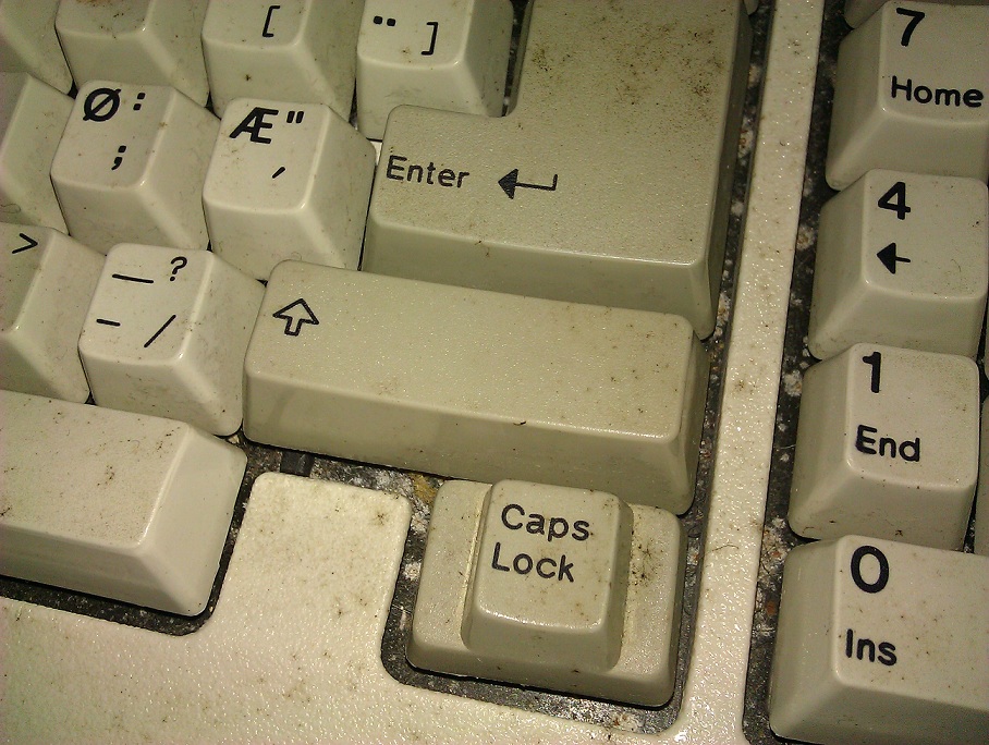

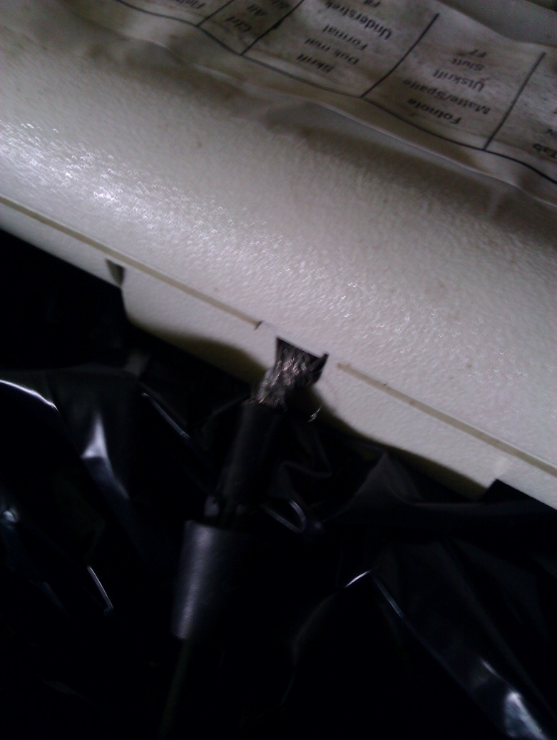

So cool, except that it's quite dirty and the cable is falling off. The paper is a cheat sheet for Word Perfect haha. Ctrl is at the right place too!
Any suggestions for how to clean it up?

I usually start removing all the keys and bathing them with dish soap in hot water

Looks like it's been damp at some point too. I'd check the innards for corrosion and mould growth/residue. Stuff like that will come off the plastic fine with a soft detergent solution and some elbow grease. If I found something that looked in that condition though it'd be in for a complete dismantle/clean/rebuild.
Good luck!

Gloves and denture cleaning tabs for the keys.

The common way: isopropyl alcohol.
Gently rub with a dampened cloth and while still moist wipe away with another, clean cloth. Repeat if necessary.
Do not rub labels, though, as it might dissolve printing ink.
