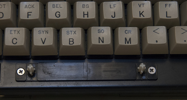

Notice the strange spacebar setup. The two sliders in the middle are connected with a flexible plastic on the other side (couldn't take a picture without disassembling - I could only barely bend my eyeballs around to take a look). A third slider is pressed with the ridge on the underside of the space bar.
Edit: I thought it was flexible plastic because it was transparent and from the angle I could see it from looked like it was flexing. It's actually two pieces of (non-flexible) plastic with interlocking teeth. (see post below)

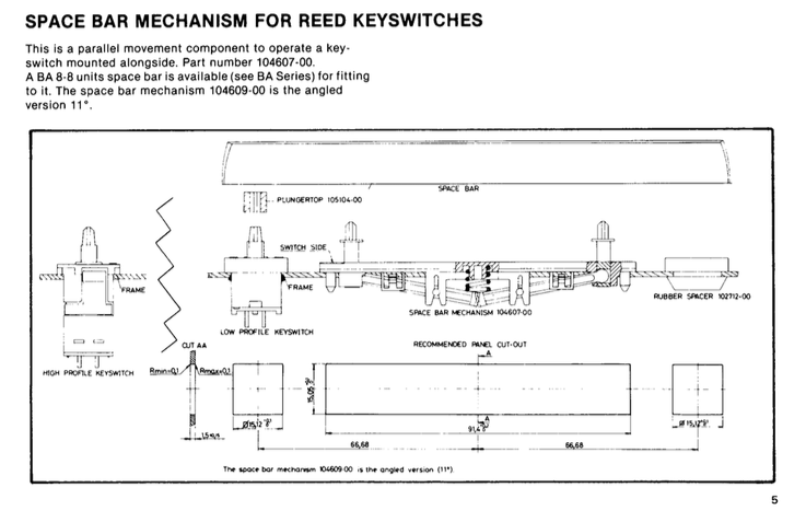

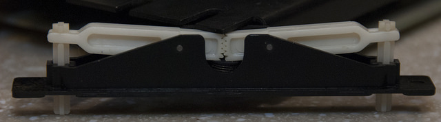

I am no expert on switches, but might I suggest that these switches you are looking at are in fact Clare-Pendar? Flickr
Specifically the tops of the switches, the arrow on the space bar, as well as the space bar design. They look like the same mount/slider, and I also see in your side view that the switches have the same design of small plastic box separators around each switch (something I did not document very well, I now see).
I know that Clare-Pendar had a very unique spacebar design (that I believe they patented somewhere) so if it is the same type of space bar as this then I would bet we have a match:
Screen Shot 2014-09-16 at 6.12.00 AM.png (121.38 KiB) Viewed 6458 times

pyrelink wrote: I am no expert on switches, but might I suggest that these switches you are looking at are in fact Clare-Pendar? Flickr
You're right! Mine is transparent orange.
I didn't realise the space bar assembly is easily removed and that the whole thing is just a stabilizer. The actual spacebar keypress is registered by the switch beside it.
