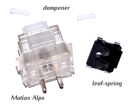

Today, I opened a Matias Alps tactile switch, going be Ripster unbeatable guide ( http://imgur.com/a/elAFF/noscript ).
First, I tried to swap in an MXBROWN spring, but without luck. The diameter is a little too large to fit into the switch.
Then, I removed the 2 dampener, put it together and got a super-tactile-smooth switch.
The dampeners are there to dampen the tactility a bit. Now I opened it again and left the leaf-spring away. I expected no tactility anymore. But the way the contact is closed gives a little bit tactility and now, the switch is super smooth and almost as light as an MXRED.
:ugeek:
Edit: The thing with the dampeners is nonsense. I just tried. All they do is dampeneing bottoming out and topping in (or what it is called).

Aren't those dampers meant to soften the bottoming out and topping out sounds? (And are therefore awesome?)
Try making a damped clicky. Or a damped linear. You've got the switches lying spare…
20 Sep 2014, 17:04
Yes.
:oops:
I think they add one effect: The starting point is a bit lower and therefore the tactility is a bit more dampened.
What I would like to have is a lighter spring for the clicky switches. They are between greens and blues.
Or maybe the leaf-spring contributes to the force.

You get a free leaf-spring (with which you can turn them into tactile Alps) for each switch!

If you order the ALPSML switches, I remove the leafs and ship them with the switches.
These are no Frankenstein-switches!
:mad:
They are like a sports car with silencer and catalyst removed!
:evilgeek:

7bit, are the dampeners what makes a matias clicky diferent from the quiet version ?

The white Alps springs (from Ortek MCK-142Pro) are a little lighter than reds when mounted into a leaf-free Matias, while the original Matias spring is slightly heavier.

By the way, Matias themselves are planning to sell linear switches with no tactile leaf and a slightly different spring.
