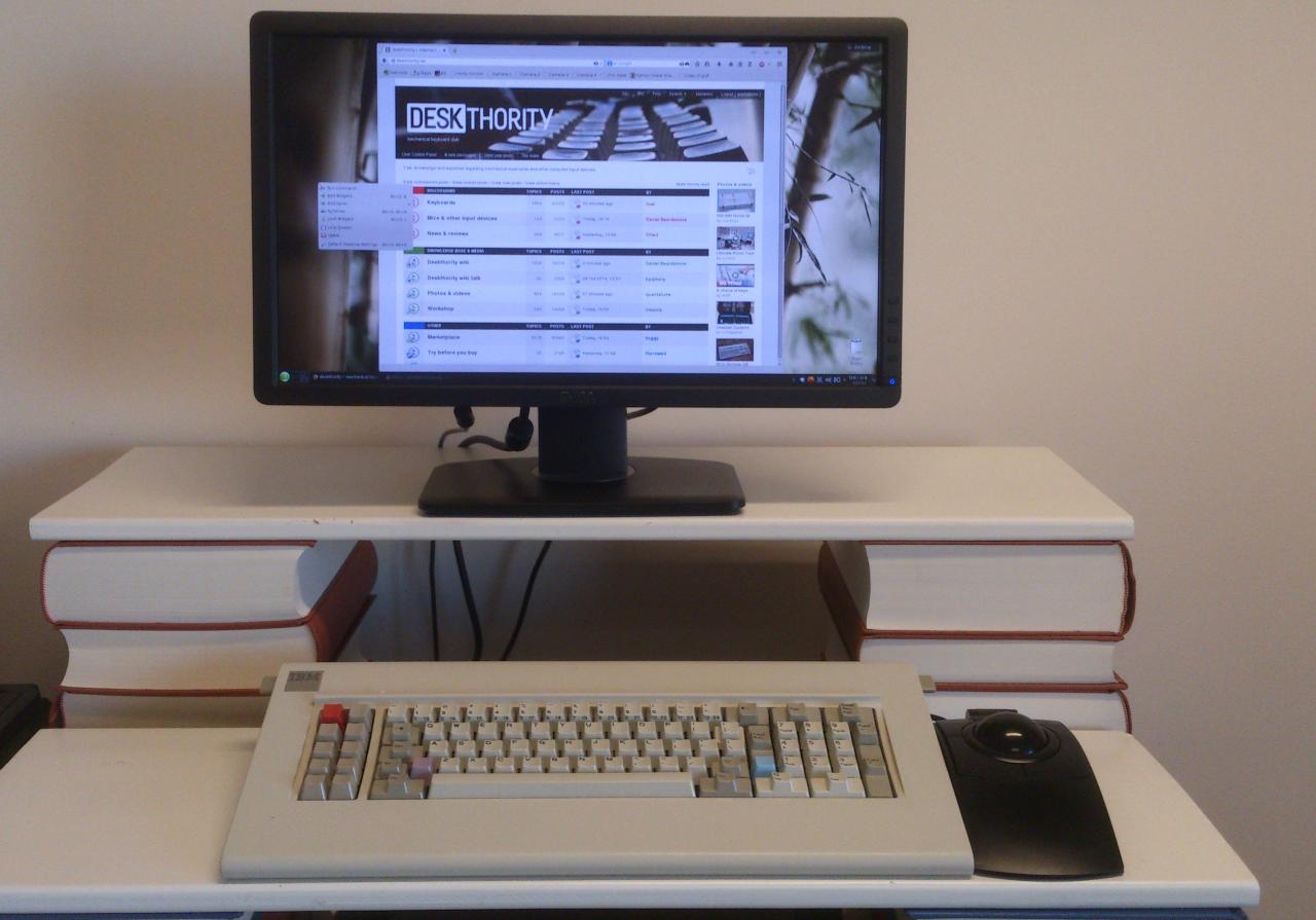

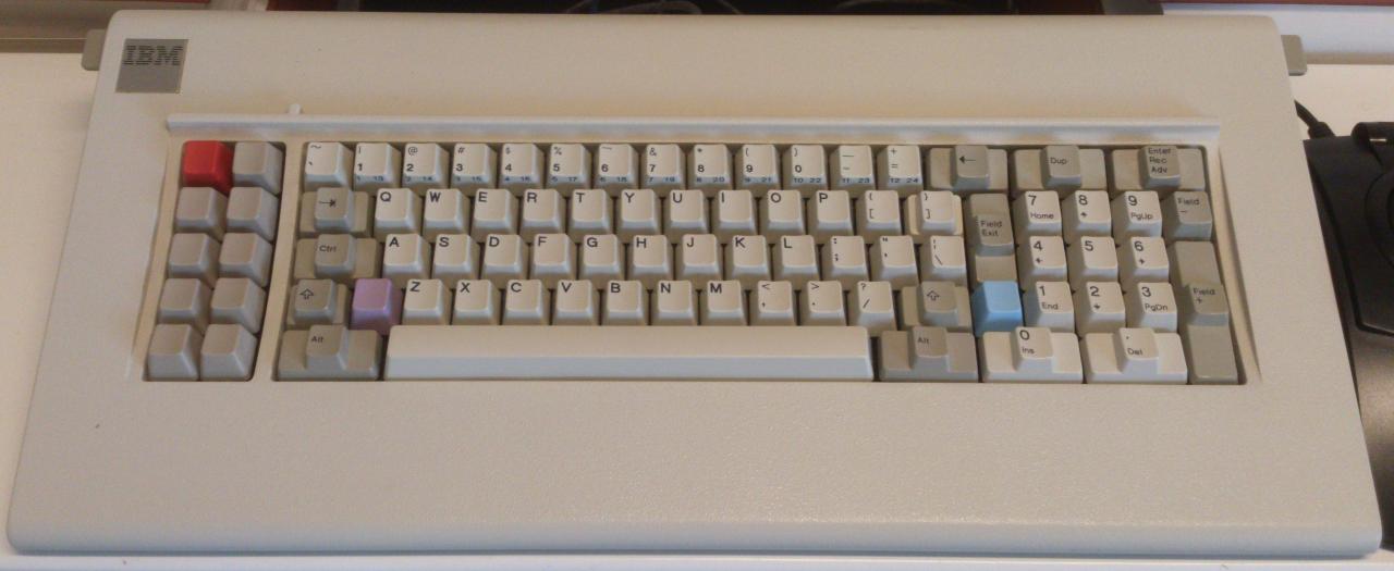

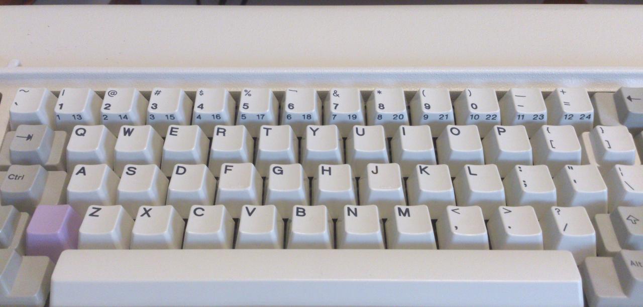

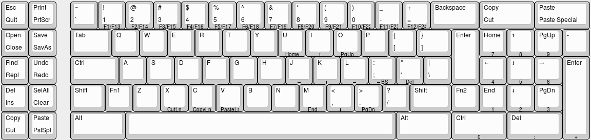

The Model F keyboard from the IBM 5291 terminal, affectionately (or not) dubbed "bigfoot," seems to be much maligned in the keyboarding community. However, I recently restored one that I obtained through one of Cindy's hauls and have been using it daily. Thanks to the brilliance of Soarer's controller (and the instructions for adapting it to bigfoot here), it's a relatively simple matter to interface it to a modern computer and have greater flexibility in key mapping than with just about any present-day factory keyboard.
I'm currently using it with my standing desk.
Set to its middle elevation (the legs allow 3 different heights), it is perfectly level with my CST trackball. While the extra case material in front of the space bar might be objectionable for seated use, it works perfectly well for a standing desk, and I find it convenient to rest my hands there when not typing. The extra case material on the sides places the pointing device 12 mm further away than the XT, but it's still on par with the AT in that regard and 67 mm closer than the "enhanced" Model M.
Being essentially an XT sans controller on the inside, it has the same clicky, pingy goodness (on the upside for most) and layout (on the downside for most).
However, I've never had any issues with the XT layout, and bigfoot has rather nice numeric caps with front-printed legends that lend themselves to remapping the function keys there. I use F13-F24 for quick-launch functions, so this is a definite plus for me.
Putting the function keys on top frees up the left-hand cluster for macro and other usage, and this is the mapping which I currently use on my XTs and bigfoot:
Am I the only one who likes this board?

Thanks for your homage to Bigfoot. Glad to see the board appreciated and put to such good use.
I have not yet tried using a Bigfoot, but I use my refurbished XT, which has the same layout. Because I use a Mac and I like the HHKB layout, I have remapped my XT accordingly. The XT/Bigfoot layout has some distinct advantages, such as some "extra" keys to the right of each Shift that are perfectly suited as Fn keys.
18 Oct 2014, 21:31
The 5 key on your numberpad: do you really have it set to UP, Quantal? I use my XT's numpad the same way (I consider it a nice roomy navigation island first, and a numpad second via Fn) but either leave 5 UNASSIGNED or set it to DOWN on the base layer, in case the inverted T haunts my muscle memory when I'm on it.
quantalume
18 Oct 2014, 22:35
Yes, you're right, it's down. I made a mistake in the layout editor.

On my XT, I have remapped the Backslash key as Enter/Return and Right Bracket "]" as Backspace (Back Delete) as part of an overall remapping/reconfiguring of the XT into a hybrid ANSI/HHKB/Mac layout. This works surprisingly well without any modification other than remapping and swapping some keycaps.

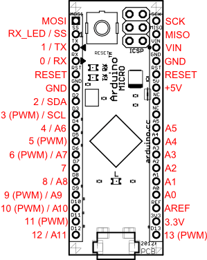

Quantalume, did you, by any chance, use a pro micro with Soarer's controller for the Bigfoot, instead of a teensy?
If so, were there any problems, or do you have any special notes deserving to be shared? Missing pins?
I am reading Soarer's docs/threads about his controller + Bigfoot combo, and also Scottc's thread about using a Pro Micro with Soarer's converter (where i have to see what changes when using the controller instead), but i'm still figuring out how to use the combined information (if possible).
quantalume
04 Nov 2014, 15:02
Hi, yes I did use Soarer's controller. You can't use a Pro Micro because it does not have enough contiguous pins for the multiplexer (muxstrobe_port PB6:0). I used an actual Teensy instead. I cut the end off an old 20-pin ribbon cable and soldered it to the Teensy and plugged the other end into the Bigfoot PCB.

Actually, i'll ask now (i hope it's ok to continue this thread - if not i can start another one, of course):
Q1. What is the teensy 2.0 <-> arduino micro (not the micro pro, but the larger model, with the reset button) pin mapping, usable for Soarer's controller?
Or, alternatively (teaching fishing instead of asking for fish), how do i find out this mapping?
(edit: i may have found it, after some reading)
Q2. Will Soarer's tools (scas, scwr etc.) work with this arduino board?

Laser wrote: Q1. What is the teensy 2.0 <-> arduino micro (not the micro pro, but the larger model, with the reset button) pin mapping, usable for Soarer's controller?
Yes, that's the chart to use. You might want to take the Arduino Micro pin out I've pasted here and annotate each position with the actual processor pin function from the chart you linked, as it will make hookup easier.

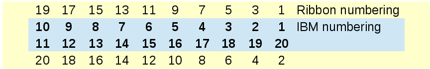

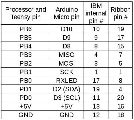

Assuming you are going to install the controller inside, one thing you might want to be careful of is the difference between the way IBM numbered the 20-pin connector and the way ribbon cables are usually numbered. Getting this wrong could fry something! This little diagram shows the difference:
ribbon numbering.png (17.87 KiB) Viewed 17769 times
This table brings everything together:
Of course, you could also connect to the external 15-pin D connector.
