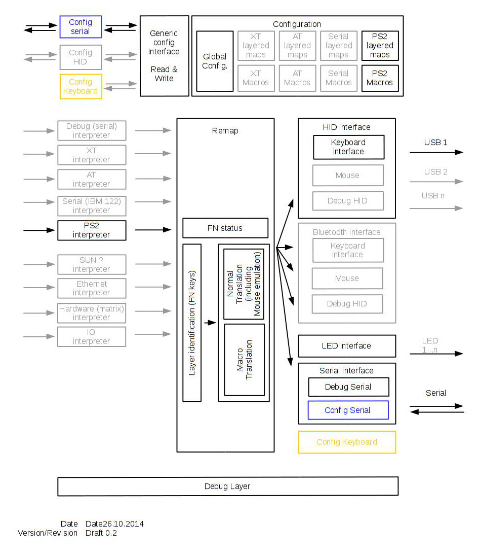

- i$k - draft architecture 0.2
- Architecture 0.2.jpg (136.63 KiB) Viewed 5189 times

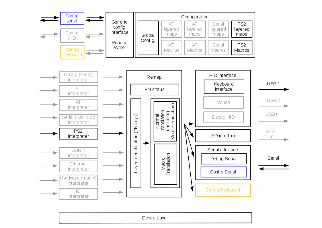

Original Post 2
Hello again,
I have drawn a potential architecture (draft 0.1).
Black items are, to me, the first to implement. But the interfaces, data structures etc ... should be defined from the beginning. This would allow people to focus on different modules.
I attach the image here, but I guess that it may be better to create a separated entry in the forum.
If people is willing to support this idea, we should create a repository in a collaborative site. I have not experience doing it, but this fact only adds to my interest in this (potential) project.
Attached you can find the VERY draft 0.1 architecture
Cheers
Hello again,
Cheers

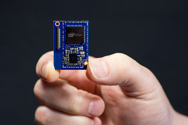

Original Post 3 - quantalume wrote:
Between the TMK controller and xwhatsit's controller, there is a large body of open source code already available.
I've been thinking about the possibilities of using the Intel Edison. Imagine having wifi, bluetooth, USB (including host mode) and Linux inside your keyboard.
- edison.jpg (31.67 KiB) Viewed 5210 times

Arakula
- Location: Austria, Europe
- Main keyboard: Unicomp PC/5250
Missing IMO is a PS/2, a serial, and a parallel output module; I got some (VERY old, admittedly) computers that get their input in ASCII from an 8-bit 6821 port (and a strobe line, IIRC - would have to look that up again). Would be nice to get that working, too... your "USB 1, 2, ..., N" output implies a multichip solution anyway, so why not.

Hello Arakula,
I have a attached the libre-office version of the drawing.
Feel free to add the modules that you are missing.
If you want me to do it, tell me.
PLEASE - use the naming conversion to keep the versioning until we do something proper.
PLEASE - post the new v0r3
Cheers

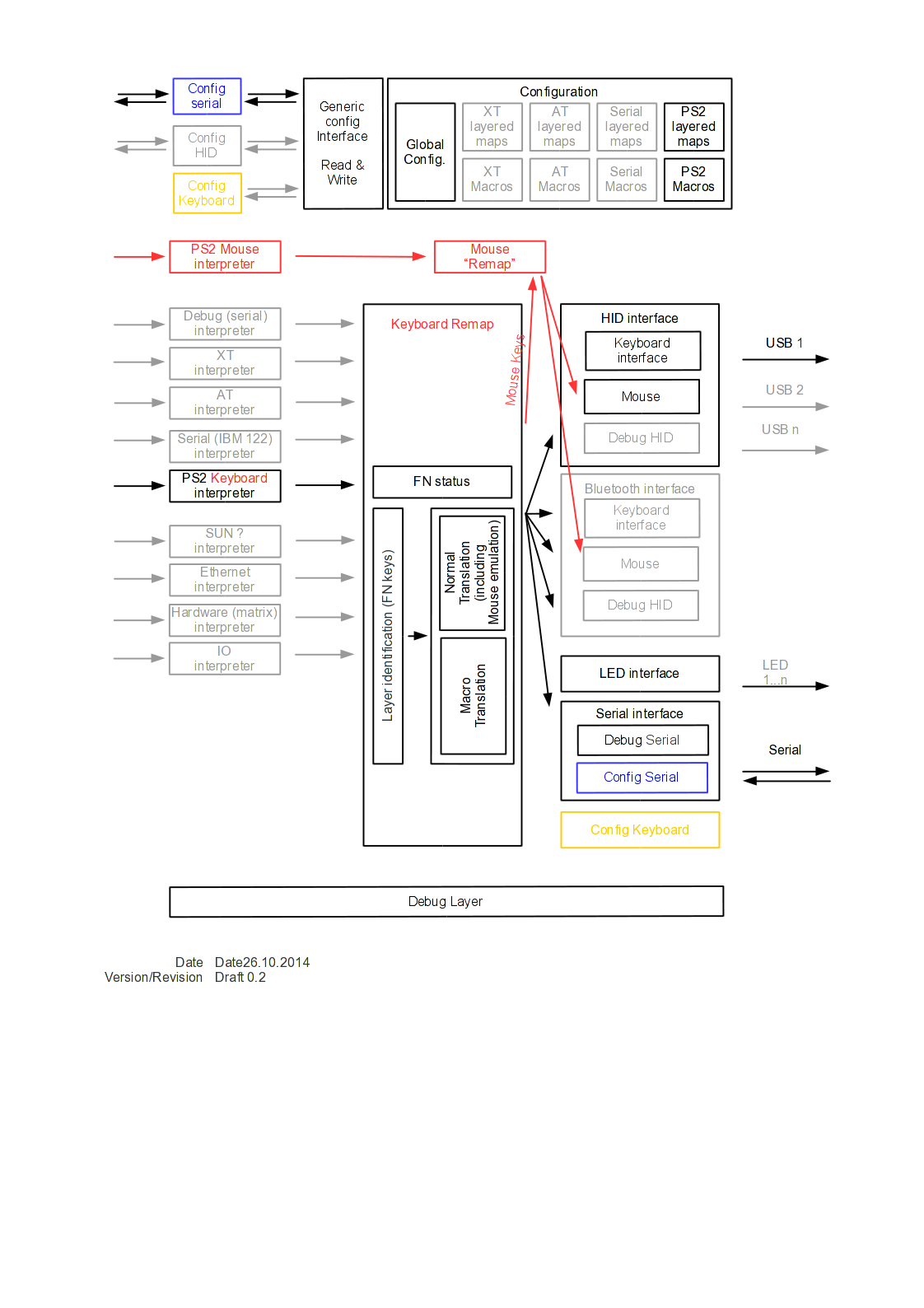

mtl
- Location: USA
- Main keyboard: Custom
- Main mouse: IBM TrackPoint IV
- Favorite switch: Cherry MX Clicky
Nice figure. What do blue and yellow represent?
FWIW, the code I was working on is here. So far all I've done is start porting ChibiOS to the Teensy 2.0/2.0++ (feature/teensy20pp branch) and start re-implementing maxtrix scanning code (feature/keyboard branch).
Here's an updated architecture that accounts for PS/2 mouse -> USB conversion as is common for keyboards with integrated TrackPoint. Changes in red. The mouse "remapping" is where middle button scrolling would be implemented.
- idollar
- i$
- Location: Germany (Frankfurt area)
- Main keyboard: IBM F or M
- Favorite switch: BS
Hello mtl,
Regarding:
I did not know find out a way to position them a single time in the drawing
Regarding the updated drawing:
I thought that we could treat the mouse as a keyboard. why not ?
The internal representation should include a parameter indicating the amount of displacement but the rest would be the same. This would allow to remap the keys and movements. One could also run a macro when a button is pressed.
If you agree, we should add a new section in the configuration for the mice.
Let me (us) know what do you think. I offer again the option of updating the drawing (if you accept this approach)
Regarding your code:
I need to go to work now. I have downloaded the code.
Cheers
i$
Regarding:
The two blue boxes are actually the same module. The same applies to the orange ones.What do blue and yellow represent?
Cheers
i$

mtl
- Location: USA
If you draw the architecture more abstractly, then yes, keyboards and mice can both be considered generic devices to be translated by the remapper. At this level however, it makes sense to distinguish between keyboards and mice because the interfaces will be different. For instance, probably what you have coming into the keyboard remapper on the left are physical key switch actuation events (scan code make/break signals), and on the right interface coming out are key press events (key codes).idollar wrote:I thought that we could treat the mouse as a keyboard. why not ?
There are some points of interaction between the two for keyboard mouse emulation and (as you mentioned) mouse-involved keyboard macros. So again it would be useful to draw keyboards and mice separately to indicate this.
Can you draw it in Inkscape?idollar wrote:I have a attached the libre-office version of the drawing.
