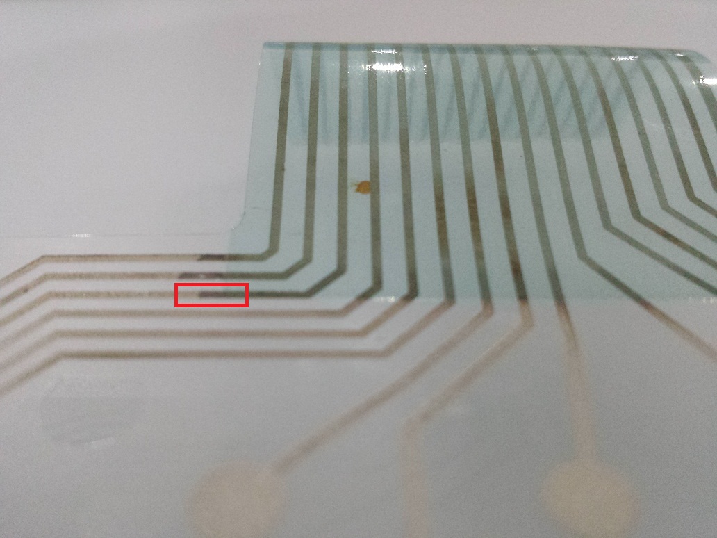

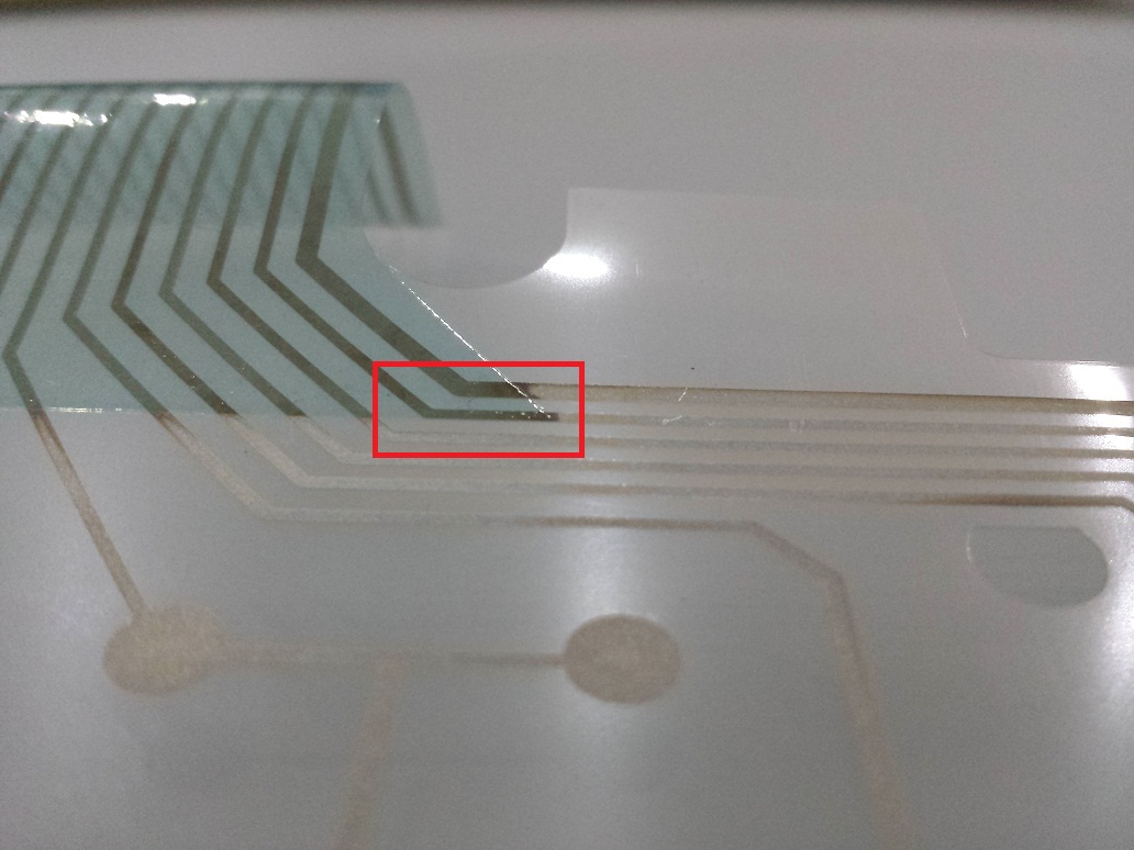

I dismantle the keyboard again and check the membrane. All the faulty keys are on the same line. I checked the conductivity between the edge of the membrane and it is broken.
This is the point where it is broken. You cannot visually see it. But it is broken.

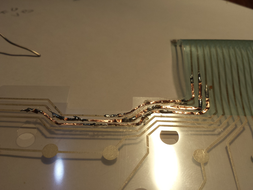

I have tried copper tape and ... it did not work.
It does not conduct on the side with the glue so I had to solder it. It eventually worked but the cable is not flexible enough and after doing back all my screws it broke.
Conclusion: use the Bare Conductive. Forget about the copper tape.

I was very impatient and I could not wait for the paint to arrive, so yes. I went to the local store and when I saw the copper plate I thought that I could manage with it.
It actually worked until I mounted the keyboard back. It then broke as it was too rigid.
The process was difficult. Actually it was VERY difficult. As soon as heat was applied to circuit in the membrane the conductive line was destroyed. The membrane surface survived without problems. The trick was to be fast enough with the soldering. This is why I had to follow the lines in the circuit until I managed to get it working.
As I said above, it all worked until I had to bend the membrane edge to get it in the controller. It then broke. I shouted in my desperation. The full process took several hours. Very frustrating.

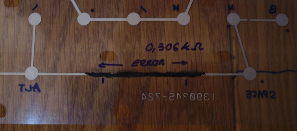

SOLUTION - HOWTO with pictures
All,
As promised here is my result of fixing a couple of membranes.
I will try to summarize all the process, for those that are interested to have a single reference.
The structure of the post follows (in two different posts due to the limitation in the number of images to include in each post):
  • 1.- Why were the membranes broken ?
    2.- First attempt and error
    3.- Second attempt – Bare Conductive Electric Paint
    • 3a.- IBM model M 1396790
      3b.- IBM model M 1391401
    4.- Conclusions
The pictures are hidden to avoid a longer post

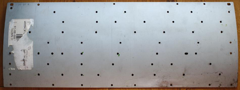

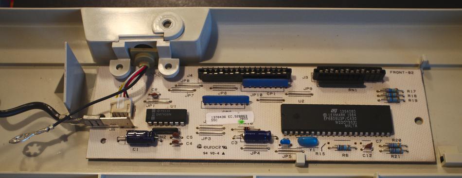

1.- Why where the membranes were broken ?

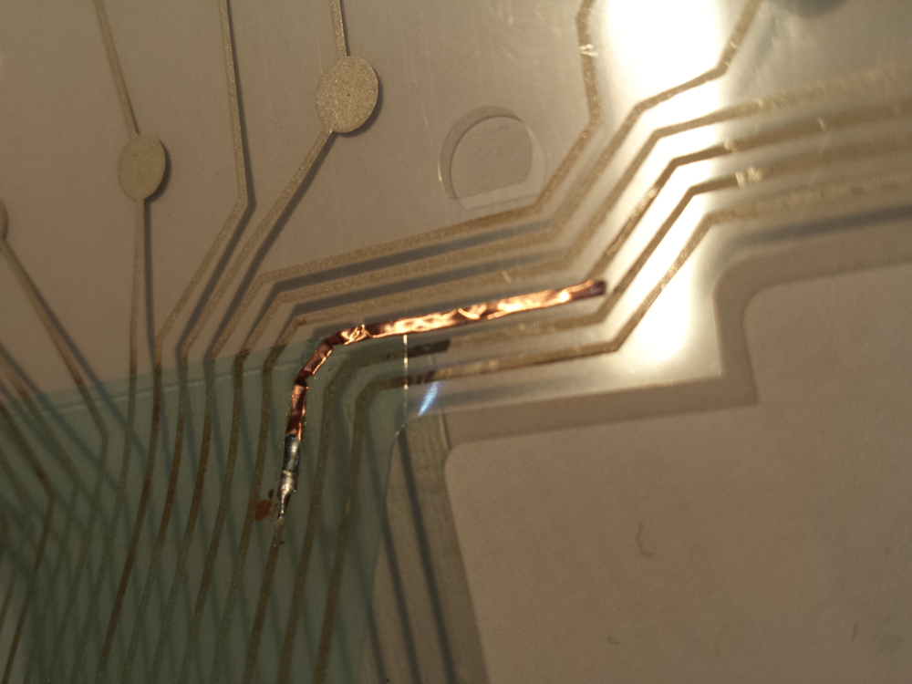

IBM model M 1391401: I procured this keyboard in ebay, USA. The seller told me that some keys were not working. He told me that the following keys were failing. I attach the text where the failure was described;
As for the non-working keys,
esc ` 1 tab q a z shift lctrl lalt g h + ] ' enter rshift rctl ralt
prtscrn scrllock pause home end uparrow leftarrow kypd+ kypdenter
kypd0 kypd.
At the time of procurement, I had no experience with IBM model M but I found repairing the keyboard an interesting challenge ;-)
The problem that I found (initially) is described in some pictures that were in the previous posts:
IMG_20141107_081440 - 2.jpg (176.26 KiB) Viewed 28448 times
IMG_20141107_081427 - 1.jpg (198.07 KiB) Viewed 28448 times
IBM model M 1396790: I procured this keyboard in ebay, Europe, Germany. The previous owner drop beer in the keyboard. I am not sure when did it happen. I do not know how long the membrane was exposed to the beer.

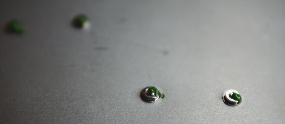

2.- First attempt and ERROR (do not try this !)
Initially, I tried to use copper tape to fix the membrane. The tape that I used had some glue on one side. This glue was not conductive. Thus I had to solder it to the conductive line in the membrane. This was extremely difficult. I eventually managed to do it.
I spent various hours, It initially worked but as soon as I put together the keyboard, the soldering broke in the part of the membrane that bended to the controller.
Following I attach some pictures. The result does not look very nice. But as I said, it was not easy.

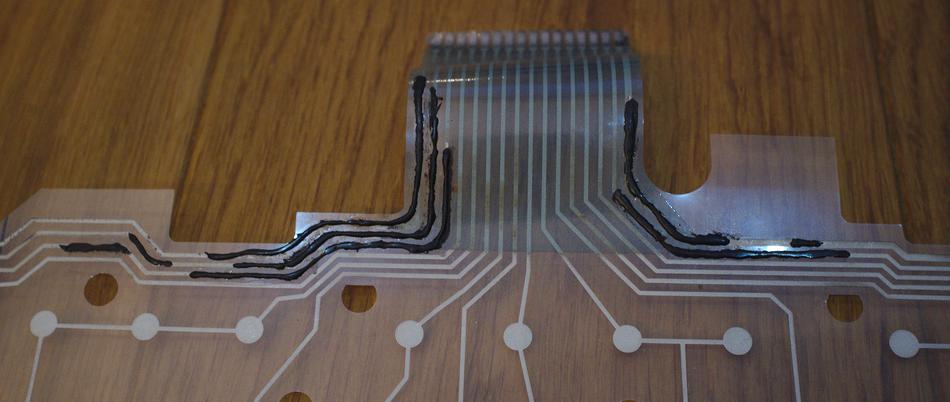

I got it following the recommendation of "cookie"
The ink takes some time to dry. It will become conductive only after it gets solid.
It is also important to notice the the resistance is significant as explained later in the post.

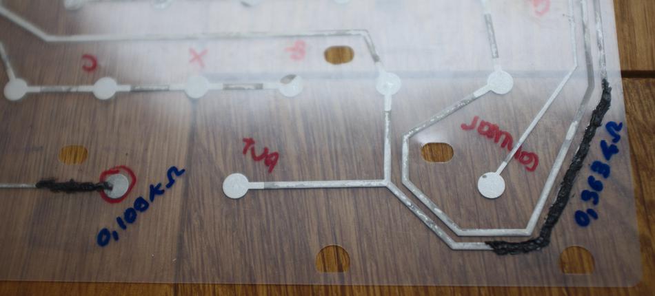

I started by replacing the copper with the ink. The resulting resistance was approximately 0.4k ohms.
In order to access the conductive line, I had to scratch the plastic protection on top. This plastic is only present in this section. If you have to do it, please do it gently. If you go to far you will destroy the conductive line. If you do note scratch enough you will not arrive to it. Always use a tester before "painting" on top. You may not have conductivity at both ends.

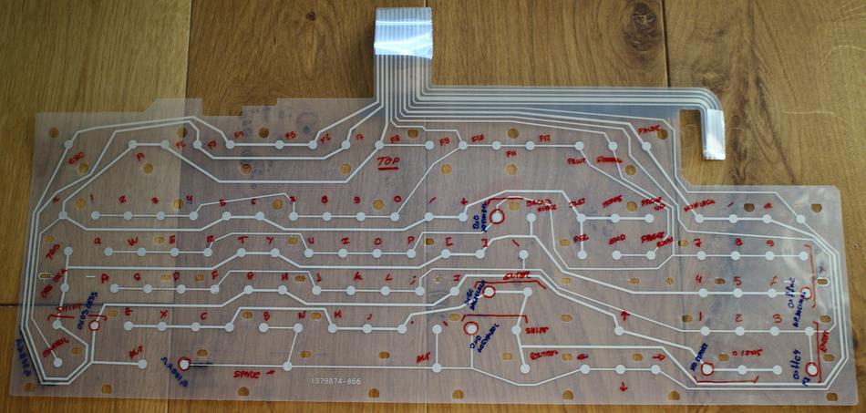

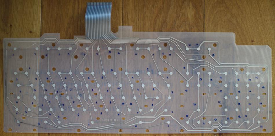

I checked the conductivity and I had to repair other sections on the membrane:

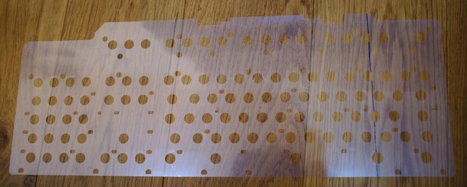

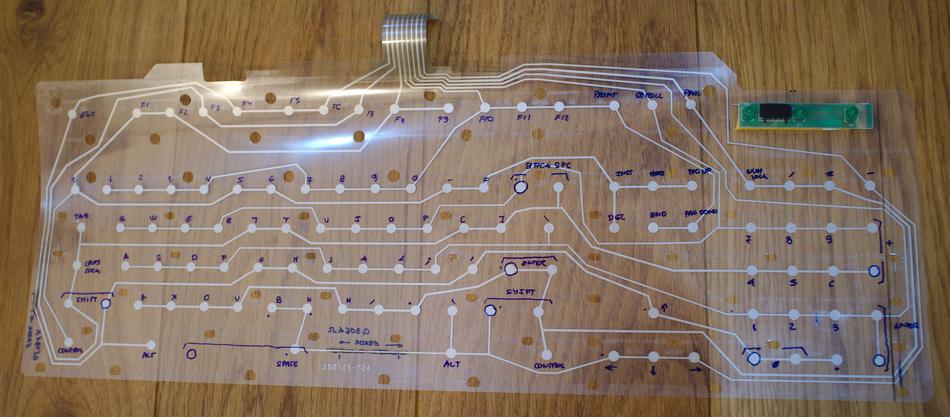

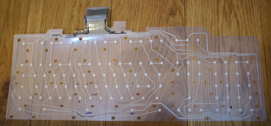

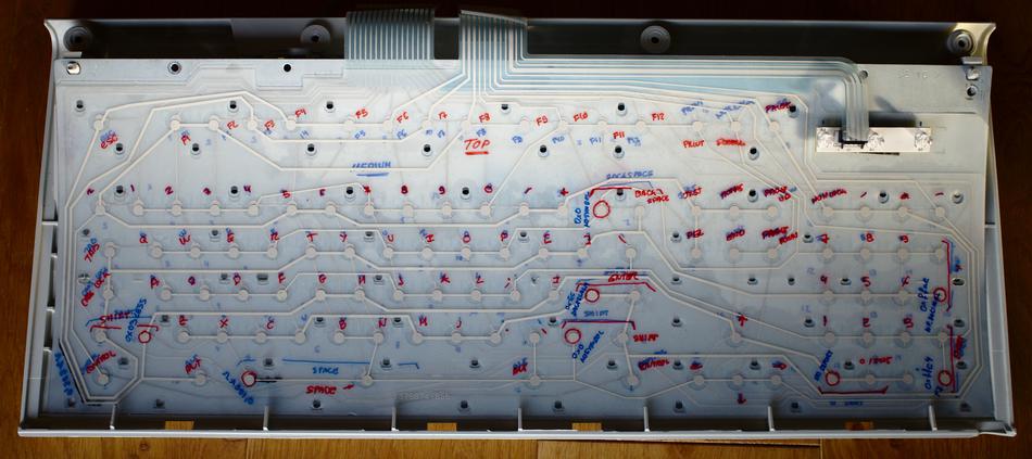

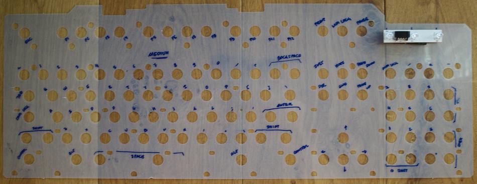

I attach also images from the different membrane layers. You will notice that I had to write down the keys.
I had some non-working keys; "g", "h", "b", "n", "left-ALT", "space", "0-num_pad", ".-num_pad" . I found the following errors in the membrane that I corrected:
I attach pictures of the marked membranes. Note also that I marked the points that are not used in the keyboard. I also wrote down the keycode:
--> continues in a second post. The software in the forum does not allow to include more pictures :-(

I also attach other pictures from the process:

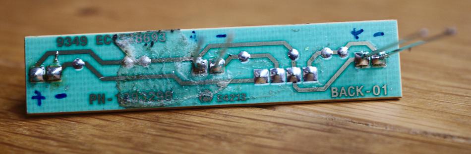

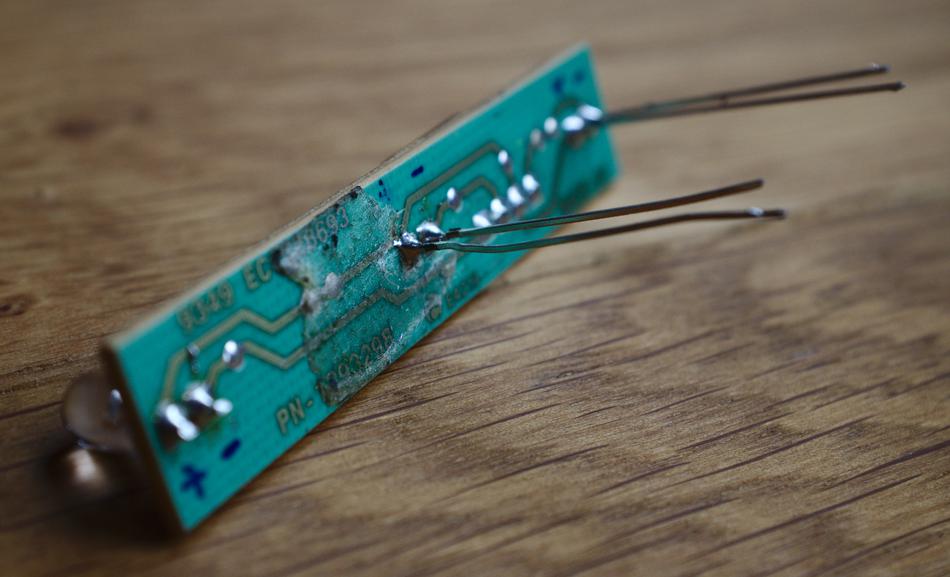

I also changed the LEDs with blue ones;
4.- Conclusions
My recommendations to repair a model m membrane follow:
a) Do not use copper tape
b) Use conductive ink
c) The conductive ink is not as conductive as the copper, but the keybard will still work. At least with the amount that I added documented in the pictures above.
Regards
