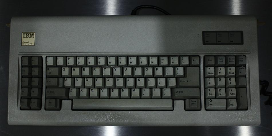

I have received an awesome IBM AT Model F keyboard. Model number 6450200.
it looks really nice. The logo was still covered with the protective plastic !

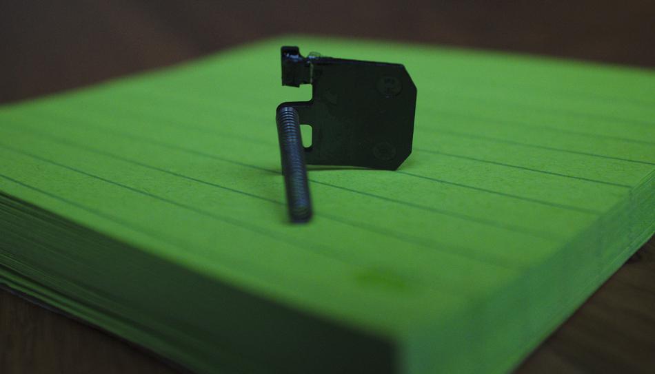

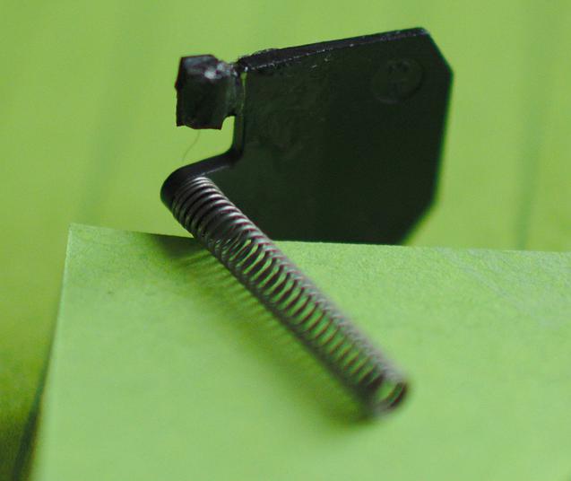

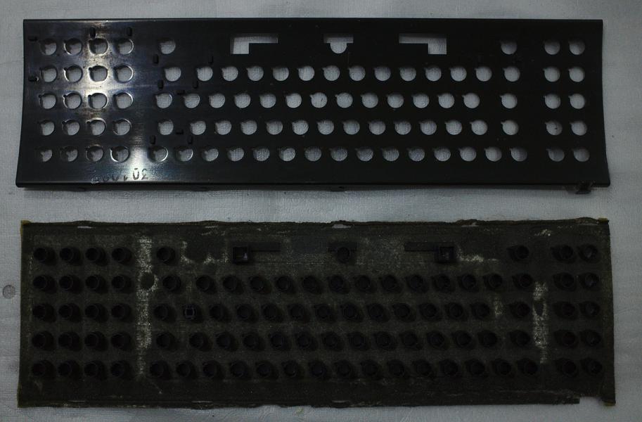

I followed the standard procedure to dismantle and clean. An to my surprise one of the bucklingspring foot was broken.

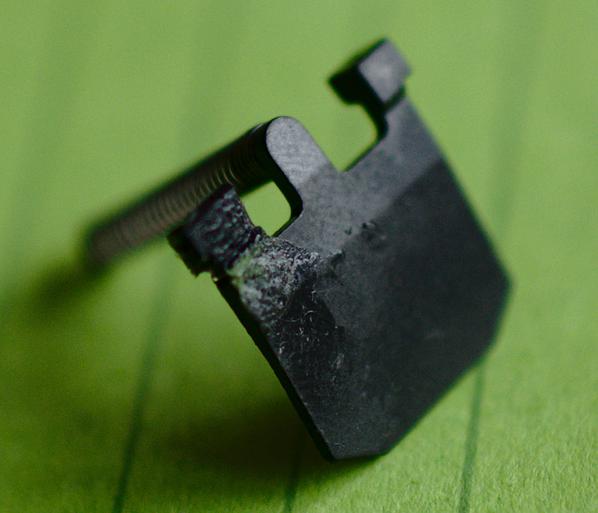

I am trying to fix it with epoxy glue. I had to carefully cut a plastic bit which is gluing right now. I am not sure how this will work. So my question is: Where can I get an IBM AT Model AT bucklingspring foot ?
I attach a picture of the repair process
I am adding some more other pictures for those with interest:

Where's your flipper broken? Here's one I found snapped in a Kishsaver:
Tricky thing to fix, I think. So I asked around and got some spares.

22 Nov 2014, 15:24
@Muirium - THANKS !
The one that I have broken is like the one on the right of your picture
I attach two more pictures with what I am trying to do. Better light and better lens may help :-)
I missed the broken bit, so I had to cut a piece of plastic to make it. I am already assuming that it will not work.

22 Nov 2014, 15:27
Yeah, looks snapped in just the same place, doesn't it? Must be a weak spot.
My picture is a Model M and a (broken) Model F spring side by side. If you saw the smaller ones inside your F, you'd be in trouble!

22 Nov 2014, 15:41
I just test it, without mounting back the keyboard, after 20 hours waiting for the glue to dry.
It does not work. I guess that it is mission impossible to get it fix. I was very careful with my repair, but it was not sufficient. :-(
