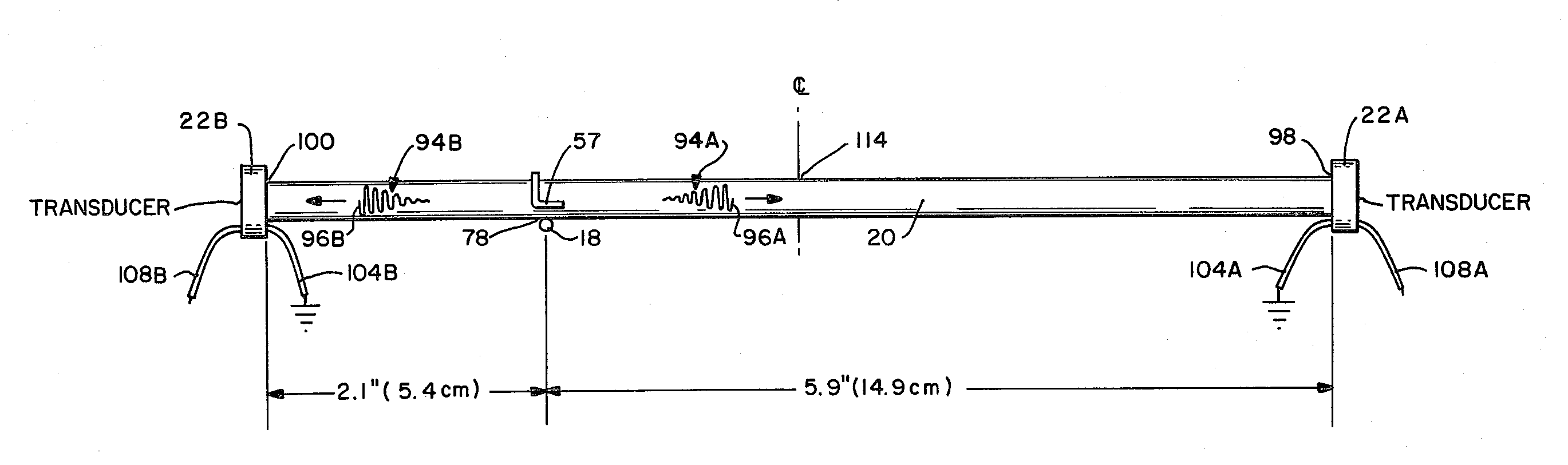

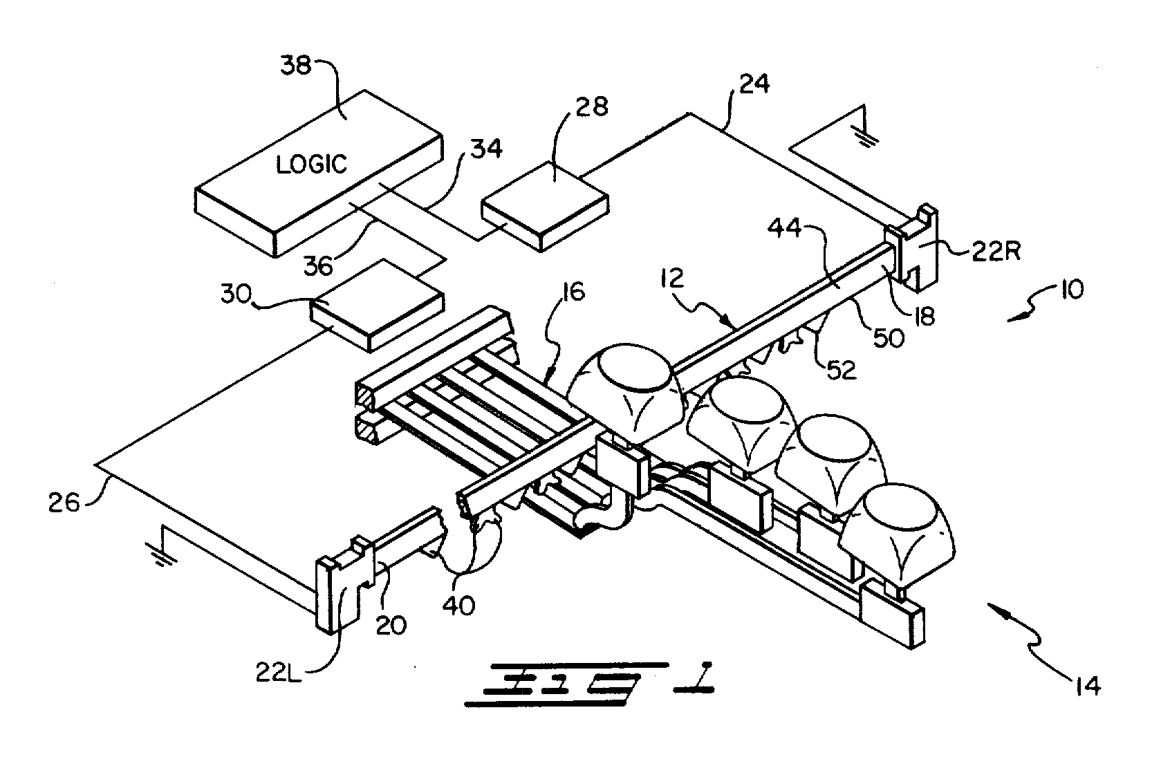

HaaTa's Ultrasonic
This Smith-Corona Ultrasonic I Plus turned out to be marvel of mechanical engineering. It is an "acoustic-sense" keyboard, using little slappers that hit a bar to encode a time difference which in turn will hit the transducers on either sides.
The Ultrasonic's ability to communicate with dolphins is as of yet undiscovered.

If you haven't seen it yet. I give a demo on how the slappers (and slapper stoppers) work.
The keyboard is pleasantly clicky and has low force switches.
The two braided cables on each side connect to the two transducers (sensor to detect the vibrations).
Hopefully I'll be proven wrong, but I think this will be the last major keyboard switch sensing tech to be discovered. I always knew something like this was possible, but I didn't think anyone would be crazy enough to actually build one! :mrgreen:

The Ultrasonic is what got my vote, for the sheer levels of massive WTF it has.

the ultrasonic-- is it very prone to lockout? i'd think if you hit two keys during the time for the sound to reach the transducers, they'd record nonsense or at least have a hard time disaminguating the input.
HaaTa
Master Kiibohd Hunter
08 Dec 2014, 04:22
Hak Foo wrote: the ultrasonic-- is it very prone to lockout? i'd think if you hit two keys during the time for the sound to reach the transducers, they'd record nonsense or at least have a hard time disaminguating the input.
Yeah, at a basic level I do agree with you. However it may actually be possible to figure out multiple keys being pressed at the same time.
First, the bar is specially design to direct the vibration and prevent losses, so I doubt that one strike would wash out the other.
Second, (theorizing here) not considering reflections from the end points of the bar, if a pulse is detected too quickly between each side, then it should be possible expect two more pulses and time those key events.
I could see something like this being implemented easily (in 1980s tech) for 2 KRO. It might even be possible to handle 3+ KRO, though the tracking would get tricky (and you'd have to figure out a way to exclude false positives).
