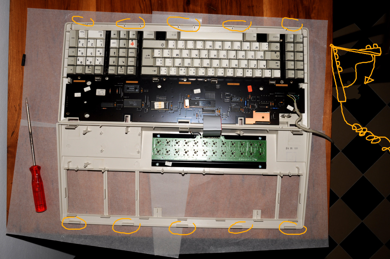

While trying to open the keyboard to clean out the dust bunnies, I managed to crack one of the plastic clips on the right side - just my luck. Must have twisted the screwdriver too much and the clip cracked near the middle. Bugger. Why couldn't they just stick with screws like IBM?

God damn it, putting it back together is even harder!!! Bottom edge is near-impossible to assemble properly. Driving me crazy.

Half-Saint wrote:While trying to open the keyboard to clean out the dust bunnies, I managed to crack one of the plastic clips on the right side - just my luck. Must have twisted the screwdriver too much and the clip cracked near the middle. Bugger. Why couldn't they just stick with screws like IBM?
This had been done intentiously to screw up people like you and me and anybody else who wants to open it. We can be lucky they didn't glue them fixed! :roll:

Half-Saint wrote:God damn it, putting it back together is even harder!!! Bottom edge is near-impossible to assemble properly. Driving me crazy.
Just trake your time! It took me a while, too. Should have written a wiki article about that.
You have to hook it into the front first at some angle and then turn it close.
If anything brakes, I will not accept any responsibility for that!
Edit: Just see it does not work that way, because the function keys are mounted to the upper shell!
Now I've got to think really hard to remember how it worked. Meybe not at that extreme angle ...

Closing the case is easy: first hook in all front clips properly (they will likely try unhooking while you close the lid) holding the case at 30 degree angle, then gently push down the rear side of the cover seeing to it that the front clips stay closed.
